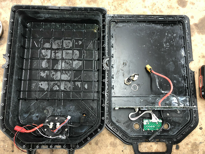

The Waydoo battery packs seem to fail sometimes because the buttons aren’t really op for the task and therefore not being able to charge it or use it. They get wet inside and stop making a reliables connection and therefore stop working as a switch. I have replaced a few buttons now and opened about a pack or 8. All seem to have the battery lose in there and always one or two corner seals folded. The loose battery can easily be fixed and isn’t a real problem i just think a blob of silicone can solve that. So far even with the folded seal no leaks from the factory. (Hopefully they read this)
For now, one battery was underperforming and losing capacity after one season of use(first generation type). But besides that no real problems. The shrinkwrap waterproofing seems to work but they need to fix the battery in the case since the shrinkwrap will just wear through like happened here.
Arguing about the XT90 connector, that one is used in parallel they use both pins for the negative side of the battery so 180A (2x90) peak and 80A (2x40) continues. That means 4kW continues and the board is not pulling that so no problem. About the loose PCB end that shouldn’t be an issue unless it’s used in an esk8 that continuously rides on cobblestones. It would be nicer it was incased and better coated. But when you get water in the casing it’s game over in any case. Fixing this would mean fully potting the battery. And will only add weight and unfixable electronic waste.
The battery shown in the photos down here has water damaged. But not because of bad quality control, someone replaced a button but misplaced the seal (this one is hard to instal so I understand why).
