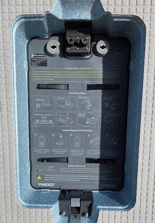

Goodluck trying to find a way to make a custom waterproof battery that sits flush within the cavity. Youll need to exactly remodel the battery in CAD, including all connectors. This is not an easy job. Waydoo uses a wet battery principle, so the battery itself is exposed to water, and needs to be filled with epoxy to prevent water from entering.

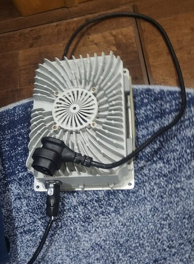

200828 Batt to ESC conn 3
The fastest / easiest / cheapest way to do it would be to buy a second hand battery AND a compatible charger (appropriate connector);

He has the Evo which is a much simpler housing to clone. On top of there probably loads of old housings knocking around on Facebook.
@jefoil go for it. The evo boards are the cheapest board only units and if you get it right its actually a far simpler build than with a hatch. I ditched all my boards with a hatch because they just add so much weight.
It’s not that simple. No simply way of integrating DIY in a waydoo board. Also, the evo boards have potted batteries, there’s not a lot of non workings ones out there. You make it sound really simple…it’s not.
