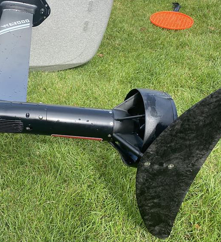

For example, you seem to have issue with the stabiliser attaching to the plastic duct which cant be removed.
  1. The stabiliser does not attach to the duct.
  2. The plastic duct can be removed.

Is this not the final design? I don’t see how the duct could be removed without also removing the stabilizer.
The bottom strut holding the stab seems is longer and thicker than the others.
You just need to imagine you keep this one and cut all the others with a Dremel to get rid of the duct.
“Imagine” because you can either 3D print this piece that looks like a prop fairing with a long single strut.
Or (when / if available) you buy a spare that will be physically cut as described above .
Once done, you’ve found a way to increase the Waydoo One speed by 15-20%.
That must be… pretty fast !
Cherry on the cake, if you reach this point… you could mount the modified @superlefax 3D printed folding prop :+1:
I noticed that too, but I’m not sure that strut alone would be enough to (safely) support the stabilizer if it was the only thing left of the entire shroud.
It’s a bit of a stretch to say the shroud can be removed at this point since it clearly isn’t intended based on that design.
Just wait a few more weeks/months until they start hitting the water. People will start removing the duct and they can show you how they did it.
Of course its not intended to be removed. My comment of it being removable was in contrast to the claim that it can not be removed.
Considering we on a forum full of people 3d printing shit. Im sure the problem of a missing hub is not insurmountable.

I took a closer look at the stabiliser strut/shroud assembly the other day. It’s quite interesting. The leading edge that you can see in the picture above is roughly a cm thick, rounded to a semi-circular profile and of a sturdy metal construction. Butting up to it, and flush with the sides, is the plastic housing of the prop shroud. The strut is definitely a structural component. The shroud is not.
I think it’s a very clever design. Probably not as robust as the Fliteboard design - it being shorter - but certainly neater and structurally more or less the same, retaining the advantages of the prop position relative to the foil and stab.
