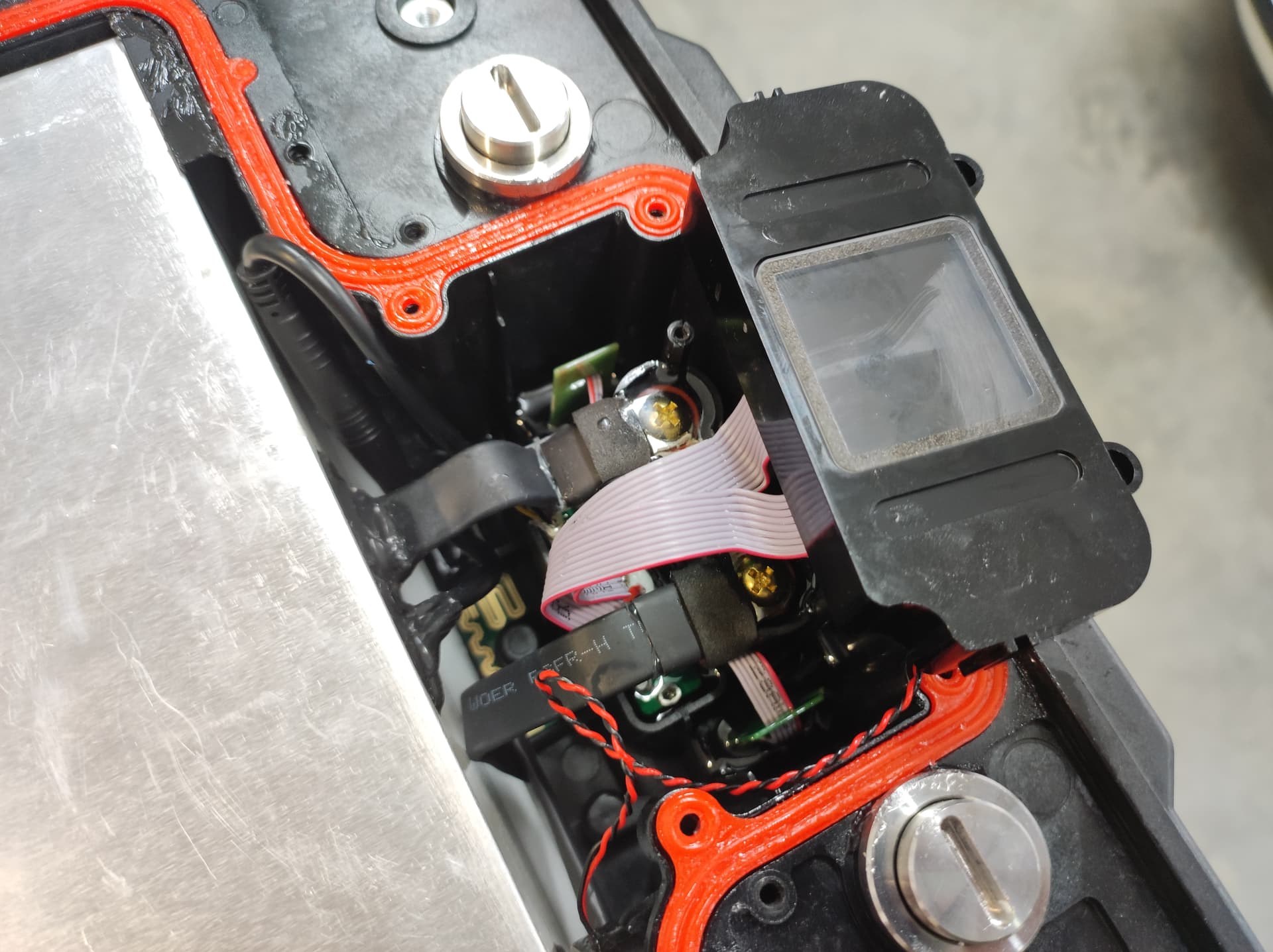

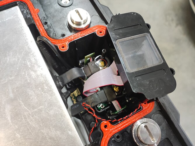

If you look at the photo (sorry, I can only upload one), you’ll see that the battery pack and the BMS (which the sensor is likely connected to) are housed in a resin-filled aluminum block. The only external connections are:
  • The battery power terminals
  • That detachable multi-conductor black cable (likely a communication bus between the BMS and the battery interface?)
You can also see a twisted pair cable (black/red): that connects to the buzzer.
I don’t know if anyone else has encountered this problem and managed to fix it; my only non-invasive option is to try updating the BMS firmware.
Otherwise, the only possibility is accessing the BMS—which means removing the resin—hoping that it’s only present on the output side of the battery pack.
