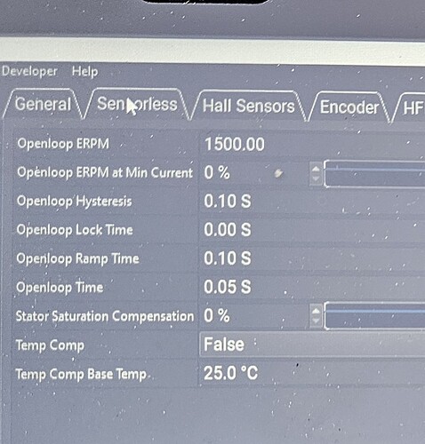

Im calling out for help again; bottom line - board has no power and barely moves through the water. I’ve turned off phase filters and run FOC detection- all goes smoothly.
Thoughts??

Show a vesc log running it, with current, voltage and rpm and pictures of your setup.
Do you reach 100% throttle when you’re pressing it?
Which propeller?
Are you using duct?
Is there a watt limit defined in vesc?
