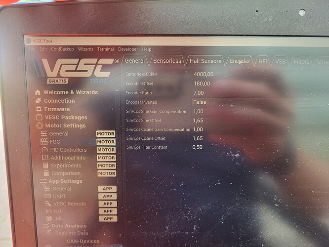

please show the motor parameters that are identified in program.
Do you have phase filters=no in program?
Motor cfg - FOC - Filters
In Case you cant find it
bought last year
I will write the values ​​tomorrow, I have to go to work.
so the motor settings/foc/filters tab is empty.
