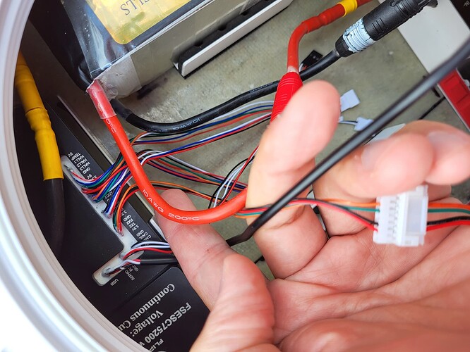

Hey guys, could you please look at my settings, I have performance promises. The set is: Flipsky 65161, Flipsky FSESC7200 and lipo battery 12S - 50V. The motor does not run at full power in the water, maximum 32A on the controller. Please do not know what I should change in the settings??? Thank you very much, best regards, Lukáš Zajacz, Czech Republic. I will try to upload photos of the setup here.

I have a Flipsky vx3 controller, a 12-cell serial lipo-50.4V battery. Flipsky vx3 controller mode - HIGH. I don’t have a BMS and the propeller is from Flying rodeo, for the flipsky and maytech engine.

motor poles 4, max power 6000w, gas shows almost 100%. But there will probably be a problem with connecting the receiver or with its settings. PPM mode worked but did not display telemetry. so I connected the UART cable, but instead of 5V I have a 3.3V receiver.
I’ll try it tomorrow in PPM mode with a simple 3 pin cable.
