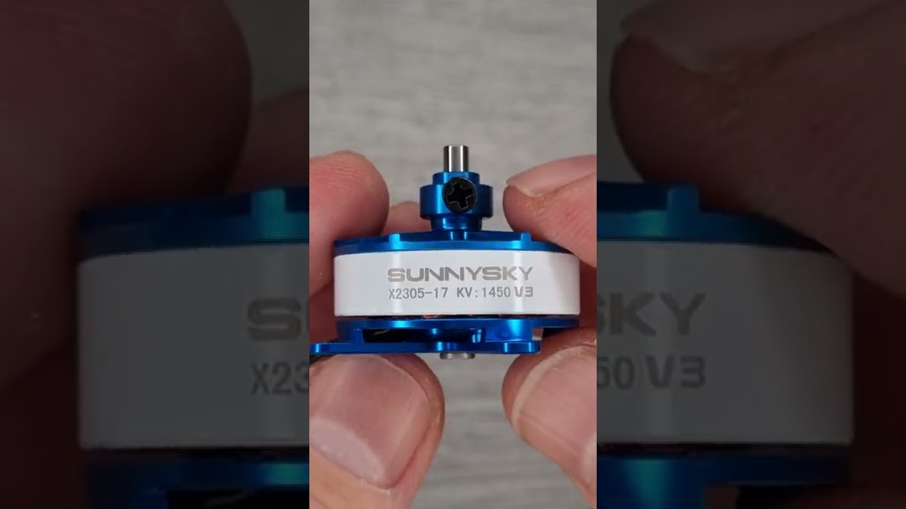

I came accros this video from SunnSkyRC.com : weight: 26 grams, static thrust in air : 680grams so a X26 multiplying factor
