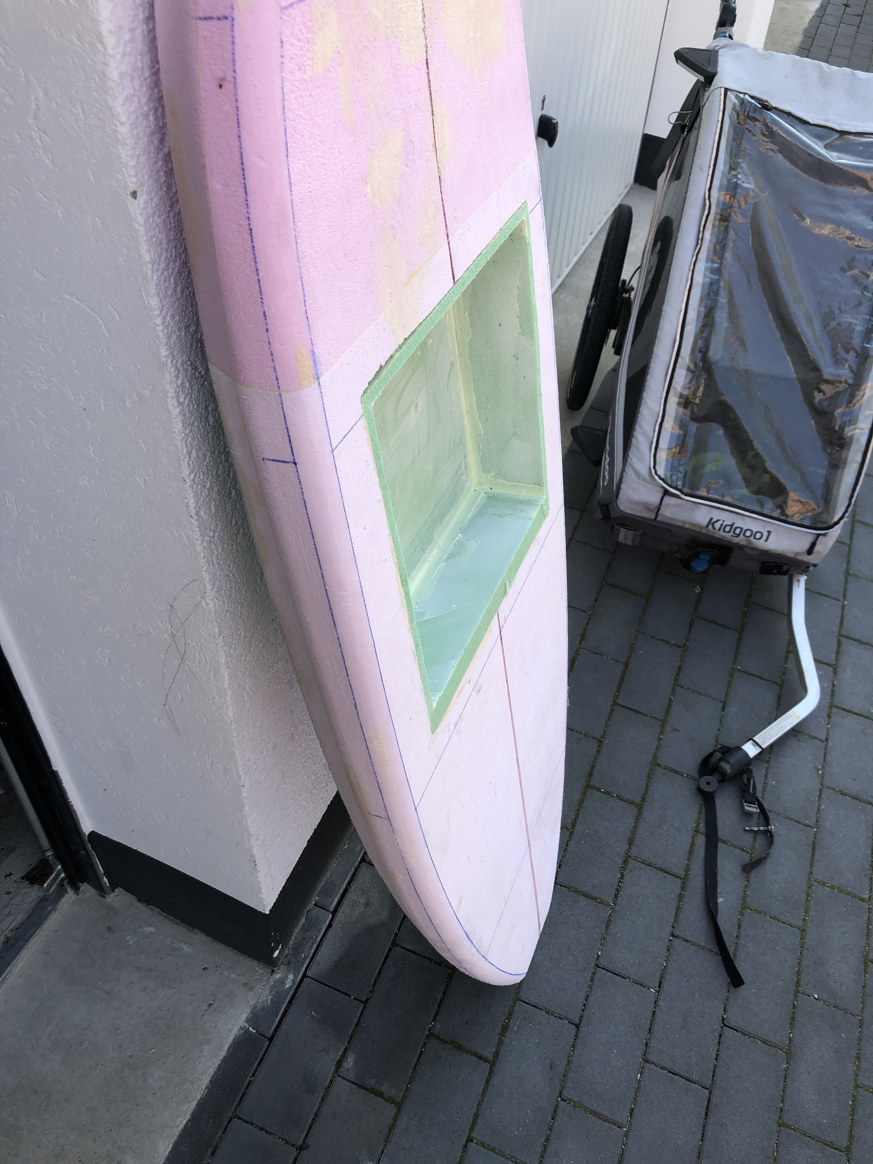

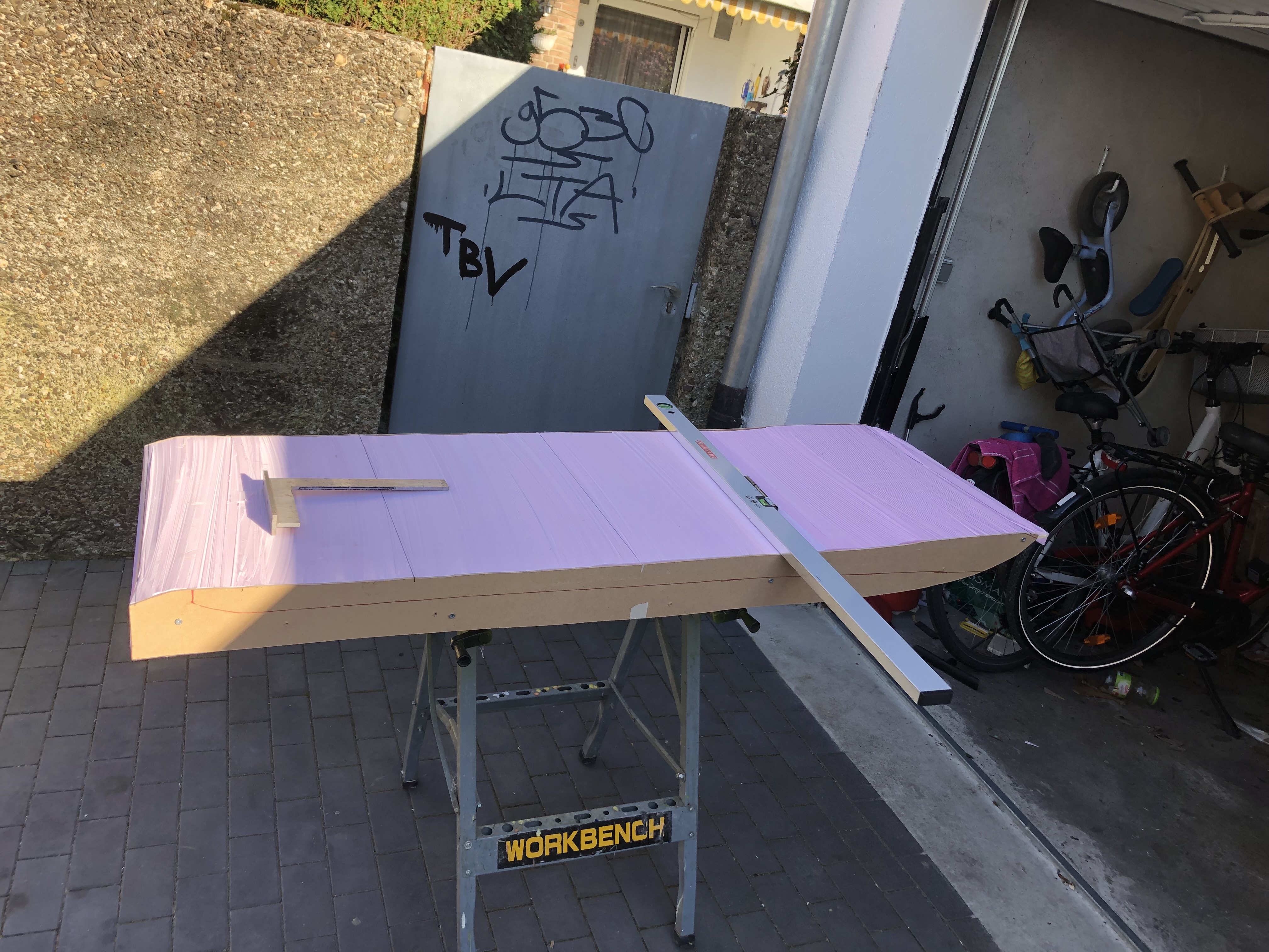

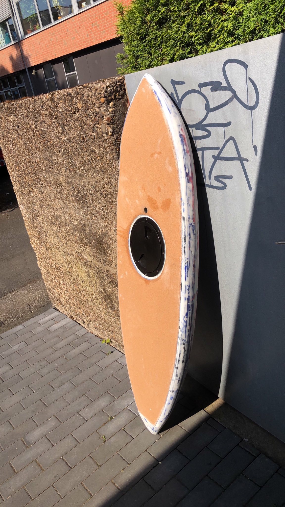

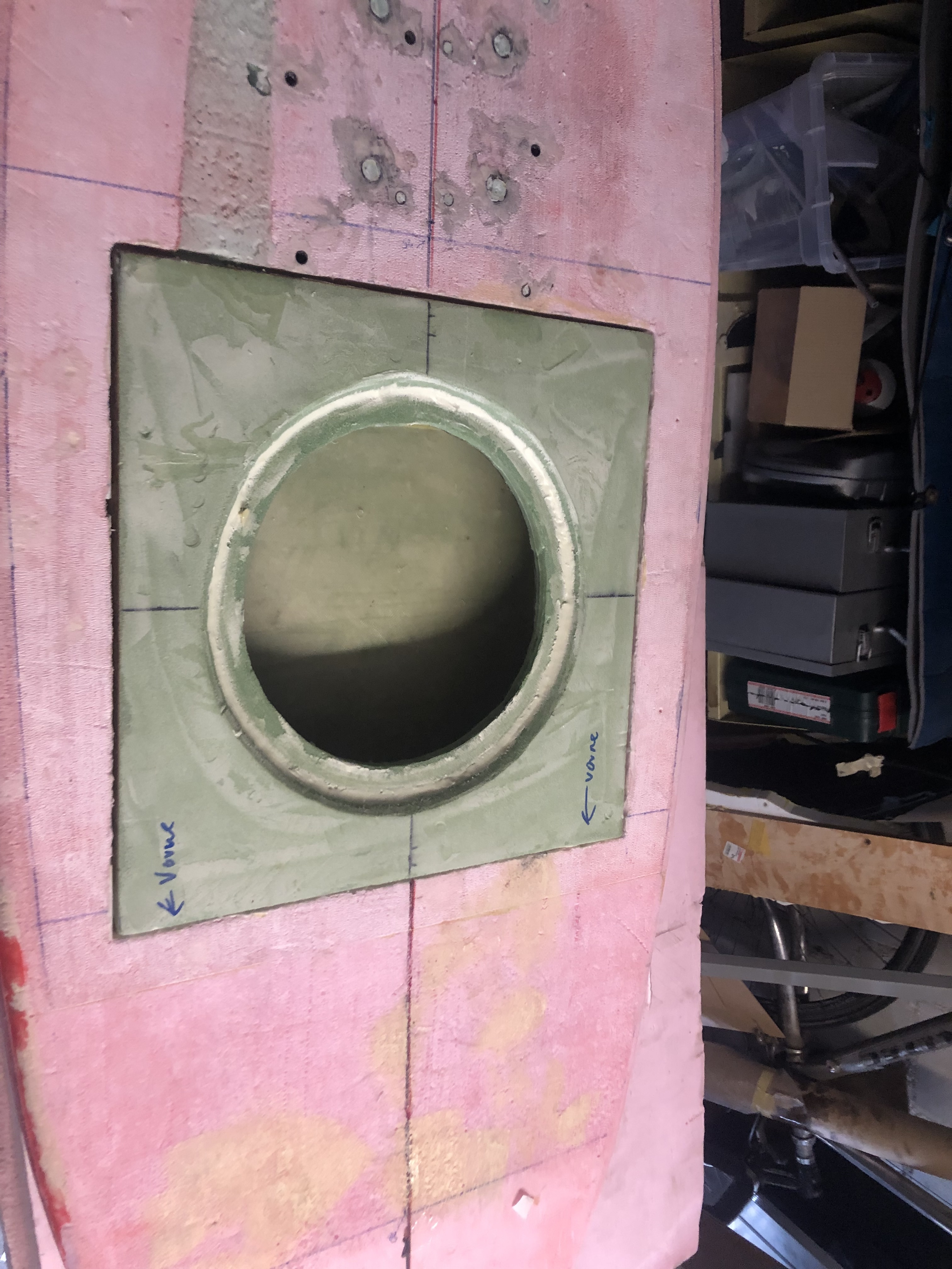

Hi, maybe get a shape 3d license to get 2d export. Print the rocker out and get cheap 2x mdf strips. And cut them accordingly .
This is a guide for your rocker.
Get some xps. Use screws to attach the mdf to the foam. Hotwire ( my diy Hotwire has an old laptop power supply as a electric)
You just need a relatively flat rocker and a good planing surface(means flat wide surface in the bottom) Round rails.
A simple basic shape works well with e foil or assist

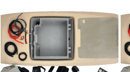

I was able to buy board only from my local distributor:
https://www.blowmykite.com
They did have few raw sets for Takuma and Waydoo boards
