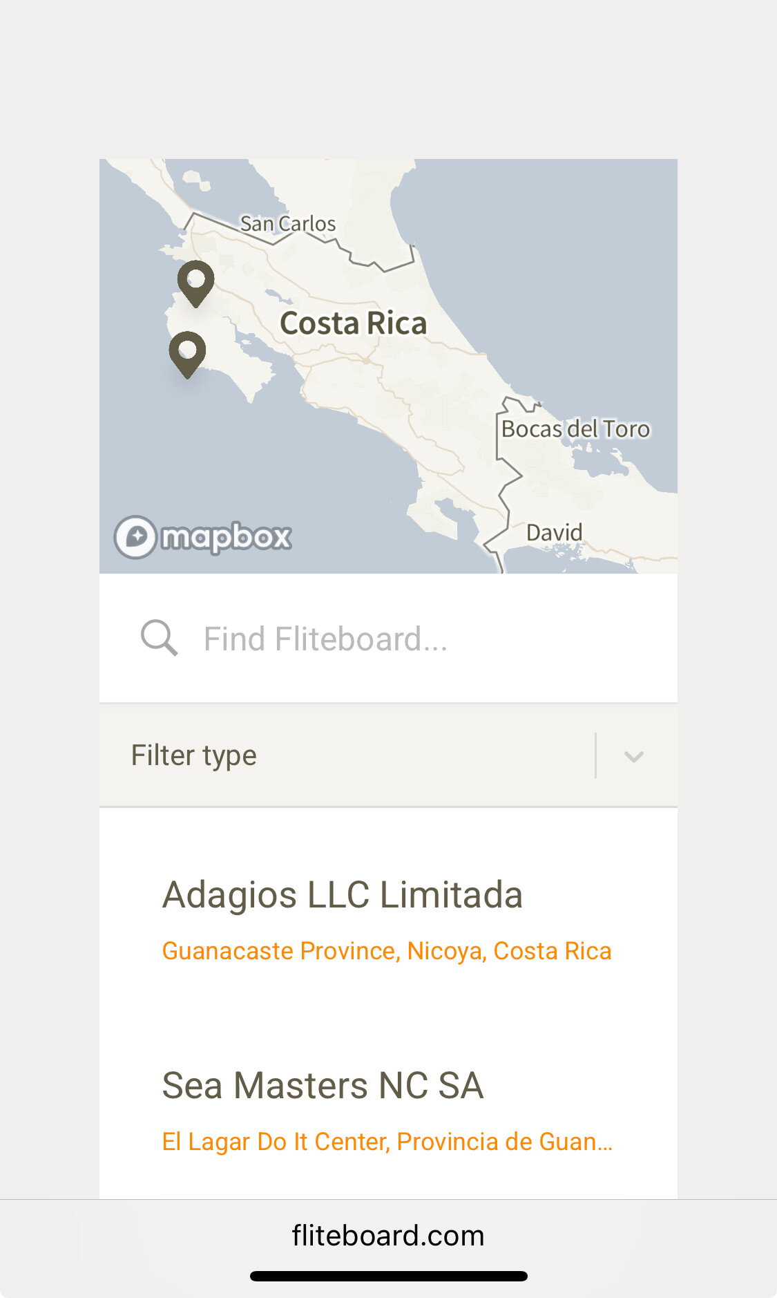

Lift is a very reputable company, the only other one that imo is worth considering is Fliteboard that have two dealerships in country.
