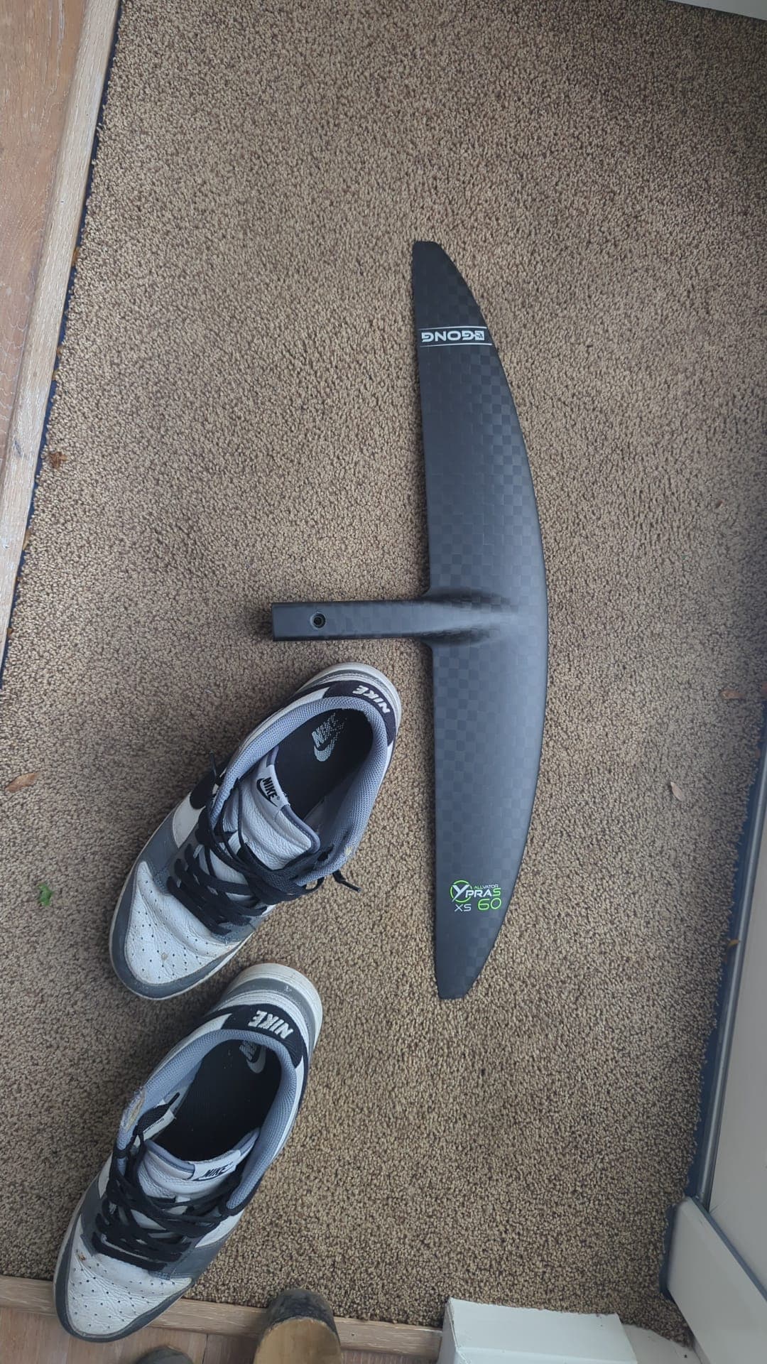

Cant wait to test this (and I am not talking about the sneakers) :slight_smile:
nice thing, also with ypra stab?
please chare conclusion after test.
lets hope not a squirrel on crack like windigo’s fluid H :sweat_smile:
xs is very small ., what is your weight?
Total weight of me suited up is around 85kg.
I will keep you updated how the new wing did.

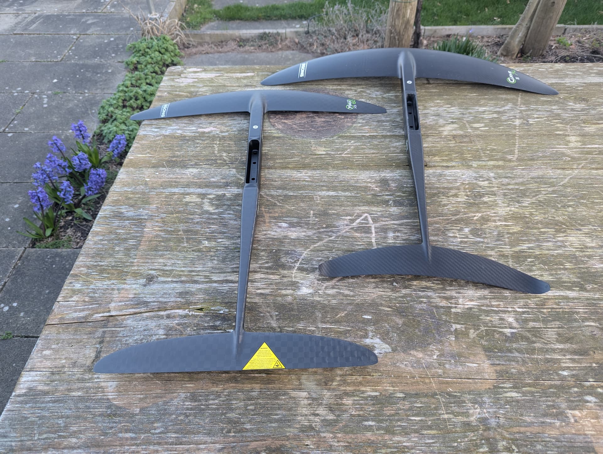

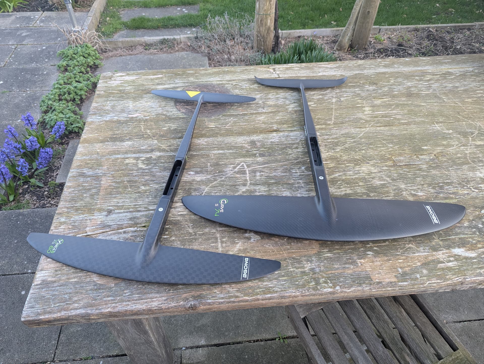

By the way I loved the old setup. (On the right of the picture)
Have you tried it? How did it go?
Could you give me a bit more information about the wings?

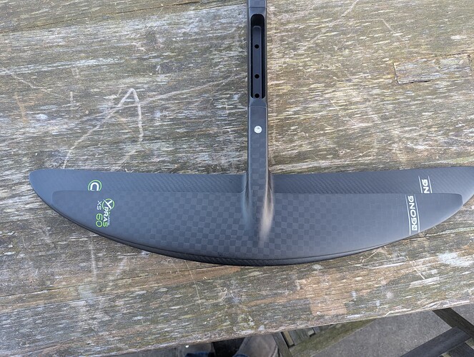

hey kian, did you test the ypra XS ?
No, I’m currently in my final exam period at school, so I don’t really have any time at the moment.
ok , good luck (and study well :v:)
hi kian, so whats the verdict about the ypra xs?
It’s a bit harder to start.
Needs a lot of power, and ALL weight on the front of the board (Fliteboard Ultra).
I’m almost doing a “hang ten.” when starting :smile:
Once going, it’s great, but very, very unforgiving!
The smallest movement or weight shift is noticeable.
It’s very nice in the turns. However, again… weight shift is very noticeable.
It’s NOT a forgiving wing! Any mistake, and you will be punished!
Very fast too (once going). +50 km/h is no problem, but because it’s not an easy wing, it’s very scary too!
I’m using a 65161 120KV with Flite prop and 16S12P on a Ultra.
