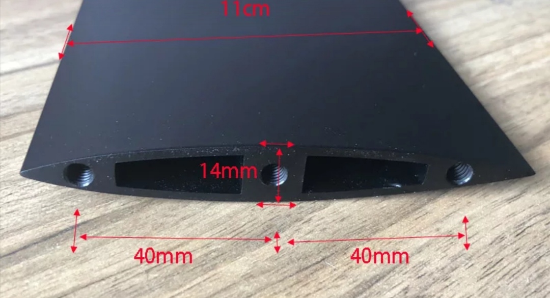

The bolt pattern is identical to the axis mast.
I designed adaptors for both the axis mast and gong mast so I could test them.

That’s an interesting concept but pretty pricey: 1090usd for a wing fixed to a fuselage, no mast (+670usd), no stab (+175). Total: 1935usd.
