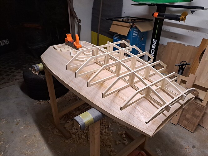

Electric box is ready for v3 and make full cfk rear mast clamp from @Manufoil design the front clamp is in work so only make the batterie box ready and mount the mast in v3 then is ready
Good Seal!
20 chr
The board looks really nice! Great and definately a lot of work ![]()
For the battery box you could have gone for the easier option and by a complete kit,
saves a lot of time and works great ![]()
The box is not big enough for 14s10p 21700 Cells so the only solution is selfbuild

Regarding the battery, wow, that thing is massive. I am currently making an overview to compare Energy/Power/… of different eFoil builds. Yours is up to now the biggest (>2kWh) and by far most powerful (>16kW
Out of interest, how do you charge your battery?
Isdt p30 and and isdt 3060 Power supply
New board v4 1450x680x128mm with flying rodeo motor mgm controller 14s10p samsung 40t batterie and flipsky remote all in plywood and coating later in crazy color
What beauty
what’s the board only weight?
… and the board “levitation” system using the US rails is well thought off for a unique, nice and easy paint job !
So only the Electronic and maybe a Green prop @Flying_Rodeo can you make a ultra prop in Green?
Beautiful and perfect works of art, artisan spirit
