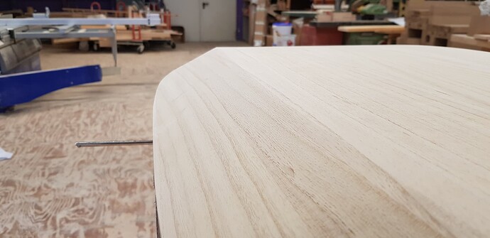

Today made finish the rips tomorrow i glue the paulownia wood to plates and hope i can make this week the bottom finish
What thickness of paulowina do you use for the sheeting?
The sheets are 4.5-5mm on the rails 2x6mm and one 160g glas on top and buttom

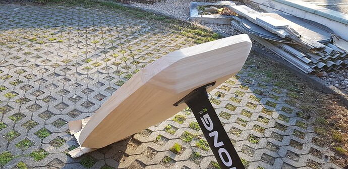

Finish with the sheets and today glue the m8 inserts in bottom hope i can go next week to make the board finish for glassing

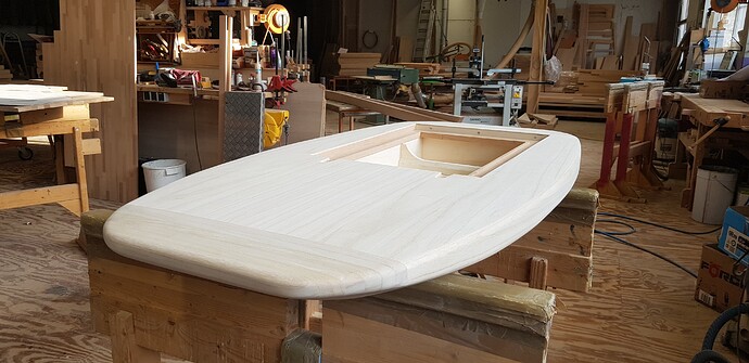

Finish with glassing and coating start to build the lion box and looking for a box for the esc and other electric stuff
What material did you use for the battery box? Looks like its been bonded or welded in the middle.
Its only 3d printed petg i make it in 4 pieces top and bottom i want to make with 2mm cfk sheets
