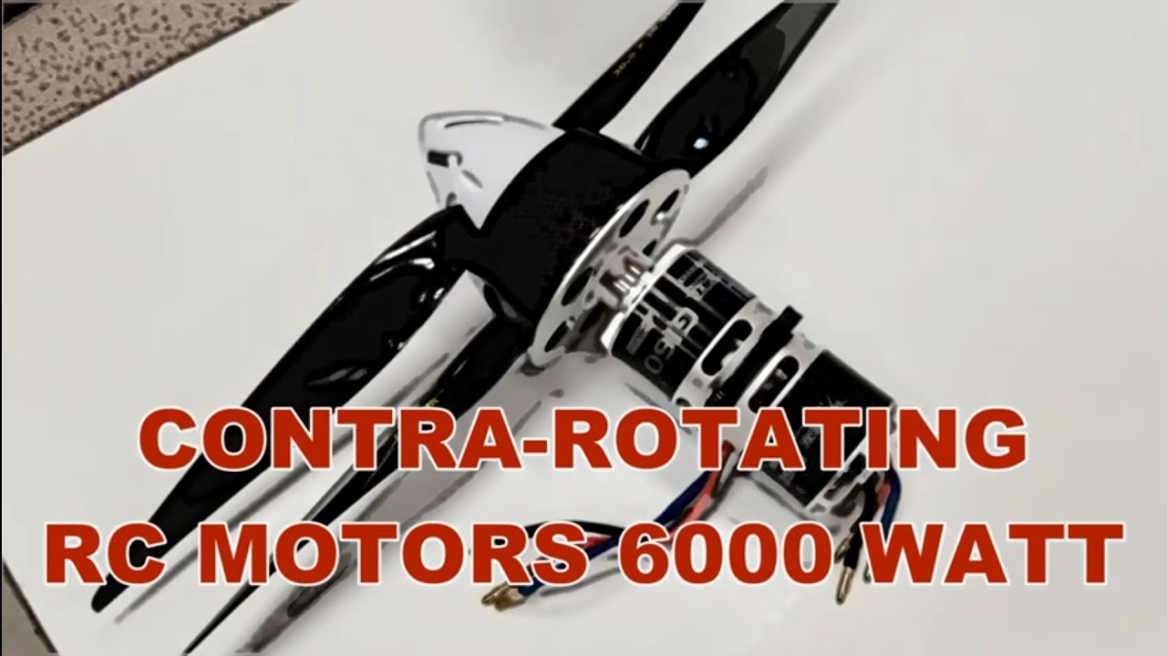

2 outrunners one in front and in the back already done
Why do you say inrunner in front ? How do you see this ? Inrunner shaft running into the outrunner bolt on? Wet inrunner ?
Possible my inrunner was most of the in the water and it is still working
Please share your sauce. Making a dual drive innruner in same shell is extremely challenging.

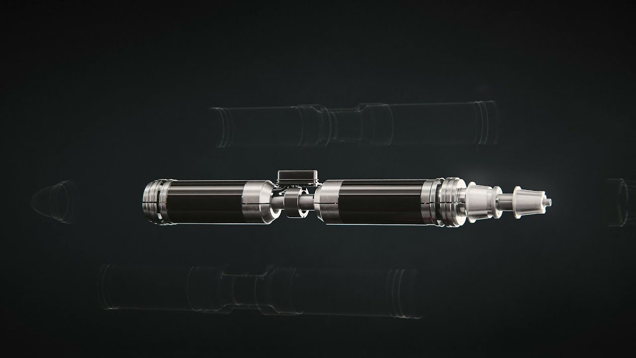

Here is a nice animation of the motor.
And here some more info;

You could very easily do this with 2 outrunners to see how much gain can be had. You could run 2 63mm 140kv (4000W each) motors. Start the front prop at 5 inch pitch and run the rear prop at 7 or 8 inch pitch. Could be a fun little project.
Probably not going to win a lot with outrunners. The disturbed flow and added flow speed from the rotating can might very well remove the theoretic efficiency gain with contra-rotating props.
