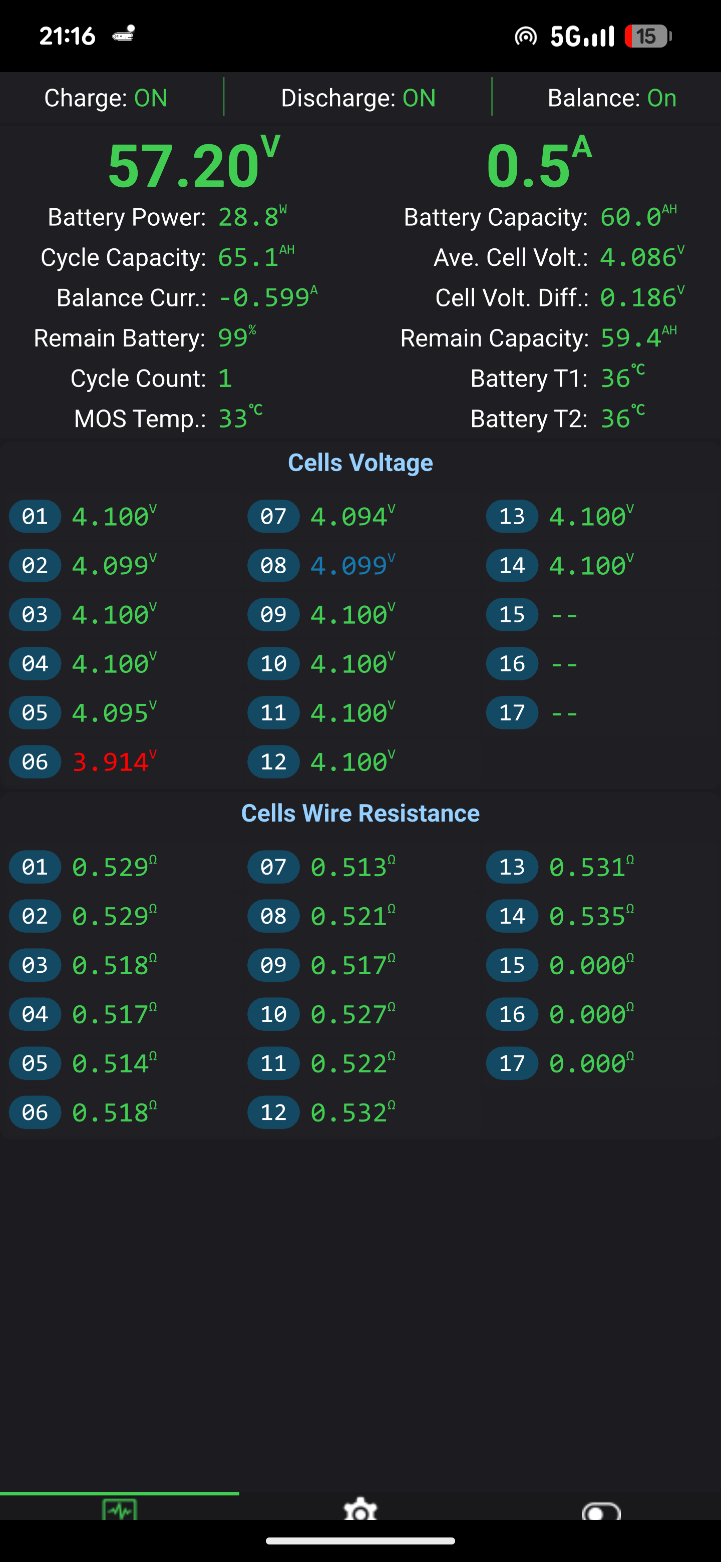

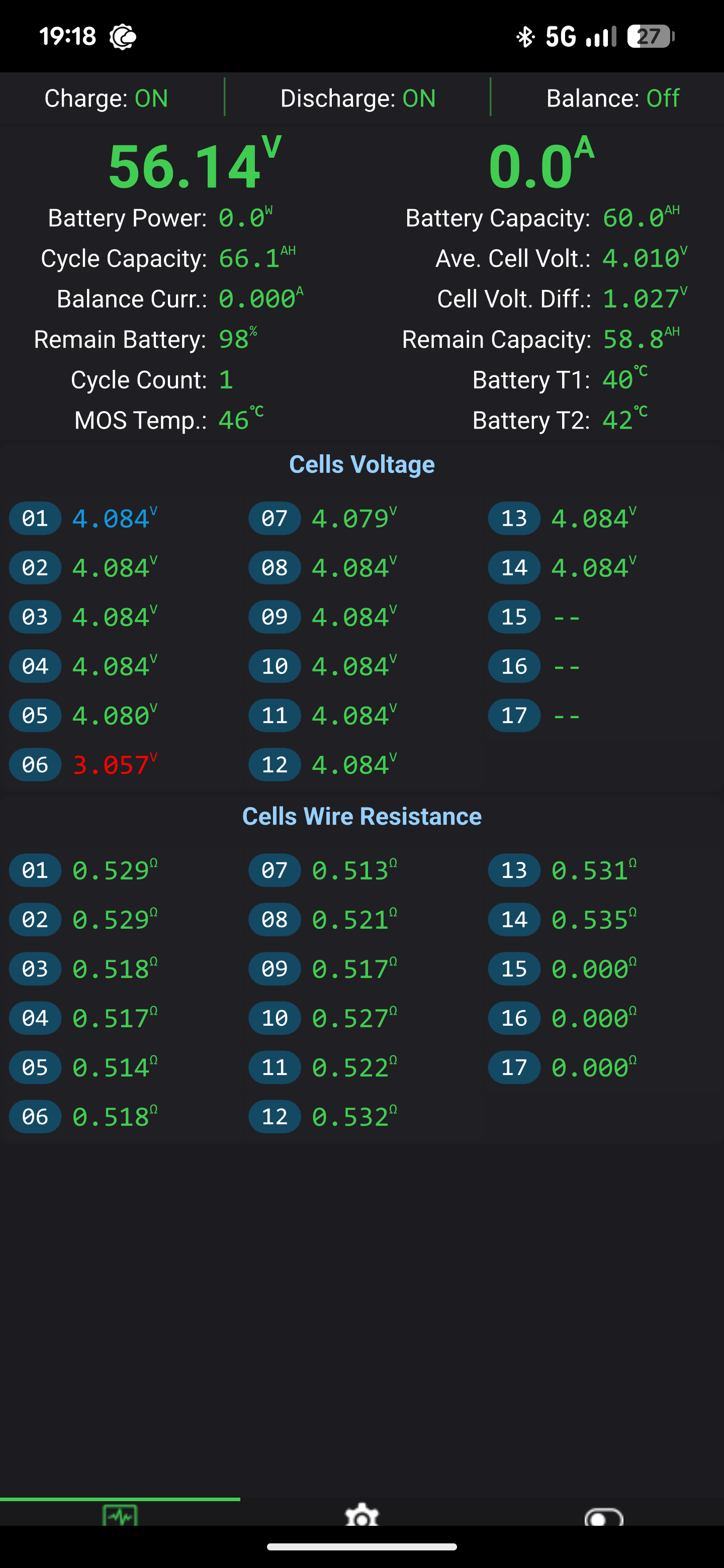

One of the cells in the battery is dying of quick self discharge, hopefully in an uneventfull manner.
It is isolated in a safe spot with active balancing turned off.
There was not warning sign, that is quite strange. I had another week cell (n°7) but on a much lower scale.

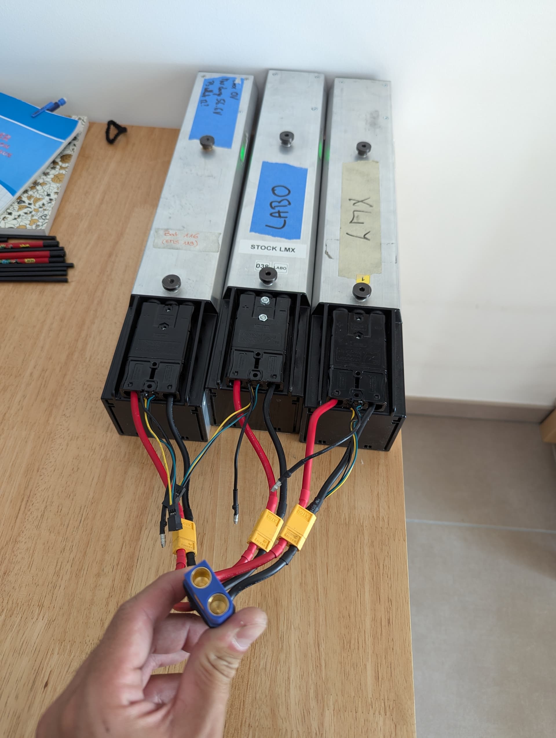

After one week, the bad cell is fully discharged and dying.

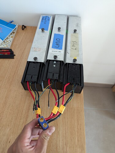

Battery situation sorted out for this weekend with a few working batteries borrowed from work. It is also a good test of parallel use, as I have some new bms to test.
Each battery has a 60A cutout and 50A continuous, so I should not have bms cut outs with this setup.

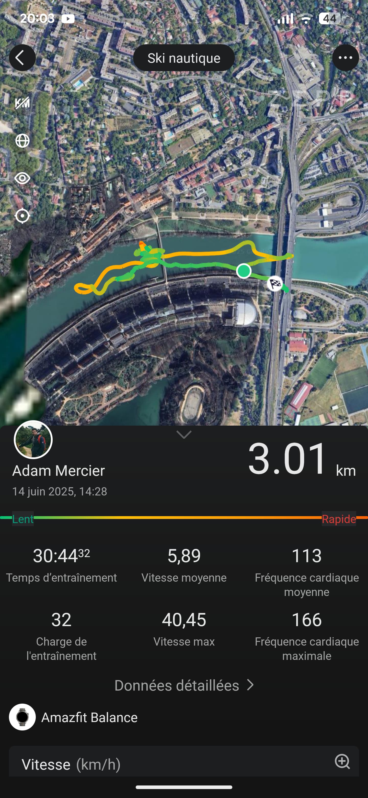

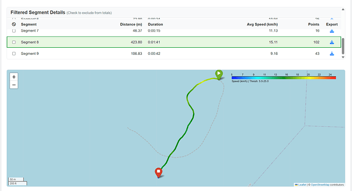

A little underpowered playing in the strong river current, vesc is overheating, at the moment there is only a small fan, but nothing to extract the heat out.
The limit of this project is nice lakes or sea with low current close to where I live.

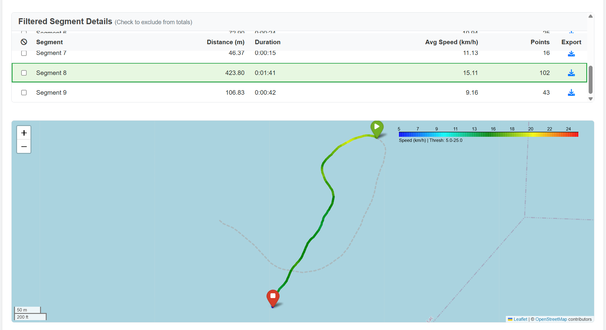

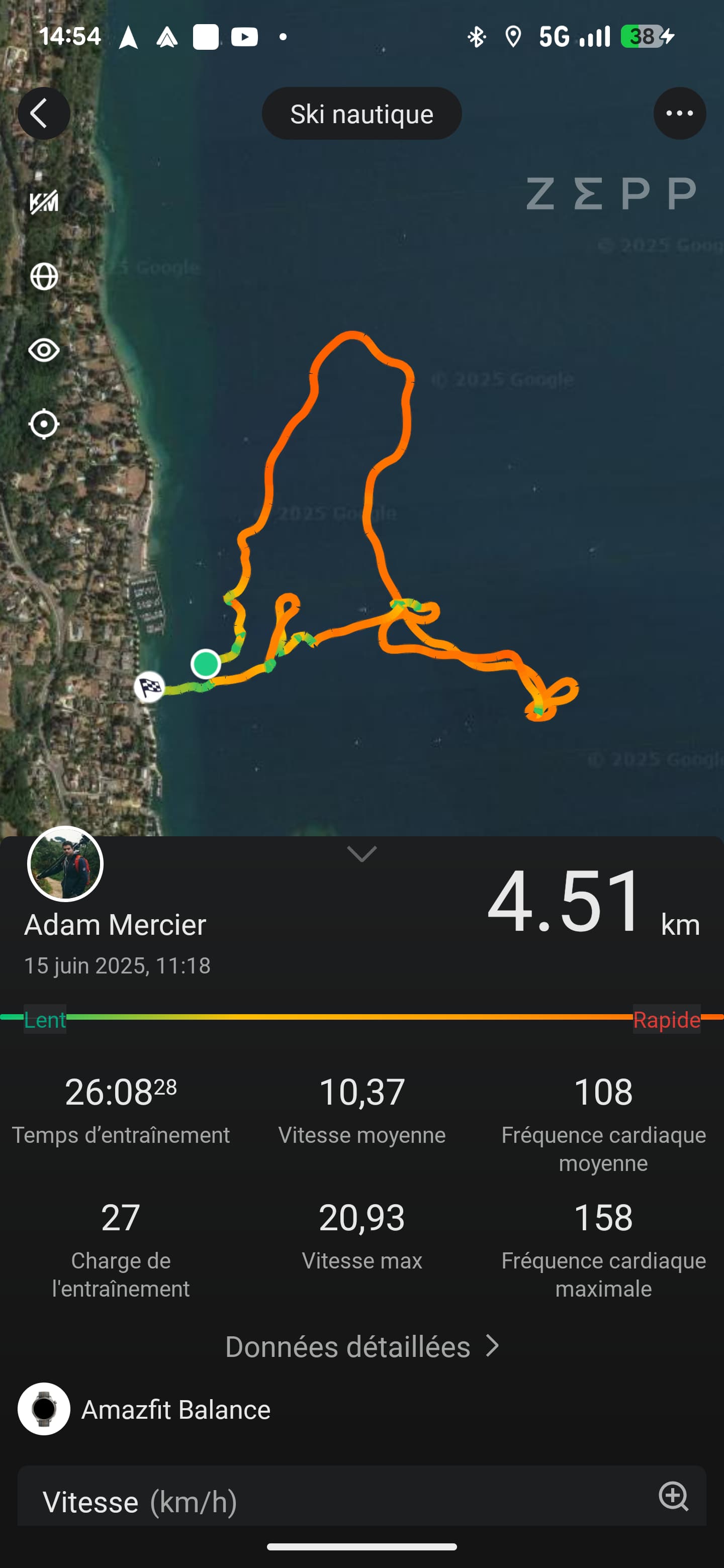

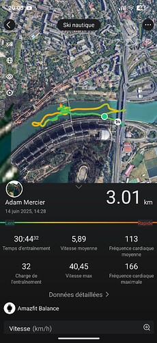

Had a redemption session, with flat water, boat waves to hunt and in a ski zone :metal:
Then went on a family adventure across the lake and back, around 6km.
The max continuous speed was around 8kph dur to the controller overheating and getting into thermal limitation. This is the next point of interest.

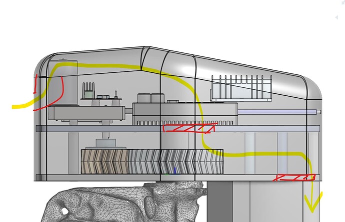

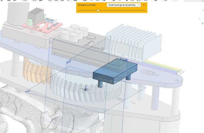

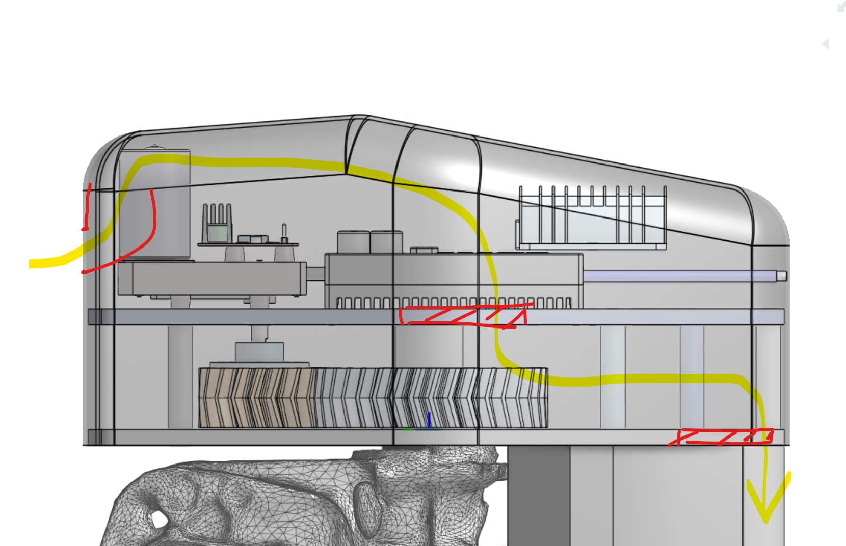

Option for air cooling
Request for silixcon PPM compatible software ongoing. I’m almost sure the silixcon would run with no cooling due to higher efficiency and quality MOSfets.
I planned for a water line by static pressure but have nowhere free to mount water blocks.
Strip your vesc from the housing and put it directly to the big aluminium Plate while using good cooling paste. Maybe thats enough.
Yes, that would definitely help, but I fear that if I dont get the heat out of the plate, it will not work. Easy thing would be to replace all spacers by alu tubes , to transfer heat to the bottom plate that is exposed to the outside.

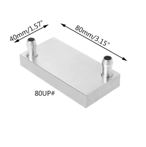

I can fit a small water block here with right exits/fittings :
Not sure how effective it would be.
Give the passive cooling a try, if it is not enough cooling put a cooling block directly to the alu plate and there on top the striped vesc. Like a sandwich.

Not convinced by the idea of breaking the waterproof nature of the engine cover for cooling. So water circulation or passive is the way.

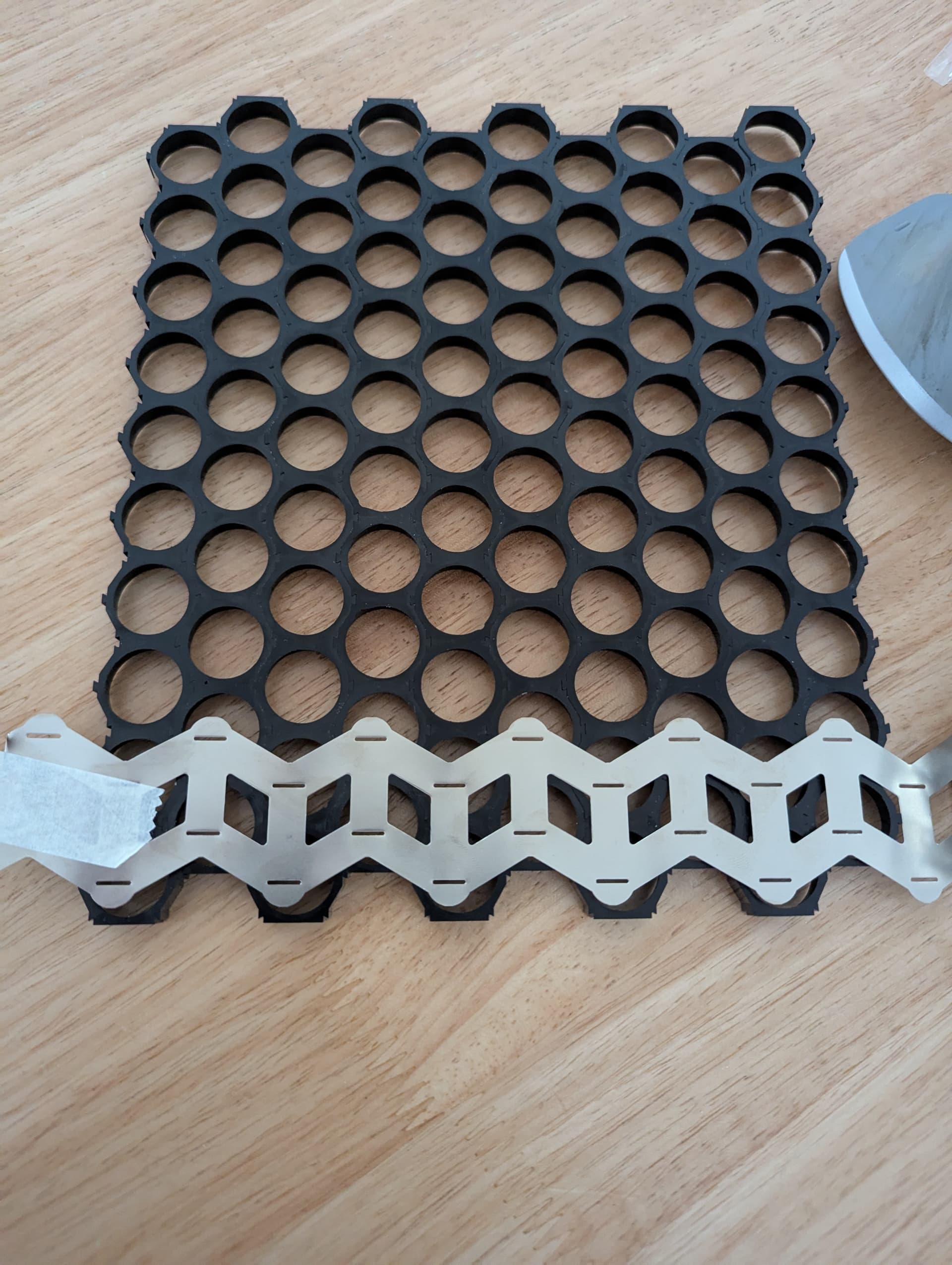

Received cell holders and nickel if I get motivation to make a battery or samples of EVE 50PL or 58E to test

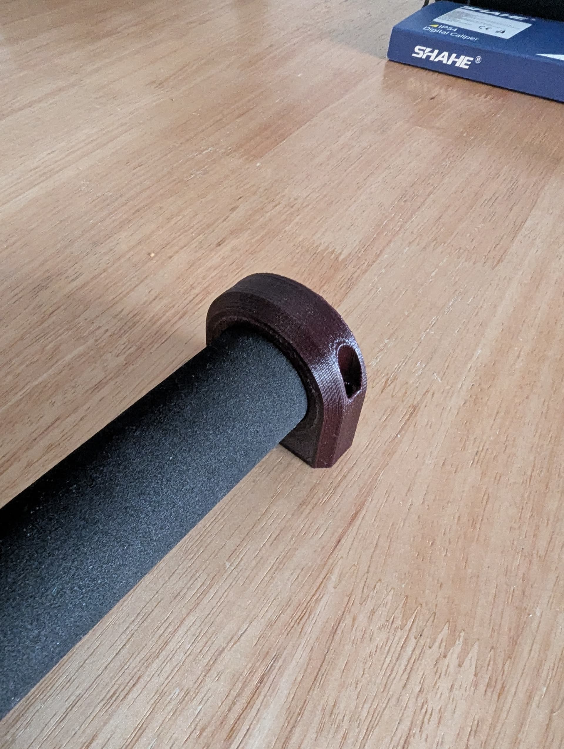

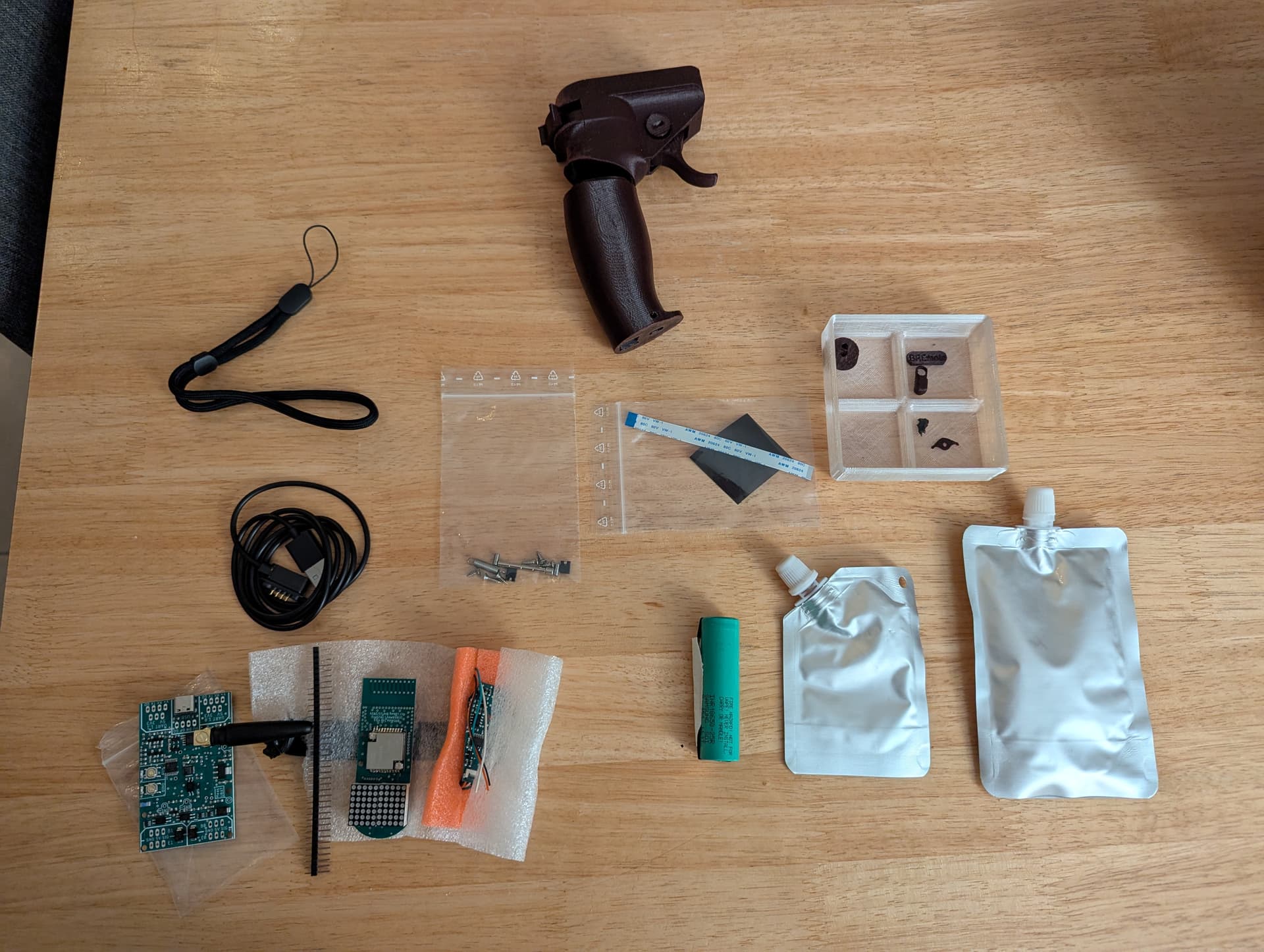

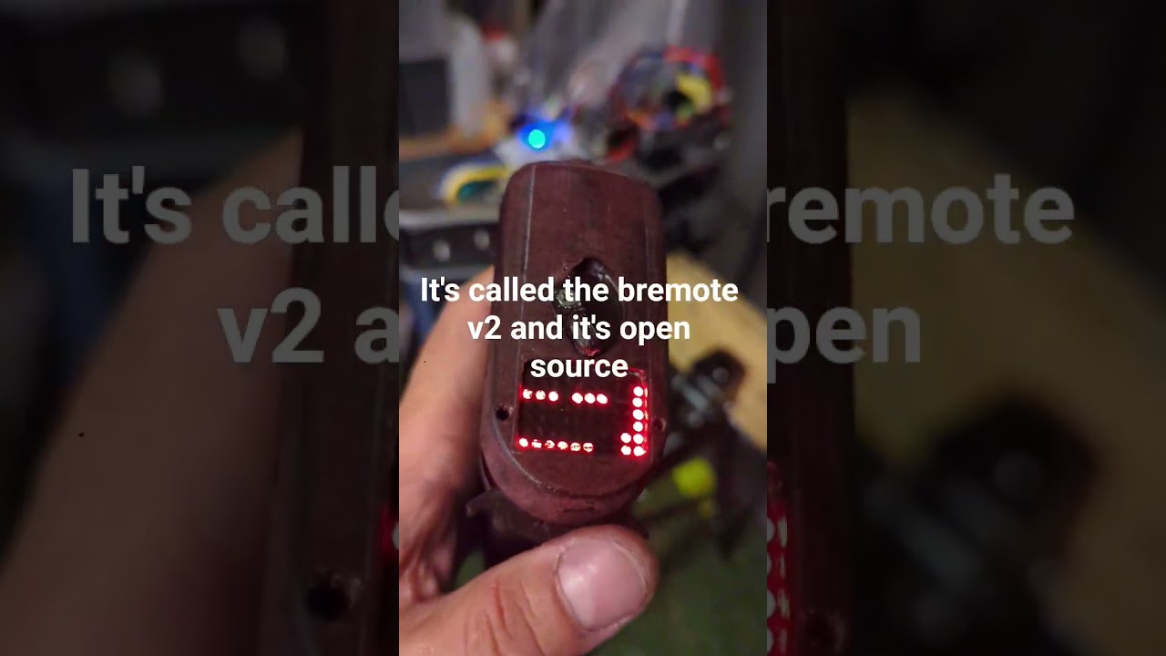

Remote is mounted and configured, took me quite some time to prepare everything. I made a mess with the ribbon câble and the potting, but all seems to work.
The trigger is still sticky and will not return to zéro well.
Did not add the gps in the remote, when the project has advanced I will make another remote if needed.
I also wired the watercooling system, I will see if Dynamic pressure is enough. The tubes are quite small but the water block is nice and the exact size of the controller. I removed the base heatsink. Heatsink and controller are just super glued together at the moment, with leftover paste in the middle.
