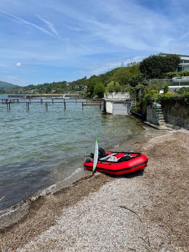

Here is the boat with just me aboard. The motor is on the rev limiter (even with 2+ person), so it could go faster with a higher pitch prop I guess.
The fuel tank in the front helps, also some tiller extension.

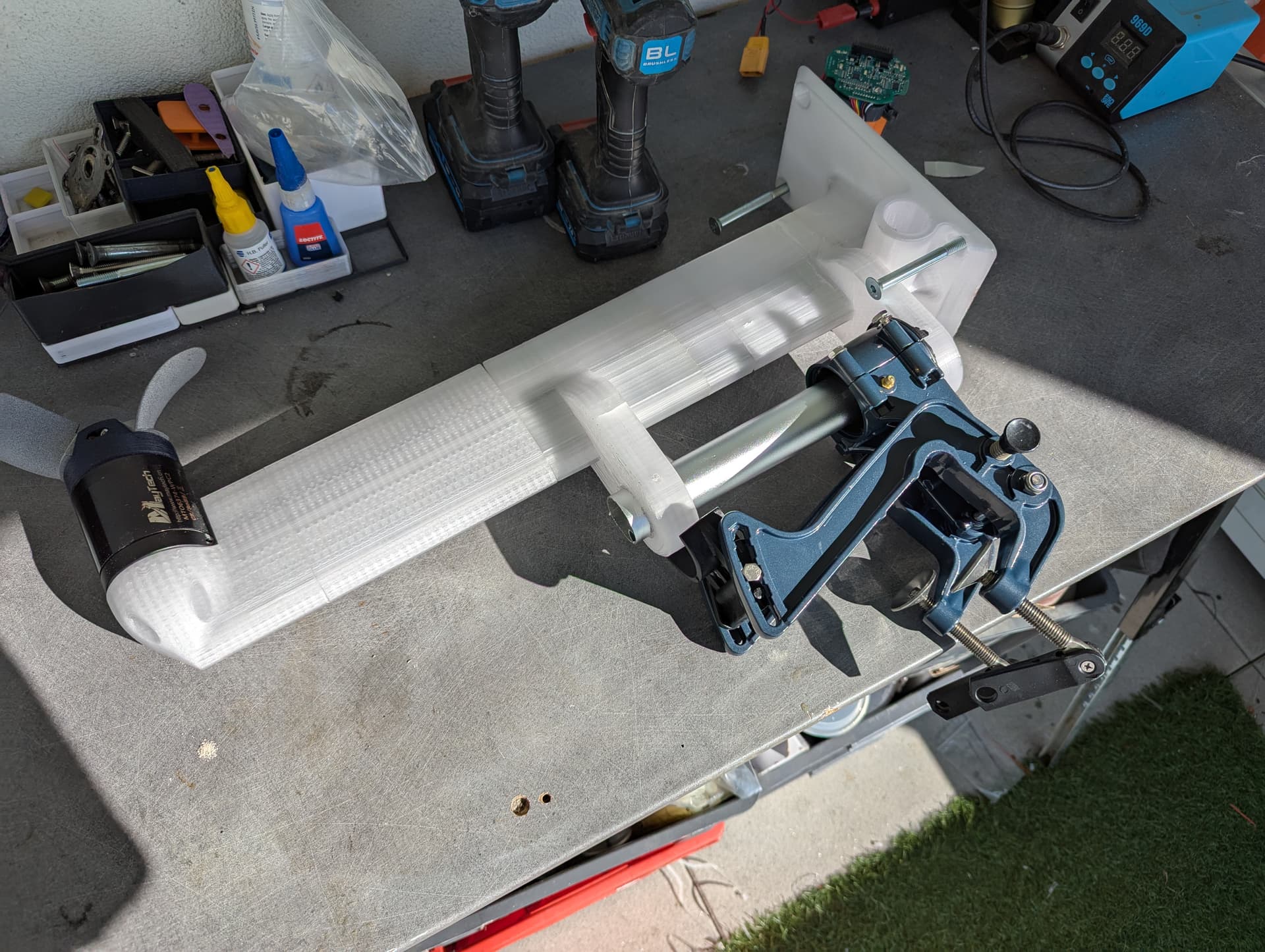

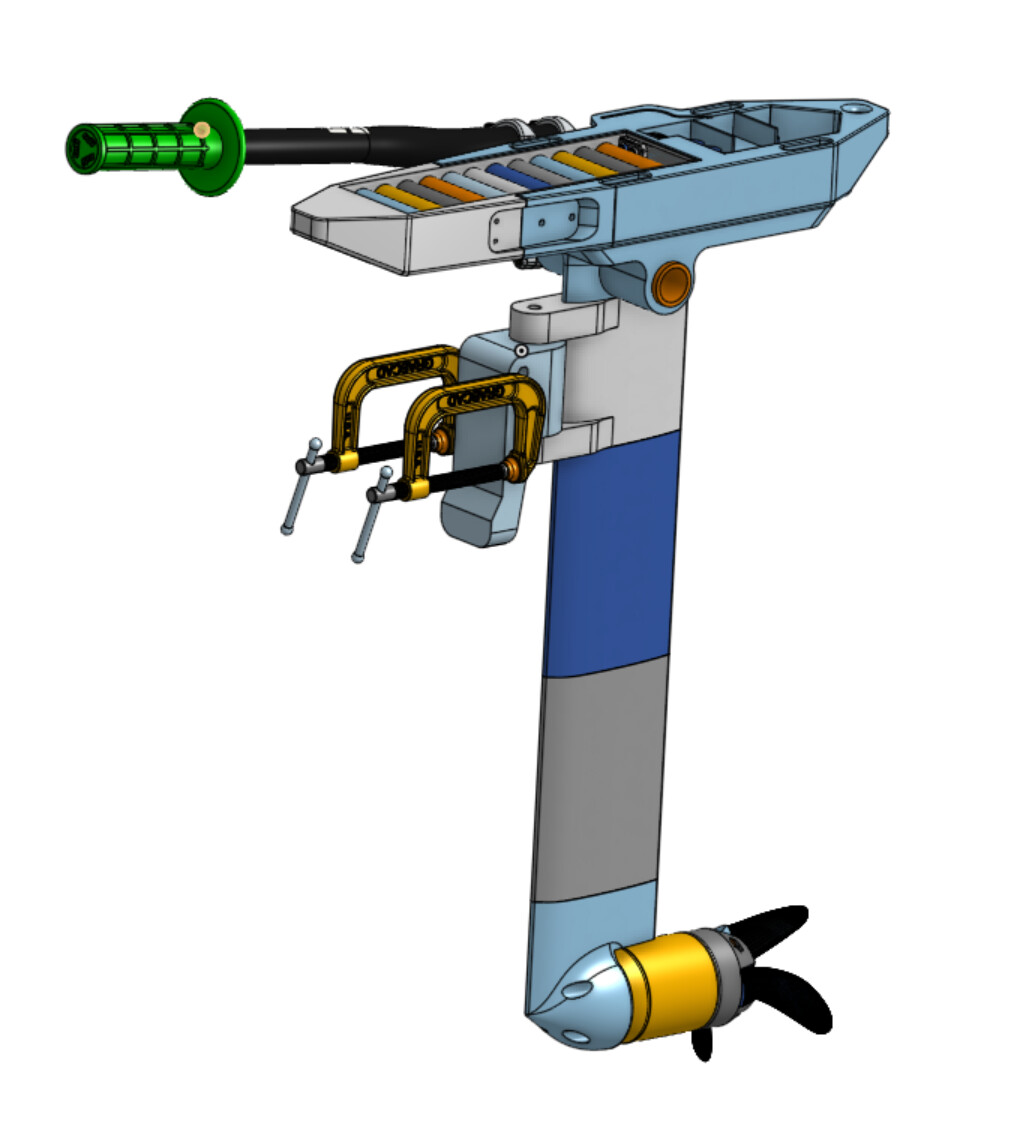

For now I am preparing the assist system integration as a trolling motor to get around on lakes where ICE is prohibited and use the boat as a pump start platform. Using my existing system, bike parts, available 6374 with triblade, minimal investment for a low power (max 1500/2000W) system.

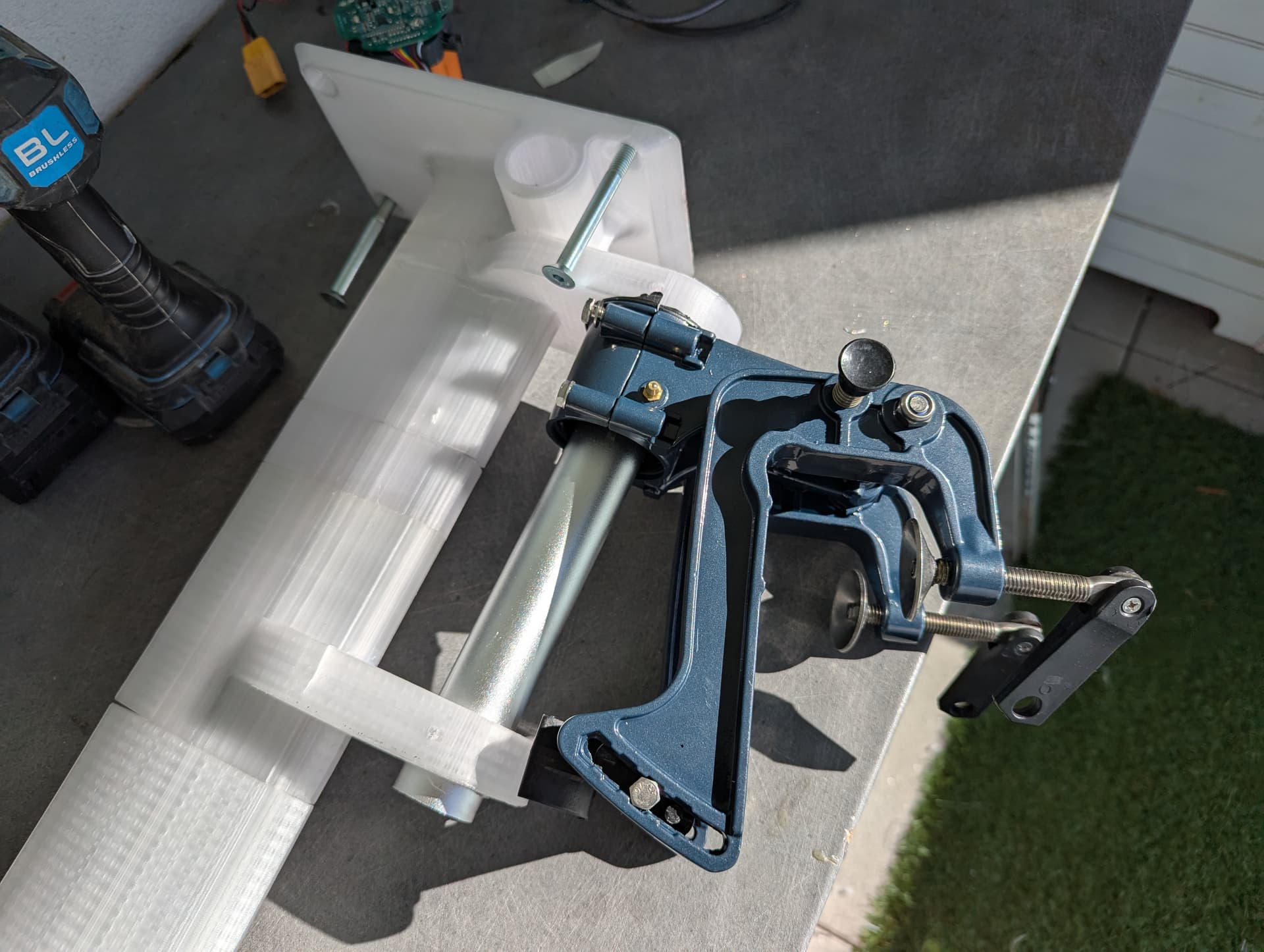

The part I am really not sure about is how to mount the outboard to the transom, any outside ideas would be welcome!
AliExpress has outboard motor mounts.
Maybe with some small modifications it might work for you?
https://nl.aliexpress.com/item/1005005303391890.html
Perfect, thank you! did not find those in my search
Maybe find a used or damaged trolling motor and salvage the mount from it.
Tilt is important as you can leave drive unit on while beaching the boat.

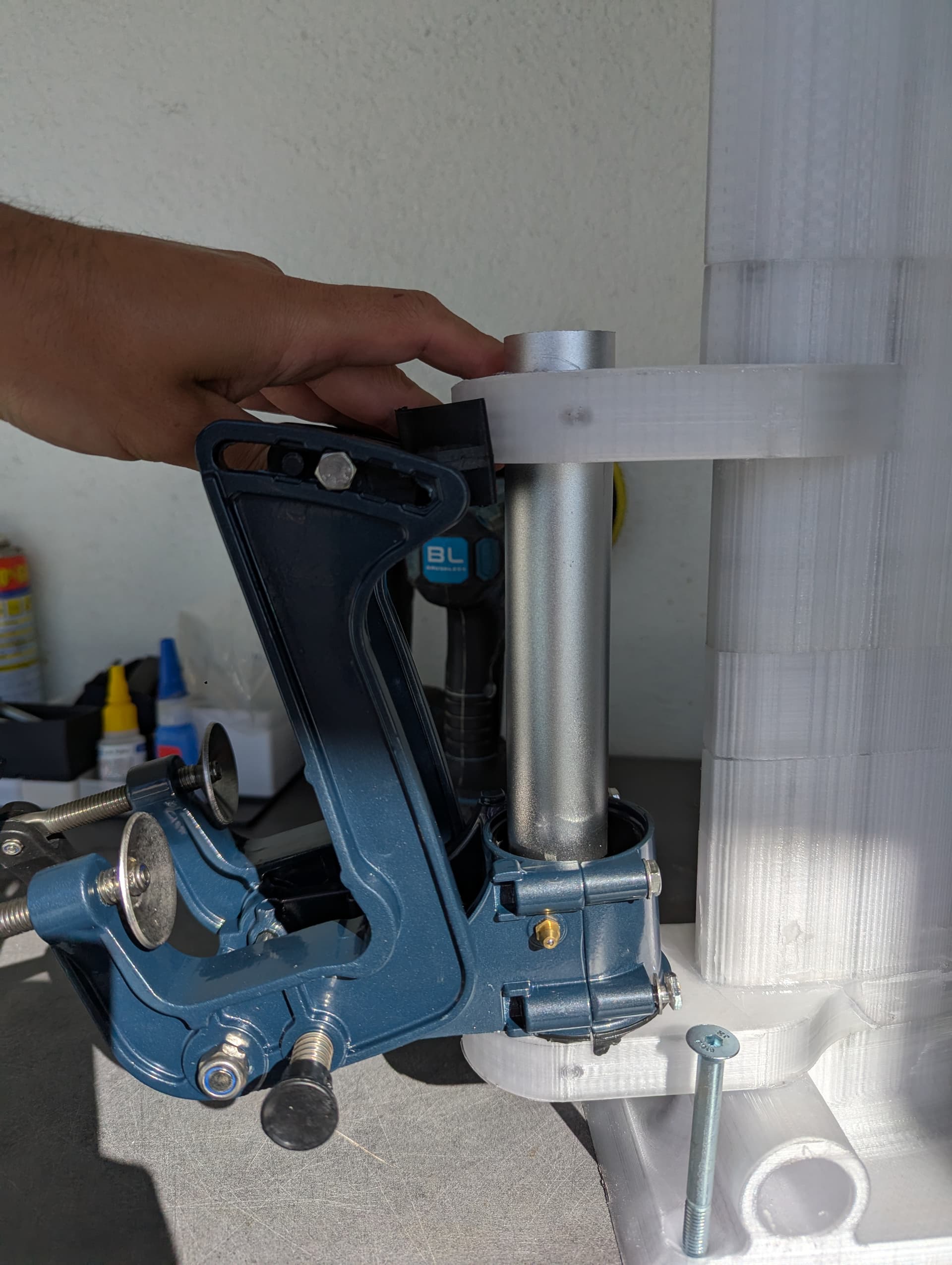

The mount proposed by @kian has the tilt system and adjustment of the motor angle. However I can not figure out or find the diameter of the clamp.
Chatgpt says 68-68mm based on the M6 screws heads, two different photos analysed. Hard to find any info online…

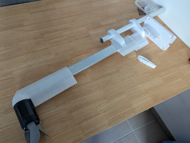

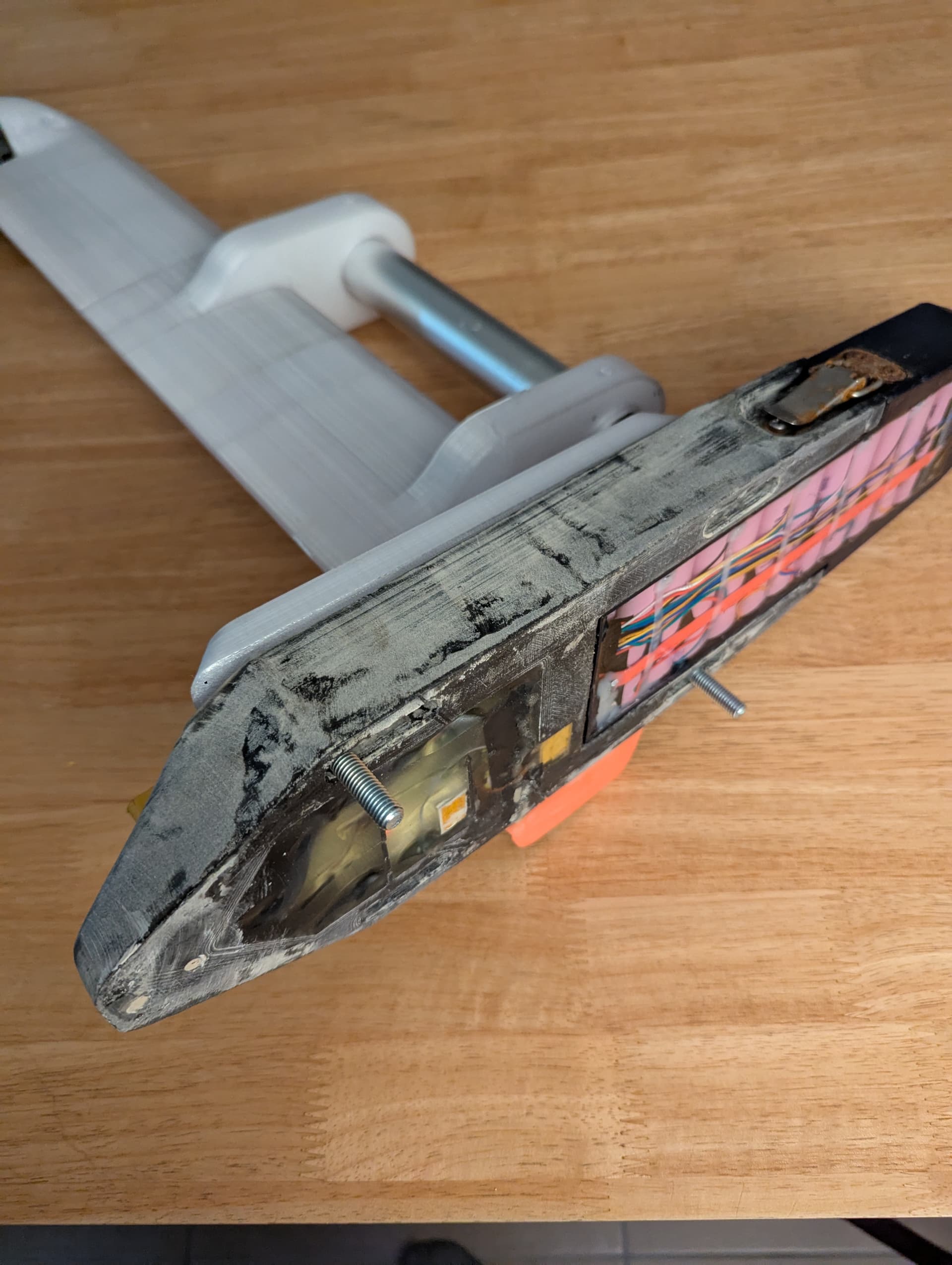

Use with a bigger controller box mounted on top in the future :

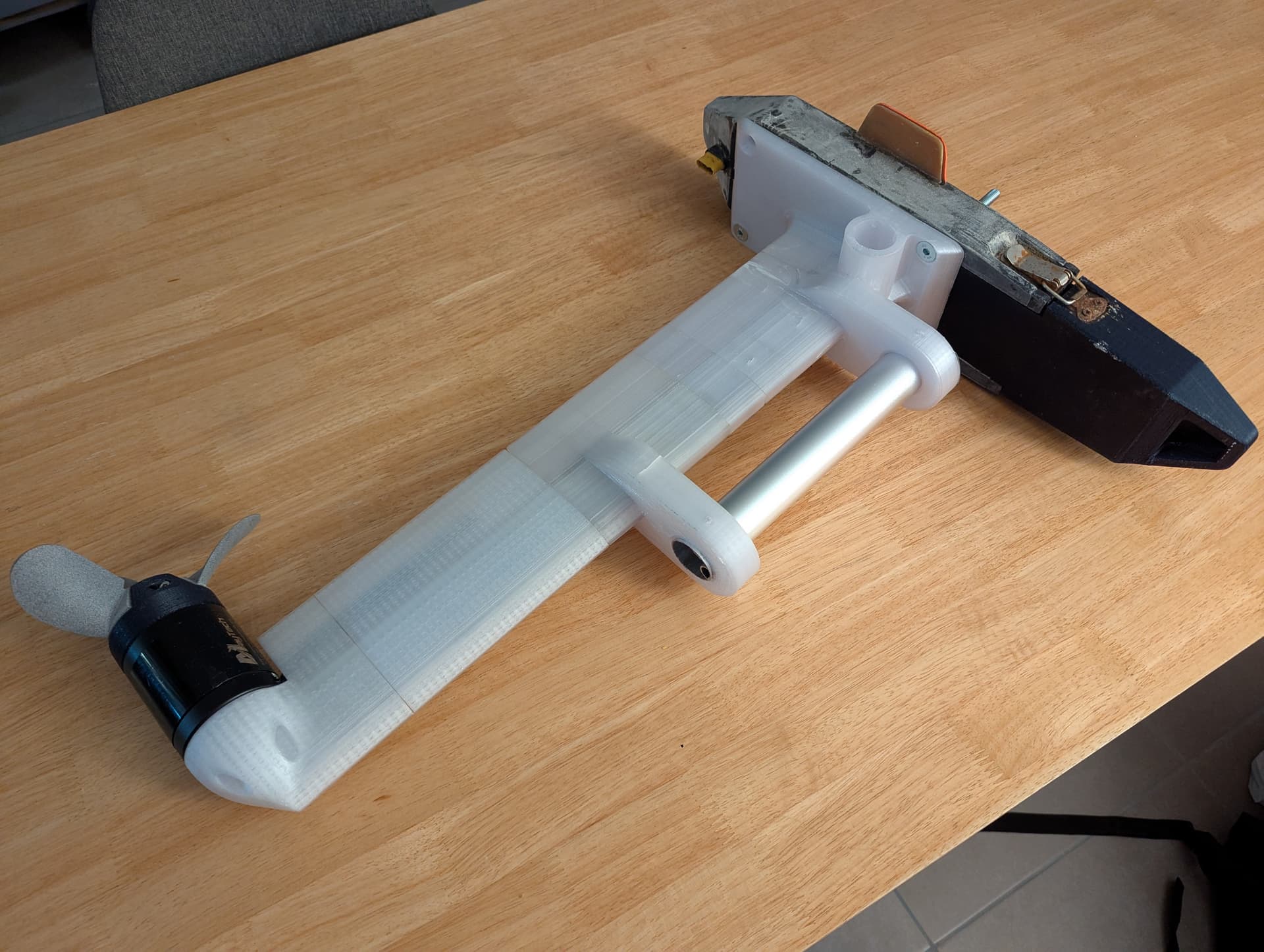

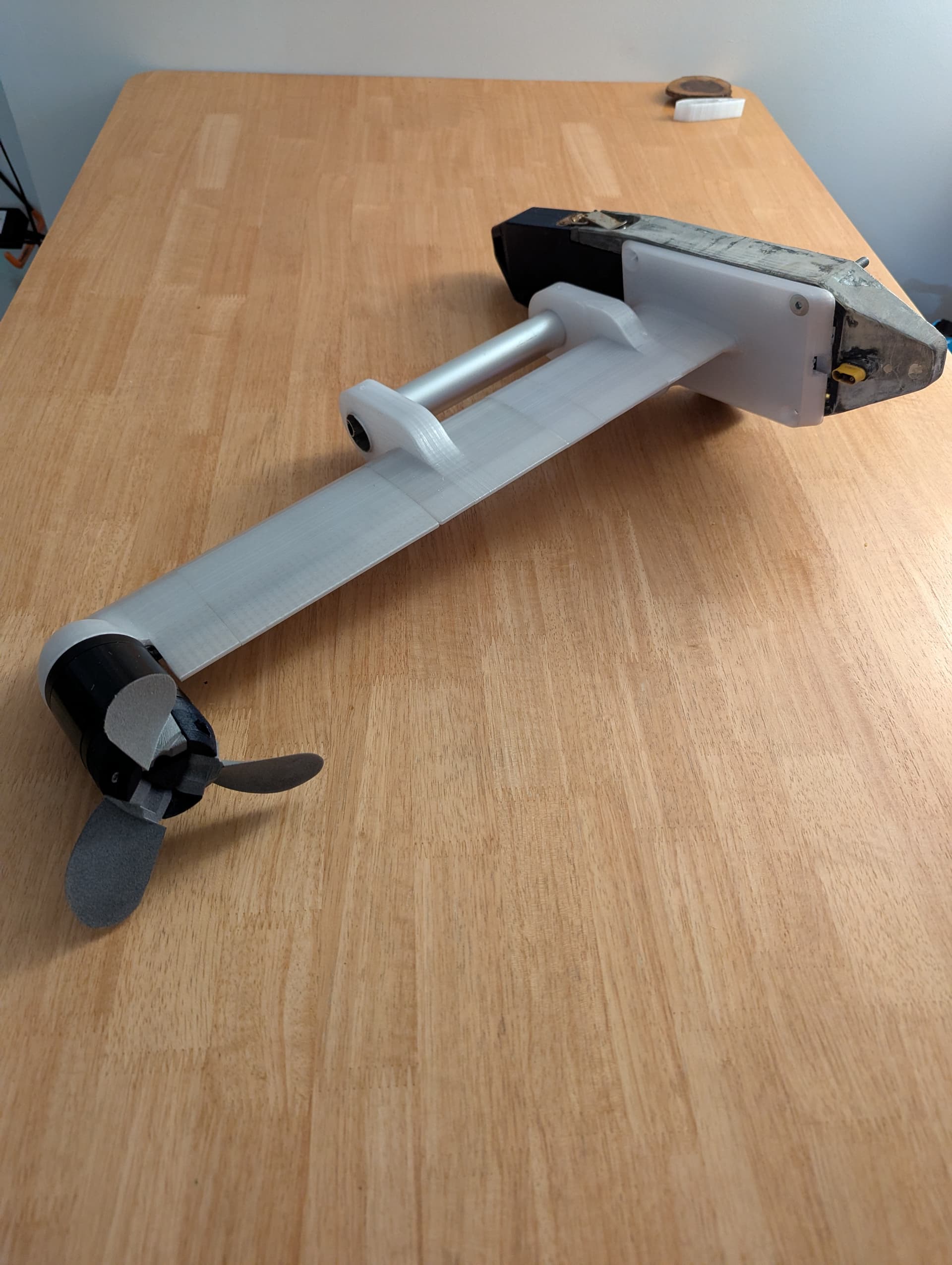

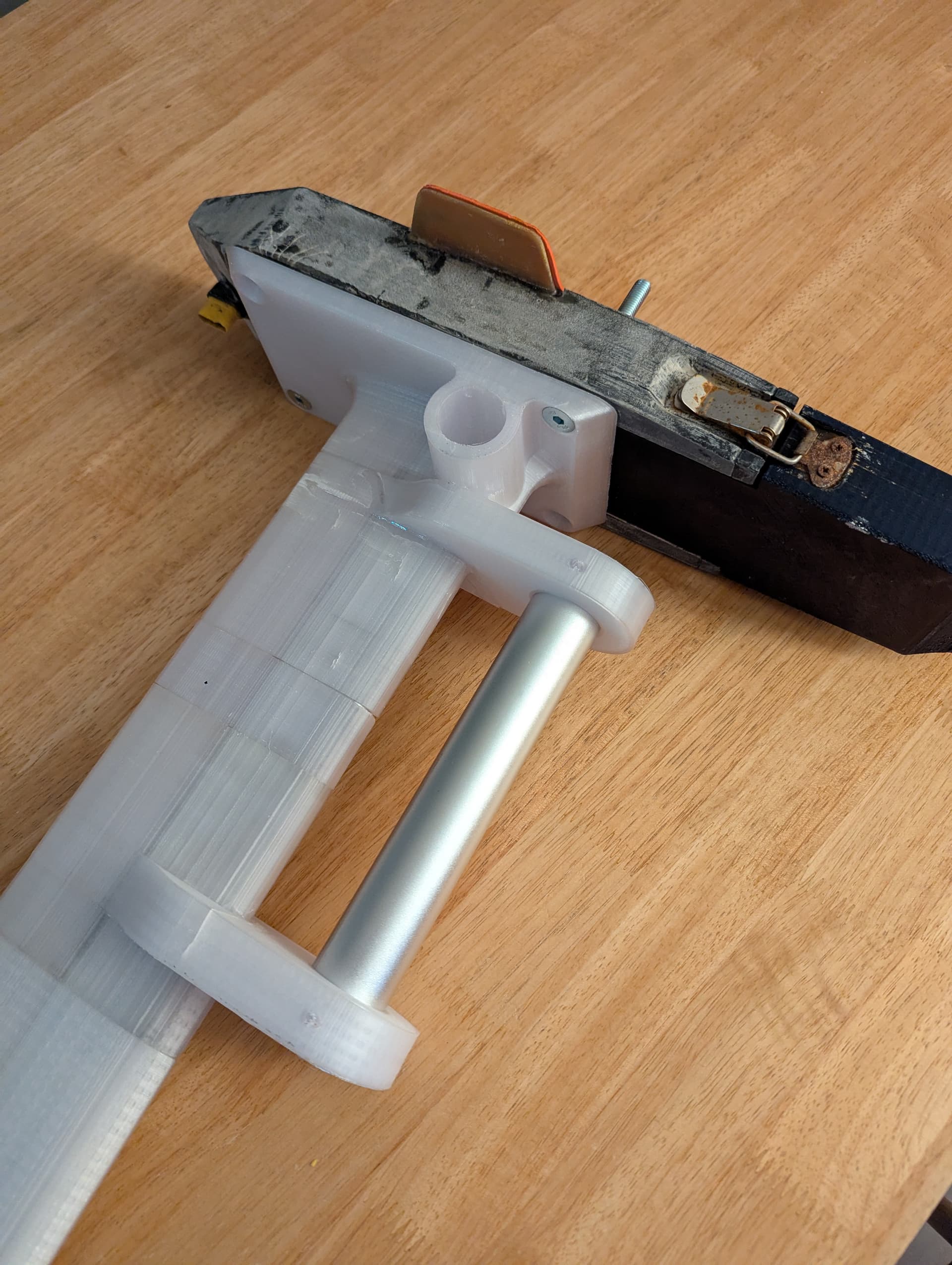

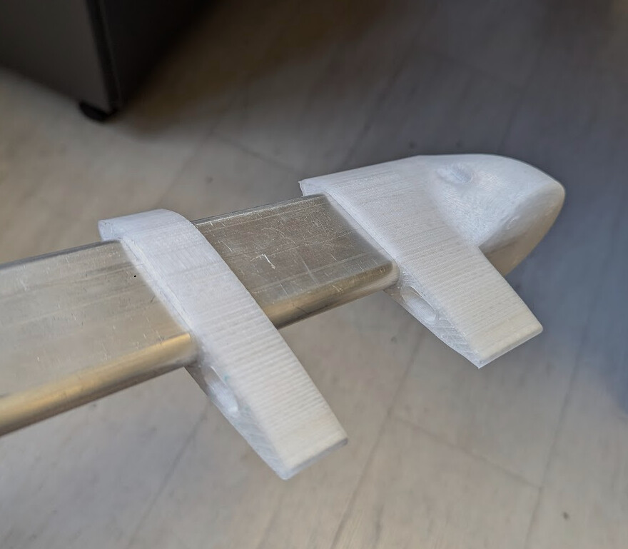

Inside the streamlined profile there is a 50x12x2mm alu profile for strength, and avoid a fiberglass job on the outside.
After manual checks I think the diameter must be close to 50mm, and the length of the mount around 168mm
Adapt the mount
Waou ! Adam Excellent project ! I had the same idea for this summer !!! amazing !
first prints, fits the alu tube but quite tight
Congrats on progress!
