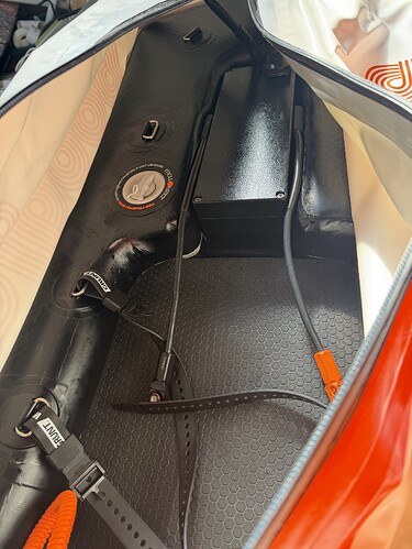

I do…
The main change in the V3 is that the steering system is now built inside the control case instead of using an external actuator.
This switch brings a few practical improvements:
• The Boogie packs down a bit smaller.
• There’s no external actuator, so the PVC is less likely to get damaged.
• Accessing the internals is much easier — four screws instead of the mixture of 14 screws and fasteners used on V1 and V2.

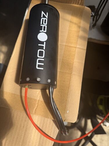

Any photos of the new motor?
Hulls are interchangeable between all version, a few people have upgraded just the hull, but to upgrade the steering requires quite a few new parts and a lot of work and wouldn’t really be worth it.
The motor is custom with extra screws around the front perimeter for durability, as well as a vent hole so that the inside of the motor is always pressurised from the top shell of the Boogie. This should help with water ingress as the motor will never go under vacuum when it cools down.
