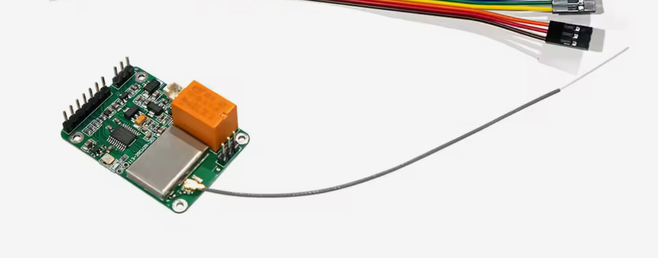

The grey cable with plug is the Maytech original antenna.
Yes. That’s correct ![]()

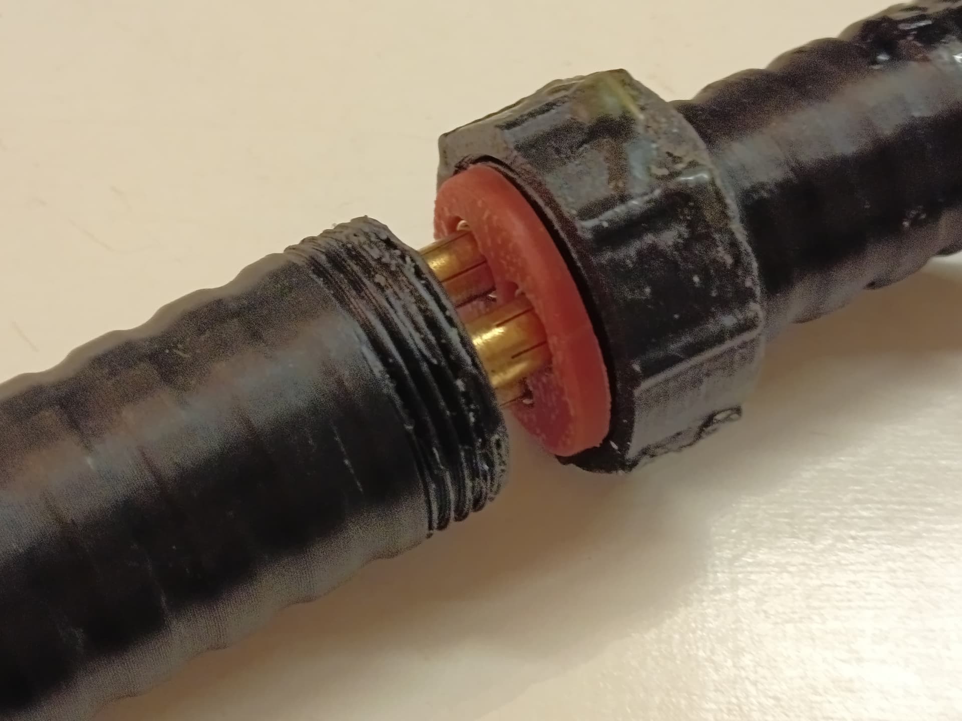

I am using the new LMT-6 plug @hangloose connector on all my builds now.
I am happy with it. I have to “expand” the male LMT-6 plug sometimes (with a small screw driver) to keep a good physical connection.
B)
I only used it in fresh water until now.
Do you have experience in salt water?
Is the isolation good enough?
I am asking because I am on holiday at salt water in a week and don’t want to run into issues…
A:
THX. That sounds good.
B:
I’ve already spent five hours in salt water with my LMT-6 connectors. I haven’t had any problems with them. The gold connectors have never seen a drop of water. So don’t worry and have a nice vacation ![]()

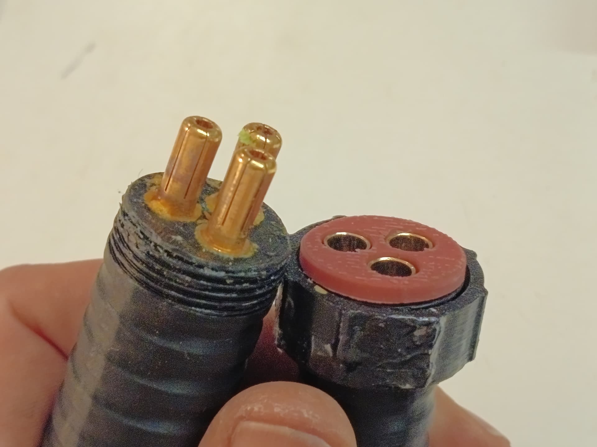

Hi, like your connector- is it possible to get the stl. fot the threephaseconnector? Thanks a lot!
Does anyone know where to source LMT-6 compatible gold plugs in the US? Anything that can be ordered on Amazon?
You can use simple 6mm bullet connectors from AliExpress.
But the cheap ones break pretty easily and of course they won’t have the current rating.
I personally made slight modifications to the stl and use xt150 connectors.
Can you send me a picture of it with the xt150?
Thanks, I think they are a good option for the hangloose v2 plug. I will try them…
That’s a good idea to use the xt150 connectors.
Would you be willing to share the modified STL?

Here is a round “hangloose” plug with xt150 connectors.
