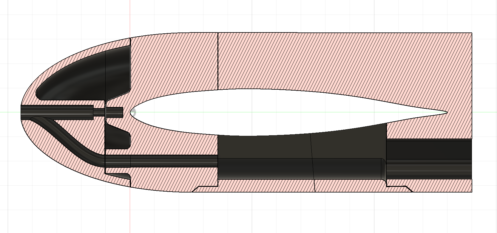

Yeah, I’ll make a complete CAD-model of the foil at first. Alright, I didn’t know about the square/rectangular hatches leaking. Everything behind them will be closed on boxes anyways. You’ve got a point about the price, I just listed up the most expensive parts. A lot will be 3d-printed, and I have the tools.

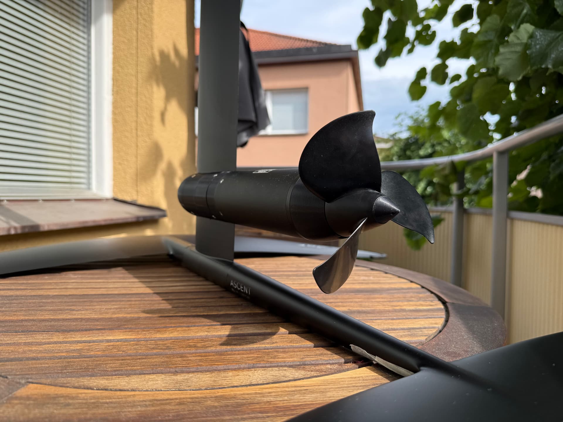

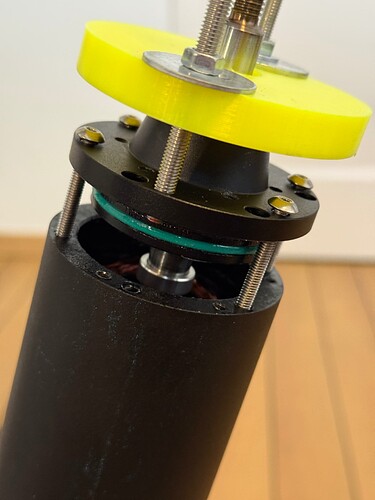

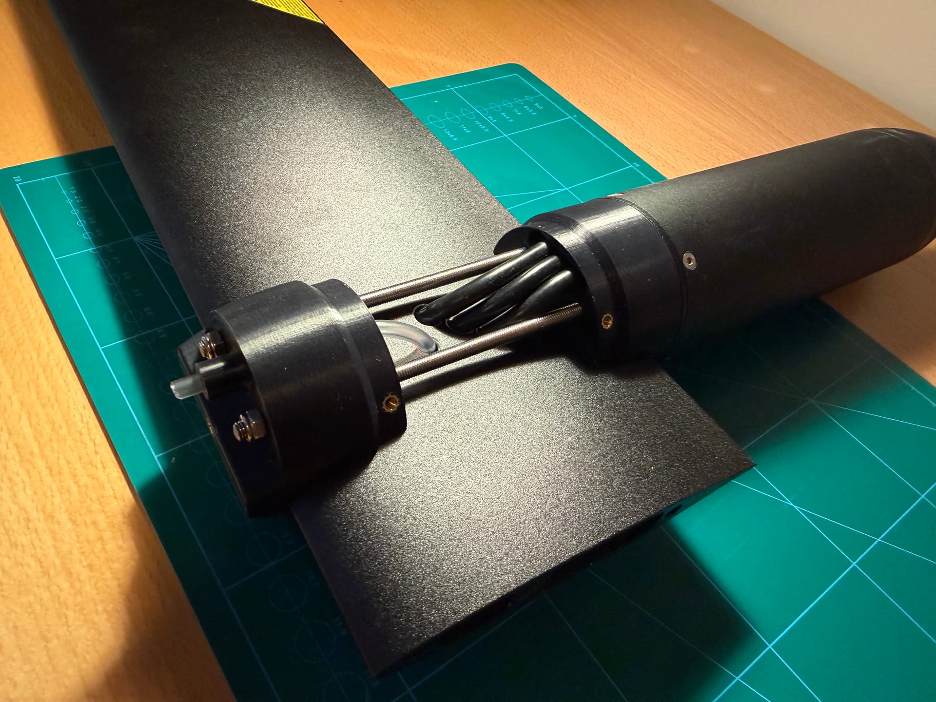

I have designed a spacer from the motor to the propeller, and a tailcone for the propeller. They are precisely streamlined with tangent splines from every edge. There is only 0.5mm of tolerance between the propeller and the spacer. I hope that they will not contact under load. The spacer is mounted with three M4 screws. The tailcone is designed with a thread for the flipsky shaft and has a hole for easy screwing.
I had to buy a propeller puller tool because my propeller was drilled out with a 11.9mm drill instead of 12mm.
Everything is printed out of ABS except the propeller pin spacers, which are out of TPU.

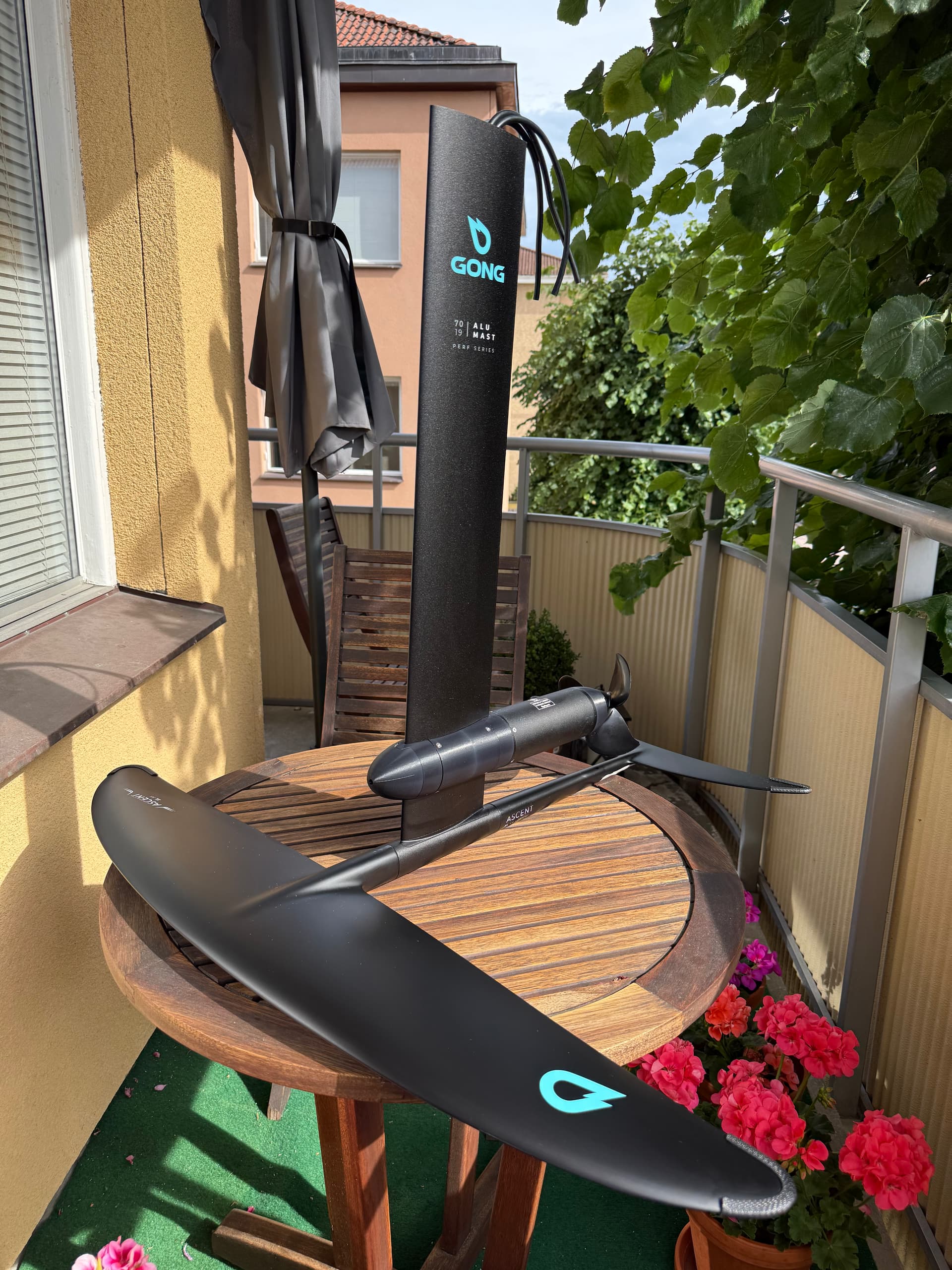

Gong Ascent V3

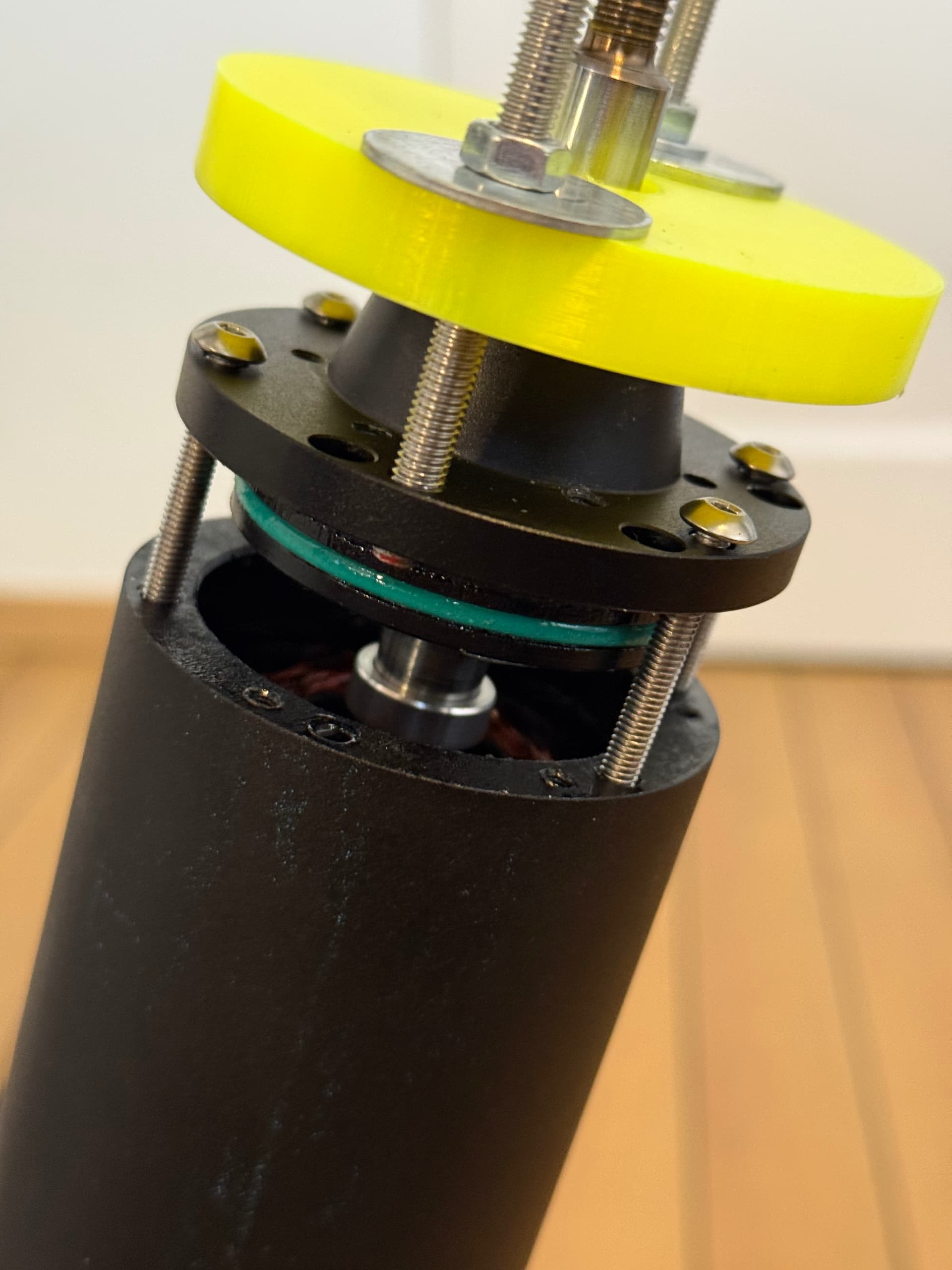

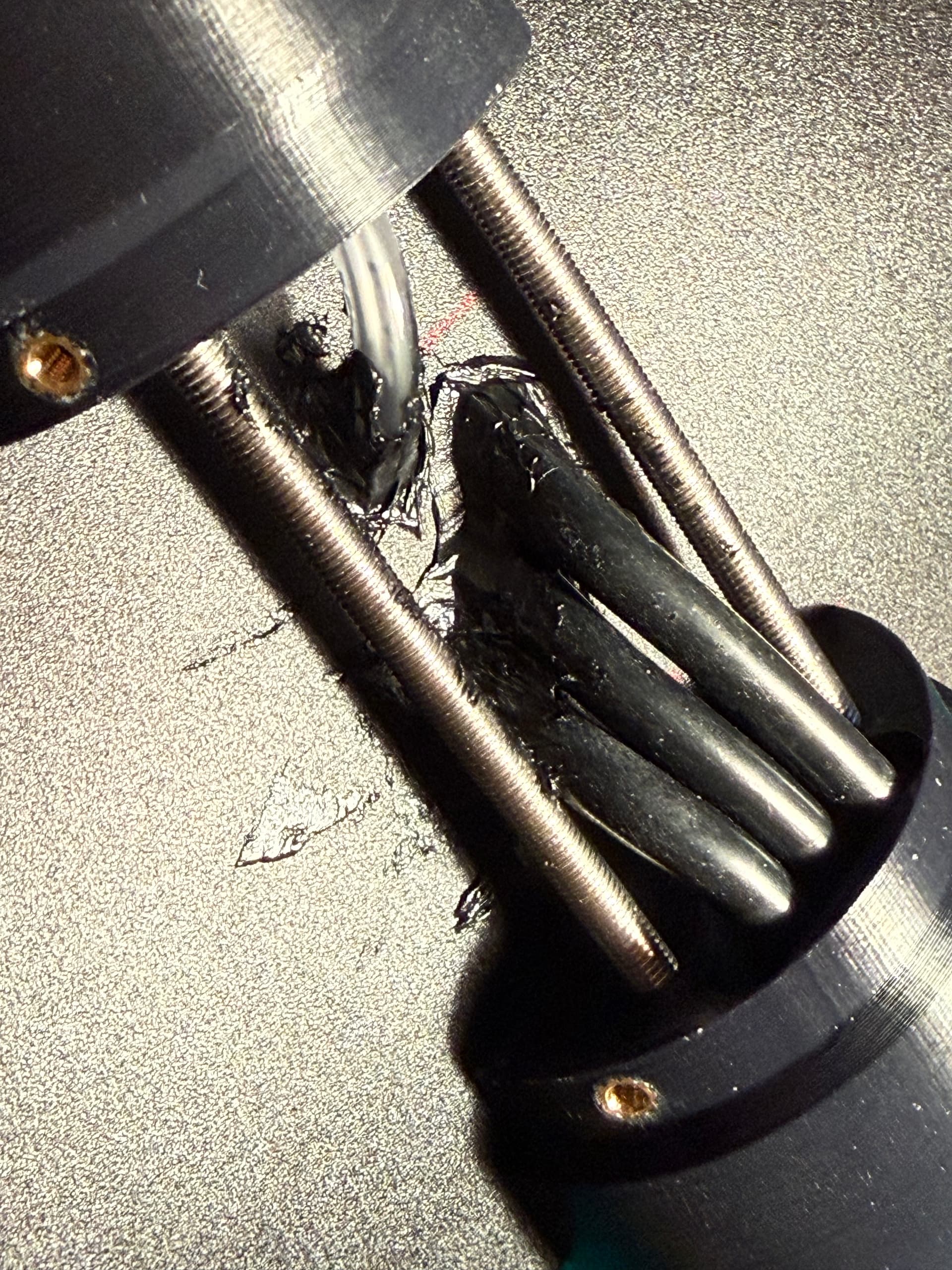

A motor mount that clamps to the mast was designed. It is assembled with 4x M5 A4 threaded rods and nuts. The nose cone has a screw hole combined with a water cooling channel. The side hatch is secured with 4x M3 countersunk screws for easy access. The assembly was printed in ABS with 4 perimeters and 30% gyroid infill.
Four holes were drilled in the mast and sealed with SikaFlex 291i.

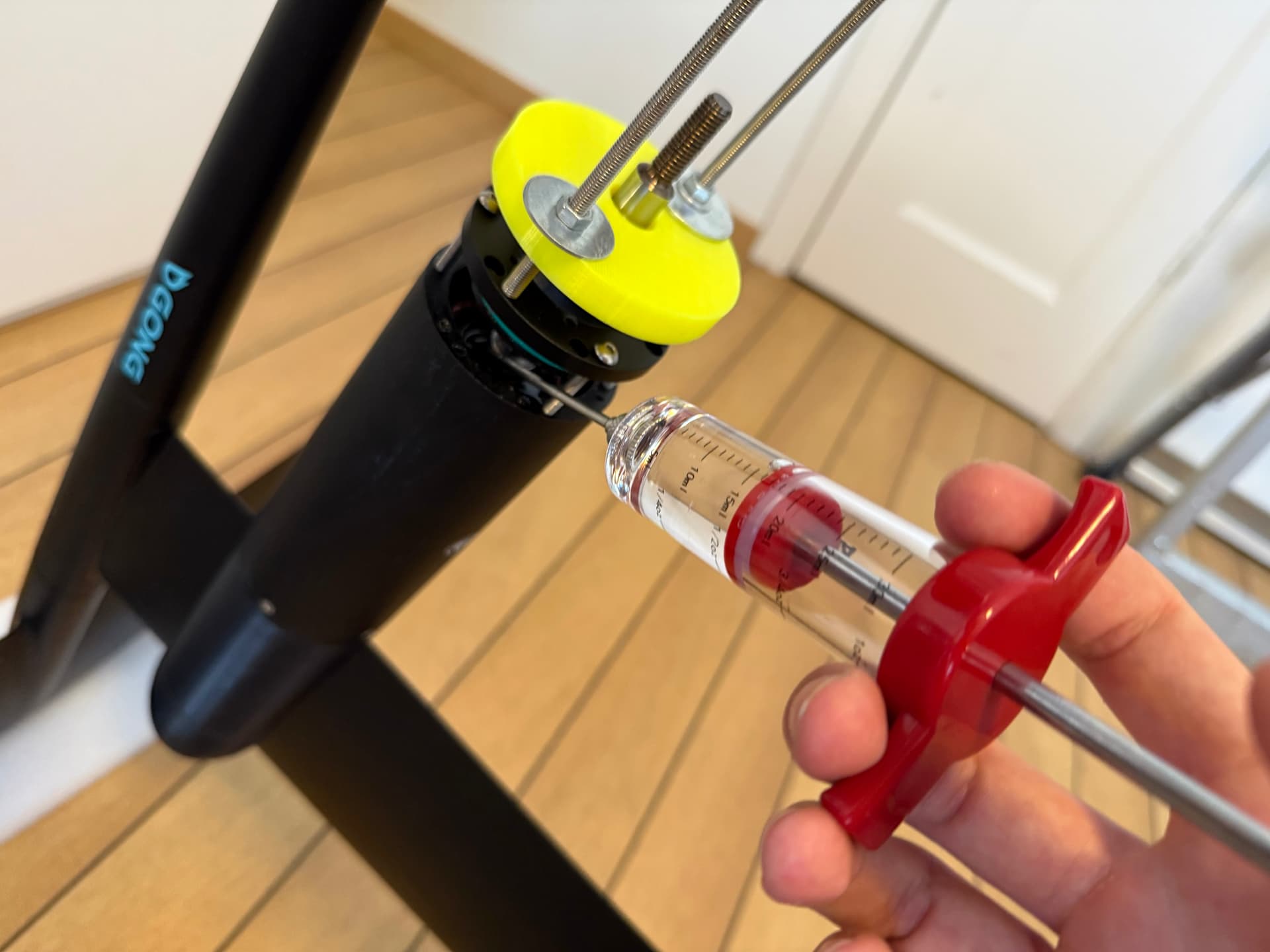

I filled the motor with 70ml of paraffin oil using a meat injector.
