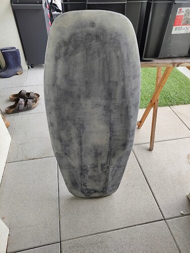

First step of sanding done, now wondering what kind of finish I will go for, for a change I have plenty of time before riding it :wink:
Filler coat (2 colors) + sanding + varnish
Or
Thick hot coat + sanding + polishing
1.320gr on the scale

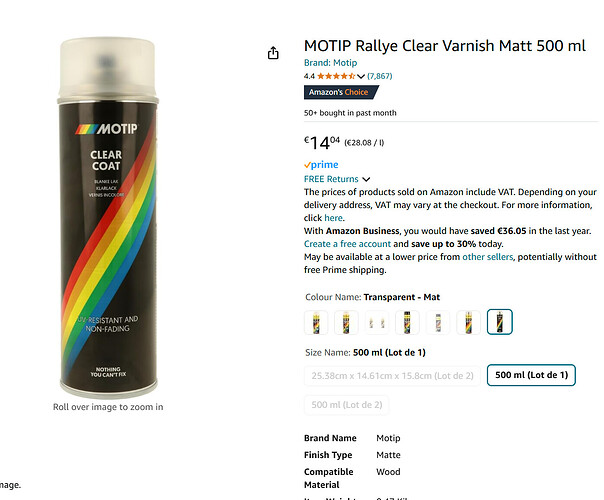

Did not find some PU varnish, what about this stuff?
The brand is well known.
https://www.amazon.fr/-/en/dp/B01DT5DWW0/ref=sr_1_6?crid=3VTR7LCJZKGH5&dib=eyJ2IjoiMSJ9.KGokfpGtHsWGt8g_7BTBTDsNWpkY1AfQx64L_H0eutkng8PX8LsAWgN8P6DRGtaQyEKWkIK5eHMO_svLdXkNj12BWj_NuYLYtH9t6-IZV5q27K8Vz7wisCHjMF9f2PqG07sCjb1dz-j9gLy5I2hClJhZazUKREe3gWLwpoJz2iG48e_548bSCtGP0uBF6PF63D7s1LIJvV7LI6GklRZEvPfkqS9Fe5w0WmOW0fx8-XXTfHFiHRwqIQI-_C6Fg7ql5RtywNcY8TyCSrLYOkYMNiDARNKWV1PXLjO89jcoqgU.wty4aWIYoH0xELKdiJNyjY8rbt6K2nvaE86Dl5E1NQo&dib_tag=se&keywords=vernis%2Bpolyuréthane%2Ben%2Bbombe&qid=1733773744&sprefix=vernis%2Bpolyuréthane%2Be%2Caps%2C213&sr=8-6&th=1
I used this one I think.
https://www.amazon.ca/Rust-Oleum-Painters-Touch-Ultra-Cover/dp/B081FLRQM5/ref=asc_df_B081FLRQM5/?tag=googleshopc0c-20&linkCode=df0&hvadid=706725384225&hvpos=&hvnetw=g&hvrand=2580250063107898710&hvpone=&hvptwo=&hvqmt=&hvdev=c&hvdvcmdl=&hvlocint=&hvlocphy=1002310&hvtargid=pla-2268857800926&mcid=7d3617230ab93e8e9a9317c57e9ae0a5&gad_source=1&th=1
But this one is even better.
the actual cheapest option I might try :joy:
I think a 2 component one is always better for outside use. I think you can use 2 component car clear coats on acrylic base

Did the fill coat to train on sanding/getting a clean surface finish
Plan is sanding then simple varnish.
Bottom fill coat done, opened the holes, cut pad to lenght, final weight will be over 1.5kgs, approx 1.6-1.65kg with pad.
Will see how it turns out after sanding, to know if the surface finish is worth the extra weight.
Mounted the mast to test, seems mega rigid. This board is 10mm thicker than my first pump board, has less carbon but better core and stringer.
Had a long sanding session on the dw, as the top coat was not super smooth and some wrinkles were still present. It was also white/cloudy due to some humidity in the epoxy, I used the board less than 24 hours after the last epoxy. I will apply a new clear coat after the sanding.
Sanded through the CF on the nose area :melting_face: Did some CF patches.
Sanding.
I will do another round with the vibration sander, then clear coat and pad :ok_hand:
