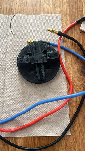

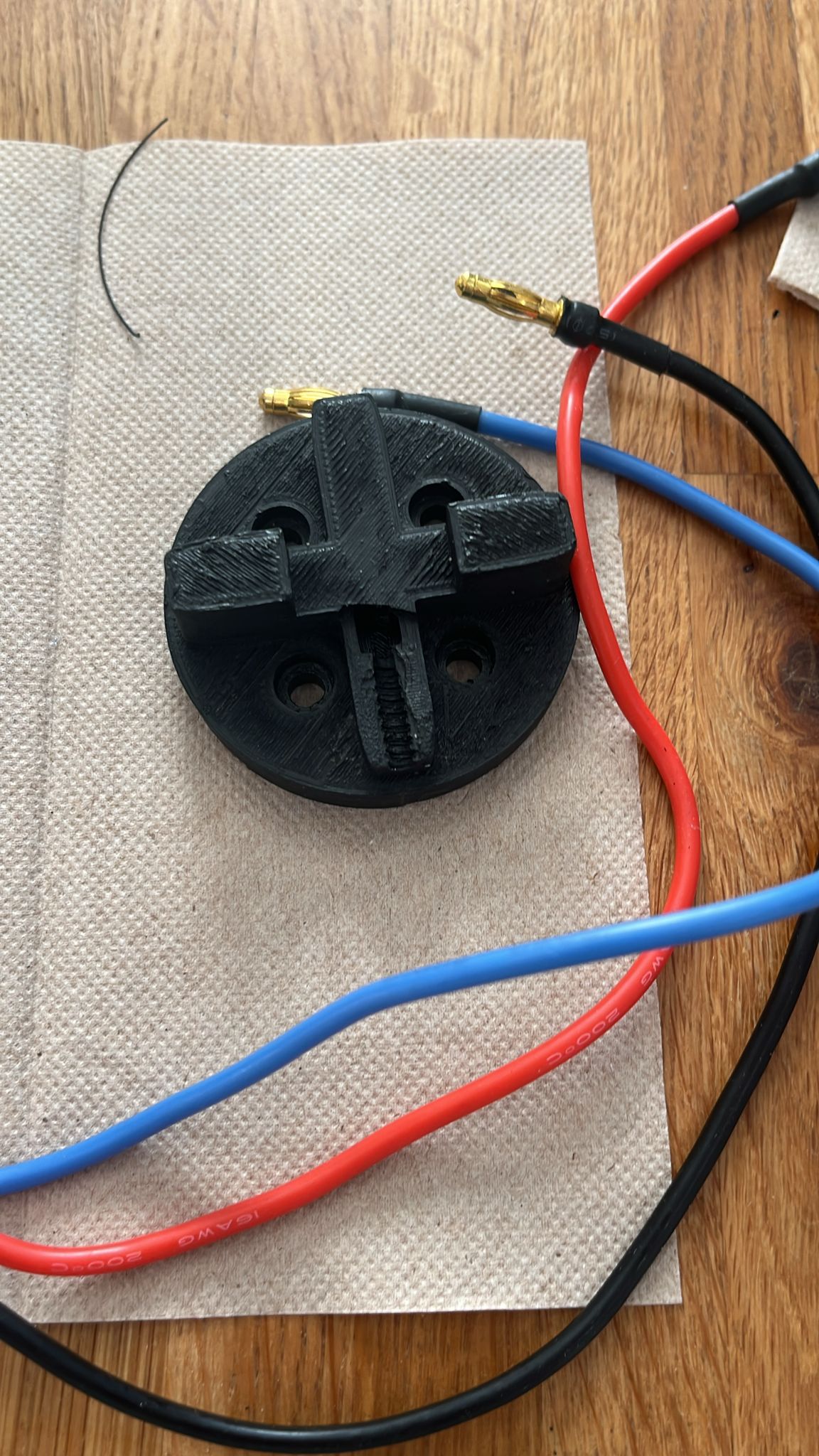

Where did you get the stl for the slingshot mount. I have PETG CF and a Bamboo printer.
It’s my own Design:
Does anyone have a file for this motor mount? It’s for an older 6384 mount, and has the 4 screws from the side to attach to the mast mount
