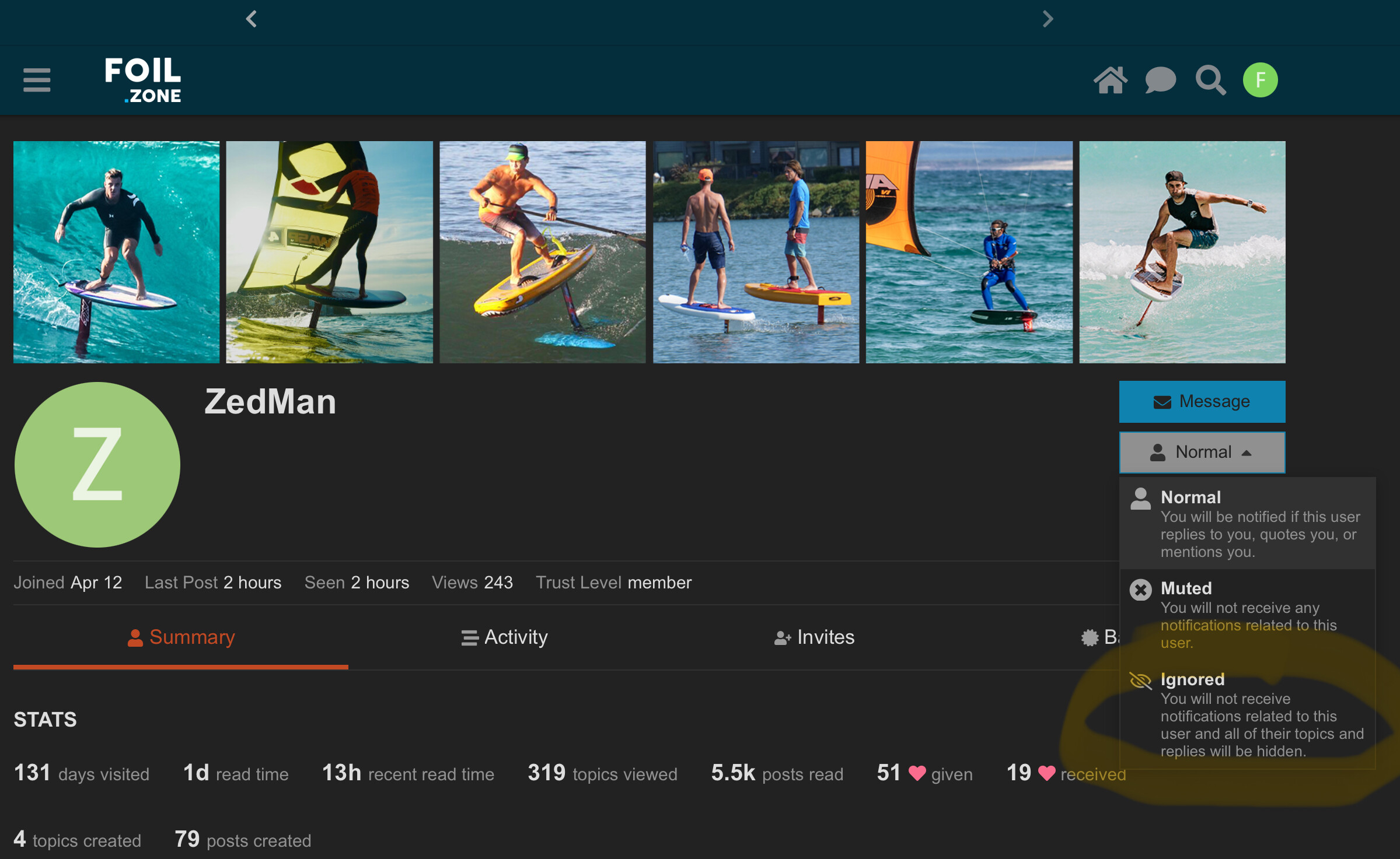

@ZedMan
You don’t seem to be taking in the feedback so……
Well said!
