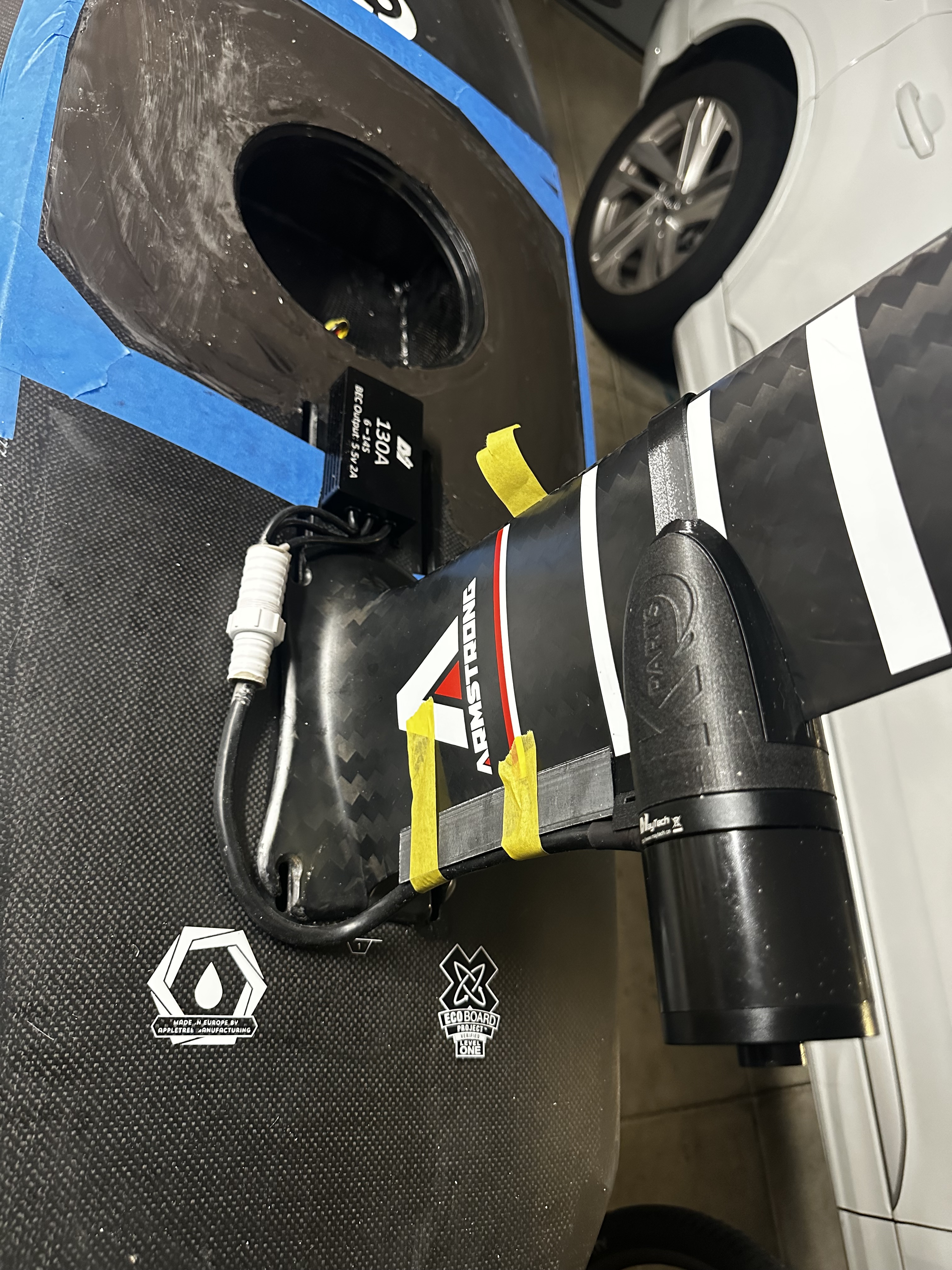

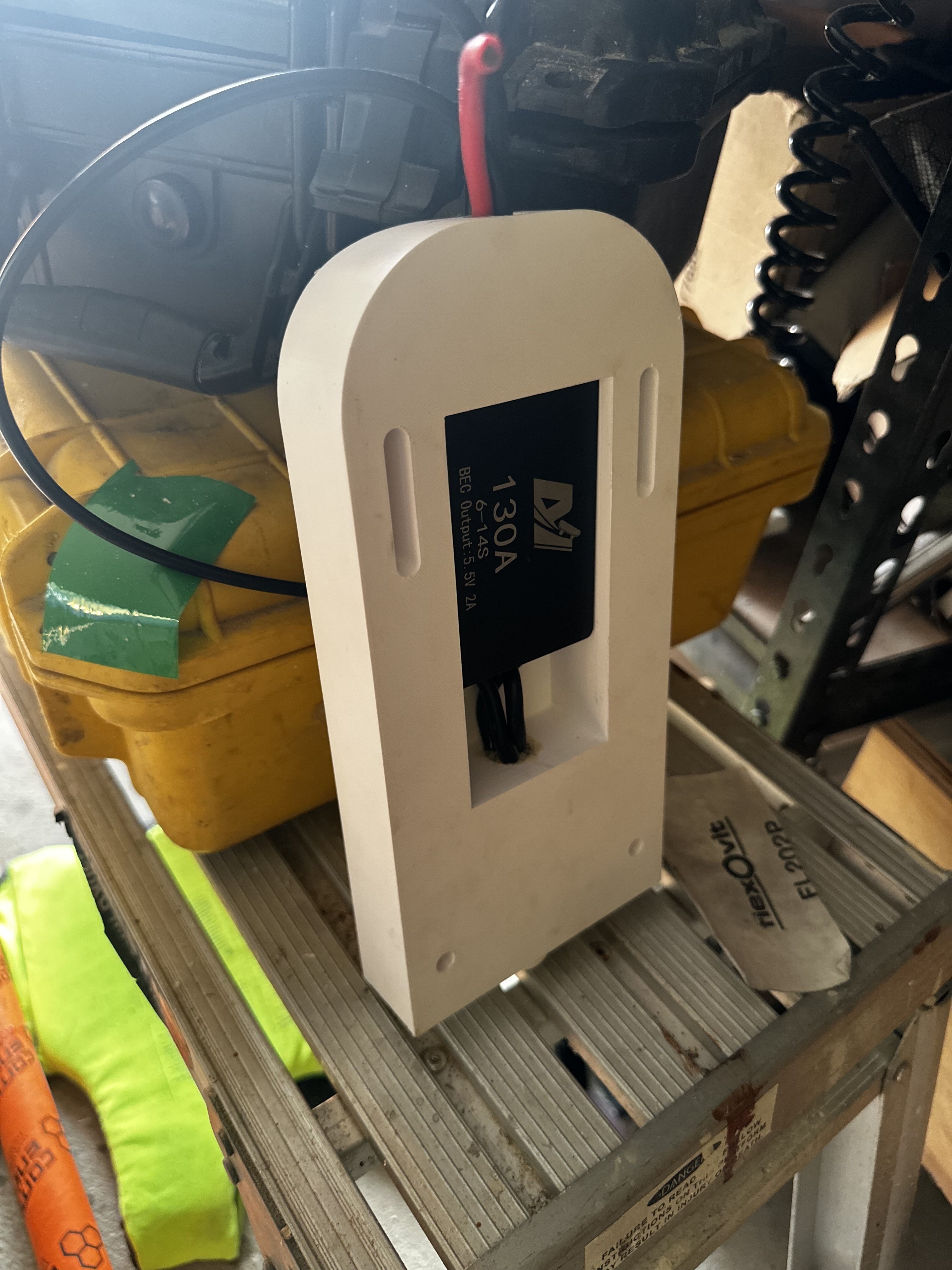

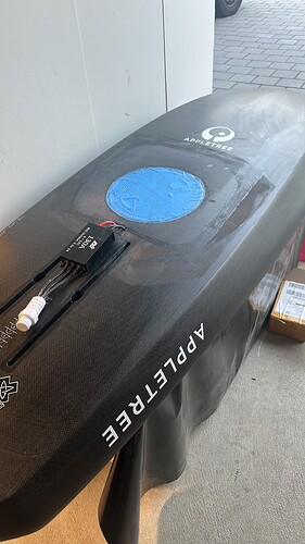

I think that’s it what you’re saying. With my 160amp setup I’m 95kg he is 80kg I have a Ha 980 on a 80l board 2bladed flipsky prop. I’m riding around a lot faster than him. But with my 130amp I’m on same 80l board on my Hs1550 foil slower and getting better run time. This is my back pack setup must be loosing efficiency due to long 2m 3phase wires.
Now I’m putting battery back inside my board again to get rid of cable. I need to improve my riding and pumping so I’ll try the 130amp on the HS1550 and I have a APF1880.
