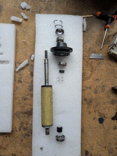

Sorry for reviving this old thread again, but my dad and I took a 65161 apart for some “maintenance”, and lost the order of the sealing part (we did make a note of if, but kind of lost it).
Anyone here who can verify if this (see pic) is the correct order?
Obviously the “lid” will go after the bearing, and than the rest will follow.
Thank you.
The space is in wrong pos
I was afraid of this.
I guess that we will need to open the motor again :frowning:
@Kian
If you could post another photo of correct assembly for future reference I and likely others would appreciate it.
This should be it :crossed_fingers:
From right to left.
Spacer > bearing > cover > ring (with inner part a little bit thicker, facing to the cover/bearing) > stationary compression sealing rubber (springpart facing bearing) > rubber ring (white ceramic facing stationary compression sealing) > flat washer > retaining ring.

My dad just did some more motor’s and took this picture for reference.
Maybe it’s of some use here.

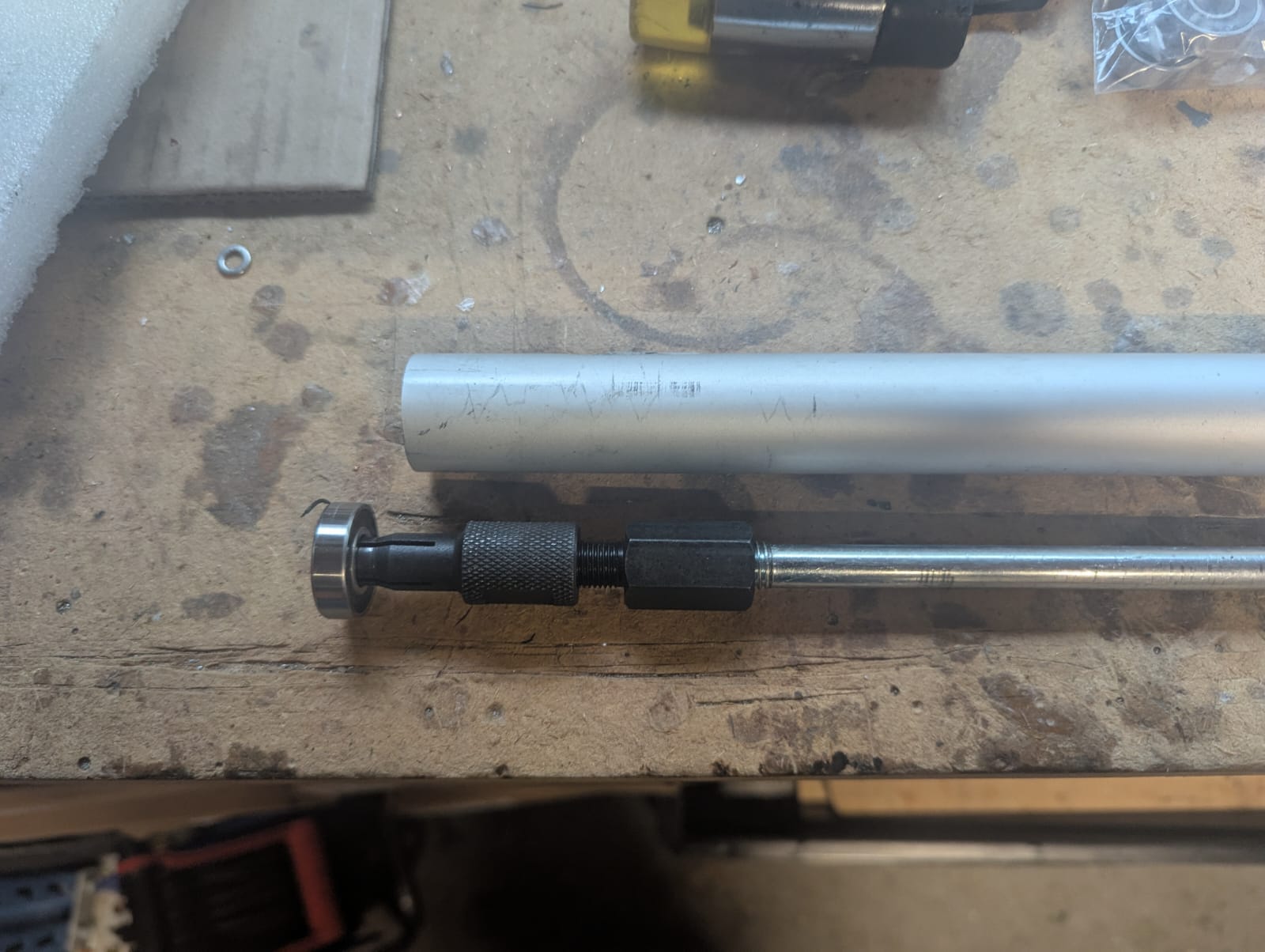

Removed the back bearing with a puller but then realised, it’s not easy to put it back in. Anyone has an advice how to put back the bearing?
We use the “puller” again to hold the bearing and roughly align it at the bottom.
Once in place, we use a longer aluminium tube that slides over the “puller” and sits nicely on the rim (the outer ring) of the bearing.
When everything is aligned, we use a small rubber hammer to gently knock the aluminium tube what is sitting on the bearing into place.
:warning: Make sure you only knock the rim of the bearing!
Another way (but not really good for the bearing) it to fix the bearing at the end of the shaft (don’t forget the spacer) and try it that way. You might need some shims around the stator to keep it centered.

This definitely feels like the right way to do it.
But since I don’t have a longer tube that’s the same diameter as outer bearing ring, I used the second approach. Everything seems to work after putting the motor back together.
