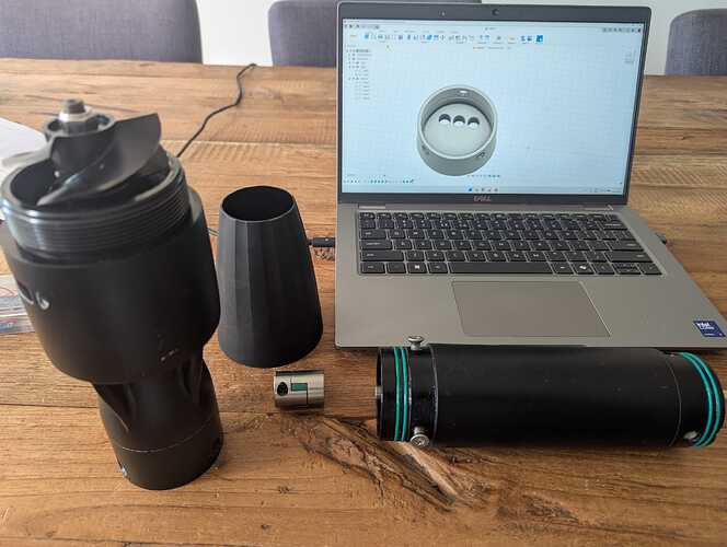

I cobbled together a way to mount the drive on the same rig I use my Flite prop on.
I use a 10S11P battery pack that a number of us use in our Fliteboard based setups.

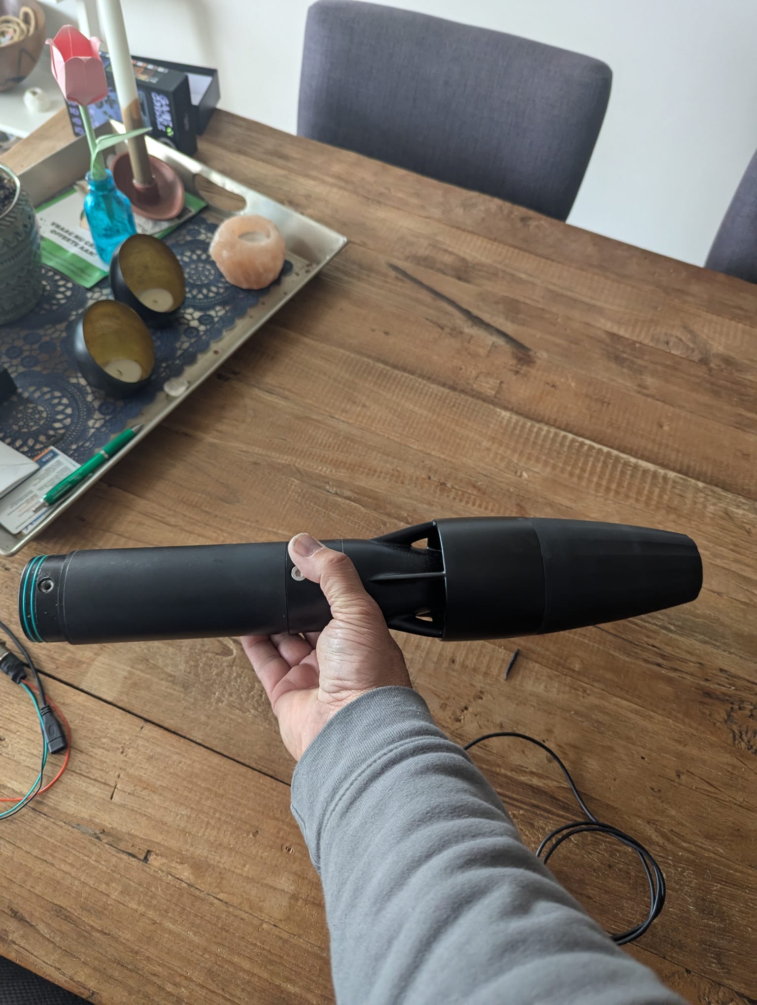

We have a JetWave motor (and jet) here, and measured just under 12000 RPM on the motor shaft at 12S (that is around a 270kv motor I guess)
Jetwave is using no gearbox.

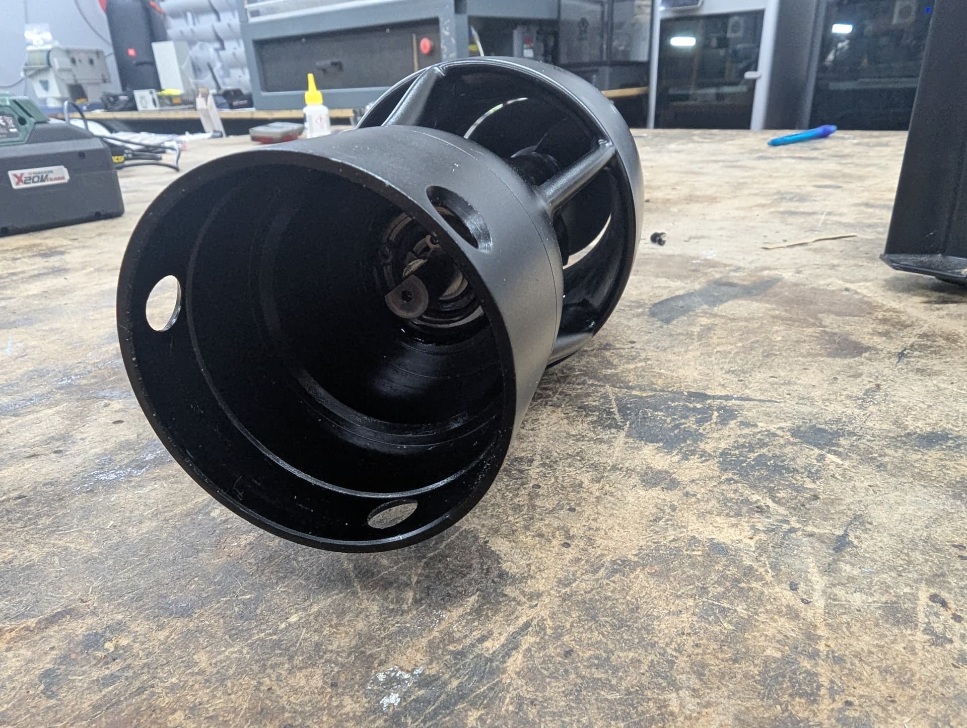

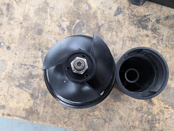

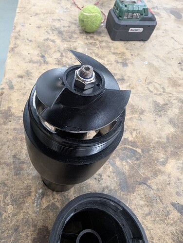

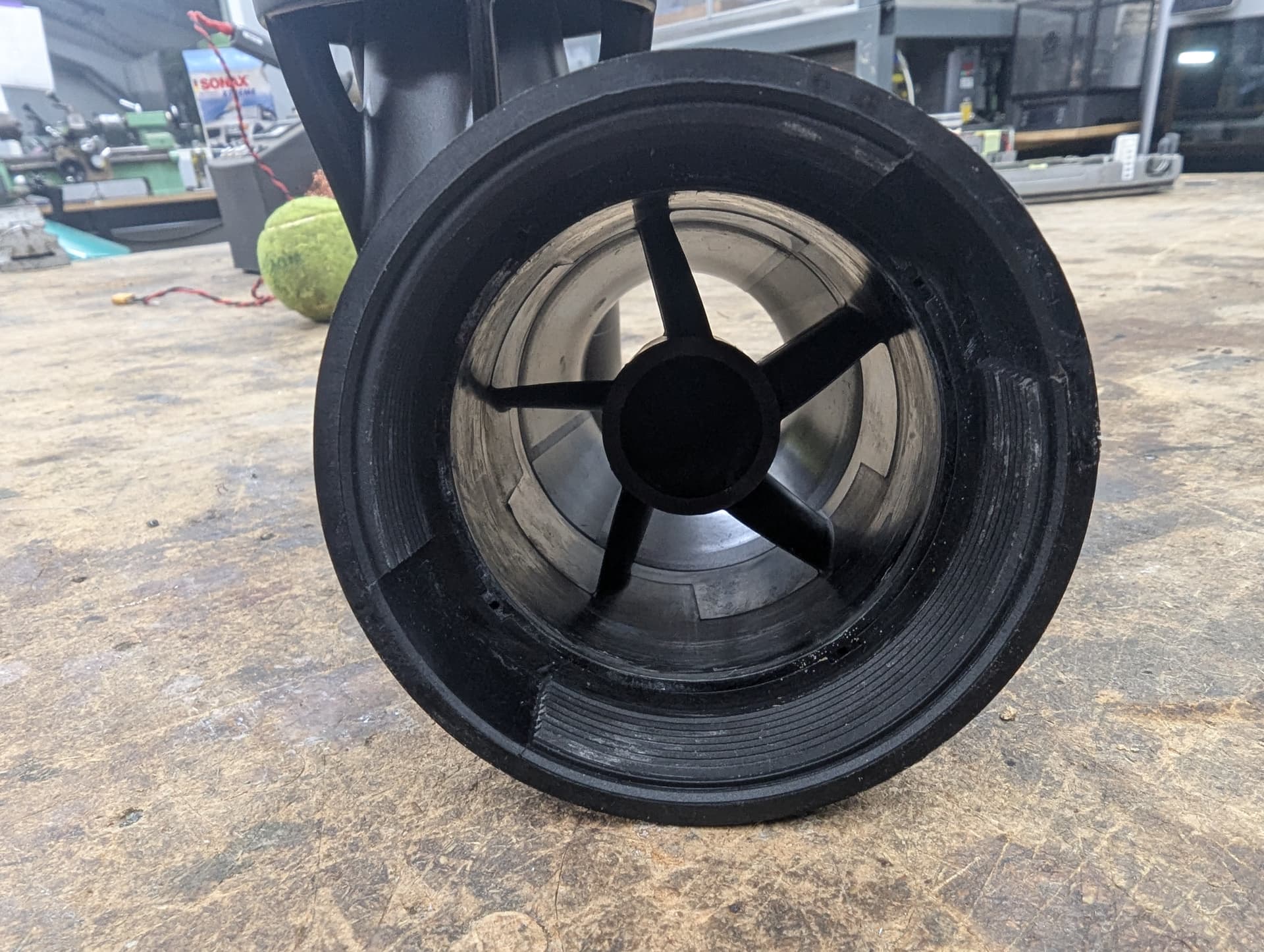

We testes a 65161 120kv motor on this jet, but did not even come close to enough speed.
No as its just a small diameter prop fully ducted. Its not really a jet at all.

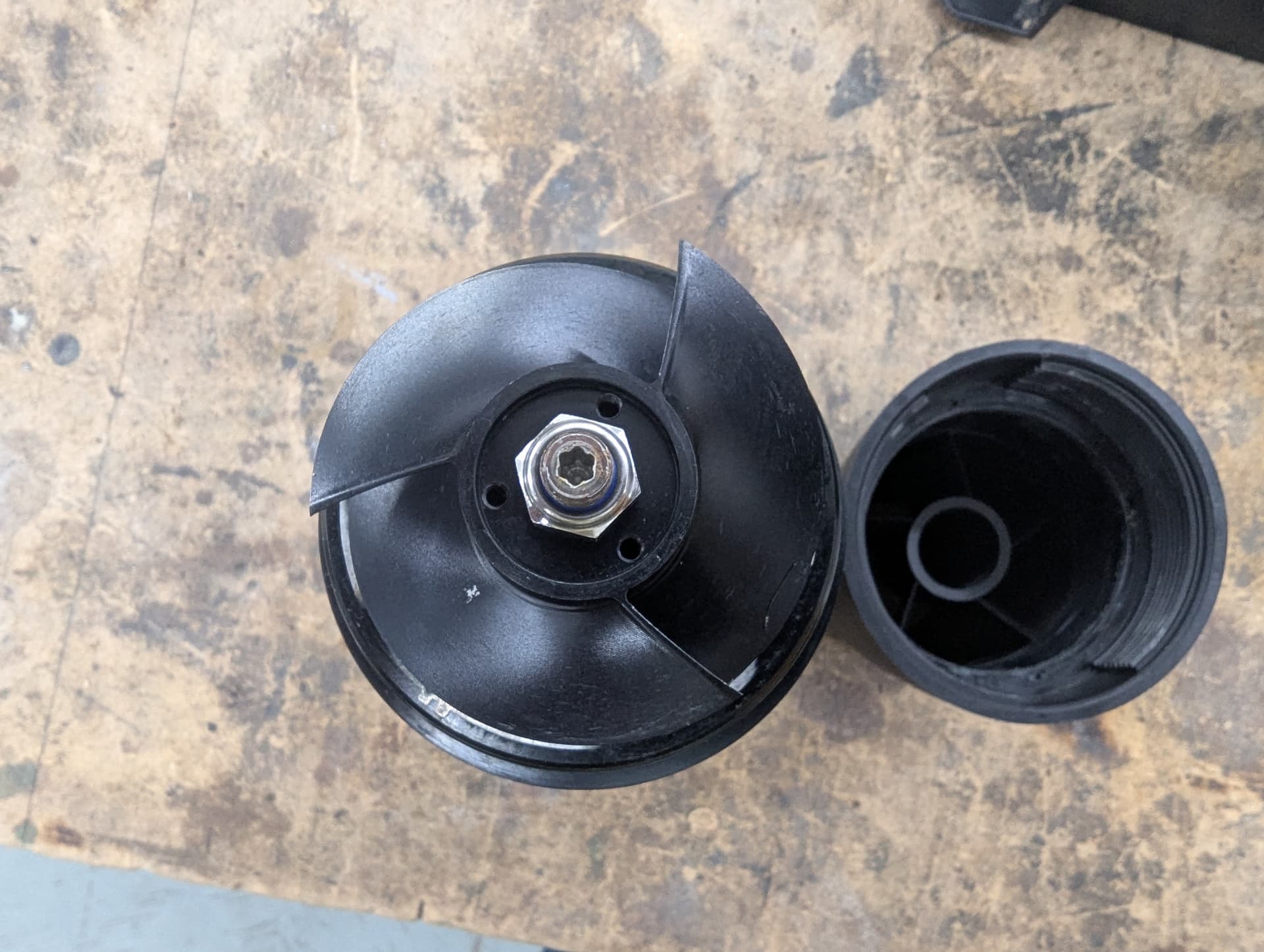

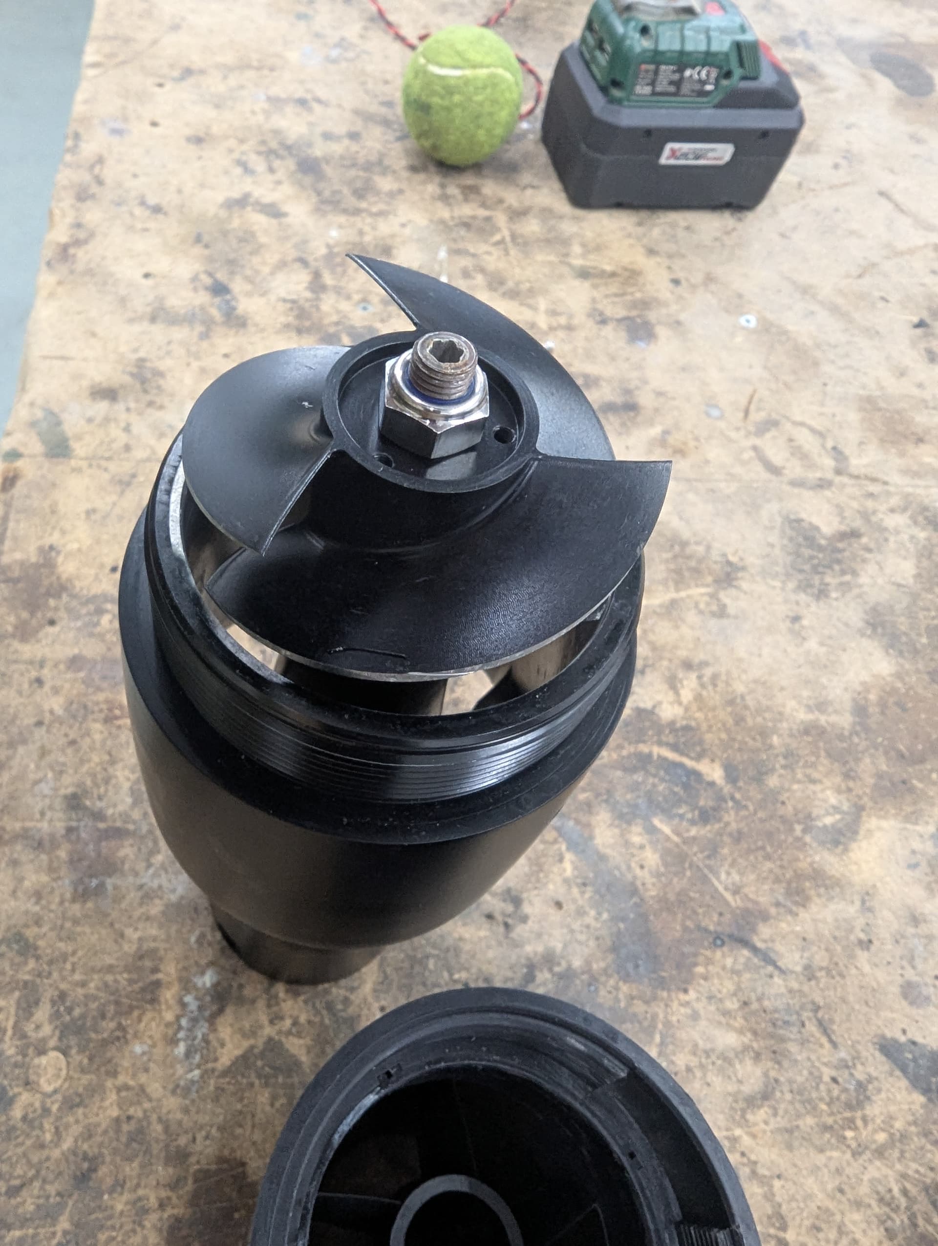

Original Lift Jetdrive

This is the JetWave “jet”

That’s quite a weapon!! The Lift Jet has very close tolerance between blade tips and the inside of the cone. It look like your jet is similar.
Yes. Very close tolerance between prop en walls.
Will be testing it tomorrow.
