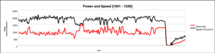

So today, in spite of the bad weather, we were really excited to try it and we were not disappointed. Best performance so far!
Power (in red): between 750W and 1000W (when not rocking the boat)
Speed (in black): around 20 km/h
Foil: GONG XLS 1500 cm2
Propeller: HighFly 3 blades P=6" D=6"
Some interesting preliminary computation:
  • When not foiling, the efficiency of the Highly propeller (FR for short) is about 45%, one of the worse I’ve measured.
  • When foiling, its efficiency is around 80%, could be as high as 90%, depending on how you massage the data…

The curves would be easier to interpret and use plotted as power over speed and power over rpm (instead of over time) as time is not actually a factor of interest in these tests.
How do you get the data for each point? (I didn’t read the whole thread so might’ve missed this)
Hi Lars,
To me, the curve makes sense: I am just trying to see how the power consumption evolves during the ride, and what my speed is during the ride. I can see that the power going up corresponds to speed going down, etc…
Plotting power vs speed is possible, but I get this, which gives me less information at this point: (but it’s true that it shows what is the max and min speed)
Same plot but over the whole ride (1 hour):
We made our own ESC so we get the current, rpm, voltage etc. information and our electronics includes a tracker with a GPS to read the speed.
What i mean is that the natural performance number for each propeller would be wh/km at a certain base speed or required power per speed.
The spread in the chart shows that the data is hard to use for any judgment since spread is so large (from 450w to 750w at 15kph is 1.6x the power for the same speed).
I guess that’s caused by the riding conditions and riding but it creates the question what is the true number for each propeller to be used for performance comparison.
Yes there is a lot of spread, that why my first impulse was to only use power and speed versus time. It shows that the power increases when you make up and down moves or side to side zigzags, etc…
But in the end, maybe the “scatter dot” chart of power vs. speed is not a bad way to compare setups. That gives you an honest picture of the ride. (with smaller dots, it looks a little more decent)
For speeds up to 10 km/h, we are in boating mode, hence the classical speed**2.7 curve. Above 15 km/h, we are most of the time in foiling mode. In between, we are in planning mode.

Do you have a way of allowing the speed to stabilise between two measurements? This would reduce the spread of the scatterplot and allow a best-fit curve to pass through. This could mean a software mod “While speed isn’t within X% variation, take another point”
I can do some low pass filtering on the data. The scattering is part of the ride, but it makes it hard to compare setups, for sure.
It’s curious to see the trend which seems to be lower power for more speed even during foiling.
I wonder if it’s the propeller reaching pitch/rpm optimum or lower wing angle (less drag) that causes this.

It’s not a problem of cruise control: The time graph shows that the rpm is steady. It think it’s just that the power and speed vary when you move the board a little bit, up and down, or left and right. I was just riding, having fun. Next time I will ride straight, with as little movement as possible to see what kind of curve I get.

Your speed varies in a 600-1400 Watts range that is 1000 +/- 40% at a fixed 2700rpm. Interesting.
Speed displayed is x100 !
So I applied a low pass filter on the speed and power data. The time curves are much smoother
an example:
The power vs. speed looks like this:
If you increase the Y scale, you get this below, which clearly (lol) highlights various modes of operation of the eFoil. The area circled in blue corresponds to the Foil Zone…
Actually I think we’re on to something as far as analysis in concerned. Filtering will be quite useful. The corresponding unfiltered data looks like this:
