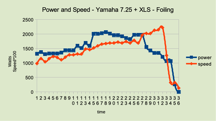

Foiling: the power drops sharply when I get on foil. So I can use these curves (power and speed vs. time) to qualify the wing+propeller pair.
For now, I’m using Yamaha propellers that we cut to various diameters. That was not perfect, so there’s nothing definitive about these results.
I could tell while riding that the D=7.25" propeller was no good. This is confirmed by the collected data.
The D=5.5" and D=6" were similarly pleasant to ride, but the plot shows that the 6" is more efficient.
