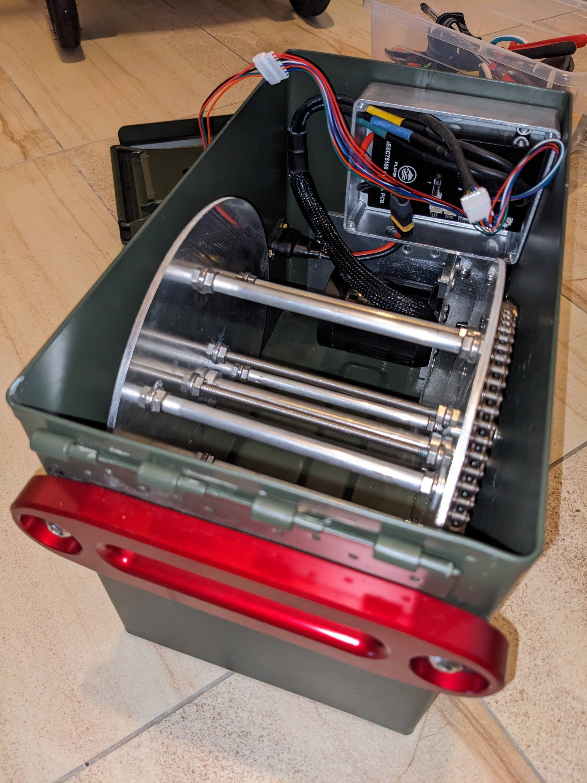

Ammo Box 6384 Winch Build

I decided to do some basic range tests today. When I placed the winch 1.5 meters above the ground, the range situation improved greatly. More specifically, at 100m I still had great signal (full bars, <50ms ping) regardless of the orientation of the antenna. It was worst (by a small margin), when the signal would have to penetrate through the winch, but still fine. It was best with the antenna’s flat part facing me (winch sideways). When the winch was at ground level, I was intermittently losing signal around the 50m mark with much higher ping times in general. I guess I need to add a tall antenna.
Unloaded RPM yields 25.5 km/h using almost no power.
RPM with spool yields 25.5 km/h using about 1.5 amps.
So, these numbers are roughly inline with the theoretical value of 28 km/h, and probably lower due to 95 max duty and other possible stress limiting settings.
And I understand that under heavy loads, RPMs would in theory go down. But, maybe my understanding is off here - wouldn’t the current increase first to give more torque? Or said another way, if the motor got 60 amps (double) in this scenario, it would be able to spin faster, correct?
Regarding the heat issue, I did try and feel the motor while at the beach and it wasn’t particularly hot. Additionally, the runs are only ~20s long so I can’t imagine it overheating that quickly. This issue was also present from the first run. I’ll look into this more carefully next time as well as the speed control temperature as it does seem like the most plausible explanation at the moment. Perhaps a heat sensor is busted.
Also, I am running the motor in sensored mode in case it matters.
@Jezza To answer your questions
Max Current: 80 amps
Max Power: 1500000 watts
Max eRPM: 100000 (I’m guessing this is fine given that the motor can reach higher speeds under less load)
I think my next step will be to figure out a way to pull various loads across the beach and try to figure out what the speed vs load curve looks like while taking note of the motor and speed control temperatures. It’s really the only thing I can think of. Also, I will look into figuring out how to monitoring live VESC info with my laptop at the beach to see if anything jumps out at me.
I’m also including an export of all the settings as C header files for reference. This seemed much more readable than XML.

Guess this one isn‘t correct (if you use the vesc to check speed)? Your drum diameter is larger, right?
Seems there isn’t enough torque and with the low battery current output it could be low motor current that is the issue. You could test increasing the motor current to the max the controller can take, does it make a difference in the speed and battery current? If it does make a difference then could be that motor torque wasn’t enough or remote isn’t requesting full throttle.
If it doesn’t make a difference then motor torque might be maxed out, motor is too small.
Do you see 100% throttle command in vesc tool when throttled to the max?
What is the motor current in vesc tool during a pull, is it the expected value?
Apart from that i don’t see any obvious things.
This is it. Up the motor current to 160a and then you should see 80a at the battery…

Motor current -
This is still under investigation. Some comments and questions.
I’m not sure where to check that, but I changed the throttle curve to the most extreme exponent possible, and tested inching up on the remote. It seemed fine as the motor didn’t even budge until 40% was reached on the remote. So, if the max throttle is off, it probably isn’t off by a lot. I also re-ran the VX3 calibration setting, and got basically the same results for a full trigger pull. If nothing else works, I’ll set the vesc power curve to max throttle on a hair trigger to make sure.
Also, the wheel diameter is fine. I’m guessing it is shown there in meters, so 14cm is accurate. I confirmed in the app.
The vesc can only handle 120 amps burst, and 100 amps continuous. As a result, I set motor amps to 120 fearing that 160 could fry something if it works. Is there any reason why we would need to set this value higher than what is wanted? Or, is it some bug? Regardless, the minimal data I got was promising. The graph below shows the line being tensioned, and then the second set of spikes is the start of the pull (the chain falls off right after). The motor current does increase past 80 amps, and the battery current seems to rise to almost 60 amps. The winch was jolted rather violently causing the chain to fall which, unfortunately, didn’t get me a reading of speed or current draw for the run. It is possible that this behavior also existed under the old settings. I’ll be trying this again next time. I wish I got a bluetooth module instead of having to take my laptop to the beach.
One other thing to note is that I had the VX3 set to VESC mode instead of FSESC (Flipsky ESC) which sounds like a trivial change, but I thought it should be mentioned.

When you setup the remote in vesc tool you can see if you reach 100% command on the screen. You can probably see it in the live readout view also but i never tried this.
Another trial with some more succesful pulls will be interesting.
For range on the remote I would get the BREmote Long Range… its really good.
Hey guys,
Thanks for all the guidance on here. I’ve done a bunch of testing on and off the water, and here are the results.
  1. The low current issue is resolved. I was reading the battery current and not motor current. I learned a bit about ESCs during this process. The constant battery voltage and variable battery current, is converted to lower voltage and higher current when being sent to the motor (keeping wattage constant). So, if the motor can’t spin quickly due to resistance, the voltage to the motor is lower which increases the current. This higher motor current hits the VESC motor current limit, and as a result it pulls less than the motor current limit from the battery. Example: Battery 48V40A = Motor 24V80A (motor spinning at 50%). Those numbers are rounded for clarity, but roughly what I was seeing.
  2. There is something strange with ramping time. When using the break/reverse trigger, ramping time works like a charm with duty cycle rising linearly. On the forward trigger, it appears to be a function of motor current and is about twice as aggressive as in the settings. That is, for a max motor current of 80A, the ramp increases as if the max it was reaching after Xs is ~150A. A couple of graphs included.
  3. The VX3’s high/medium/low settings are also just a max motor current setting with low being 50% and medium 75%. These numbers could be a bit off. I only ran the test once.
  4. Again, remote range is fine after the super basic antenna re-orientation.
So, I guess, mission accomplished… kinda. For foiling it works fine. Actually, the power for foiling is overkill. The bonus scenario of cross shore surfboard drag doesn’t work terribly well for us guys here at around 80kg (15km/h is fun for a bit, but gets old). For women and children, it could be a hoot though.

Hi, first of all: Thanks a lot for sharing this build with us. It is very inspiring.

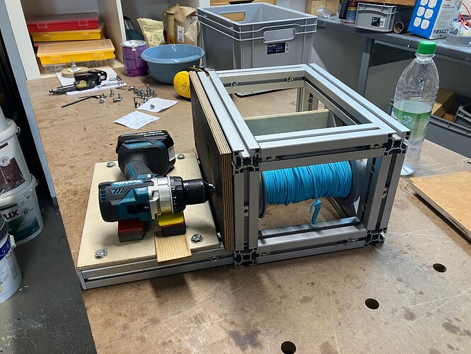

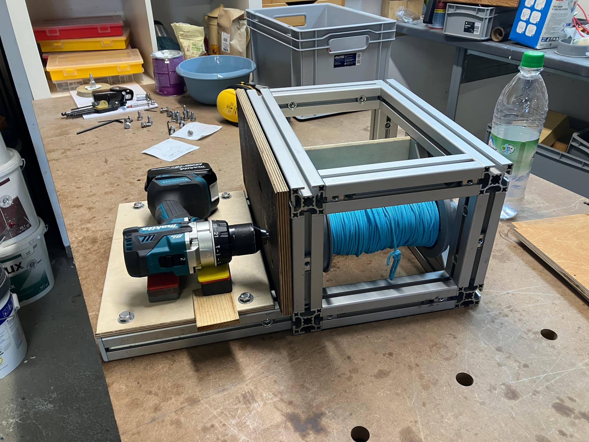

I built a simple which for foiling with a cordless drill. It works, but only for light foilers, not for me.
Now I would like to rebuild your winch, but I have a couple of questions e.g.
How did you mount the sprocket on the motor? Did you use a round or a D-shaft? Short or long version? or
How did you install the spool? In particular, how did you attach the sprocket on the spool and how did you install the spool in the box? I noticed that you used bearings. So I assume you used rather a shaft than a hub (I am not sure whether I use the correct English terms). However, it would be great if you could let us know your solution.
Finally: How do you control the speed when foiling? Is there any other throttle than the remote?
Best, Sebas
Hi Sebas,
The sprocket is mounted to the motor using a dog point set screw. The motor I got uses a key/keyway, but I could not find a sprocket that would work with the key. The dog point of the set screw fits nicely into the keyway, and although it doesn’t seem as strong as a key it has been holding up well.
The sprocket is attached to the spool (two aluminum discs) using long m6 bolts with nuts in between the closer aluminum disc and the sprocket as spacers. The spool itself is then just some more long m6 bolts run between the two aluminum discs further from the center covered by some perfectly sized little aluminum tubes to prevent abrasion on the rope from the bolt thread.
And yes, there is a shaft. It is actually attached to the aluminum discs on the inside. The central hole of the large sprocket was much larger than the shaft. Some careful measurement here was required to prevent too much of an uneven spin.
As for foiling speed, it is just the remote. The rider holds it. We reduced the max speed of the winch to about half in the VESC software. So, something to keep in mind here. Choose your gear sizes carefully. I could have gone for more power and less speed perhaps allowing a deep water start or more exciting non-foil pulls.
I hope that helps. Let me know if you have any other questions. Also, here is a picture of the spool without the rope.

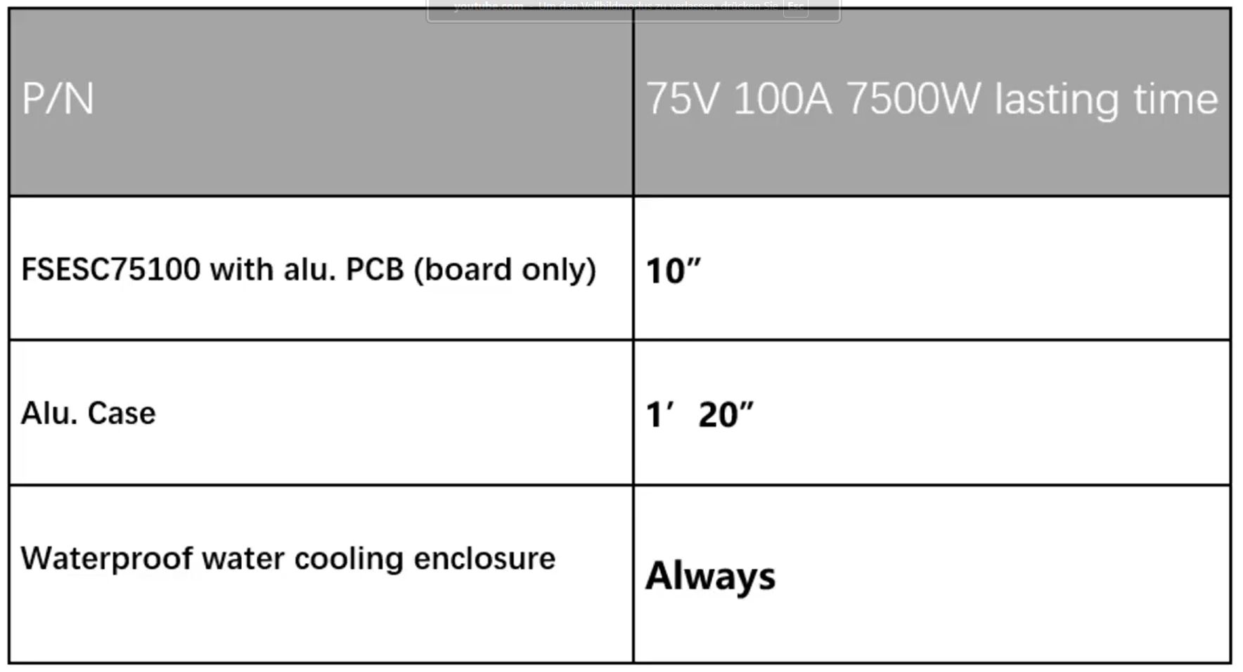

Regarding the heat issue, there is a Flipsky video on YouTube with the following summary at the end:
HEAT DISSIPATION TEST of 75100 Series Products
Accordings to this, it should not be a problem to use the 75100 for foiling as the runs won’t last 1:20 min.
Right. We have had no heat issue. Runs are short, and the current draw is only high for a moment before takeoff. Once on foil, little power is used.

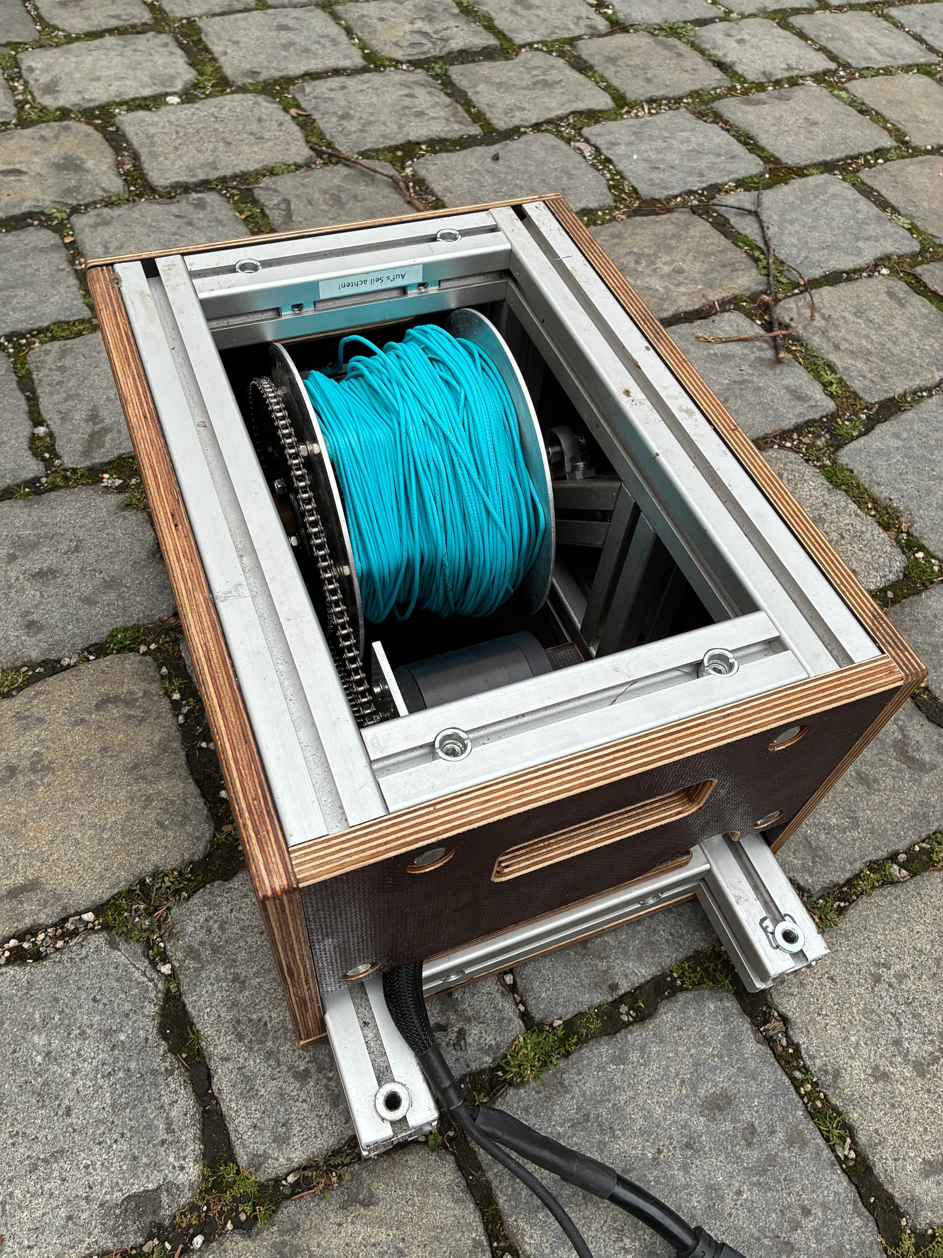

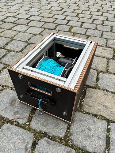

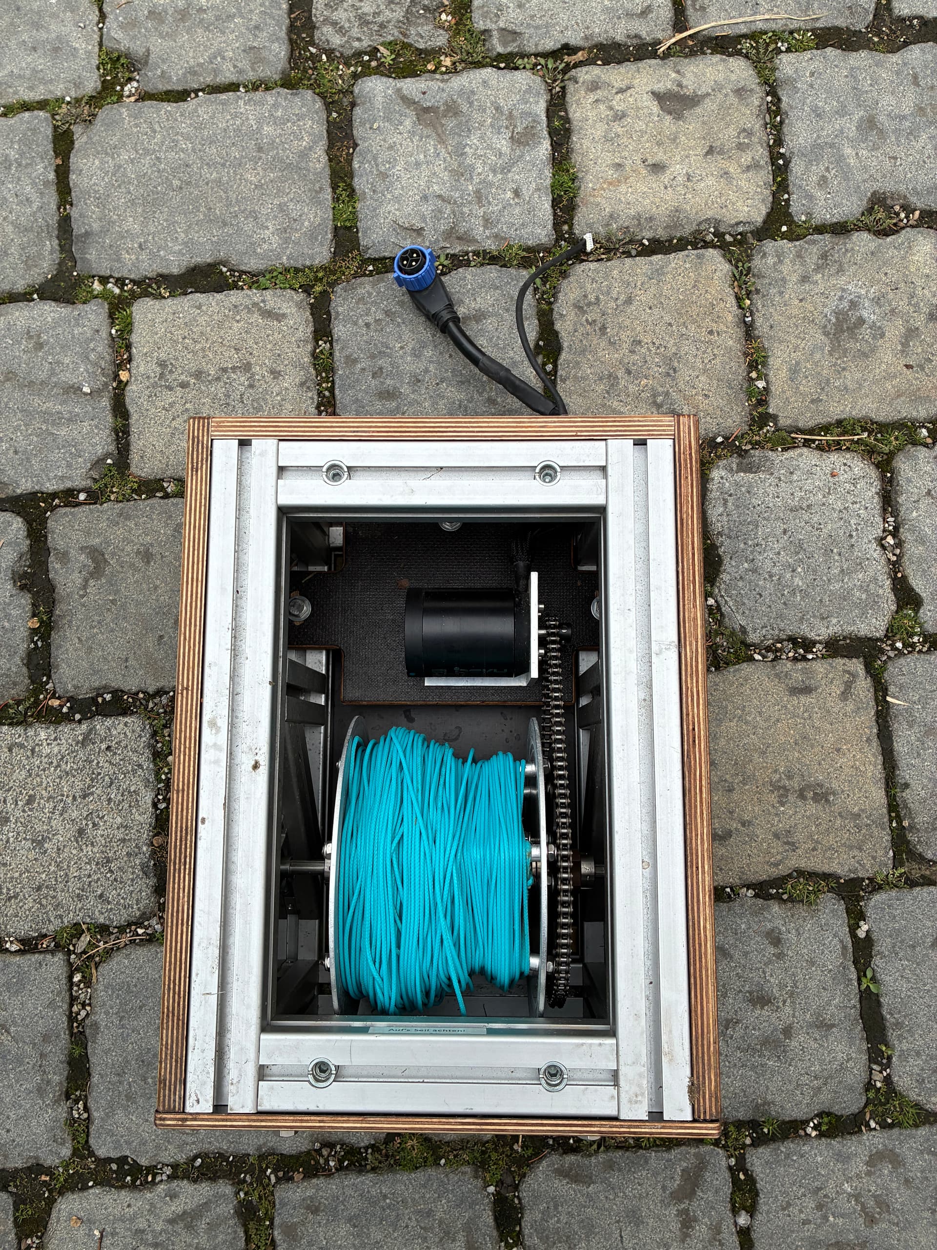

I built my Foil Box based on the Ammo Box, and I’d like to share my version of it here. The basic components are essentially the same . I only changed the gear ratio, which I set to 1:8 (10:80 teeth). I also added a Bluetooth module. The box is built on the basis of my previous box.
The key components are:
• 40x40 aluminium profile
• 15 mm screen printing plate
• Flipsky motor 6384 140 KV
• Flipsky VESC 75100 water cooled (I will also use the VESC for e-foiling)
• Flipsky Bluetooth module
• Flipsky VX3 remote with an additional 1.5 m antenna
• 12S 8000 mah Lipo battery (2x 6s in series
• Spool diameter about 140 mm
• Gear ratio 1:8 (10:80 sprocket teeth)
• 3 mm polyproylen seil
• Riders weight: 80-95 kg
• 130 l board
I also built the spool myself. The hardest part was finding the center of the side walls and getting everything aligned. Next time, I’d use a 3D printer to make a drilling template and a centering guide for the sprocket, or just print the whole spool.
The first test run was a success. The setup worked perfectly. Neither the torque nor the speed was an issue. We controlled the speed via the Max RPM setting using Bluetooth and the VESC app. There was still plenty of reserve for a higher speed.
However, the cable inlet needs to be adjusted. It’s currently in the middle of the spool. I’ll move it up to reduce the leverage forces on the spool and cable friction. Additionally, the spool itself needs to be moved further back.
Furthermore, a few settings in the VESC app need to be adjusted (ramping time, settings on the remote control). I’ll likely cover the details of this in a separate thread.
Conclusion:
The setup is great and works excellently. I would build the box this way again, but with 30 x 30 mm aluminum profiles and 9 mm screen printing plates.
