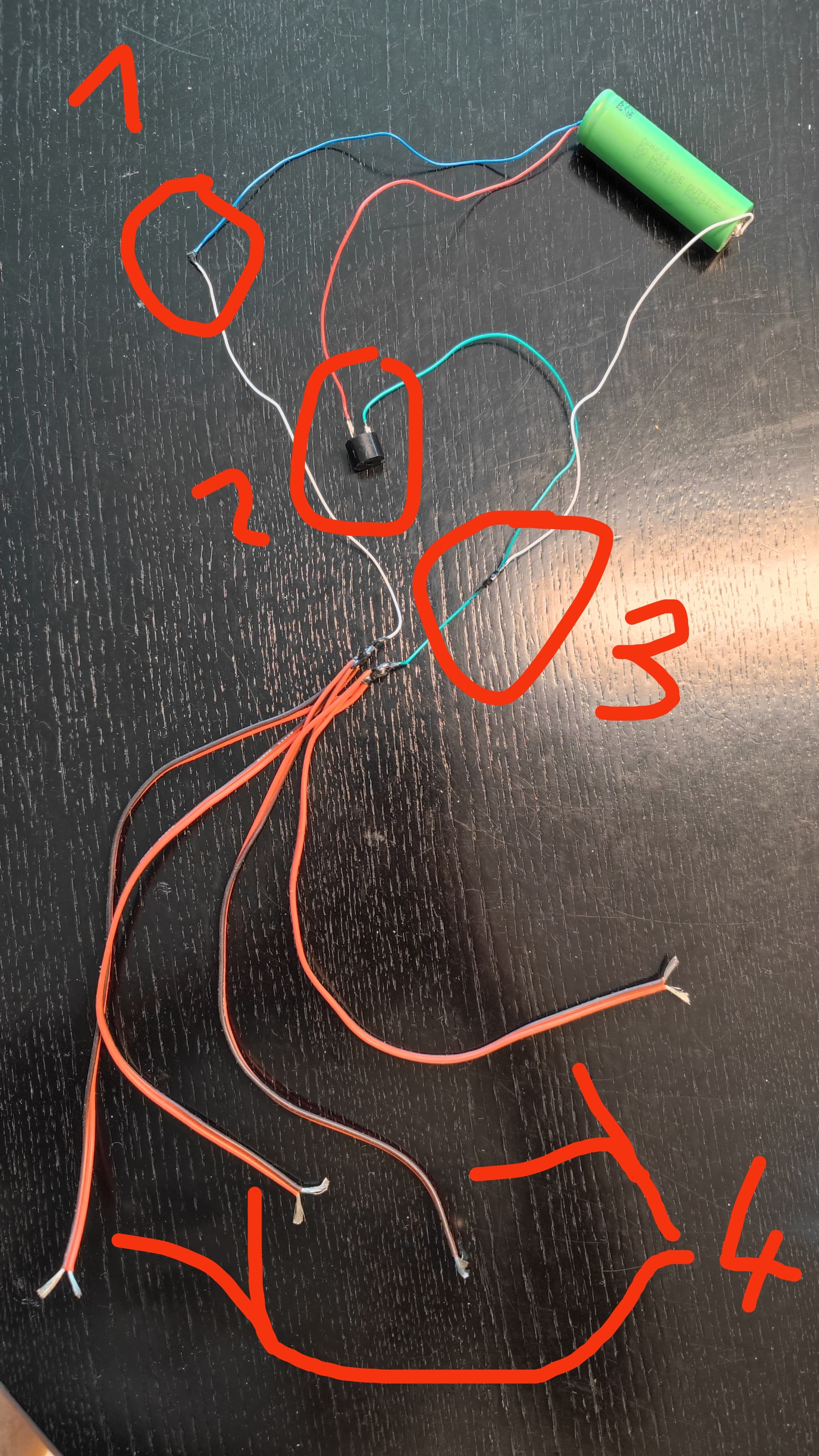

I also buildt a quick and dirty water detector.
I just opened an old damaged electronical scale and soldered the needed parts out. You cant see those small smd parts, but they are there :smiley:
1: 10kOhm resistor
2. buzzer
3. npn transistor
4. sensor cables attached to the basis of the transistor.
As soon as one of the cables are in water, current can float into the basis and the buzzer gets activated. It works fine. But I havent built in the board yet.

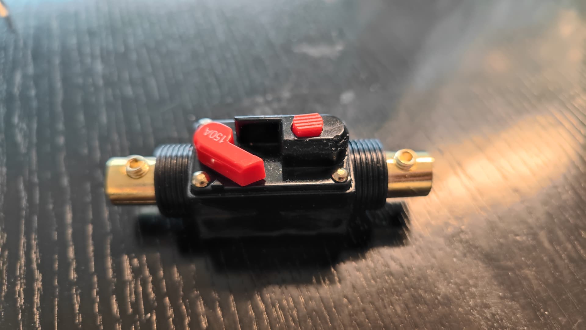

The last thing is that the cheap china fuse can by far not withstand what is written on it (150A). Something in the inside melted and now it is not possible to trigger or close the fuse anymore. Is that issue know or did I just could have a faulty part? Anybody also using that part or another better one?

People used those in the early days 2019/20 but most cheap ones could not withstand more than 60A, no matter what they were rated.
Better use an antispark connector like xt90s or QS8S. If you want a fuse, midiOtto 150 - 200A is rated for 58V and is quite compact. Works well in my 2 boards.
Here an update. I opened the fuse and the metal pins which are making the conection inside are held by cheap plastic which melted down. I excluded the fuse and did a second testrun:

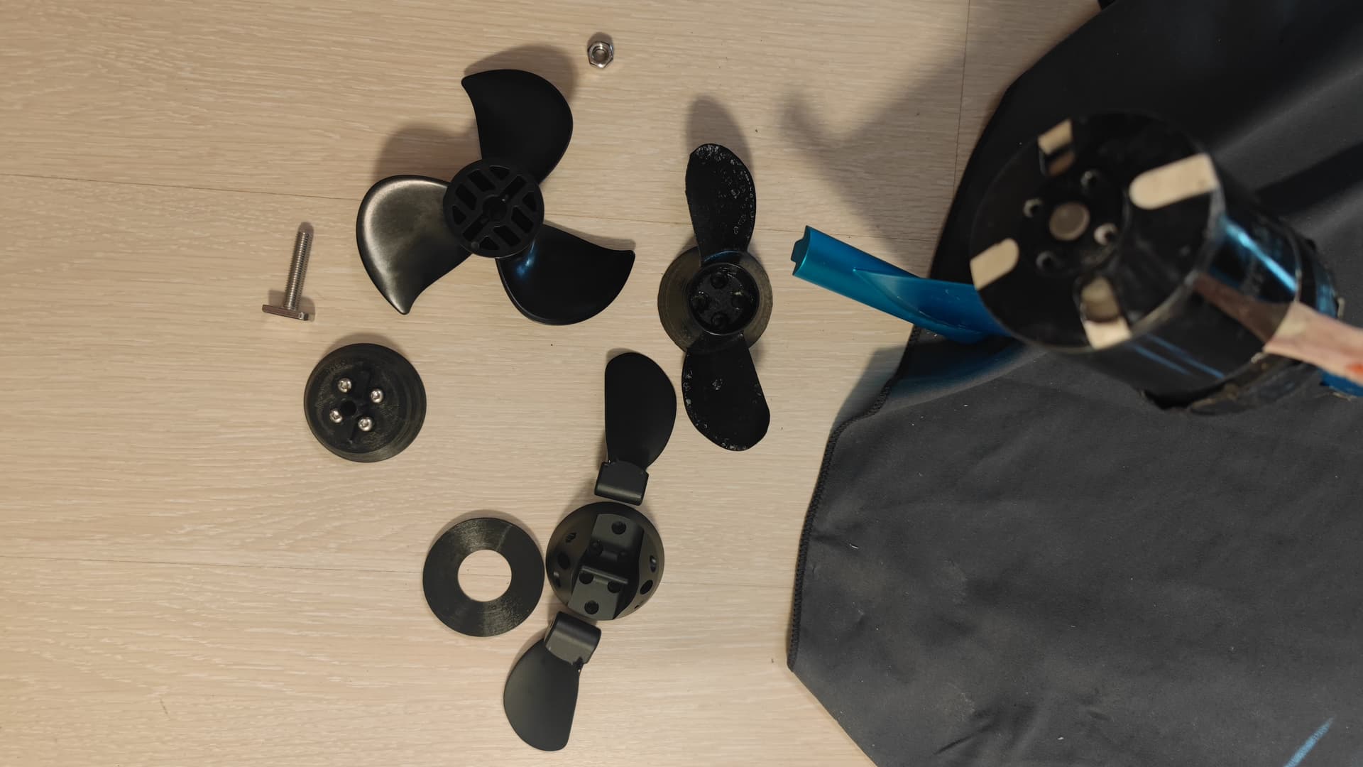

Unfortunately the the ESC got to hot and is shutting down. I got a hint that maybe my prop does not have good efficiency. It is the prooven Volkers prop, but I printed with a bad printer and I deformed the prop maybe also a bit due to heat (I wanted to eliminate burrs at the edges and flamed it. The prop got very soft while that) and I also fixed an edge with UV-epoxy (I crashed the prop inside my door :D).
So I have bought a plastic flite prop and a 38€ flipsky aluminium folding prop (https://a.aliexpress.com/_ExFvH3u) and printed mounts for it:

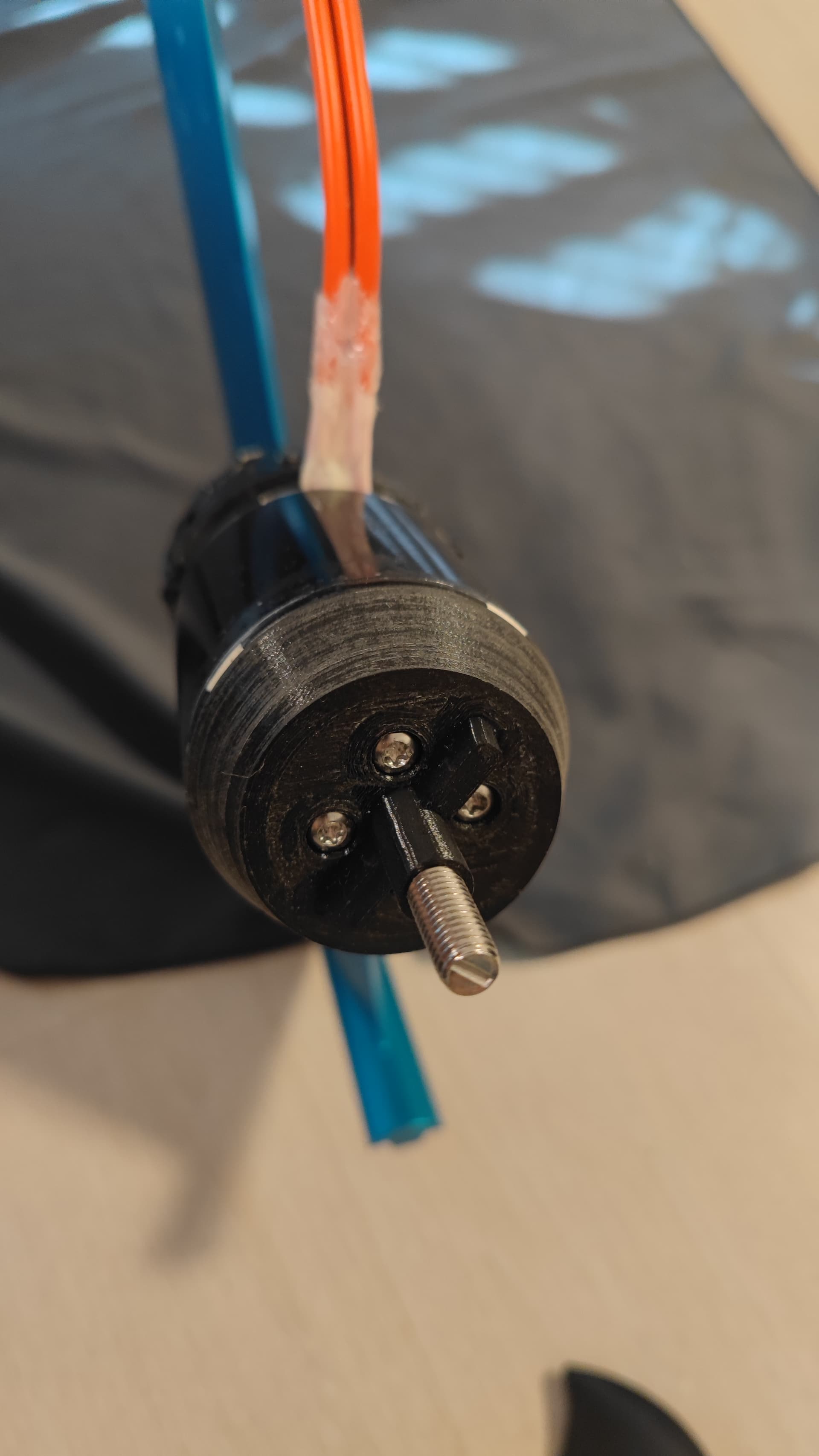

Nice build. Can you please share the 3d printfiles you used to mount the props to the 6384 and what type of bold head is that? looks familiar.
that adapter for the flipsky folding prop is from @seagull_nz (BDUAV 120kv Motor Flipsky Prop Void Fill by seagullnz - Thingiverse). I could not find his original post, so I hope it is also fine referencing him like that. The fit on my 6384 is excellent (perfectly centering and in line with the outer diameter). It fits also to the flipsky prop which I got, anyhow the outer diameter transition and centering the prop could get even more improved (maybe Seagulls prop has slightly other dimensions).
I ordered this 38€ alu folding prop: https://a.aliexpress.com/_ExFvH3u
The flite adapter I did myself. Centering on Motor is quite good (not as good as seagulls for the flipsky. He has here really 0 play). Centering on the Fliteprop side is perfect for mine, because I optimized for that. But it could be, that it does not fit to others, because there is also a flite prop measurement of someone else in the forum and that is deviating for several 0.x mm (3 blade prop file? - #3 by SoEFoil). So looks like there is quite a lot of fluctuation in the part.
Here is all of my data(creo, stl). I printed it with the motor side upwards to have a really smooth surface on the motorside to fit better to the motor.
https://www.dropbox.com/scl/fi/wgwijfsukrtipn820o3ka/Fliteboard.rar?rlkey=u11s3kgsfxi8x5u8ni76h43tk&st=2idw0cxx&dl=0
Screw which I used is in M8 x 40mm: https://a.aliexpress.com/_EzxgdmW
For the flite adapter attaching to the motor, I use quite short screws (10mm) to keep everything compact)
