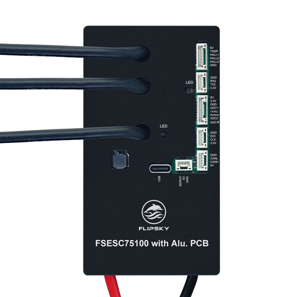

I cant open the limits due to the vesc, which is 100A vesc. But my issue is that I am far below this limit. So either the rootcause is by physics/prop or vesc application/hw issue. Sat_be comment is clearly showing that the prop is not the issue. I assume the probability of wrong tuning is much higher than a hw issue, so I need to find the rootcause in the vesc application.

Hi Jan, thanks for commenting again. The 100A limitation is at least what flipsky wrote on their webpage for the vesc:

I increased now the motor limit to 120A, abs. max to 170A and battery current to 90 A. Tomorrow I will try again if it is showing now more than 43A. If yes, I will increase the motor current in vesc till I am able to fly and hope, that the vesc will hold for some time.

It is working with the increased phase current from 95 to 120A. The displayed bat current while riding gets higher nearly the same amount (from 43 to 65A). This is sufficient enough for me to come out of the water. I haven’t driven the pack to low voltage, so I do not know yet if it will work also there.

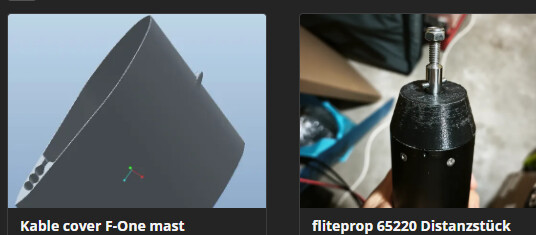

I also added a view updates (cable guard and Motor endcap) to reduce drag.
I will upload all the 3d parts later. It did not let me upload those, because the hosting page detected, that I used screenshots out of the 3d modeling programm and it requested real world pictures. So I need to make pictures first.

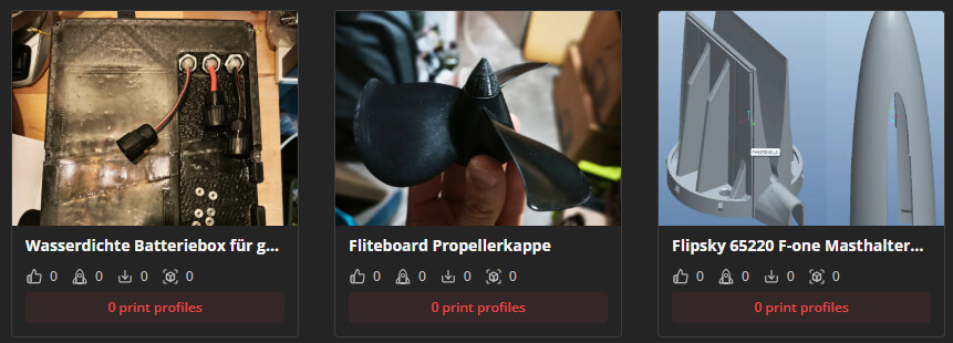

Now here a few 3d models for my final configuration.
I forgot to say, but I also updated my battery compartment, because the old one always took a lot of time to assemble before having a ride. The new one is much better and also very watertight.
I hope with the following link they are accessible. They are all step formats. I hope everybody can use those, but for me those crappy stl files which cant be edited anymore are annoying as hell.
https://makerworld.com/de/@user_3443594597
