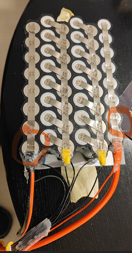

The Battery is done. I have 2 seperate 6s8p blocks created so that I can use a 6s balance charger which I already had. The blocks are coming without a BMS. All cells in parallel I have fused with cheap fusewire from alibaba. In series there is just 1 fuse behind both blocks to at least protect the battery in case I get a shortcut. After finalizing the blocks I added stripes of a sealing as shock protection before I wrapped it in pvc. The pictures are showing upper and lower side + the final blocks

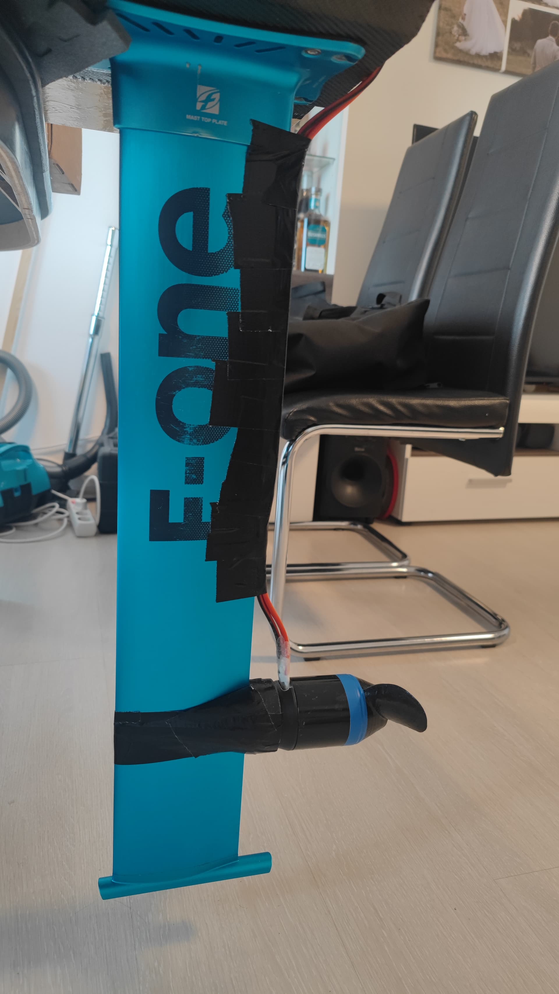

Here is now also the attachment of the motor to the foil. I had another good idea, so I changed my approach. I just printed a piece of plastic and put a clamp. First I just wanted to press hot clue in a pipe to model this peace of plastic to avoid setting up the printer, but then I anyhow installed creo and set the printer back to live. It is done out of PETG. It was not perfectly matching to the foil but with a heatgun I could fix that. Over the clamp I will stick a waterresistant tape to improve hydrodynamic.

I would suggest to increase your battery terminal thickness. At the marked spots you will gett the current of your 8P over the nickel strip, which will be too much.
You could extend the terminals and solder them to the nickel between the batteries, but it would have been better to solder before spotwelding, to avoid to heat up the cells.
See here, 1. battery soldered carefullly after welding, still OK after 4 Seasons.
2nd battery was soldered first and then spotwelded.
You are right I did not consider that. I think I will just double the terminal strip. That is I assume the best what I can do now.
ok, I put it into a calculation and 2 stripes are still by far to less. So I will put 3 layers of strips to get some heatsink between soldering and the batteries and then I will solder a wire on it. Thank you @sat_be, that could have ended bad.

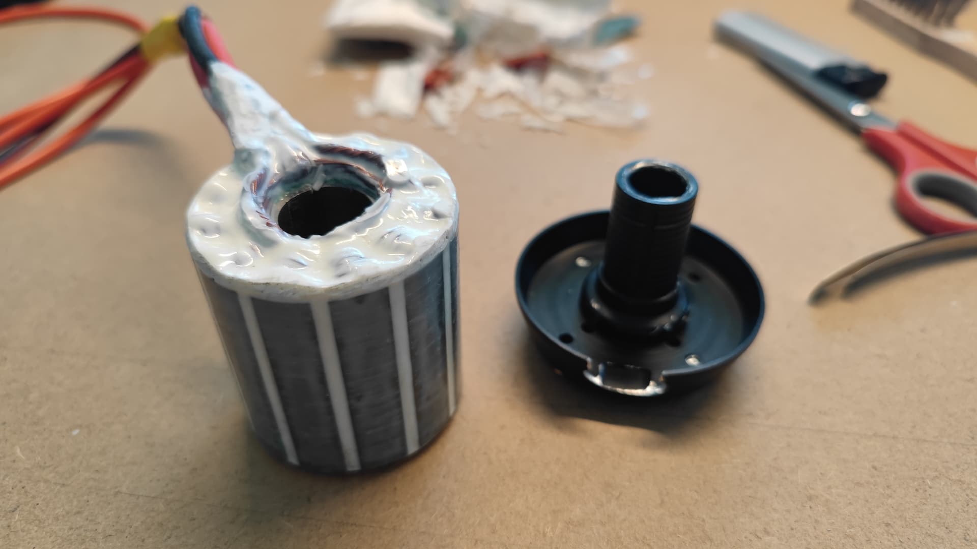

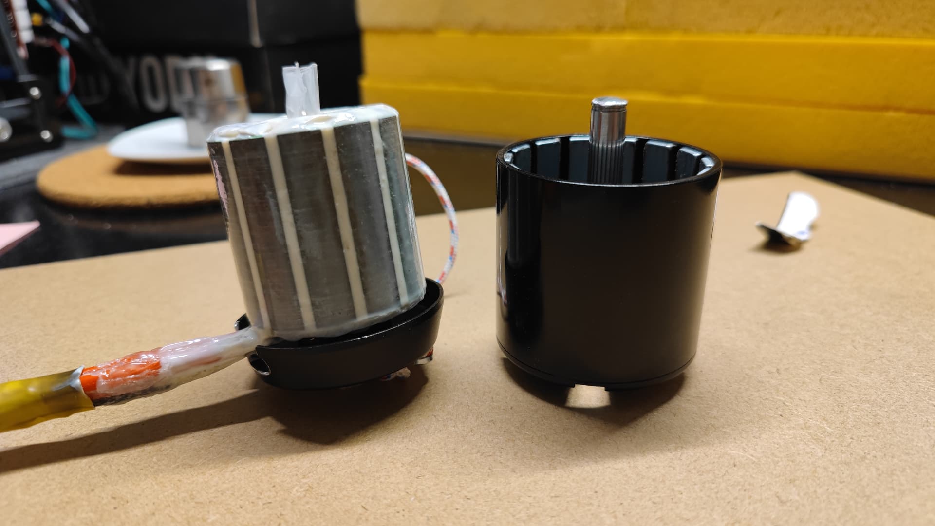

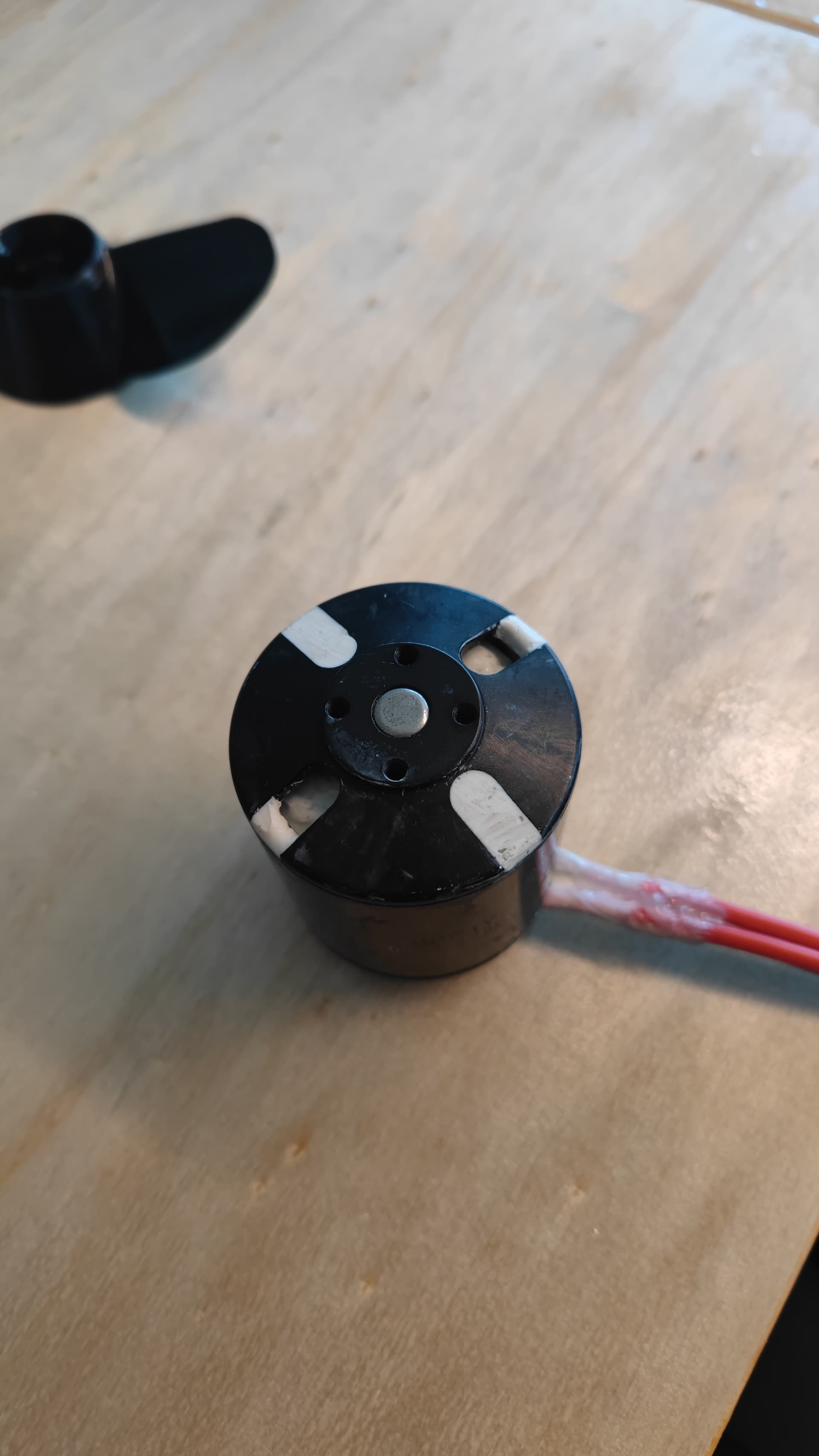

here is now also the motor. I filled it up with epoxy with 30-40% aluminium oxid (2-5 micron) to get the heat conduction improved. Also the magnets have a very thin cover. So there should not be any corrosion anymore. The shaft I cut of.
I have a kilo of it (so much more than I needed. So if someone also needs something for his motor, I can sent a bit for getting the shipping costs.
You could also solder short strips with the spacing of the batteries to a wire or copper terminal, spotweld that on top and fold over. If you can temive the existing terminal leads, even better, the you could do as I did (link above).
I did your last proposal now and had today my first test drive today. Worked well. Thanks
I also filled up the outer rotor magnets and reduced the holes at the top, to have less rotational drag:

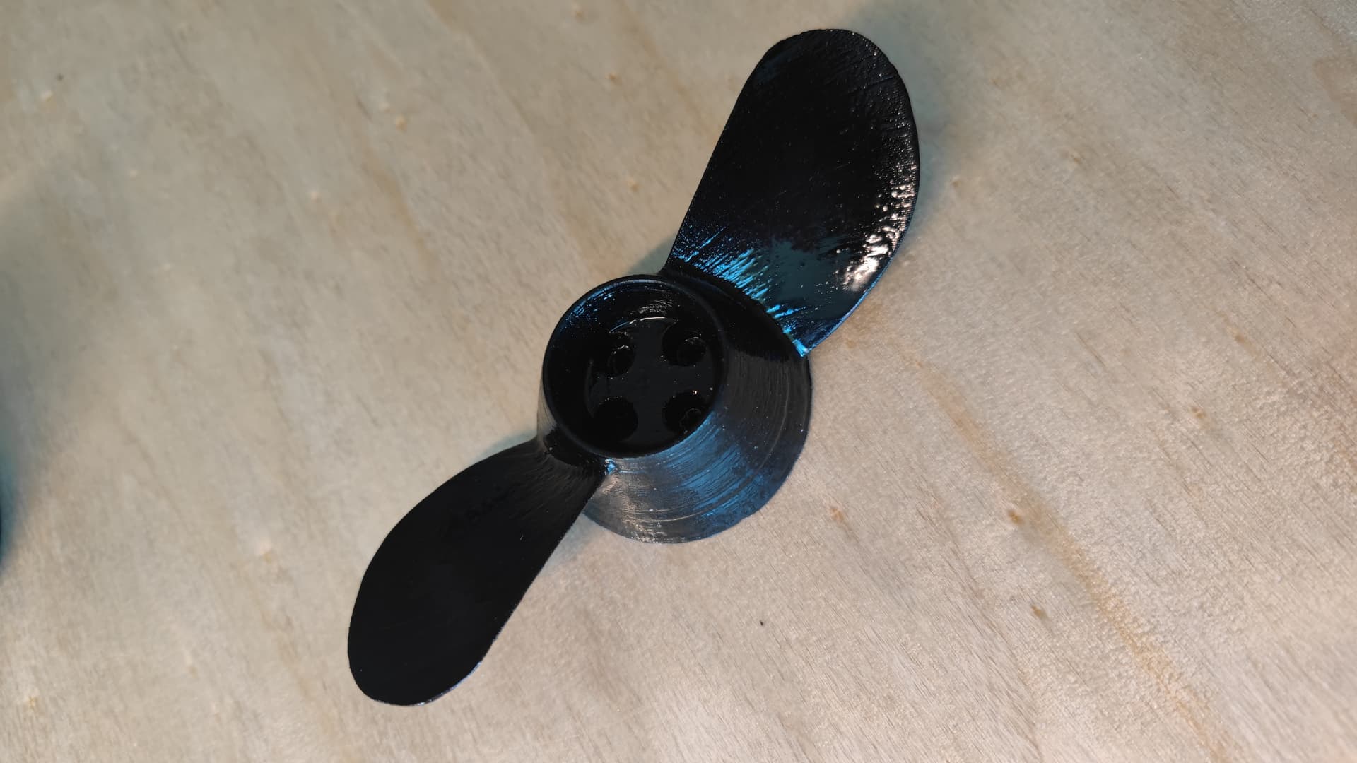

Prop I 3D printed one out of the forum and attached a layer of epoxy (Volkers prop)

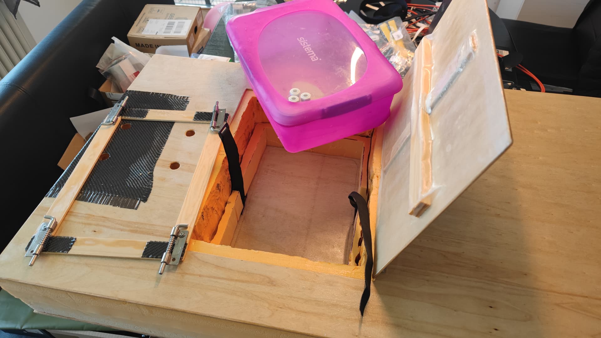

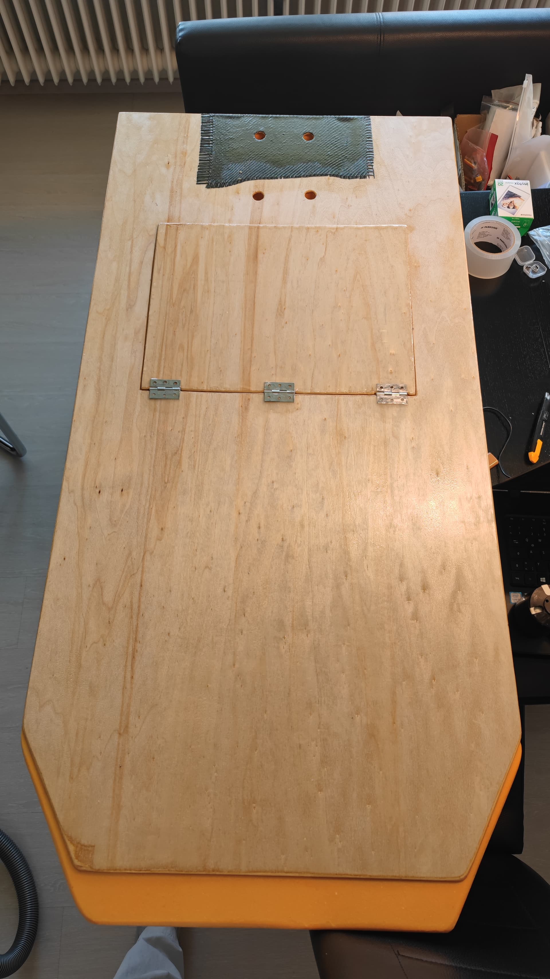

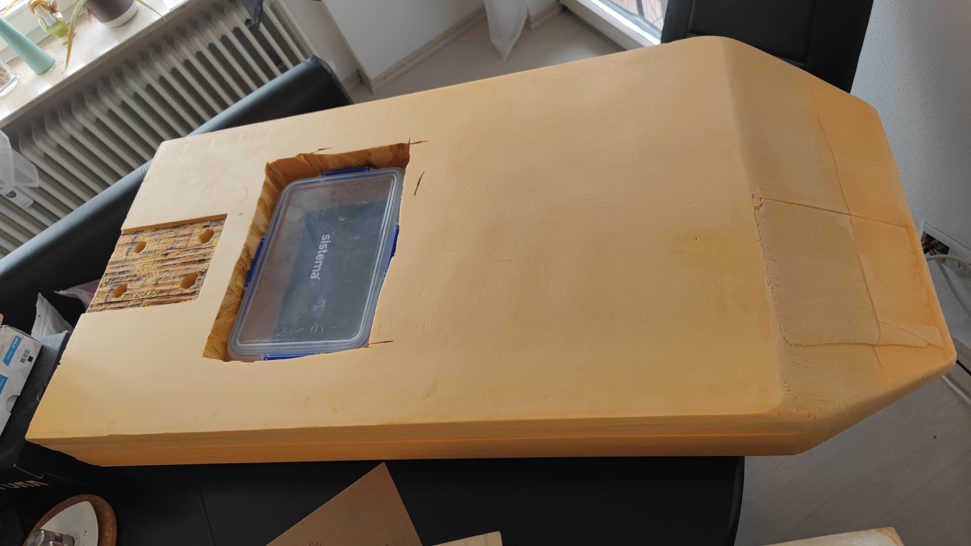

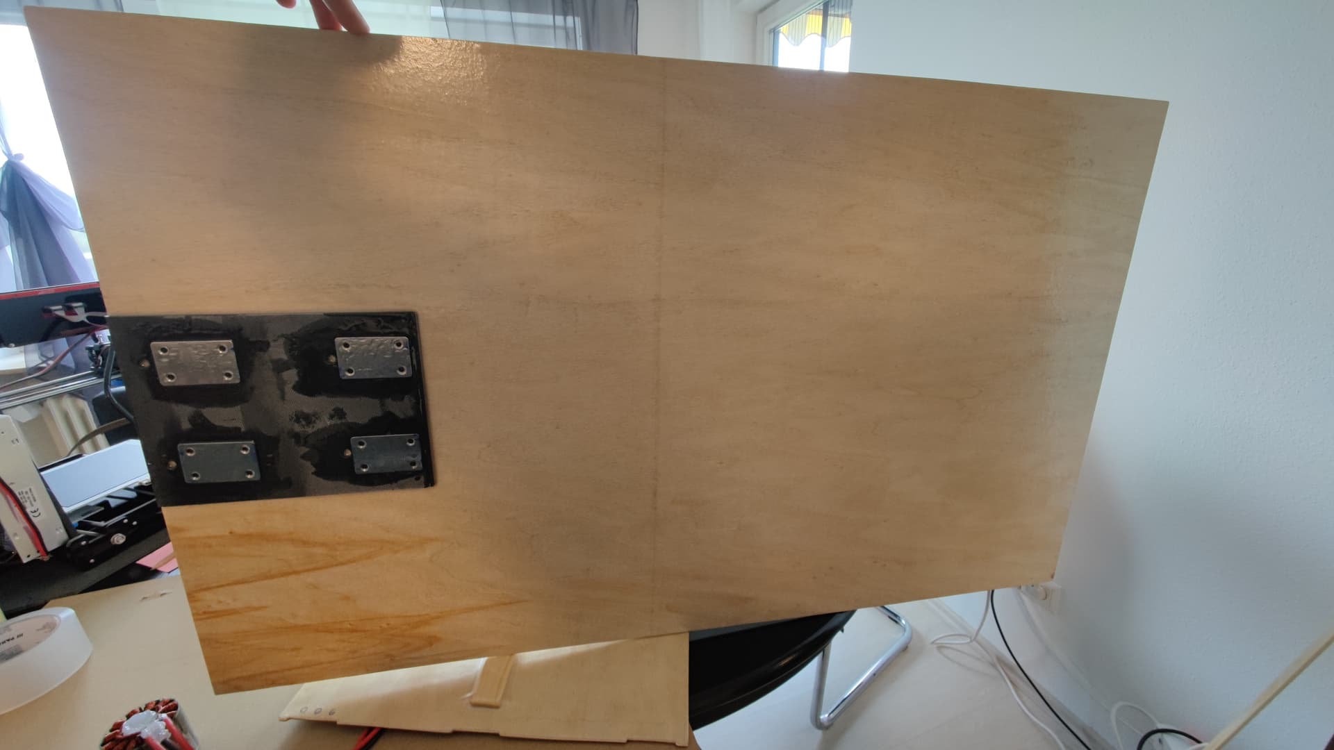

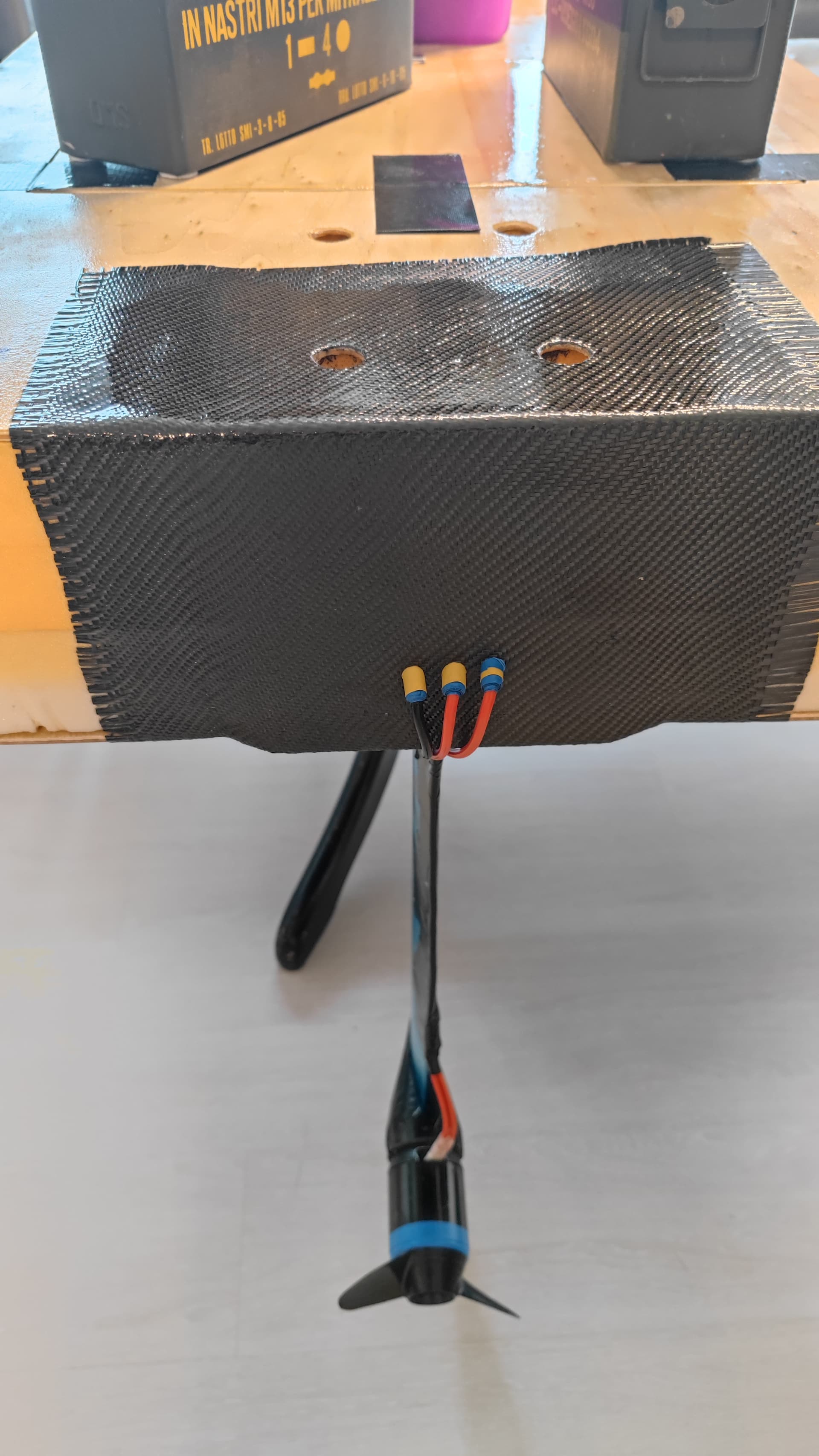

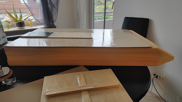

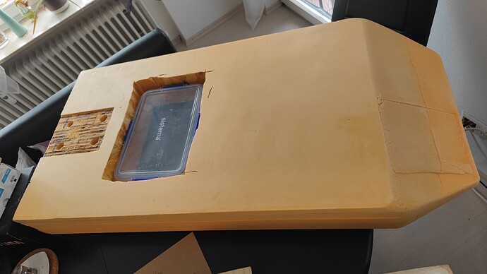

The board is also done. xps with a top and bottom sheet of thin wood to get forces not pressing into the xps. At the mast I doubled the wood and placed floor pvc parts, because that was for free at the store as an example and it is water resistant. I ued the additonal layer pvc because Iwas feared that the mast and screws on the other side are pressing in the wood and then the sealent epoxy layer at the top gets broken and water comes into the wood. One layer of carbon I placed from the mast side to the top side to eliminate that the different layers get separated by forces from the mast. More strengthening I dont think is needed, due to the thickness of the xps, the board is stiff. the wood I sealed with a layer of epoxy.

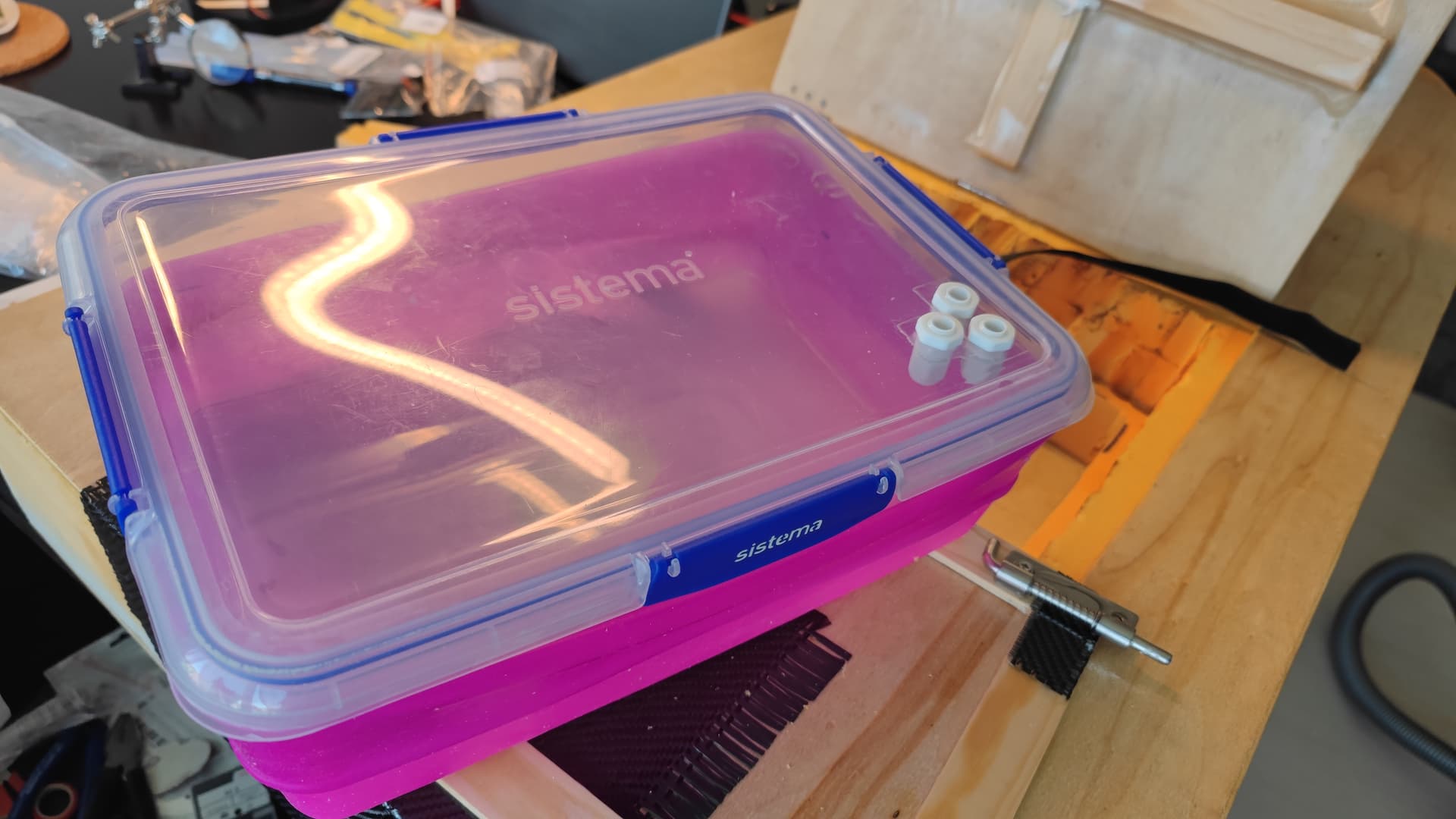

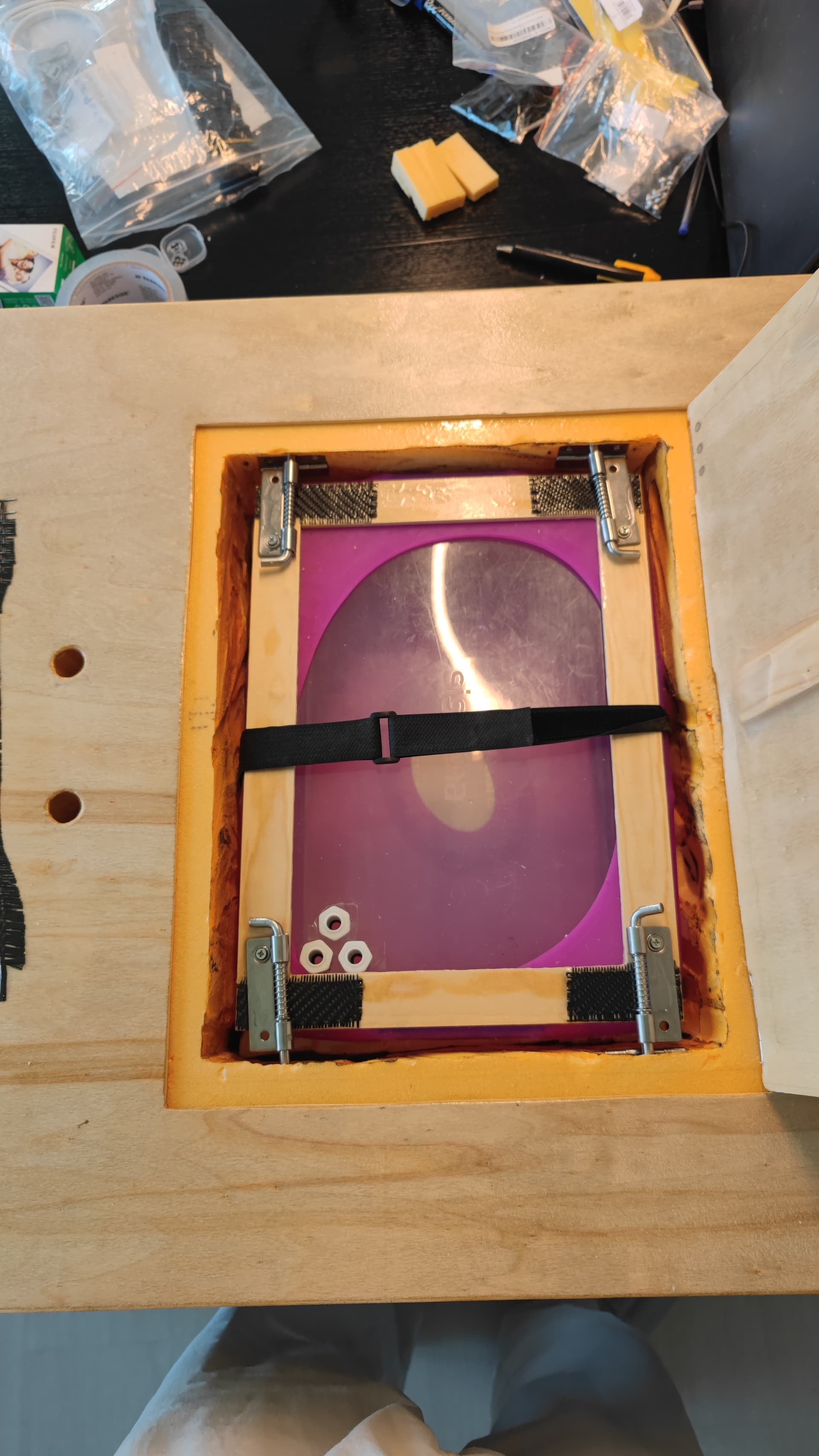

The electronics inside is in a normal kitchen box, which I wrapped around such a cheap china silikon ball to make it super tight. The box I am holding down in the board with a frame which I can snap in ontop of the box. Wiring just attached with adhesive stripes. adhesives stripes also used to smoothen the surface of the motormount.
