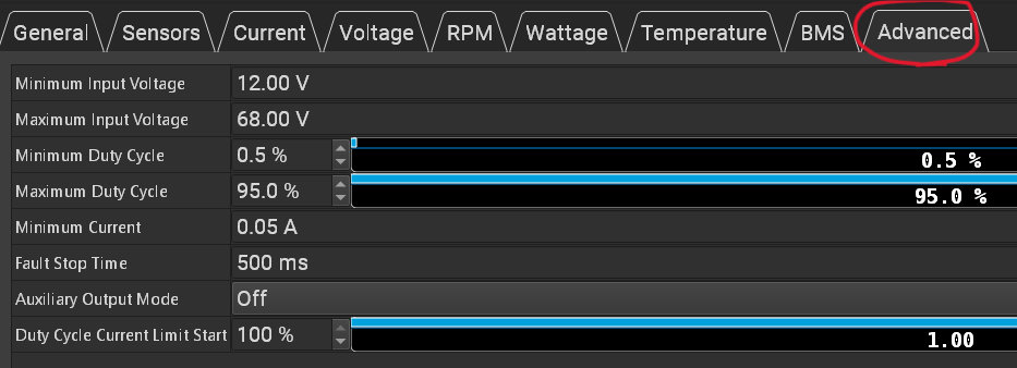

Motor: FlipSky 65161 120KV
ESC: FlipSky 75200
Battery: 16S 11P, 90A max
Are the Сurrent settings correct, especially the 200A maximum for the motor?
ESC: FlipSky 75200
Control Type → Current bidirectional
Do you plan on going in reverse? ![]()
Other than that looks fine to me
Certainly. Reversing is very useful when I want to get the board back while in the water.
