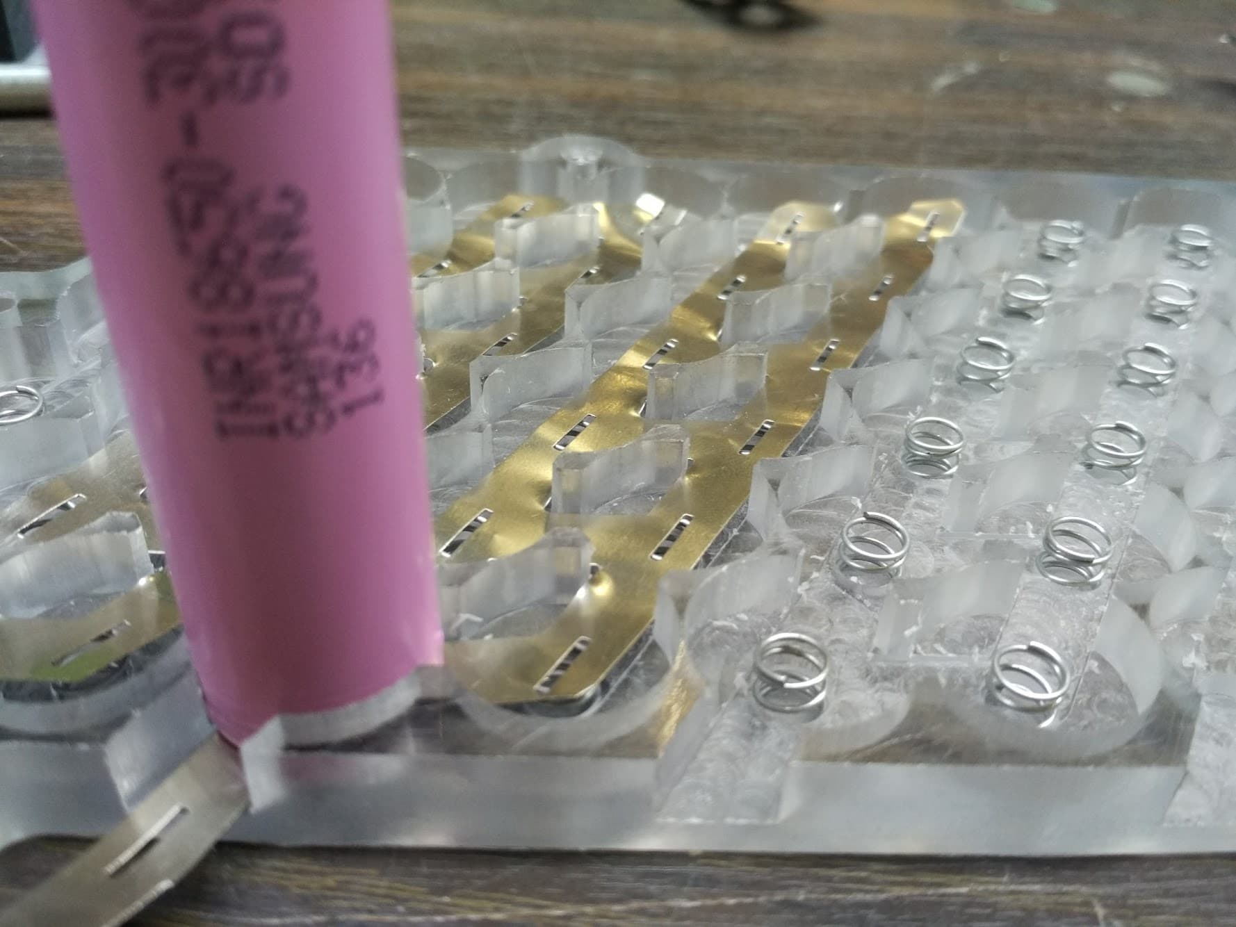

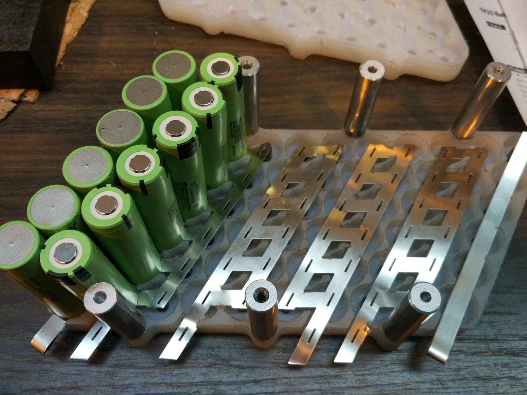

What about a solder less battery build, that could be assembled by ordering parts and assembly, without spot welding and potting?
I worked in the past on solder less batteries, (2016) but did not have issues of waterproofing then…
I will work on such concept to make my 12S1P setup airplane safe (up to 20 cells per person is easy in most airplane companies) See last link, same idea.

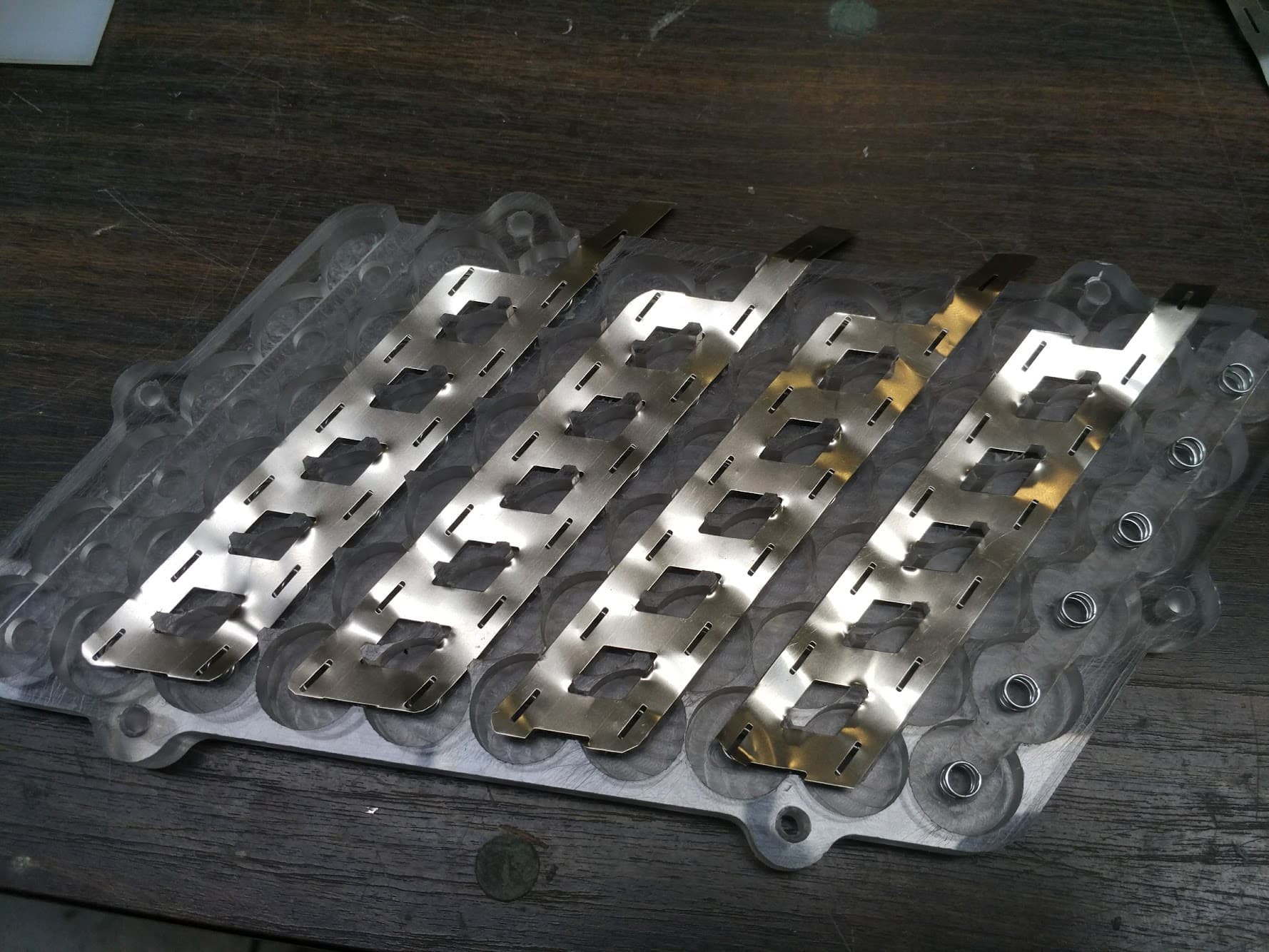

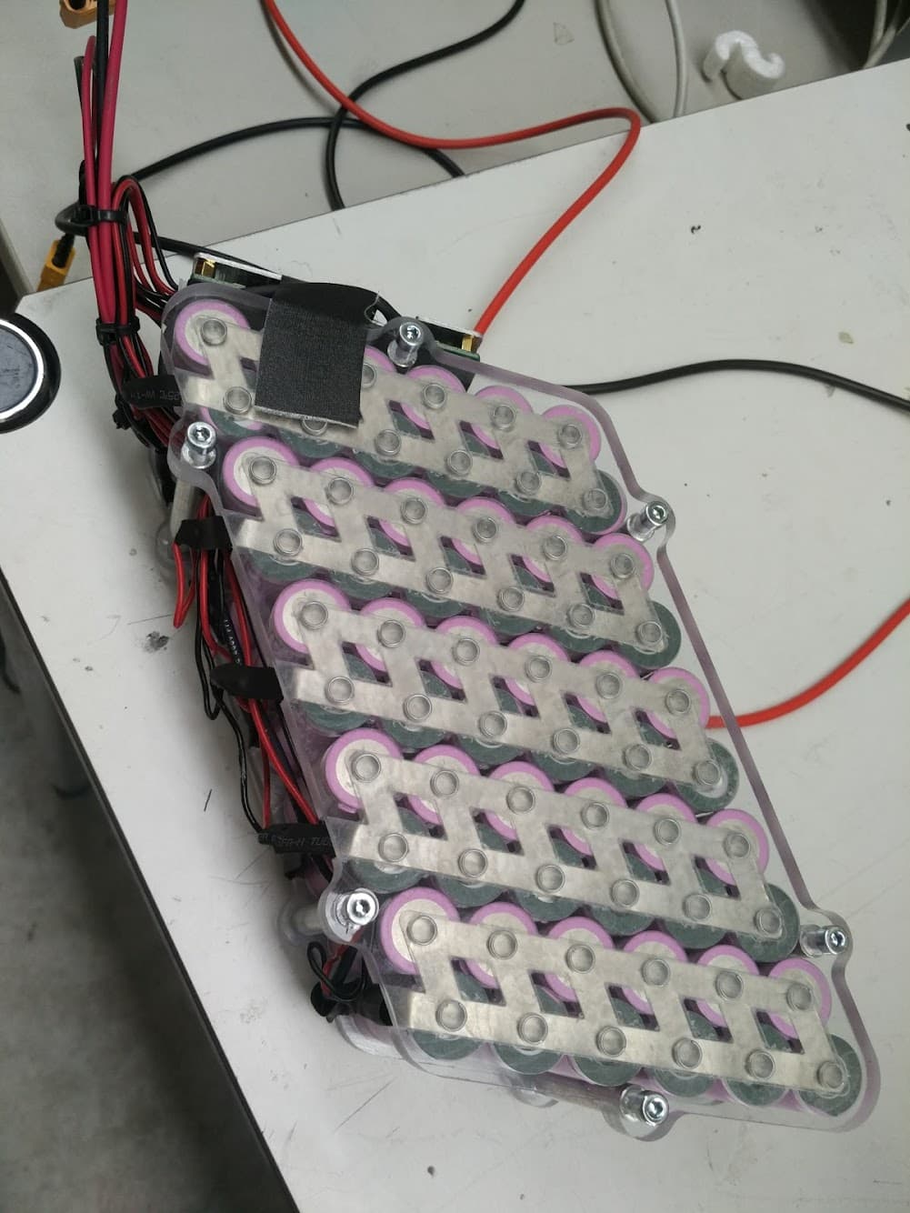

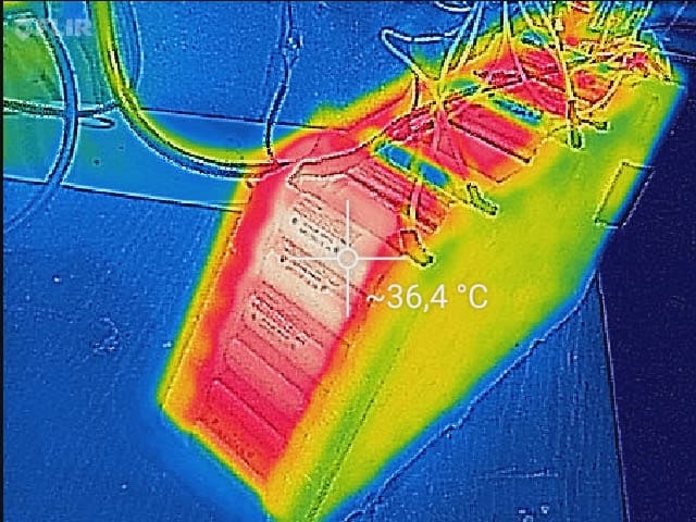

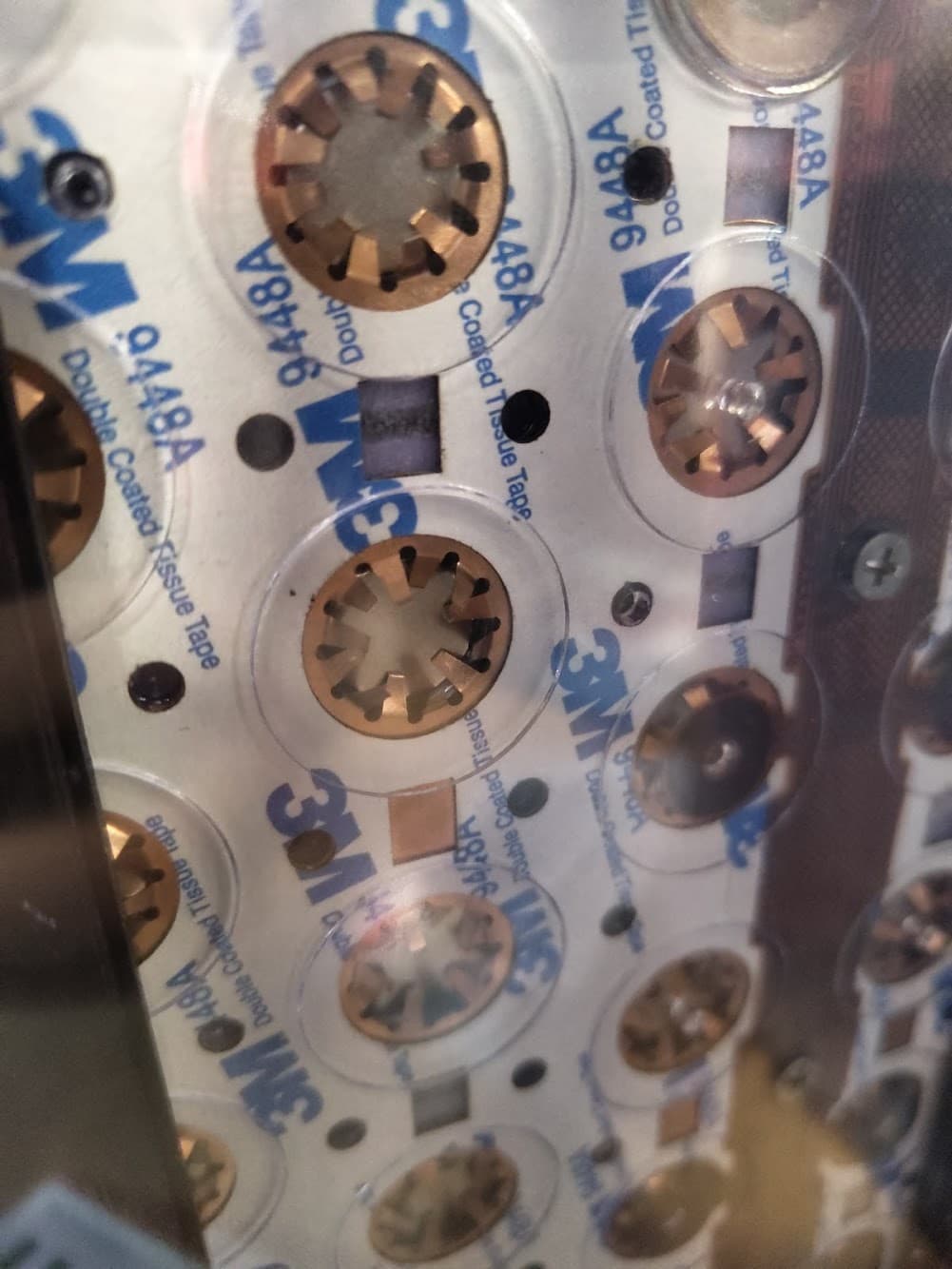

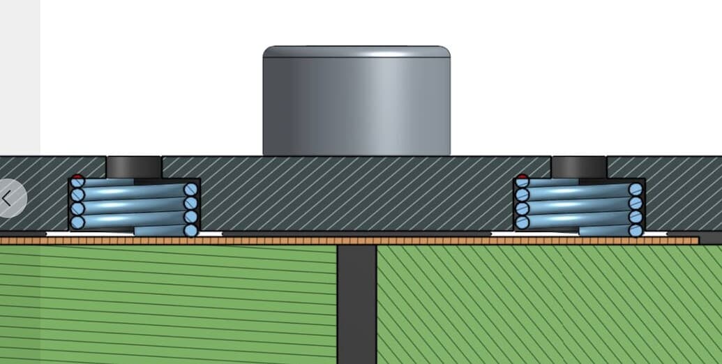

Cells holder has holes for springs, springs push on nickel, nickel carries the load. This 10S6P was used without issue for a while.
Thermally, there was no visible hot spots on the strips :

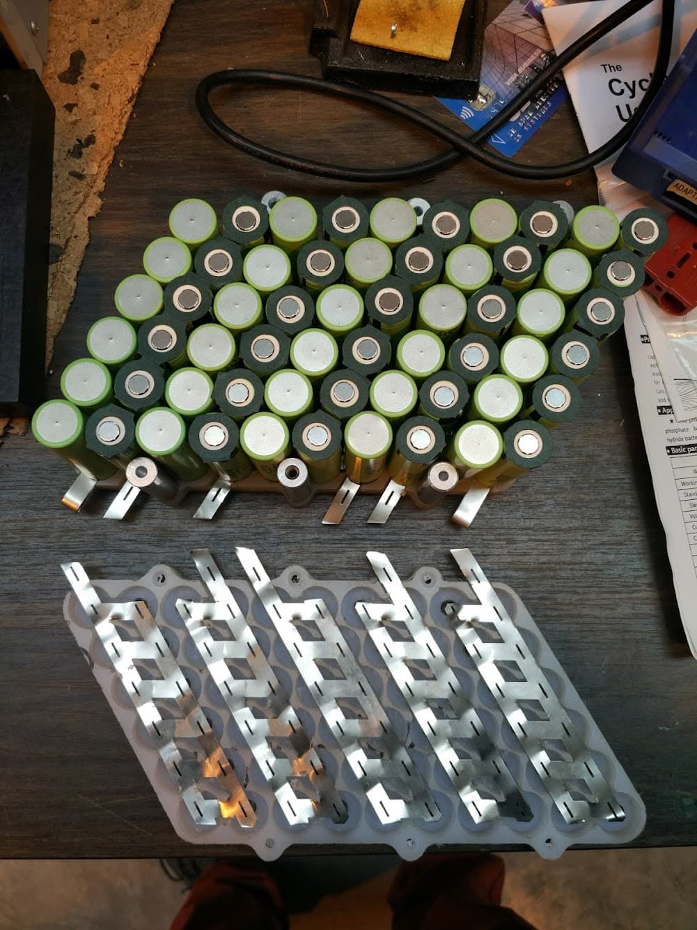

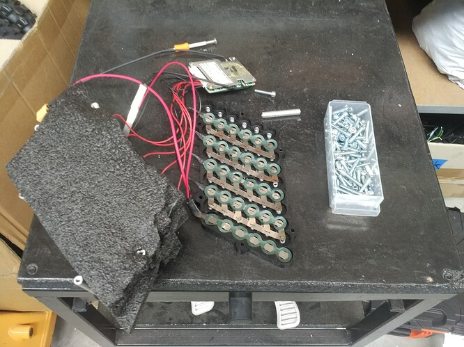

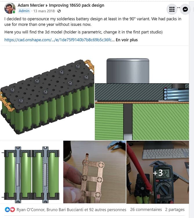

Had a design file back in the days :

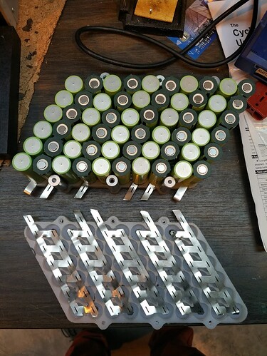

Other things I have seen done :
Also discussed here :

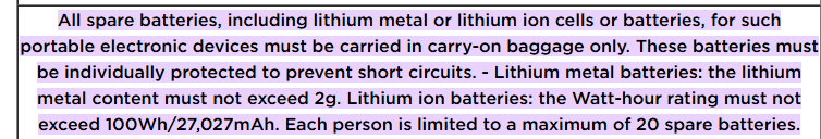

Seems like the travel is a bit of a minefield with some flights going well and some not so well. Nothing clearer for airlines than individual cells and the limit appears to be 20 batteries under 100Wh.
Much simpler than the multiple 6S1P and the new cells are pushing 6S1P over 100Wh anyway.

Making a solderless battery is easy, making one able to handle 50A per cell is a whole other game, and making it as a kit that can reliably be assembled by amateur technicians and be lifetime reliable and safe in salt water is an almost impossible challenge. :laughing:
@Bzhwindtalker this is a great idea just not so sure on how doable it is!
If we could reliably design a pull apart battery, that is contained within a waterproof case would be a game changer!
Some serious design effort would need to go onto this though…

These are Virgin Atlantic’s rules:
If I travel with family thats 80 cells
Or if I configure 6s1p packs 480 cells :rofl:

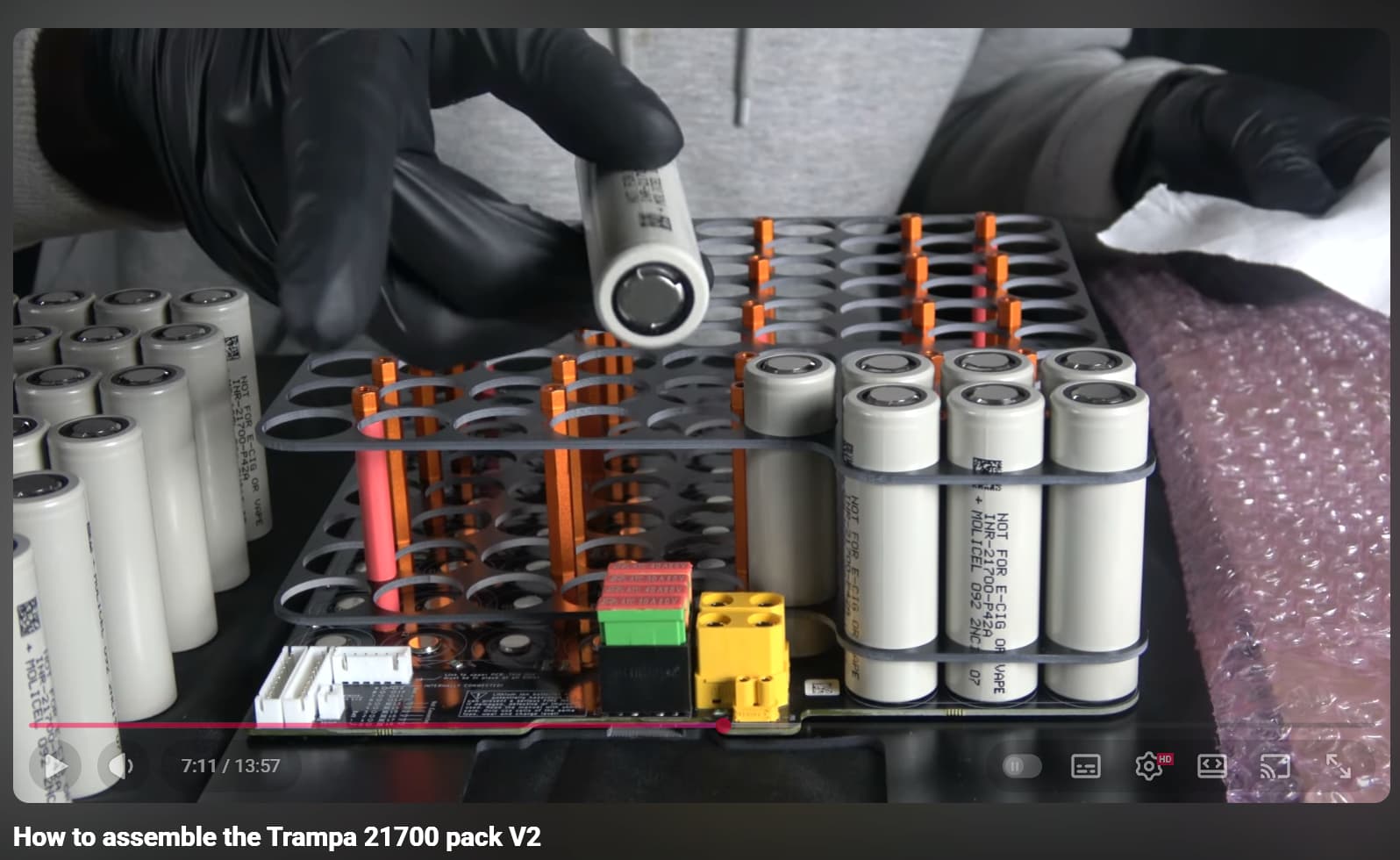

Then trampa actually sells a pcb based battery kit. However being a 7P pack and having 20A fuse on each cell, this pack has much lower amps/cell than you are planning.
