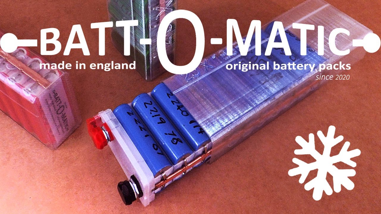

What do you think about this solution : https://www.batt-o-matic.com/
