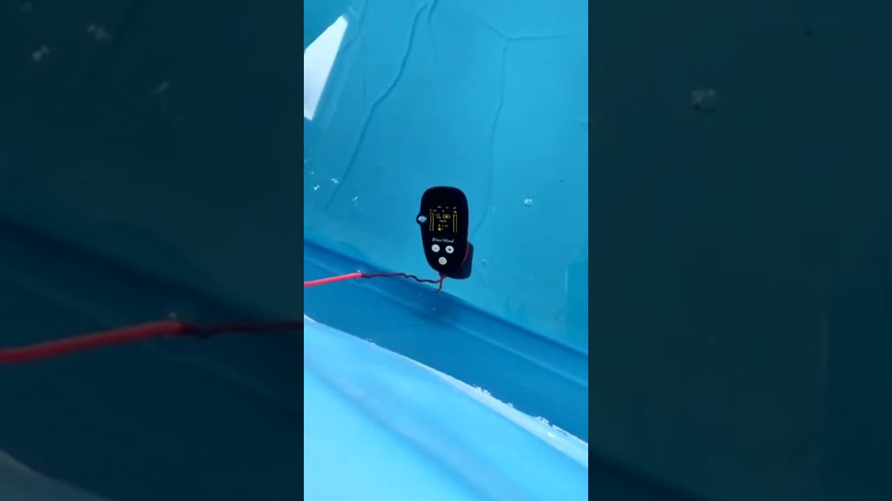

waterproof remote controller underwater test.
Depth:30cm
Duration:10minutes
