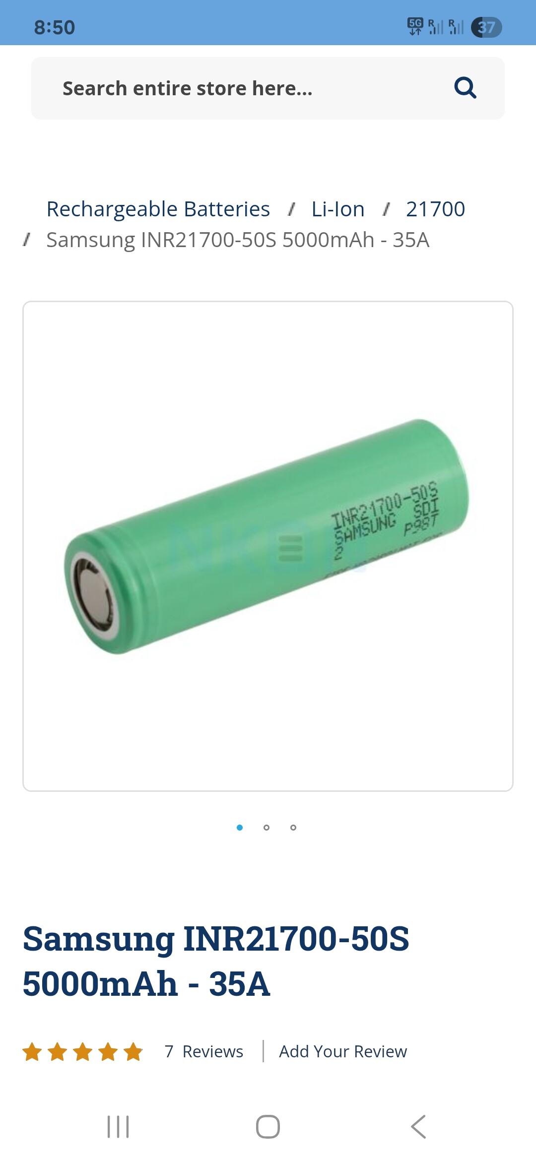

Samsung 50S - I use 2 battery 14s10p of them.
I can only find data for Samsung 50E, not 50S
https://www.nkon.nl/en/samsung-inr21700-50s-5000mah-35a.html
