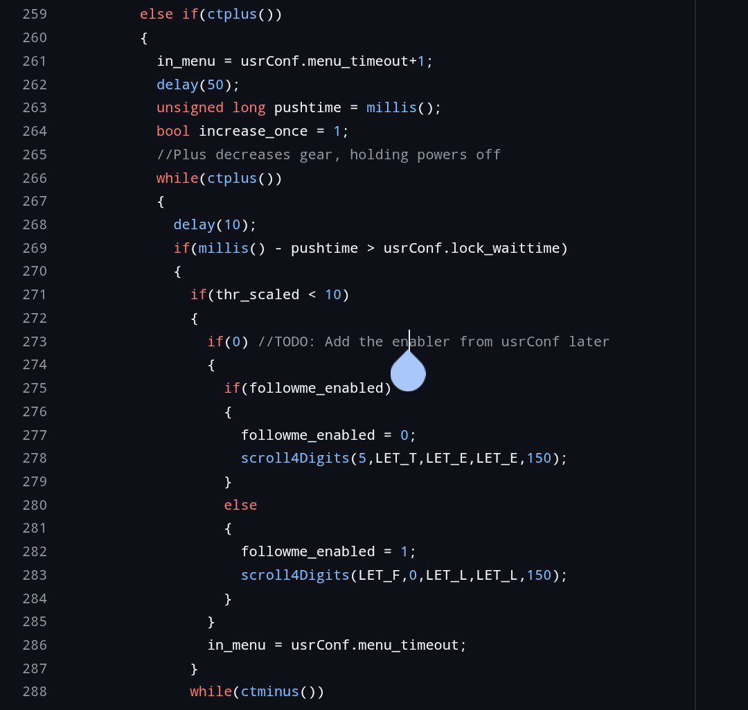

Would be nice if you could use the same conf struct and the same user interface button to enable/disable follow me (both are already in the current GigHub version of my “original” code btw)
Check line 273 in Hall.ino for the enabling function
Just need to enable the if(0) function and then you can use the followme-enabled variable

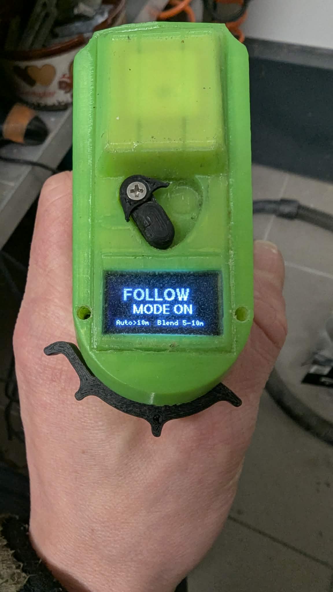

For now for testing with small wheeled boogie I went for this logic :
Hold trigger on turn on, follow mode enabled, classic mode otherwise.
Foiler speed >5kmh, follow mode when throttle pressed (max throttle proportional to trigger input), 100% throttle (settable max for follow mode) to distance over 10m. 10-5m down to max 50 % throttle, stop under 5m.
So it would follow with min 5m distance.
If foiler speed under 5kmh
follow mode to 10m, 50% to 5m.
Under 5m full manual mode, needs trigger to be relased to go to manual mode, safety so boogie will not go full throttle when comes to 5m radius.
Manual mode will latch and follow mode will be active again when distance is >8m.
All distances and speeds are settable only in code for now, spiffs would be nice to implement for easy adjustment.
Also using vibration motor, will vibrate if gps or radio signal is lost, so rider will now if there is a problem with following.

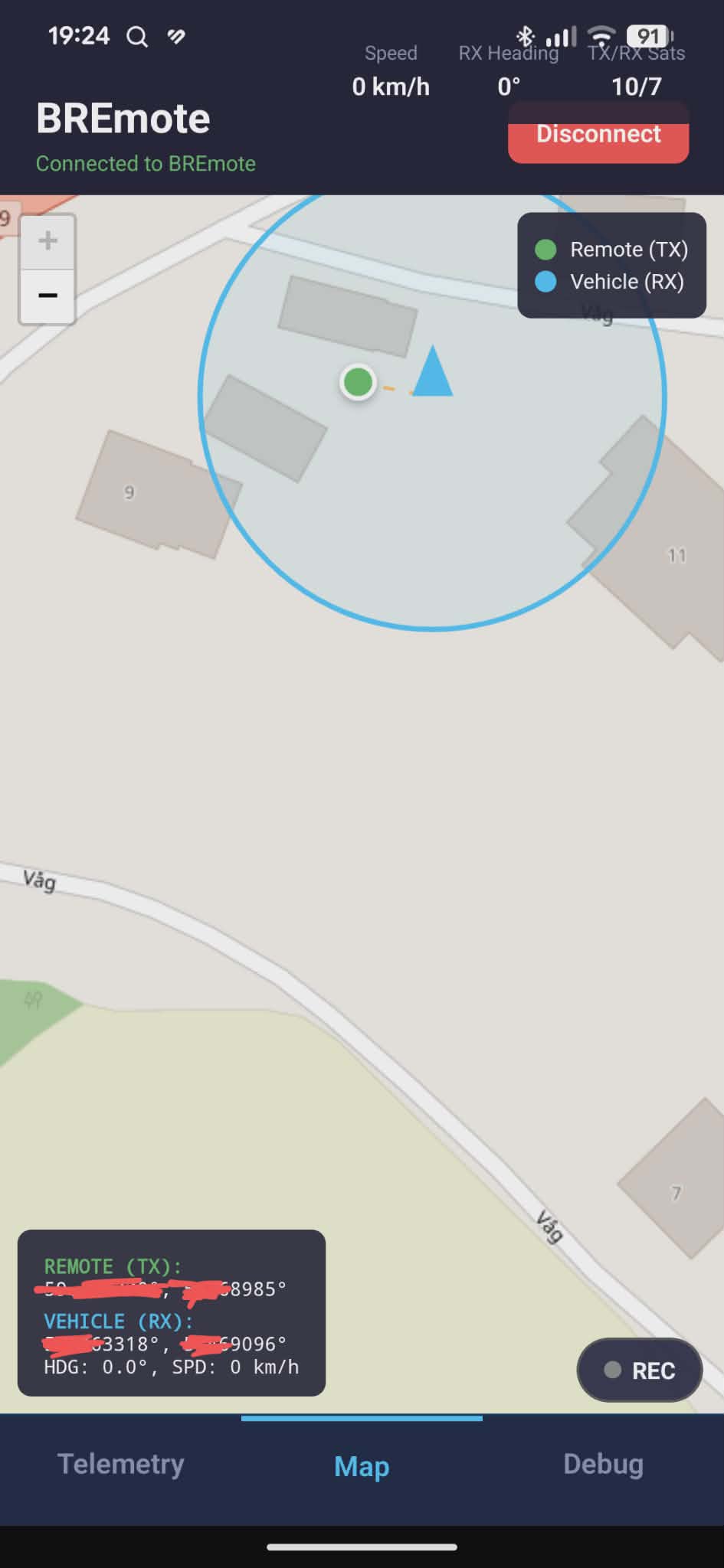

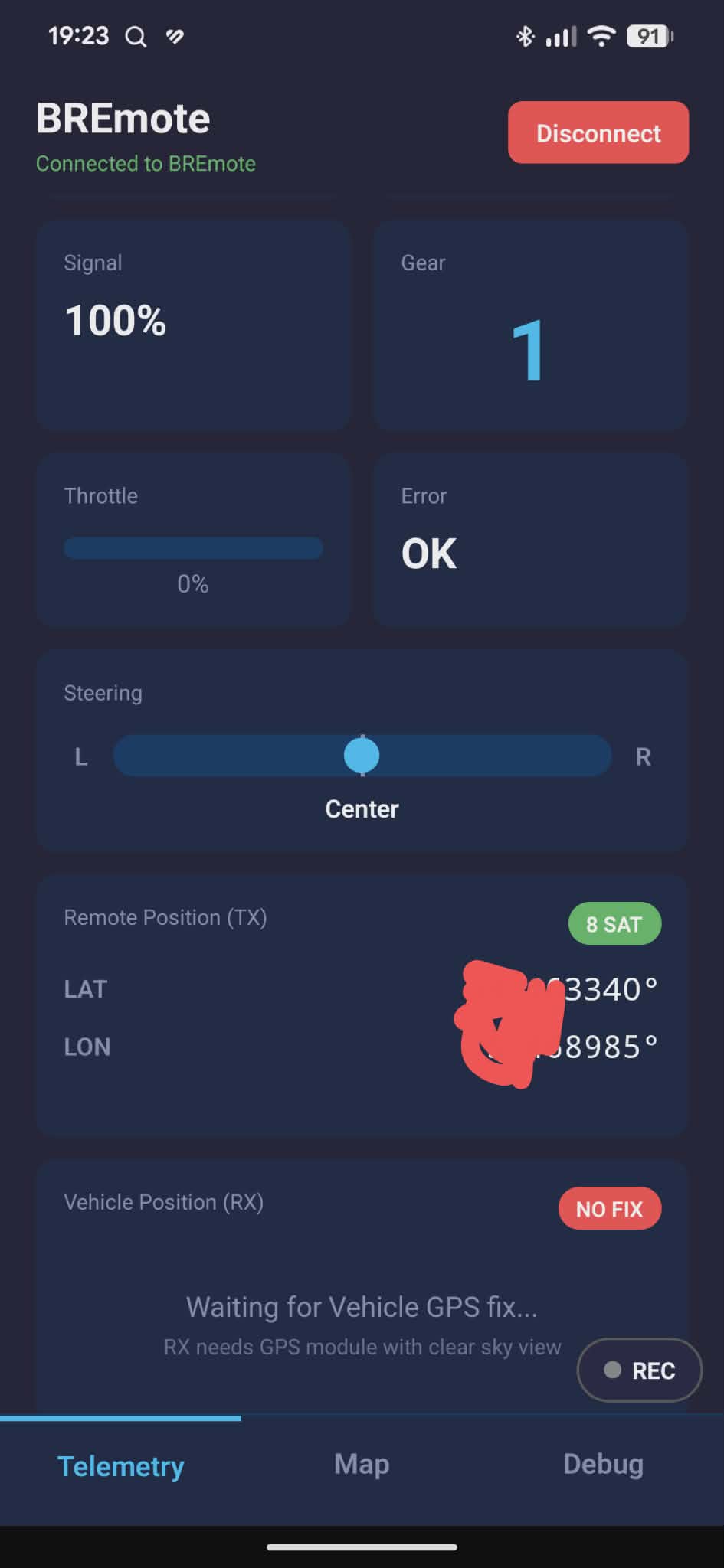

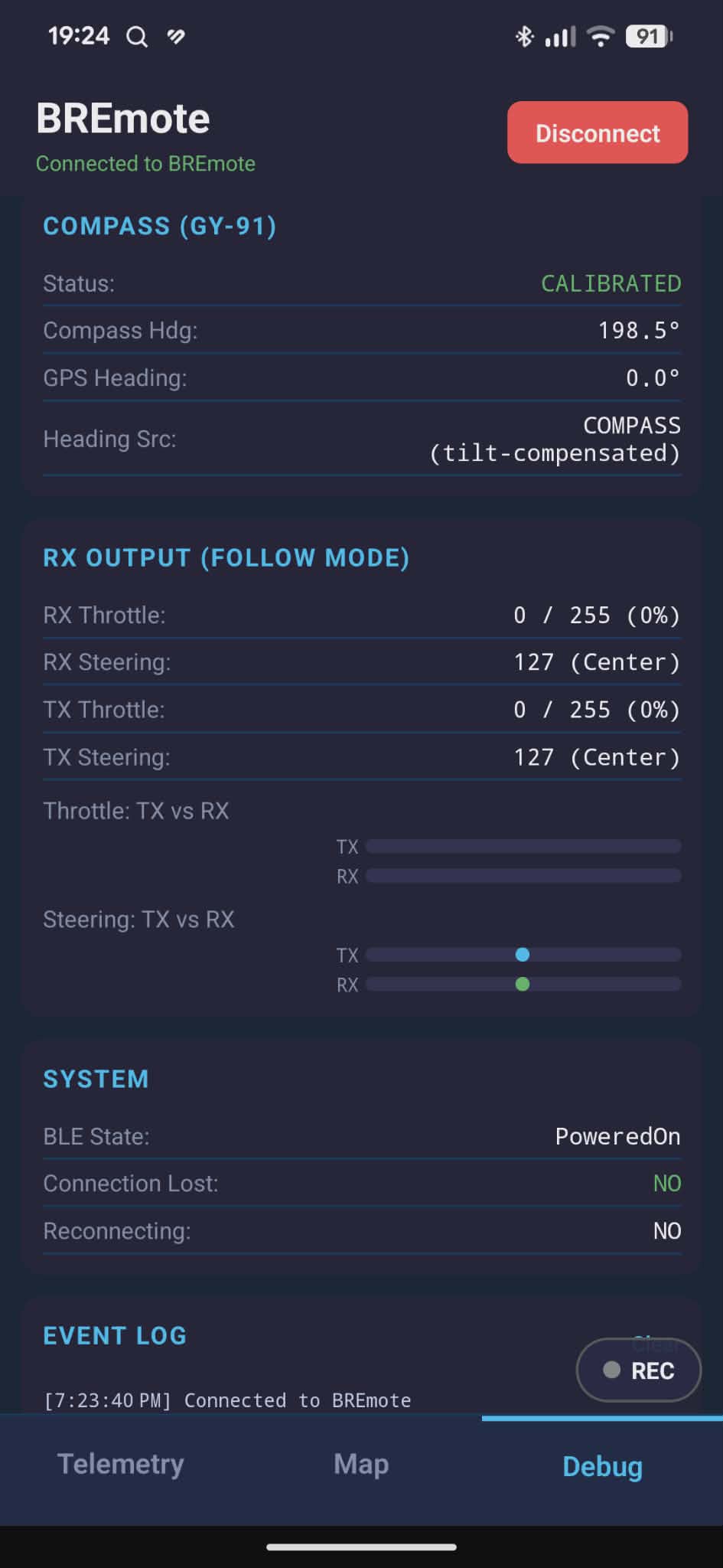

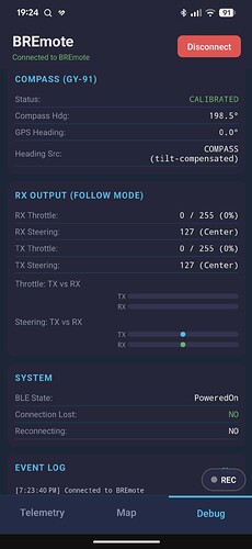

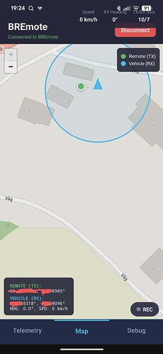

Also Bluetooth is enabled now and there is an app for debug (for now) and datalogging.

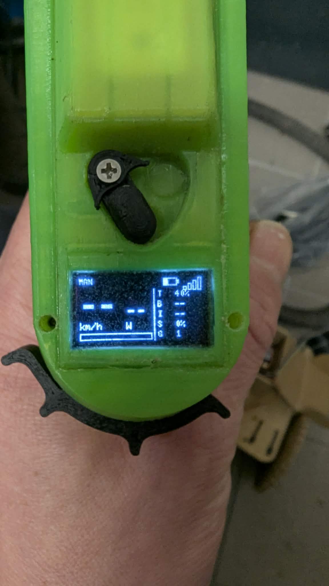

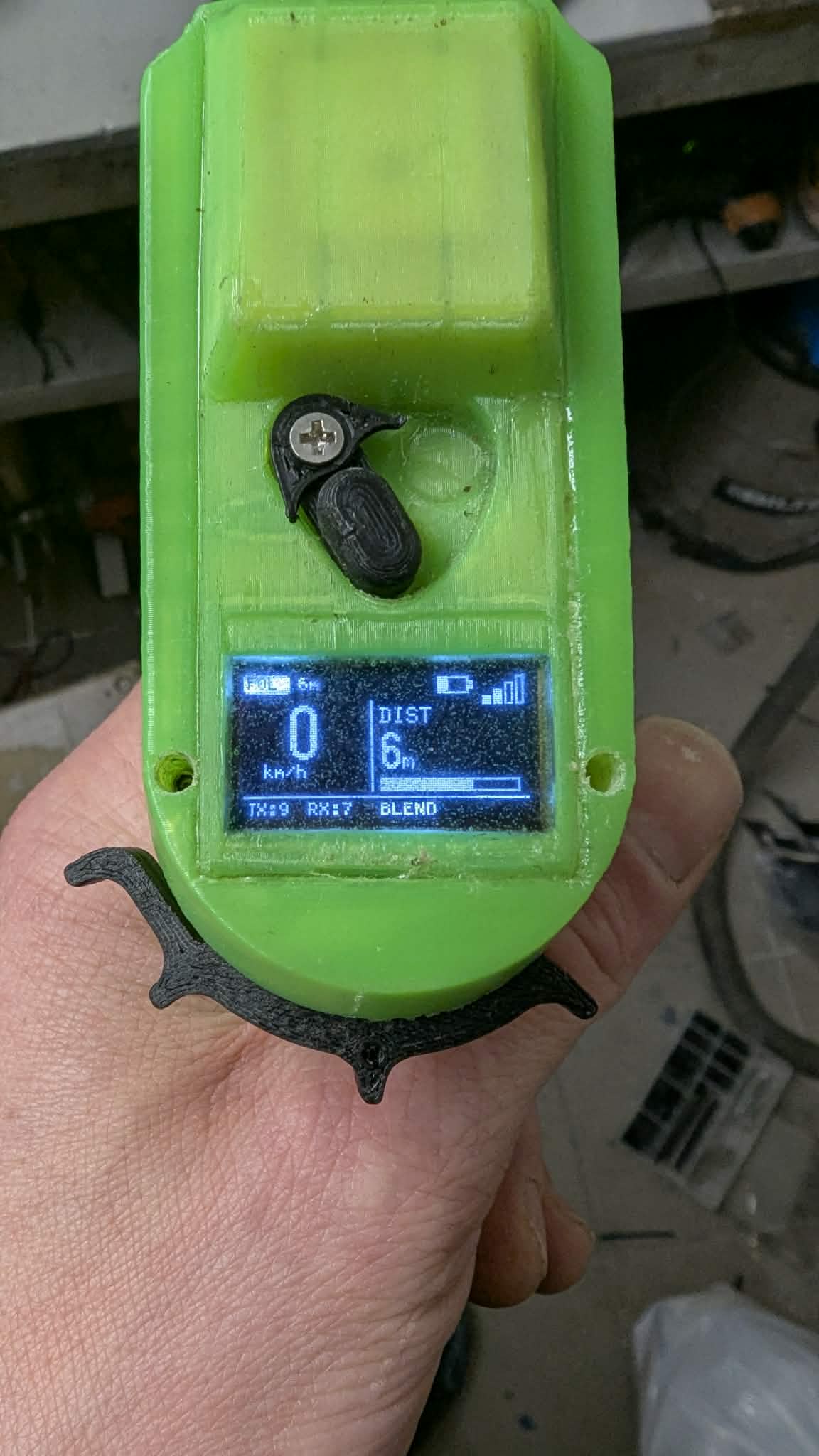

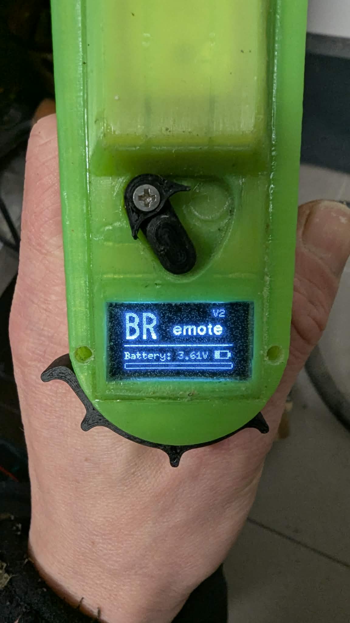

Before all this I have replaced dot led screen with 128x64 oled screen, not tested on water yet.
Will add some pics for inspiration :slight_smile:
There are some micro air bubbles in epoxy screen potting. Looks better in real life

Looks very nice what you got there for sure!
