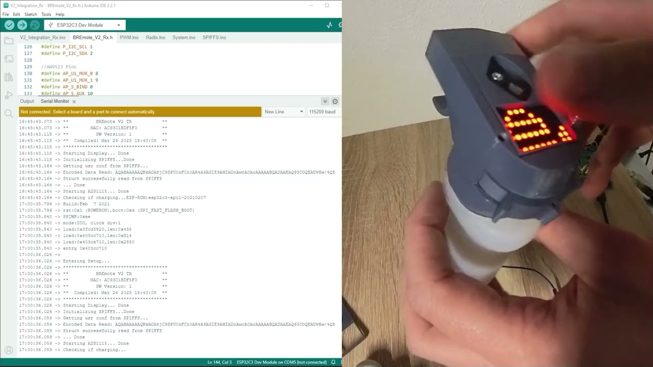

I have some success - still an issue with custom timer triggered with throttle activation. I want a dedicated timer only if throttle > 0. Some issue in my loop. Need to take more time to debug.
When no Vesc:
When Vesc:

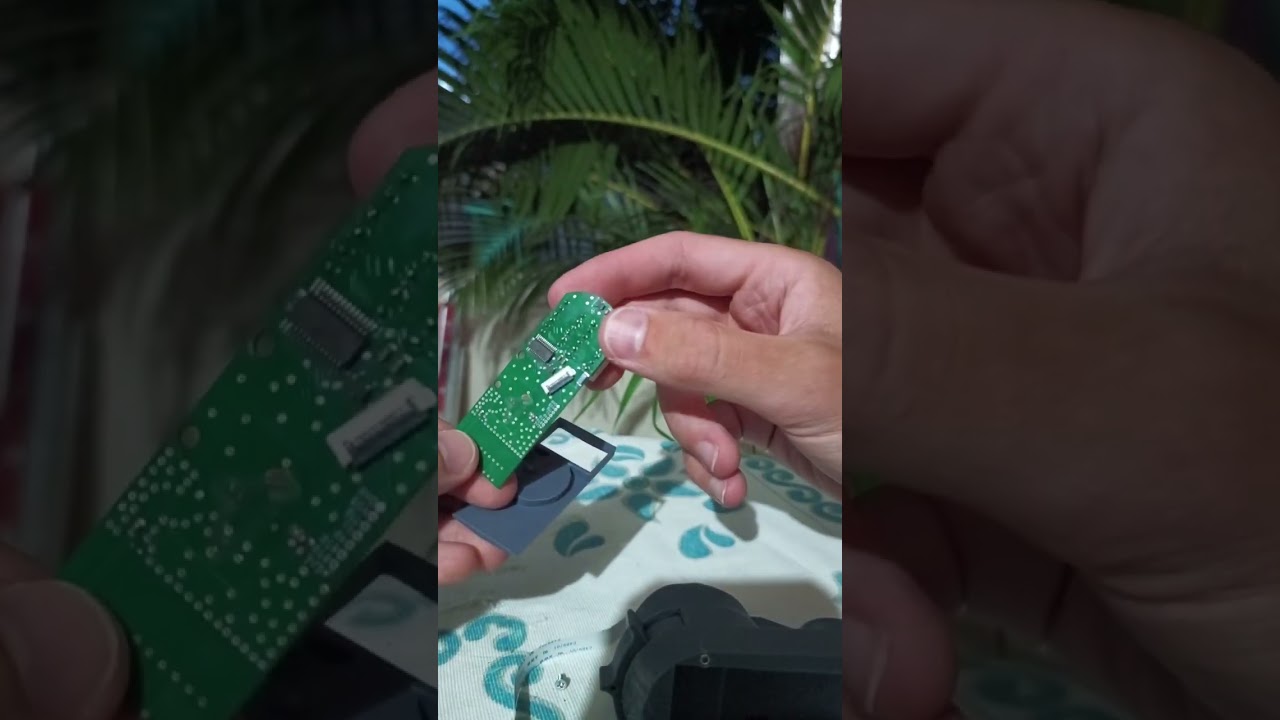

Update time :slight_smile:
Made quite some progress in the last few days!
:white_check_mark: Hardware Updates
The Tx hardware is fully tested and working fine.
I’ve finished designing the Rx board, and the optional BEC board is still in development but should be done shortly.
Preview of the Rx:
:satellite: Antenna Tuning
While the first Rx prototype is being manufactured, I took another look at tuning the antennas for the remote. Progress is going well—the antenna is already usable, but I want to optimize it further for even better range and reliability.
:desktop_computer: Software Progress
The software is mostly complete, including all basic functionalities.
:video_game: New Remote Design
I’ve also started developing a second style of remote. This version is primarily designed for eFoil rather than tow boogie, as it has reduced steering capabilities. As a result, it will be more compact and cost-optimized.
One of the most exciting aspects is the throttle input mechanism, which I haven’t seen on the market before. Instead of a traditional throttle, you hold an eccentric “kidney” with both your index finger and thumb. From my testing, this improves precision and comfort significantly, as both fingers can work together.
