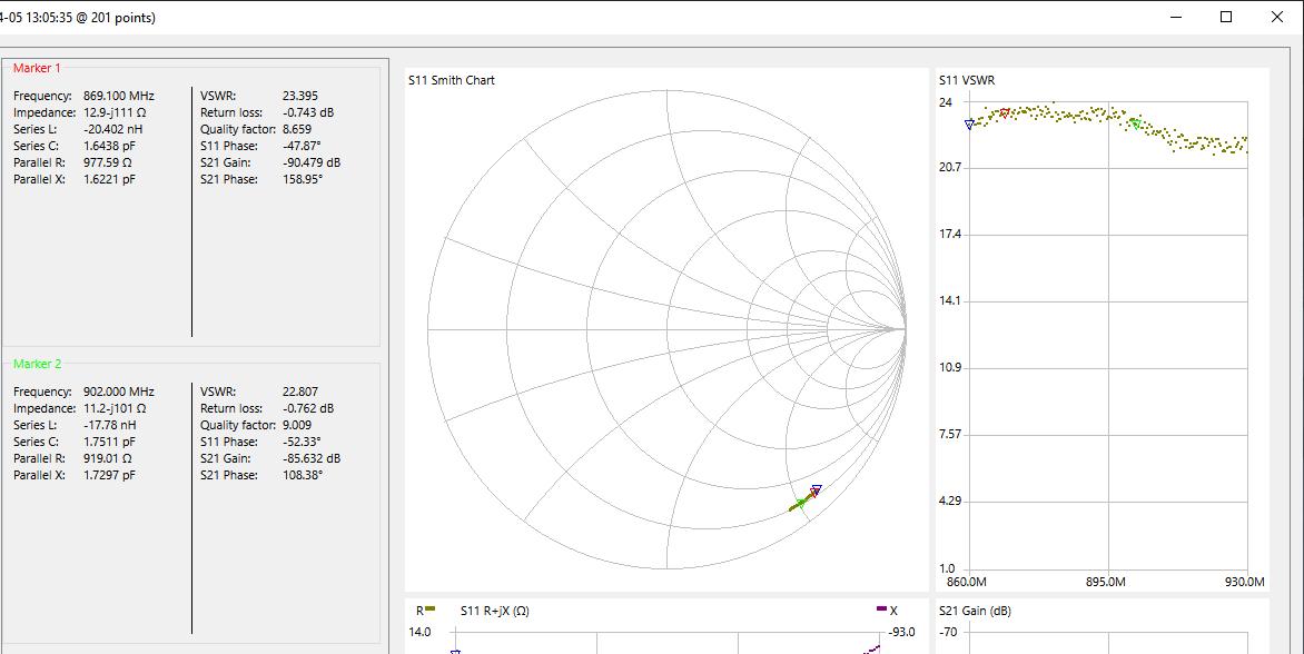

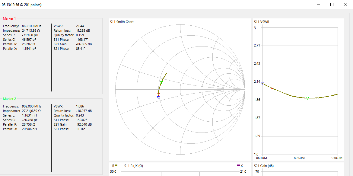

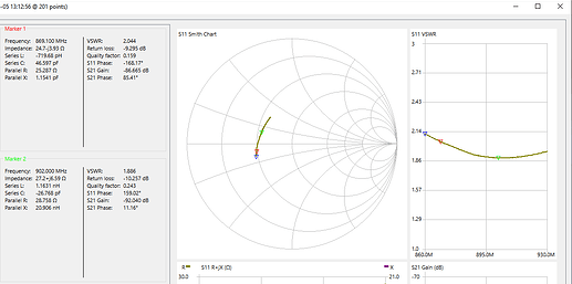

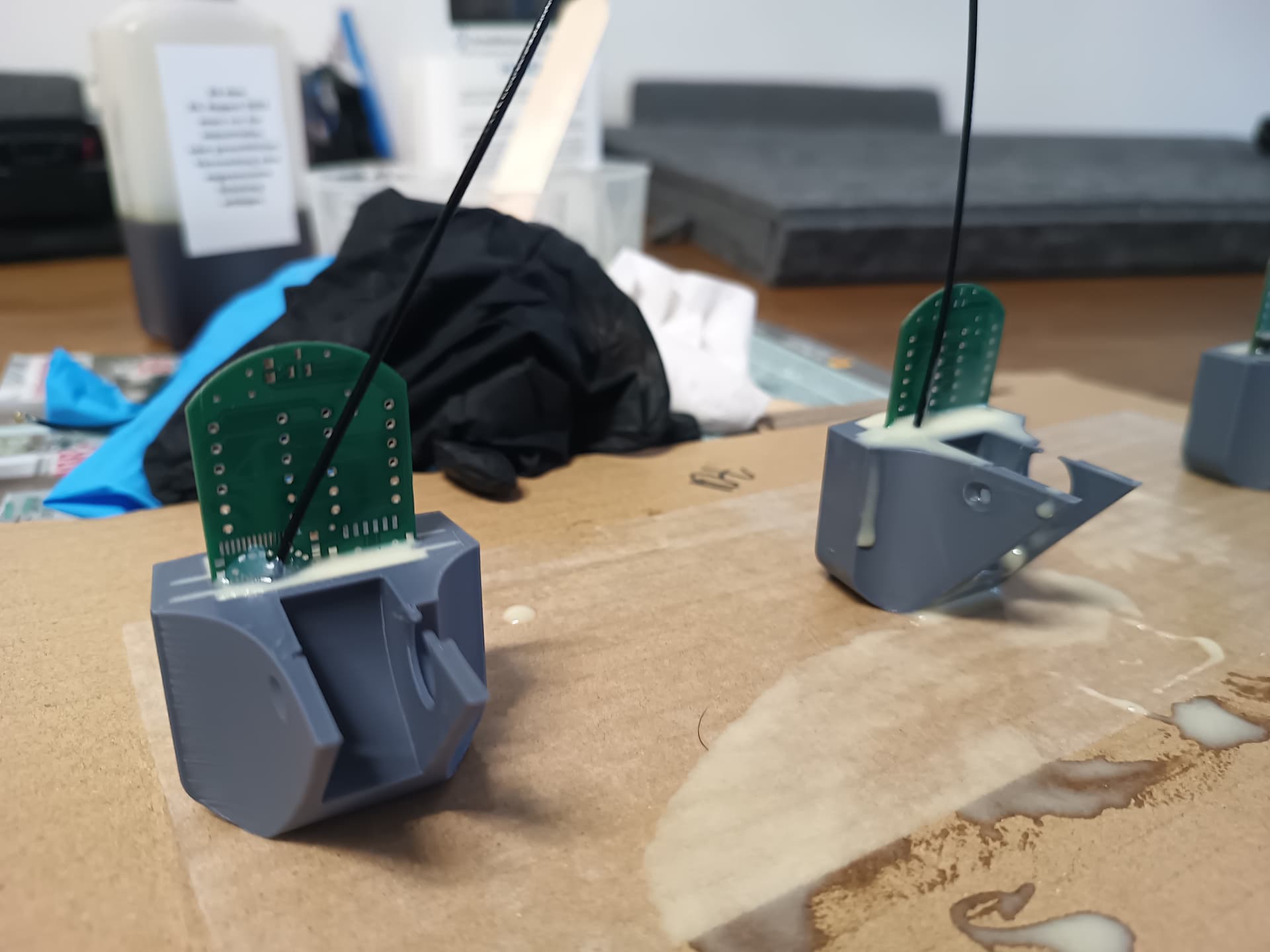

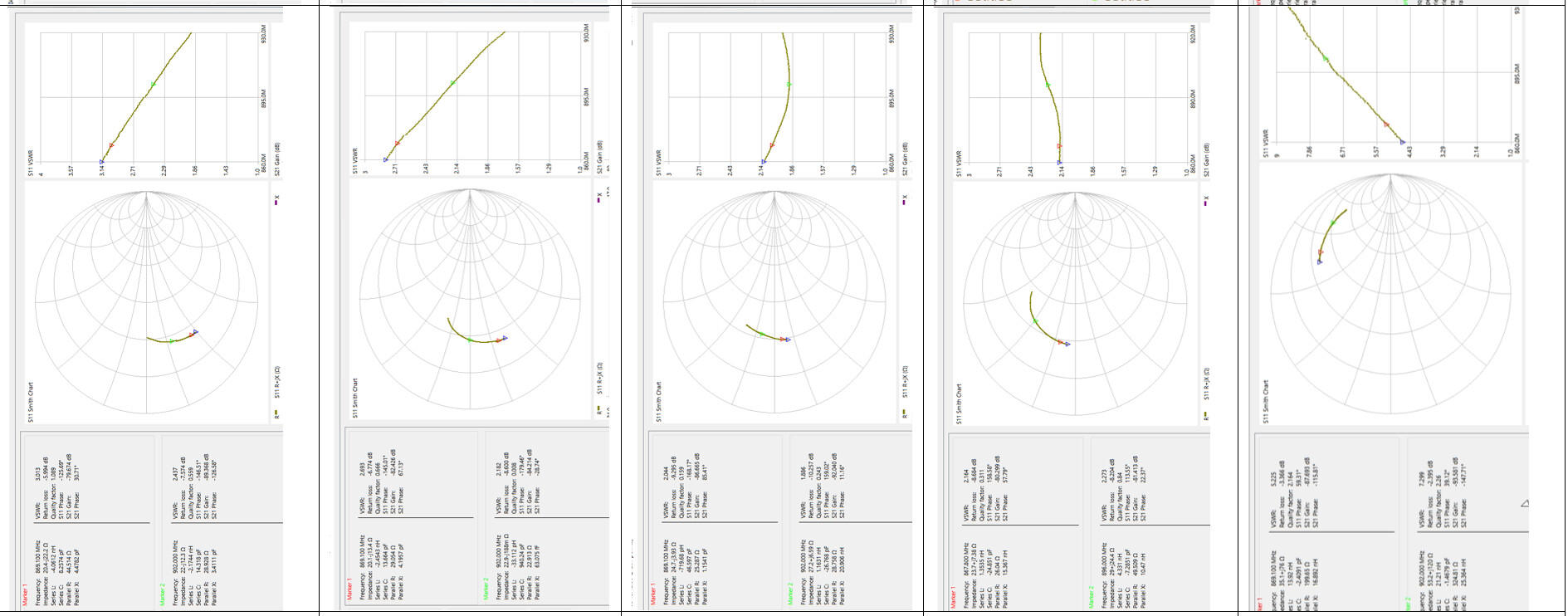

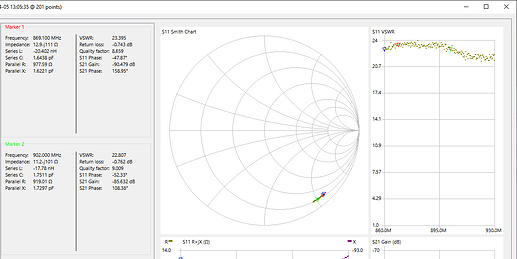

Small update, antenna testing is coming along nicely.
I am currently optimizing for the 869MHz (Europe) and 902MHz (America)
Currently favorite design, unmatched antenna:
Without potting compound:
With potting compound:
I did not expect the potting compound to have such a big effect… miraculously one of my designs still hits VSWR <2 after potting, even without any matching network.
