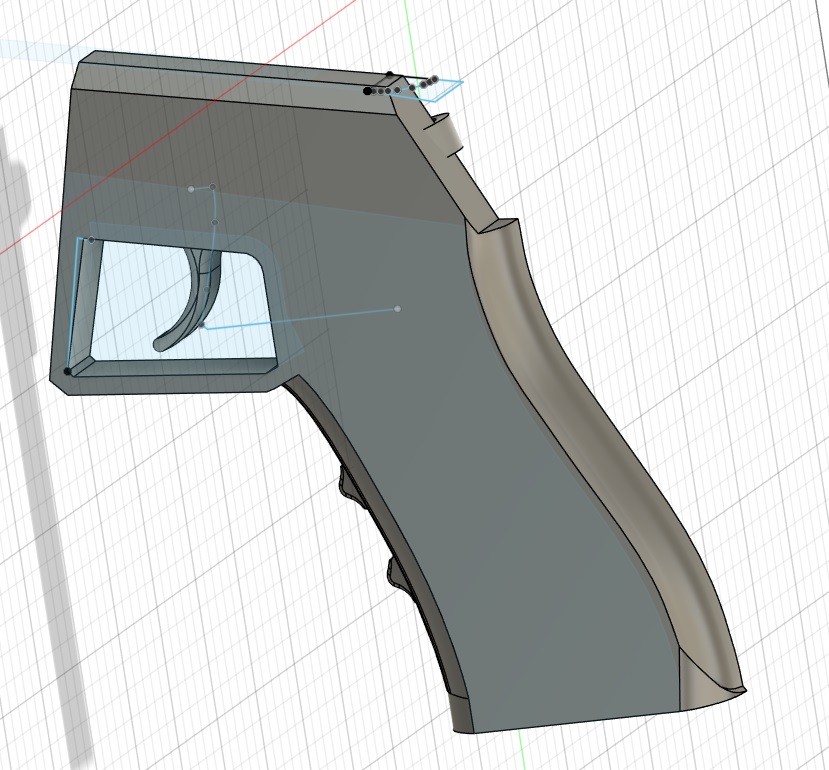

so your version with the pistol grip do you have a model I can steal, I need to replace the one I had in my rough draft prototype for another one, was just wondering if you had something ready before I start making a new one.
I made a model for the previous version of the Bremote. But I didn’t have enough knowledge to finish it. Either the selector or the trigger worked well, but not both. Also, during preliminary tests, the range was shorter than I expected, and I abandoned the project. For this version, I only have a rough model. You can steal it if you want.
Rough model is good enough for me just need a half decent model to work off :slight_smile:

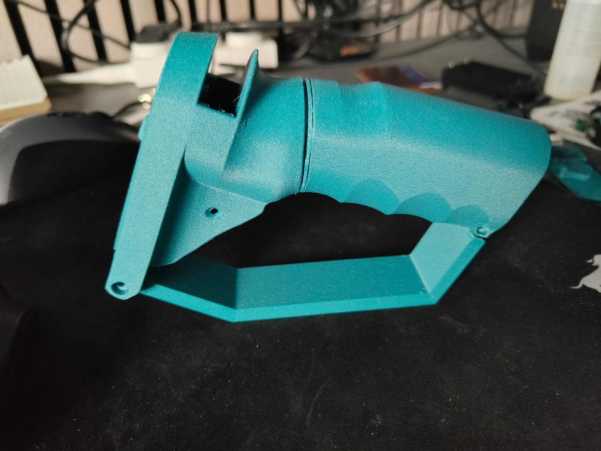

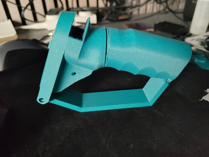

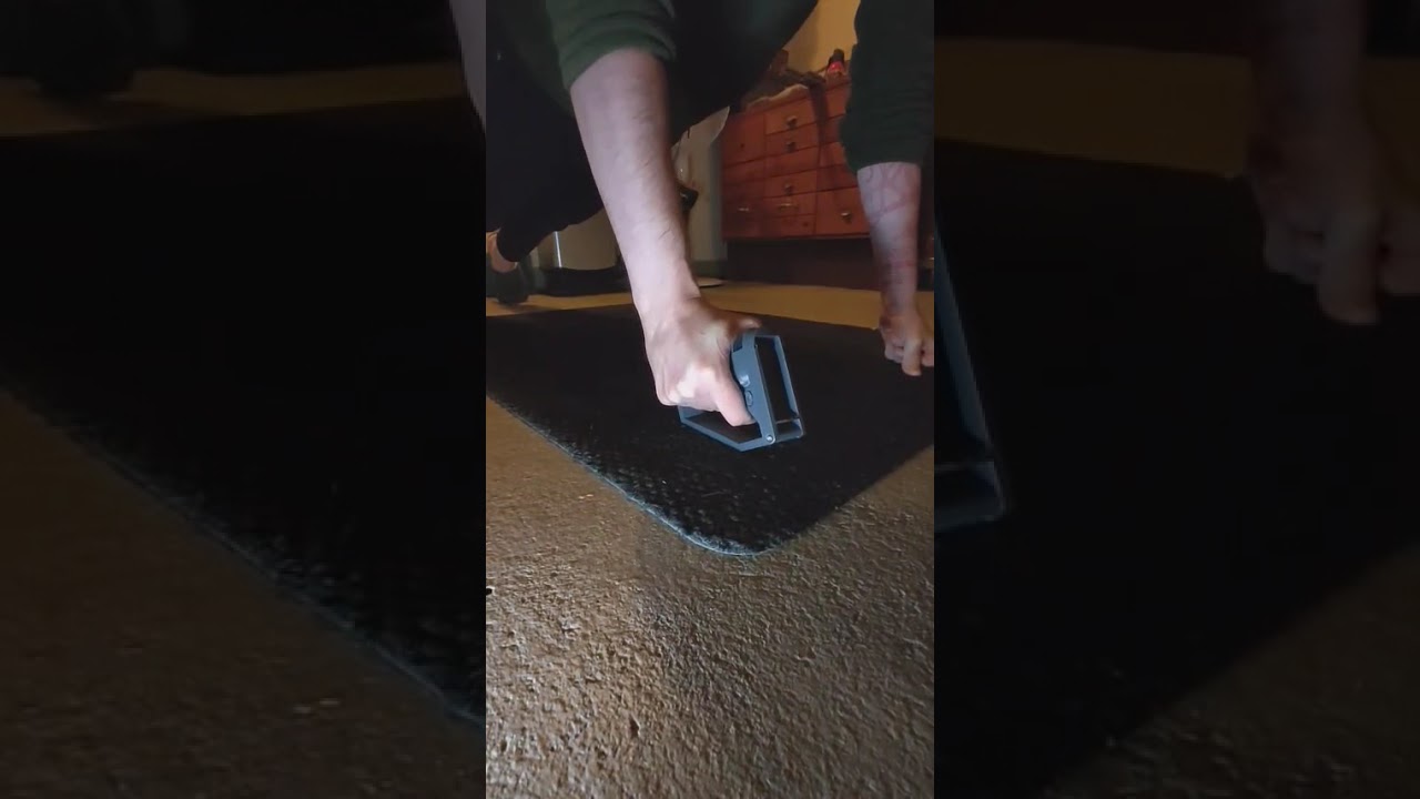

So I did a stresstest of the Bremote V2 remix of me, I have made a Magpull style grip, which I will slim down a little and I used just regular ABS nothing reinforeced and I used gorilla glue, the idea was that it would fail, but after 6 sets of 3-5 push ups it didnt.
I will futher refine the designs, but what was impressive it did not break, it required that I did a 1 hand push up for it to break, which makes me confident that this design will hold up if you dont be reckless :slight_smile:
Some more photos for the curious, I will change the design ever so slightly.
I am quite impressed with the durability! Nice work

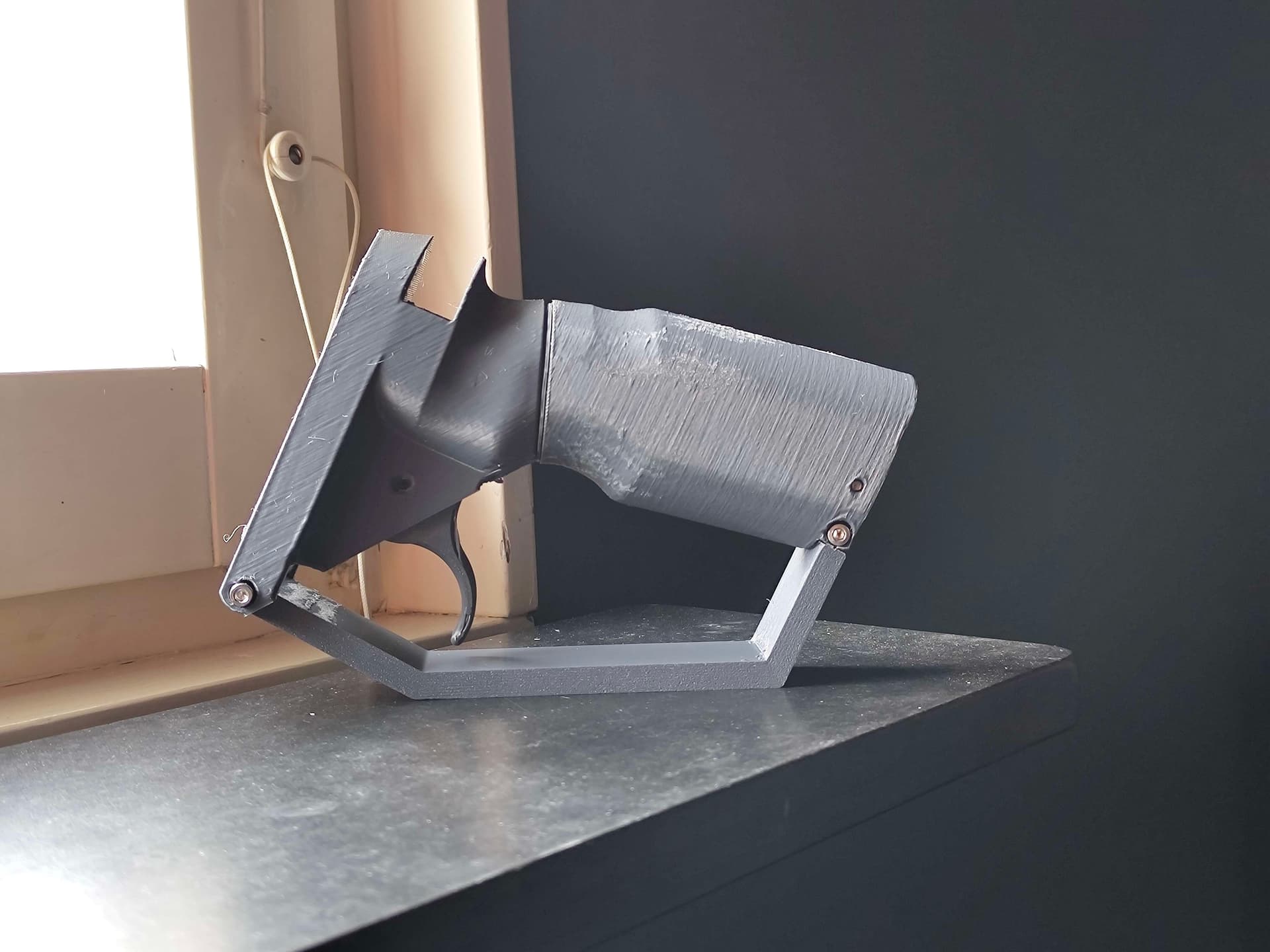

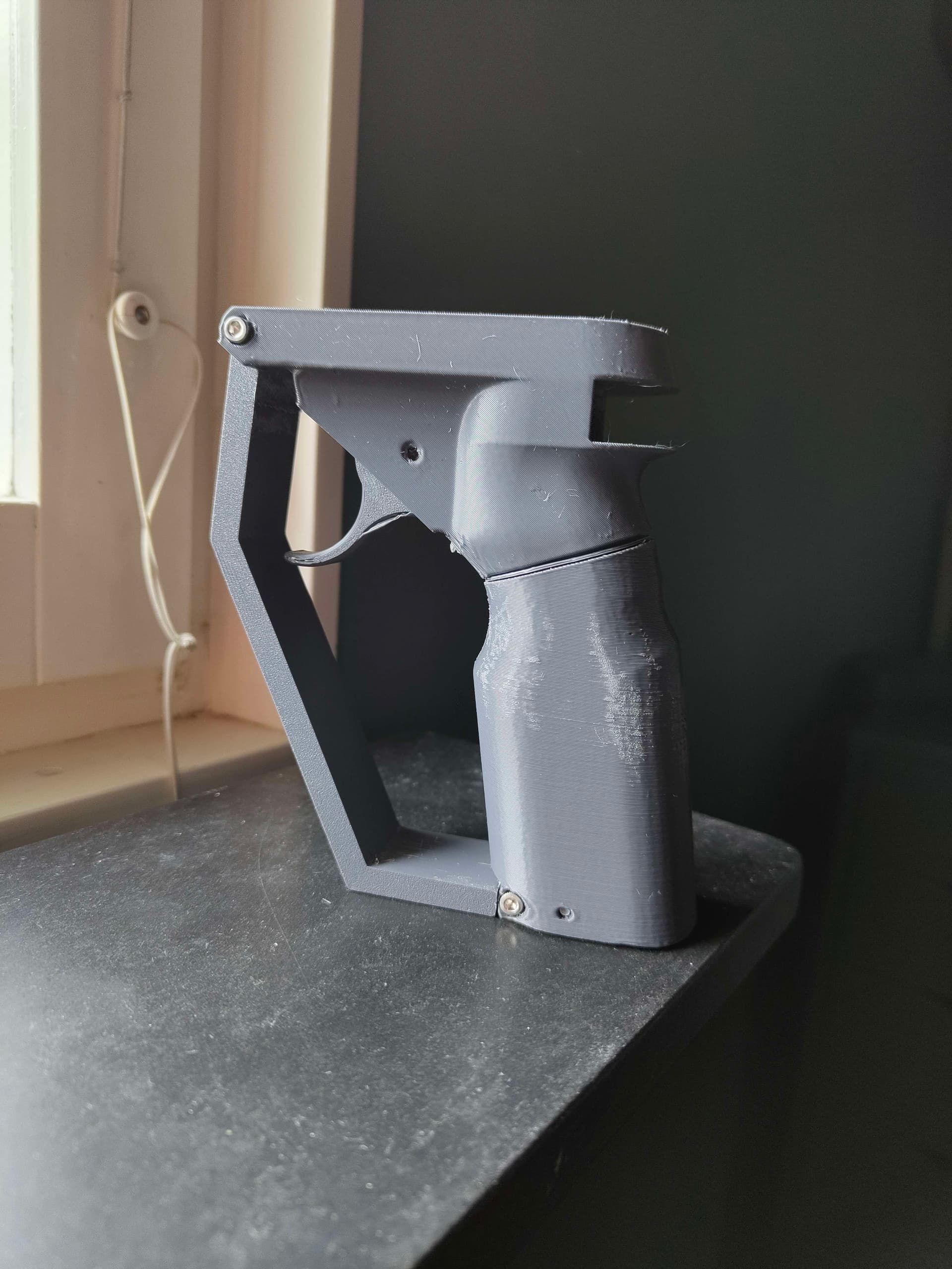

V2 printed in ASA GF coming along nicely, besides being able to sustain push ups the design is good enough for a first prototype, just waiting for the internals to be delivered.

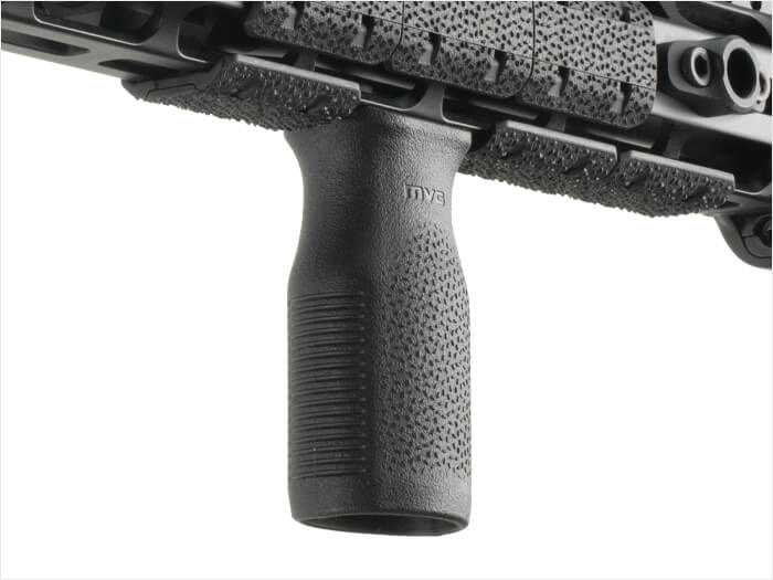

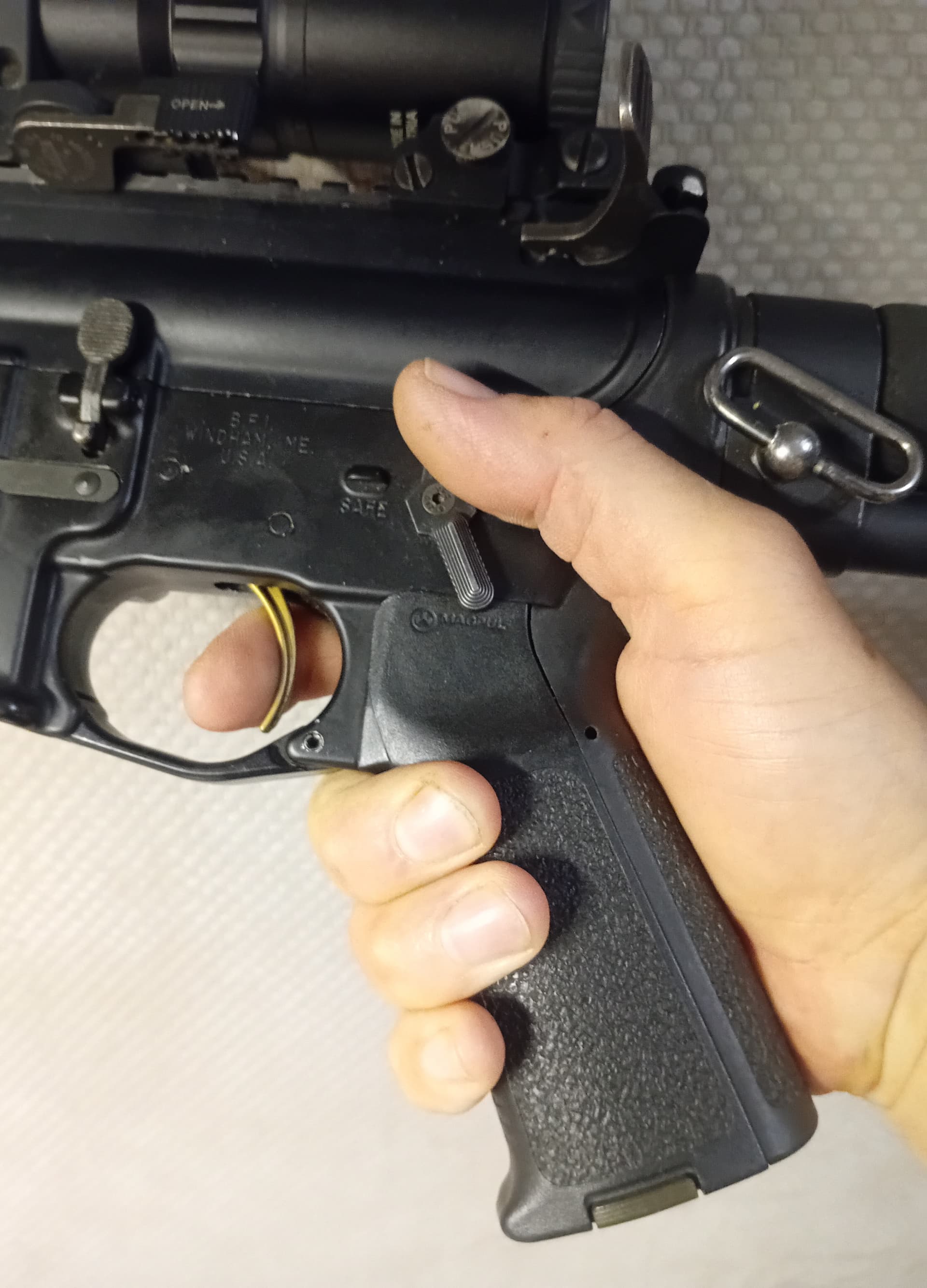

Sorry, but that’s not even close to a Magpul. Here’s a Magpul. Notice how much space there is in front of the trigger. This is necessary so that your finger can rest comfortably inside the trigger guard without the risk of accidentally pulling. And that narrow gap in your photo completely destroys the idea of the trigger guard as a safety element.
It’s modelled from a magpul vertical front grip, mostly because I like the size and shape of it, I have since remodelled it slightly to fit this use case more, point of it was to allow gloves, protect the trigger and have grooves for all four fingers.
No it is not the pistol grip, it doesn’t fire bullets so the gap doesn’t need to be massive, but the gap is plenty from my initial testing do allow finger to be off when not in use, will post the built version shortly.
I’m glad you like the front grip, but it serves a completely different purpose. Well, I think further discussion is pointless. Without your trigger guard, the remote will be much safer - that’s my firm belief, based on many years of experience using a wide variety of grips.
