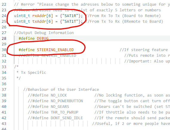

To troubleshoot, I first configured the throttle-only feature on both the receiver and transmitter and set it up on VESC. After some tweaks, it worked flawlessly. Then, I enabled #define SERVO_STEERING_ENABLED in the receiver and #define STEERING_ENABLED in the transmitter, and re-calibrated everything. However, there are no voltage readings or servo movements at the steering servo connection.

Shared_Config for transmitter: Circled areas I made a change from default file
Screenshot of Share_Config for Receiver: Circled areas I made a change from default file

@Jesserosco first of thank you for responding. Initially i was planning to replicate your speed differential setup with two escs, but to save money i returned the escs and using single beefy 75350 esc from previous efoil build, reconfigured it to run two 6384s with servo and rudder. I changed the configs of receiver & transmitter according to Ludwigs videos, and posted snap shots of configs in op, but no luck with servo 2nd wires. I don’t know if i missed any other settings in config, but I’m almost 100% sure wiring is flawless, it’s either the settings or the receiver.
