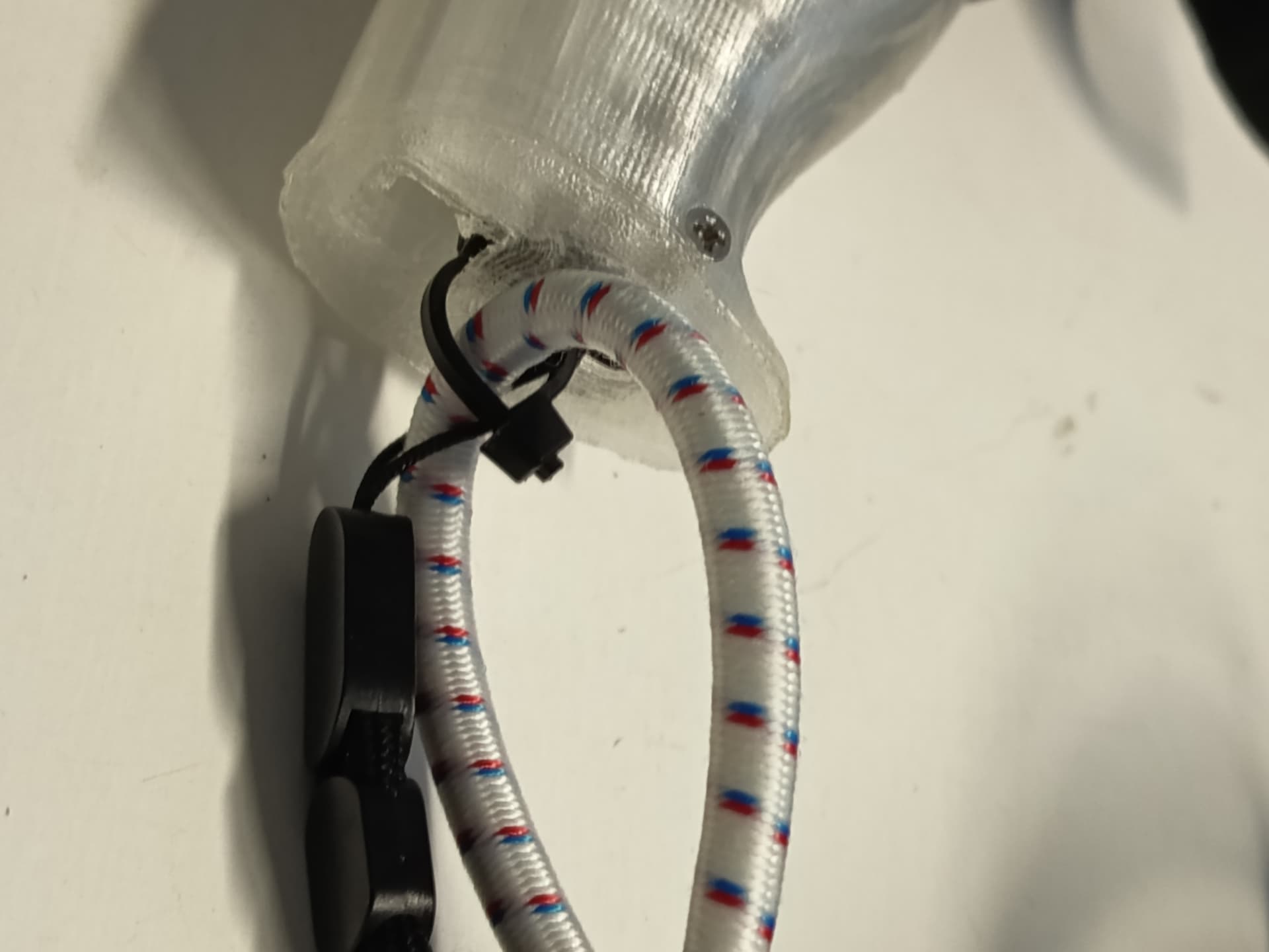

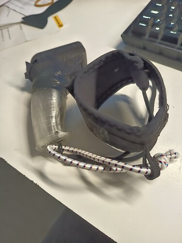

If you rely on the lanyard attachment, make sure it is strong enough.

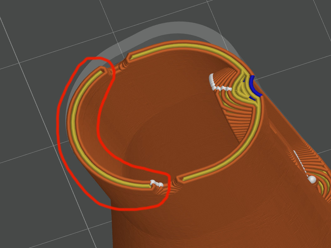

I’m sure, it is just my crappy print quality, but I pulled that right off, when I was pulling the lanyard through the outer handle.
The connection of the lower part of the inner handle and the rest is just 1-2cm with barely any thickness (for me 3 lines of 0.42mm) and is aligned right with the layer lines.
If that part breaks, the lanyard will disconnect from the remote.
As a solution I have the outer handle out of TPU and attached the leash the the small piece between the lanyard and the hole for the usb cable. And then fixed the outer handle to the rest of the remote at the upper end with tape.
I have one of these spare from my Maytech remote. Thanks.
That sounds well thought out. Thanks
