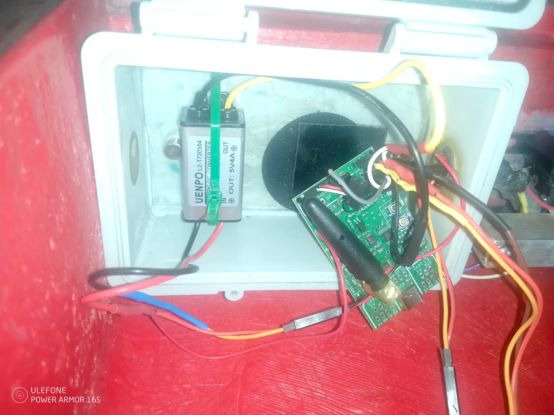

hello ludwig i got a strange micro mouvement in the steering servo all the time and i think that it makes some bug in the direction when it come back to center is there a parameter i can modify

Hey
Can you please check with another servo, this looks like your servo maybe has water inside
Also, how do you supply power to the servo and how do you supply power to the vesc? Do you have a schematic?
servo is supply by bec on the rx it was doing it first time never touch the water do the same in the water, when i turn the remote off it stop with power supply it looks like an order give by the remote, is the steering influence have to be a certain value ?

Which BEC exactly? The BREmote BEC? That can’t be used for Servo, only for ESCs! For servo please get a high current BEC

bec servo is high power 4 amp sold as you said on the rx board
Please provide a schematic and image of the set-up
  • and - from the battery to the be, from the bec to the rx, - to gnd rx, and +from bec to the 5 volt rx and to the 5 volt servo make the bridge as you said, and gnd 5 volt and signal to the servo, esc cable in h
    is place
    the battery pin to check voltage come from the + that is connect for supply the bec
Thank you for the image
It looks correct, can you confirm if the output voltage of the BEC is stable and if the servo has not been damaged by any other reason?
Maybe try supply power with another 5V source instead of BEC and try another servo if you have one?
