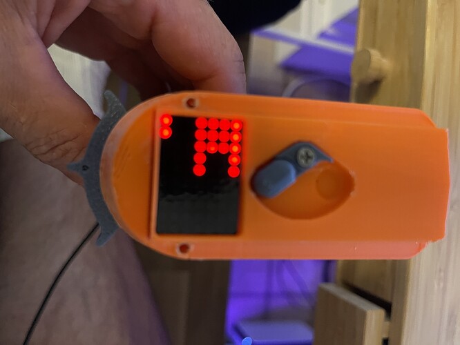

Here the output via serial terminal. The display on the screen looks to be the charging one but missing the end.

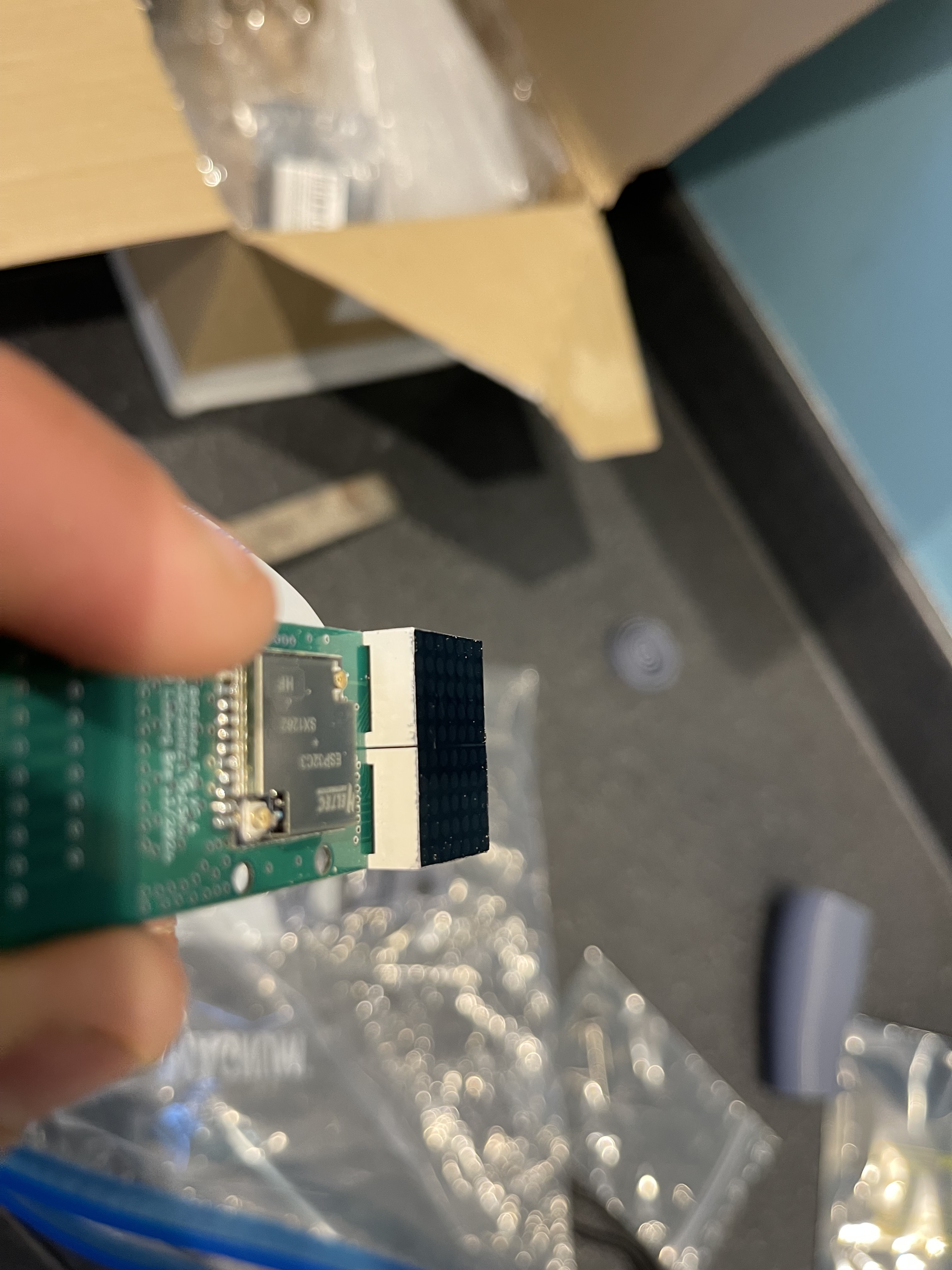

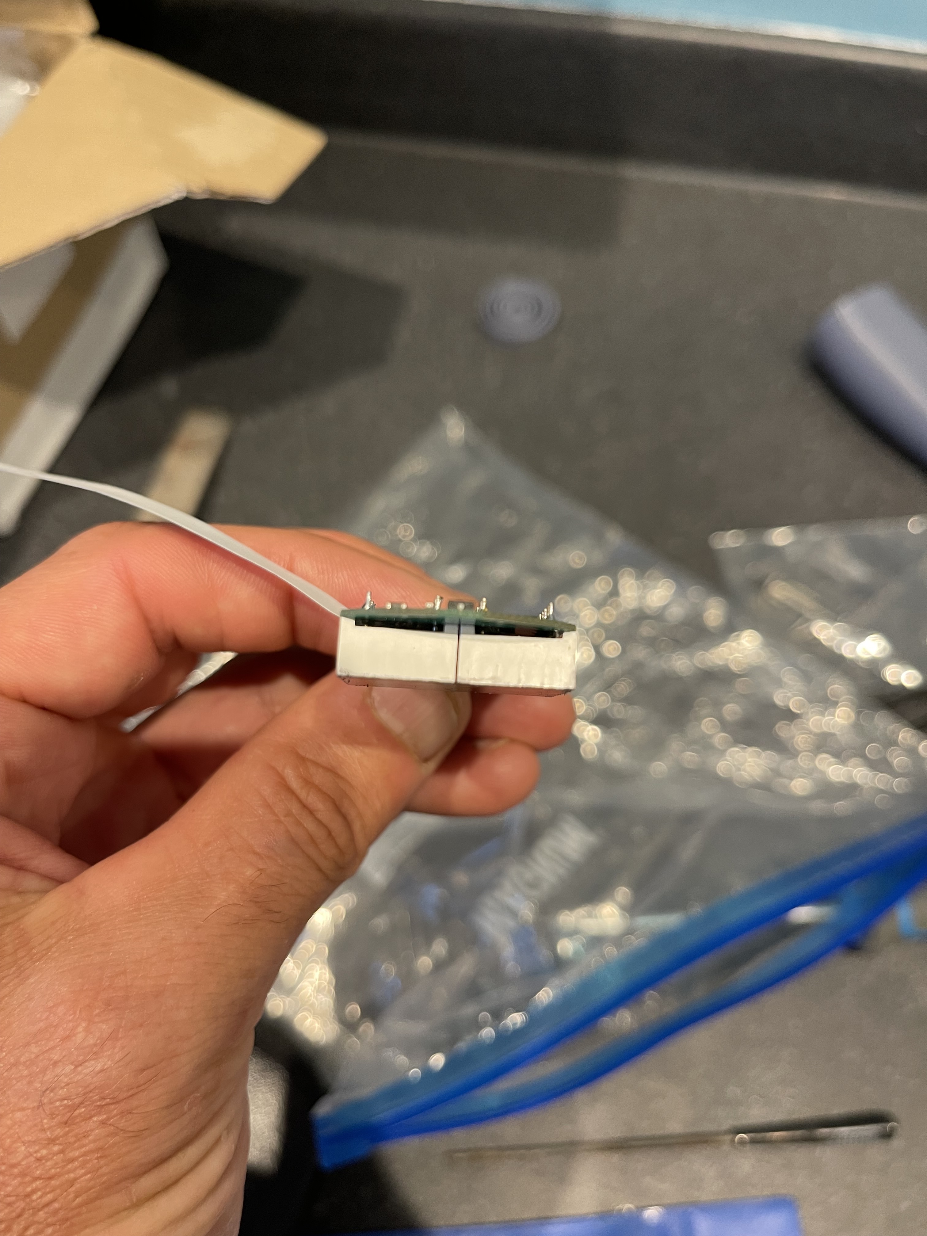

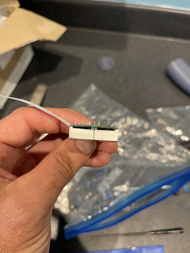

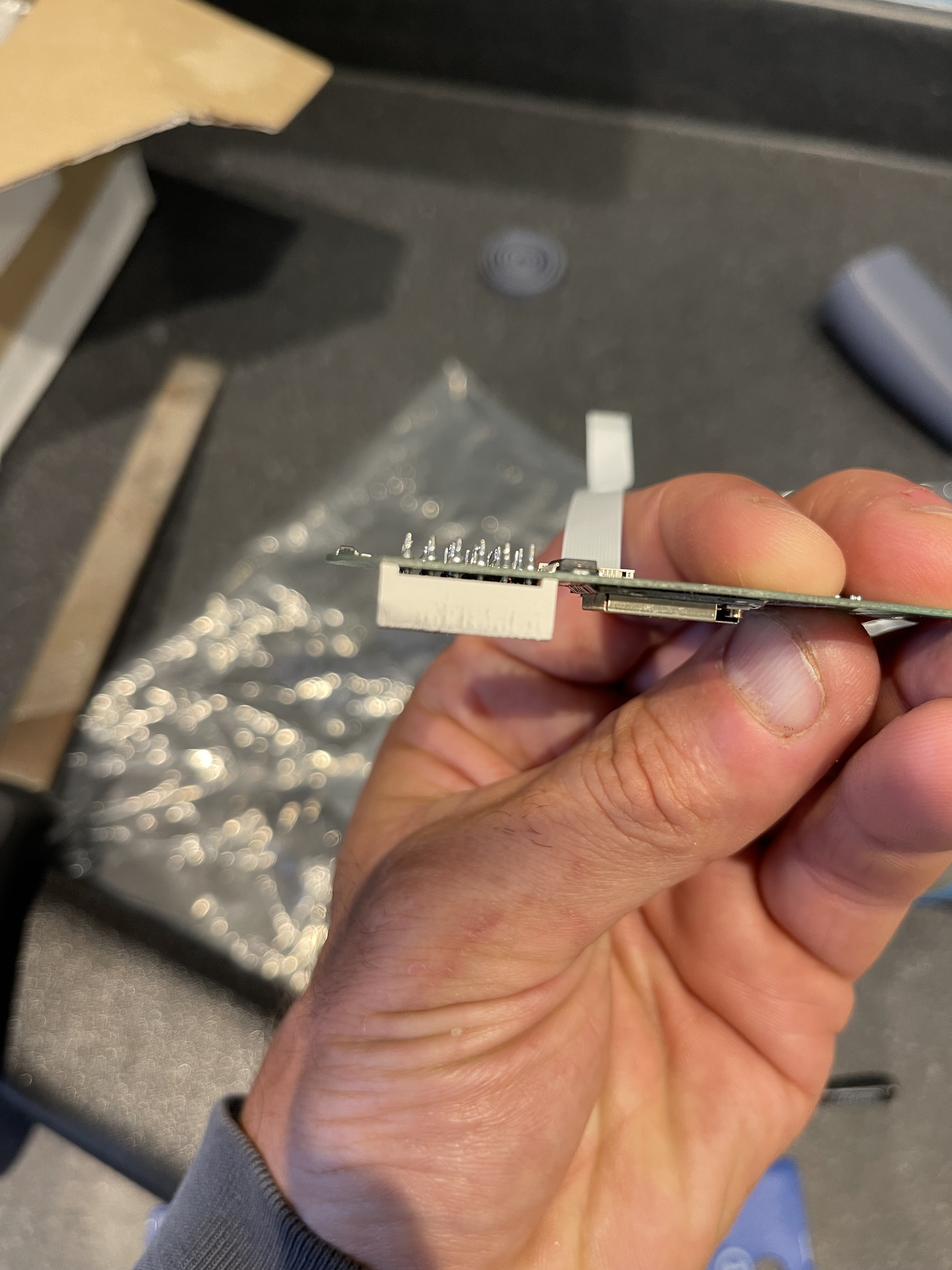

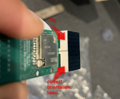

With a bit of luck it may be a solder bridge under the display… or actually it might be one display was put in upside down…

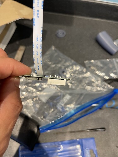

Please also include images of all 4 sides of the display
Please also check left and right side of the display itself. Can you see a “757AS” print on one or both of them?
Thanks!
One of the displays was soldered in the wrong orientation…
If you want to try, you can desolder it and flip it 180°
And anyways you will get a replacement from openfoil, I will contact Jasmin already, he will contact you with further information

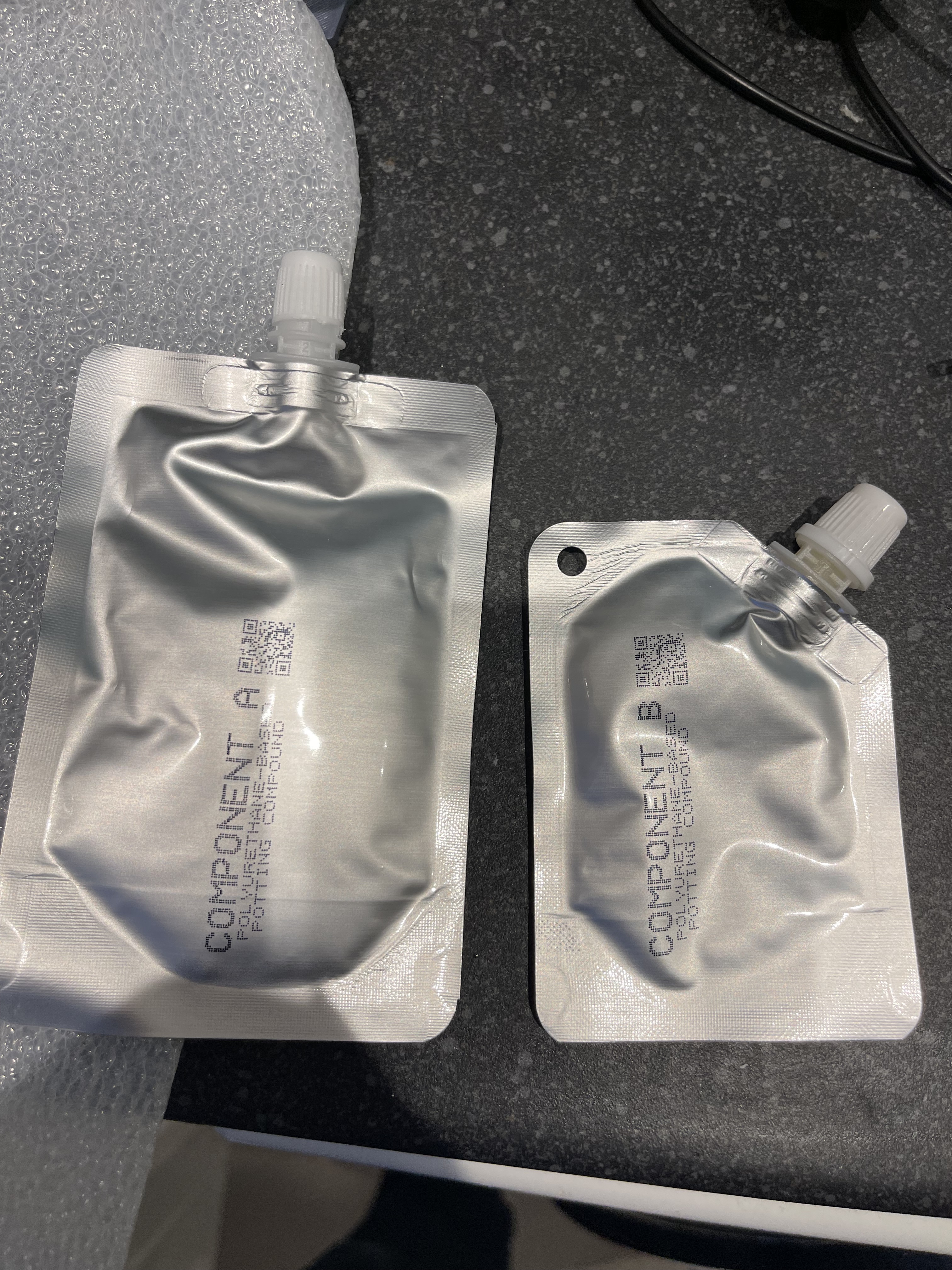

When potting the TX are the pouches that come with the kit (compound A and B) in the correct ratio where I just need to mix them together fully?
Thanks
The contents are already measured, just pour everything into a container and mix.
