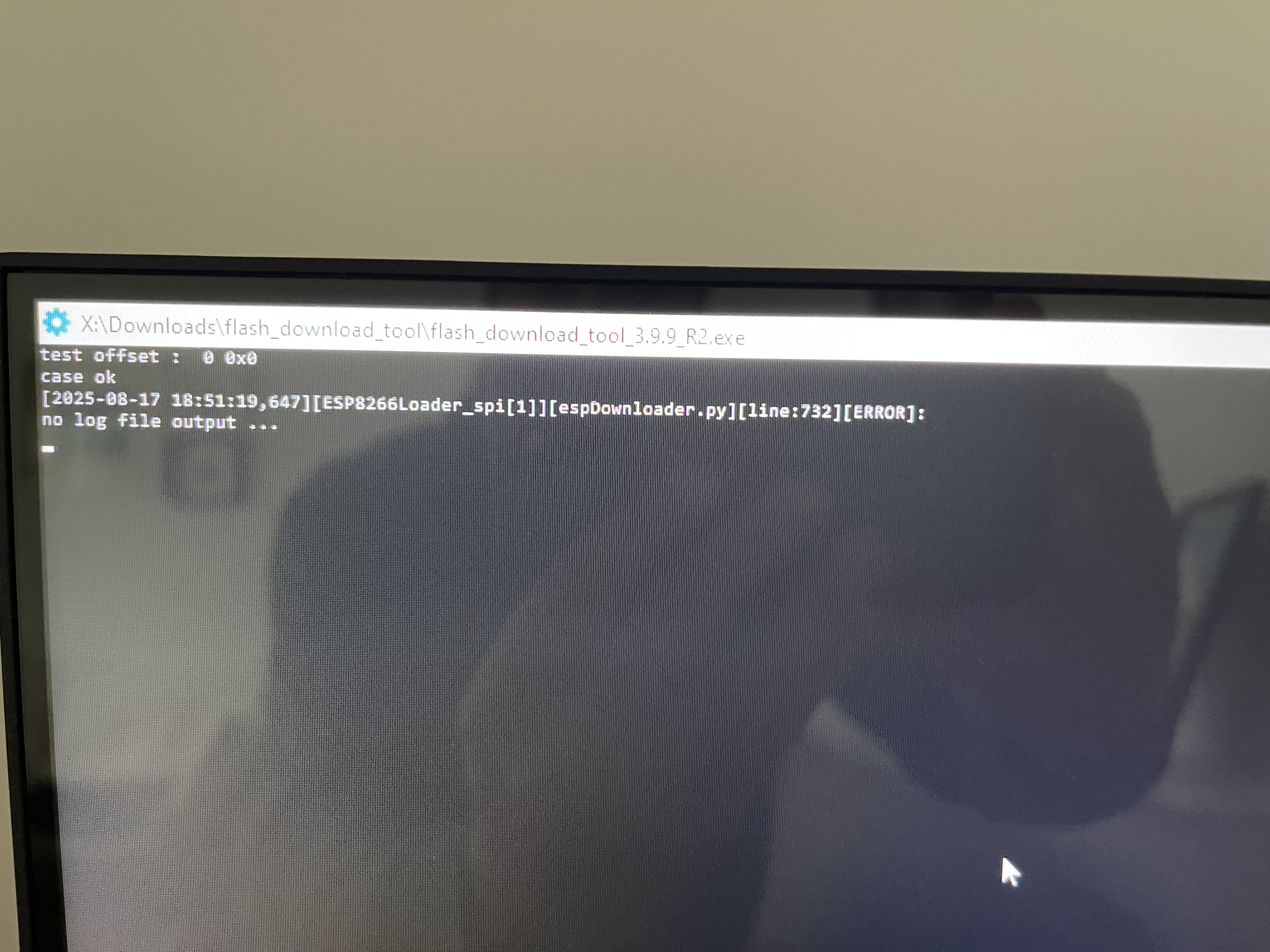

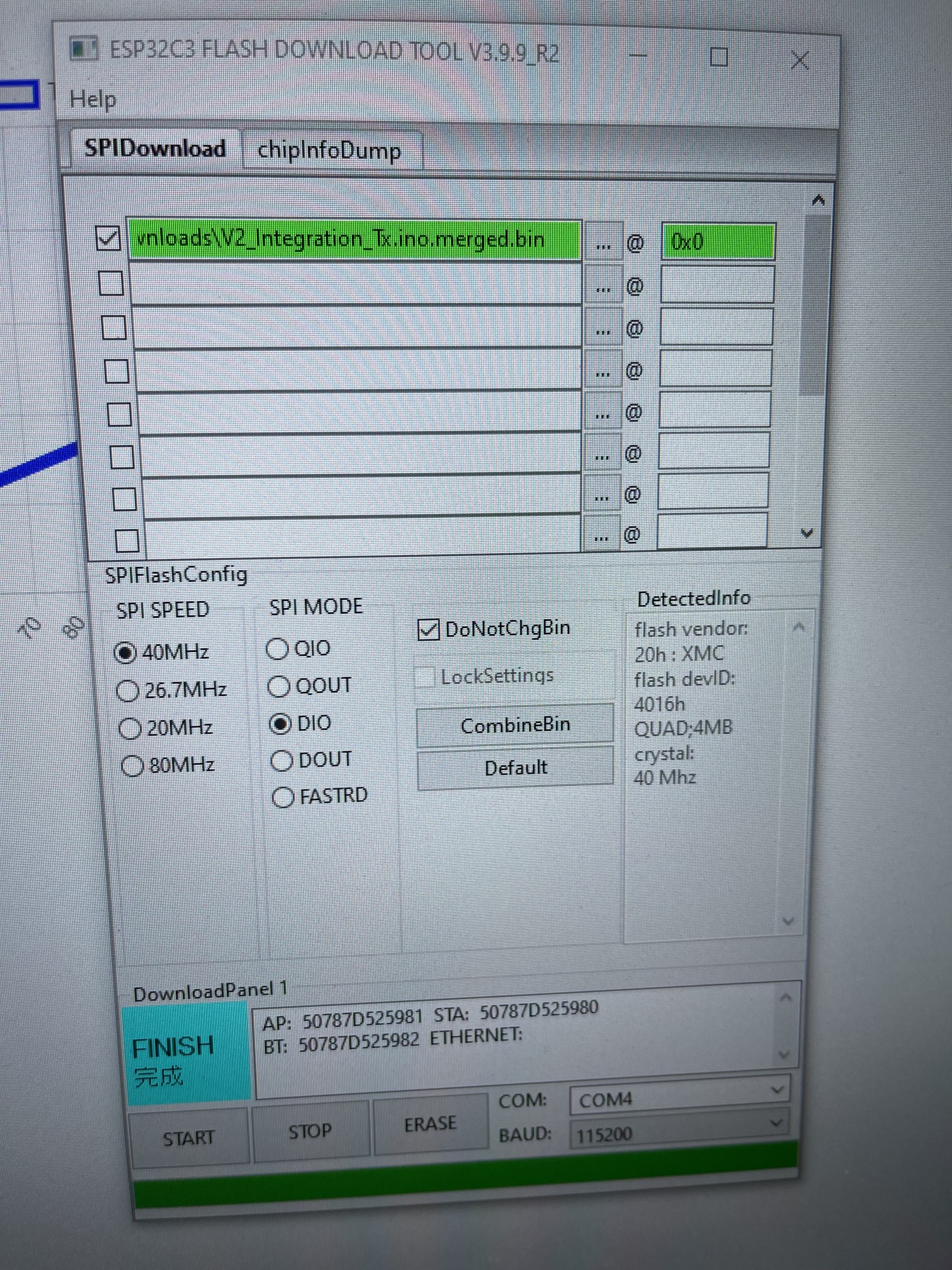

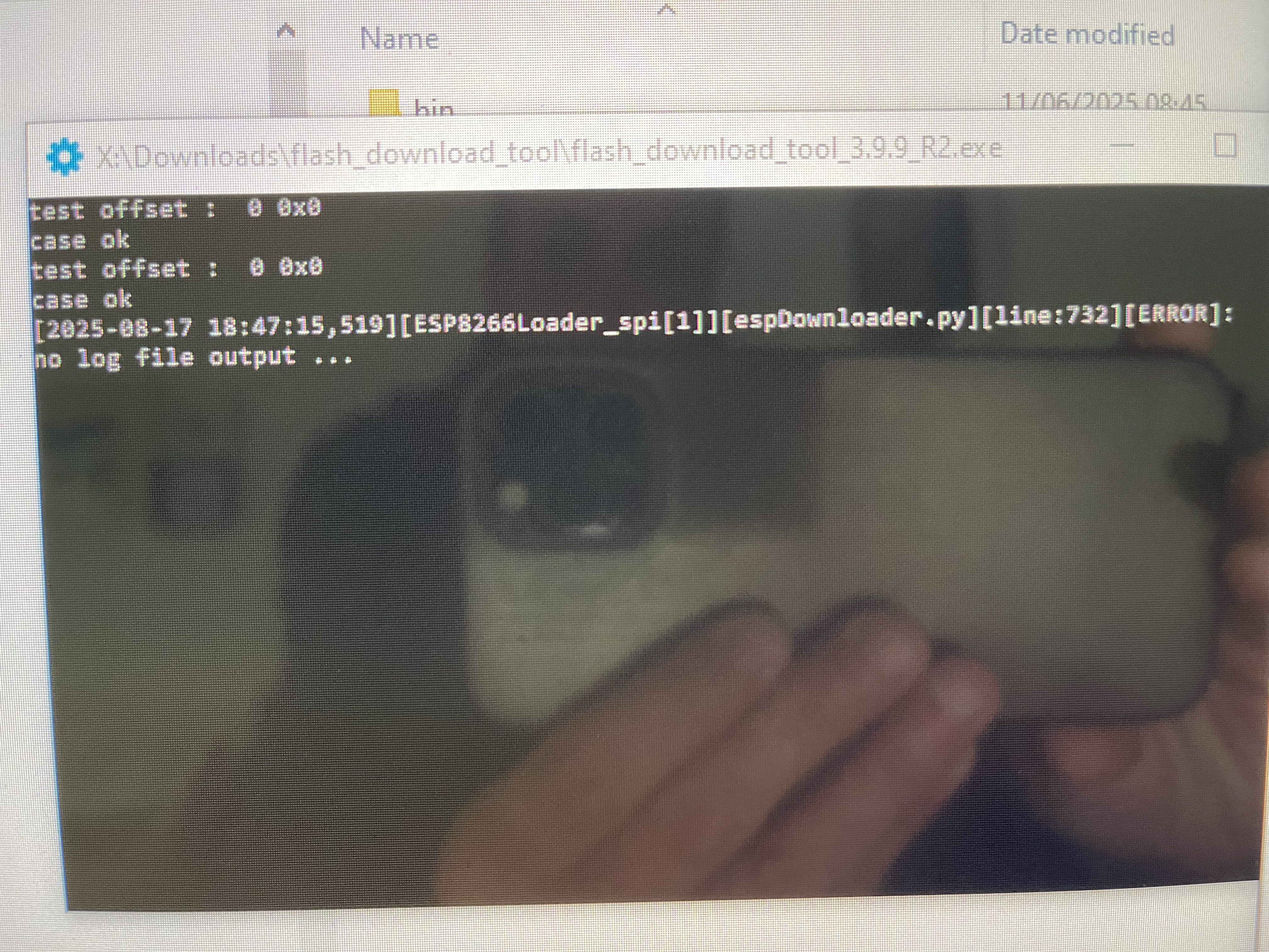

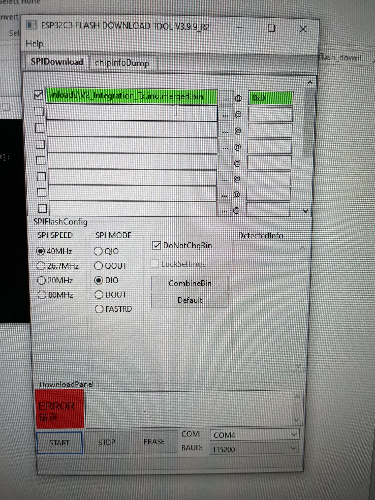

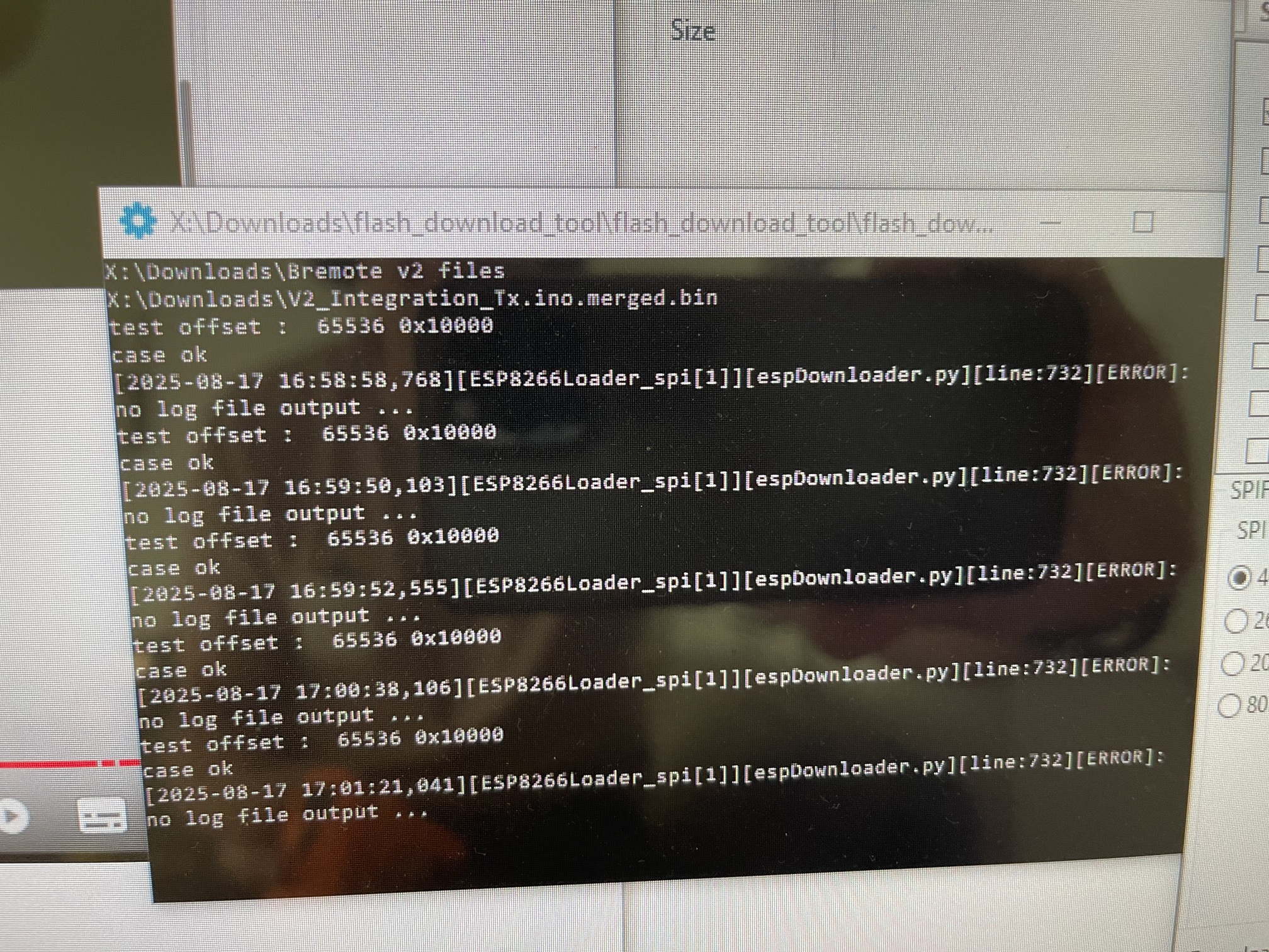

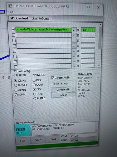

Did anyone get a “no log file output” error when trying to flash the tx for the first time? I used the tx.ino.merged file and initially tried address 0x10000 and then read the updated post above and amended it to 0x0 but I get the same error.
Thanks.
In the picture is still says 0x10000 offset
Can you provide a updated screenshot?
Also I think there should be more information after the [ERROR]: …
Check if you can make the window bigger to see this information
The “no log file output” is normal btw, I also have this
Also the “ESP8266 loader” is a bit suspicious

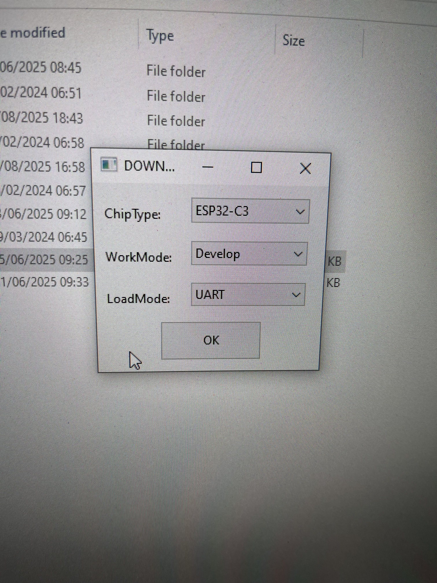

Double check you selected “ESP32-C3” in the first window that opens when starting the flash tool
This is full size. Thanks

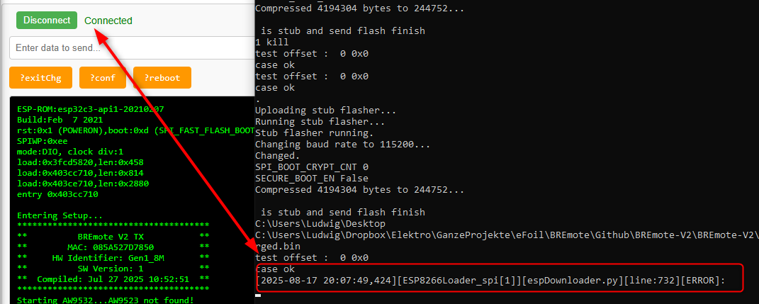

Any chance you have any software open that blocks or interferes with UART?
Already opened the serial terminal in the browser? Or some 3d printer software maybe? Arduino IDE?
Looks to me like the flash tool is not allowed to access the COM Port (driver)
Also you may try another USB port?

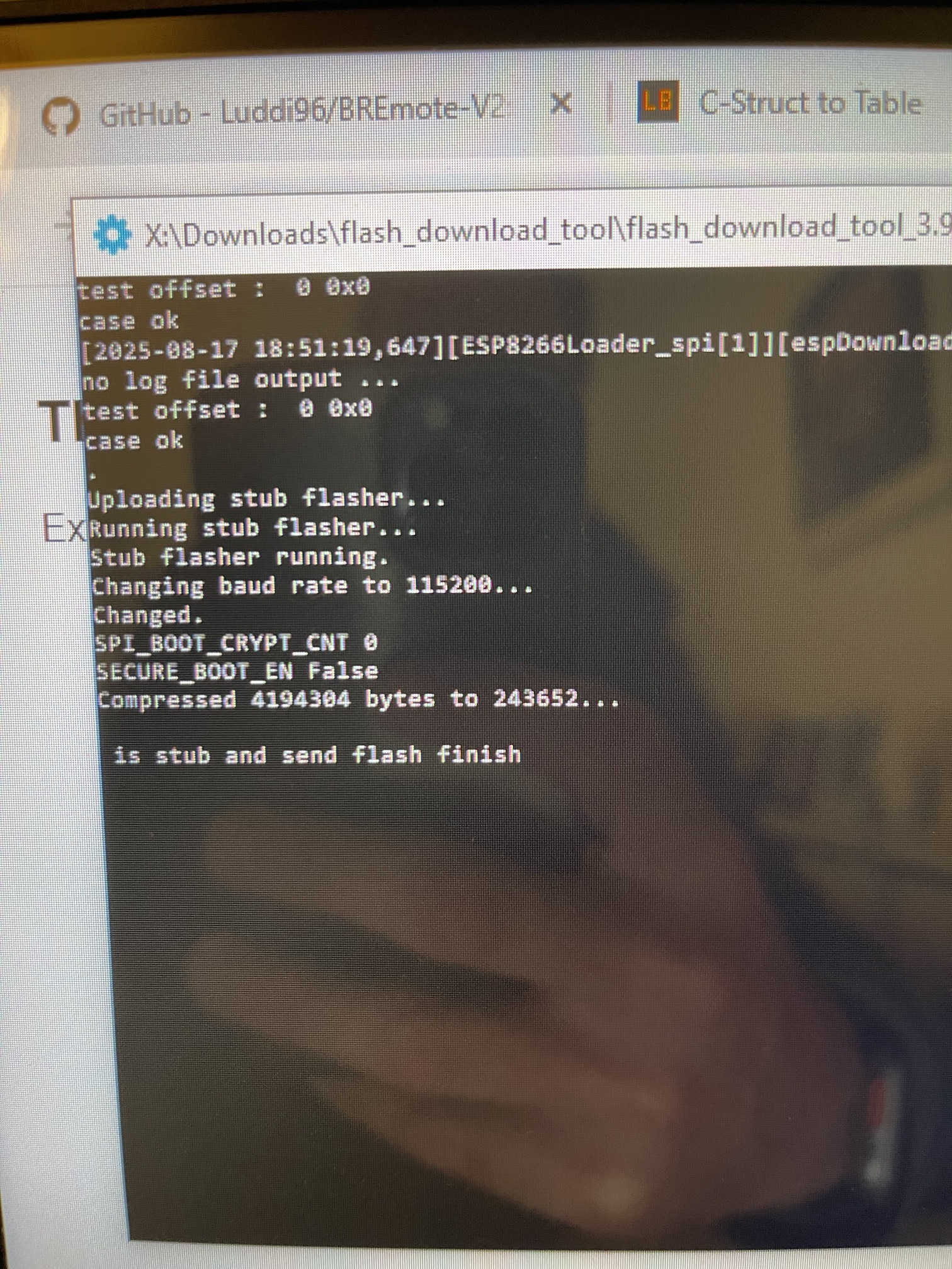

Update:
I could recreate the error by already connecting with another tool to the same COM port:
So please make sure no other tools have COM port / UART access to the same port
Hi Ludwig,

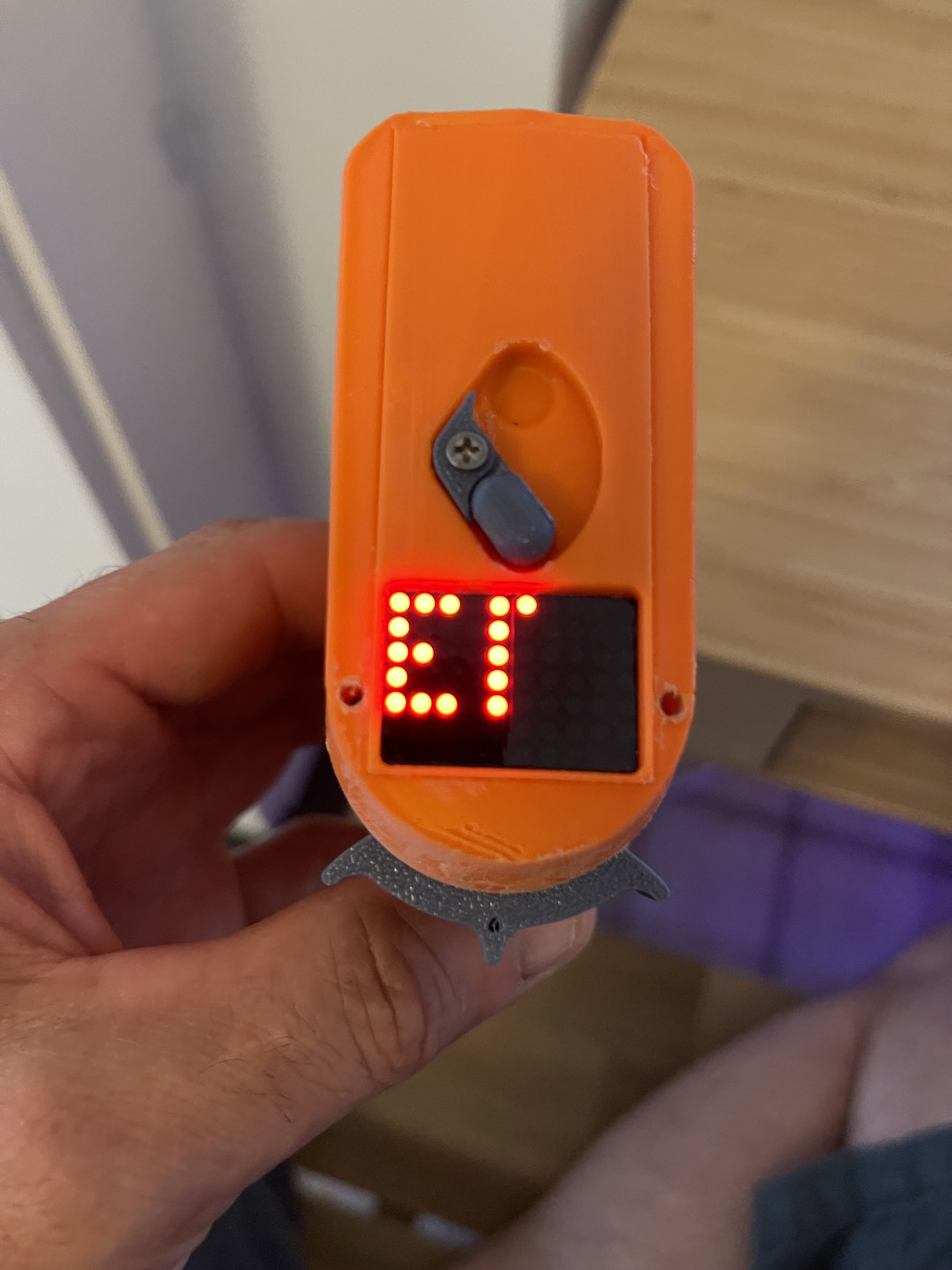

It is alive! I had arduino open connected to com4. Once that was closed it worked. Do all the below look as you would expect?
From watching your build video, it looks like my LED monitor is not fully displaying the codes. It looks like I should be seeing EC or EP but I’m only getting the above. Is there anything to look at to see if I can fix the screen?
That is interesting.
Next steps:
  1. Connect with the serial terminal, turn remote off and on and share with me all code that was output there
  2. Remove top PCB again and send an image of how the bottom (solder joints) looks like
