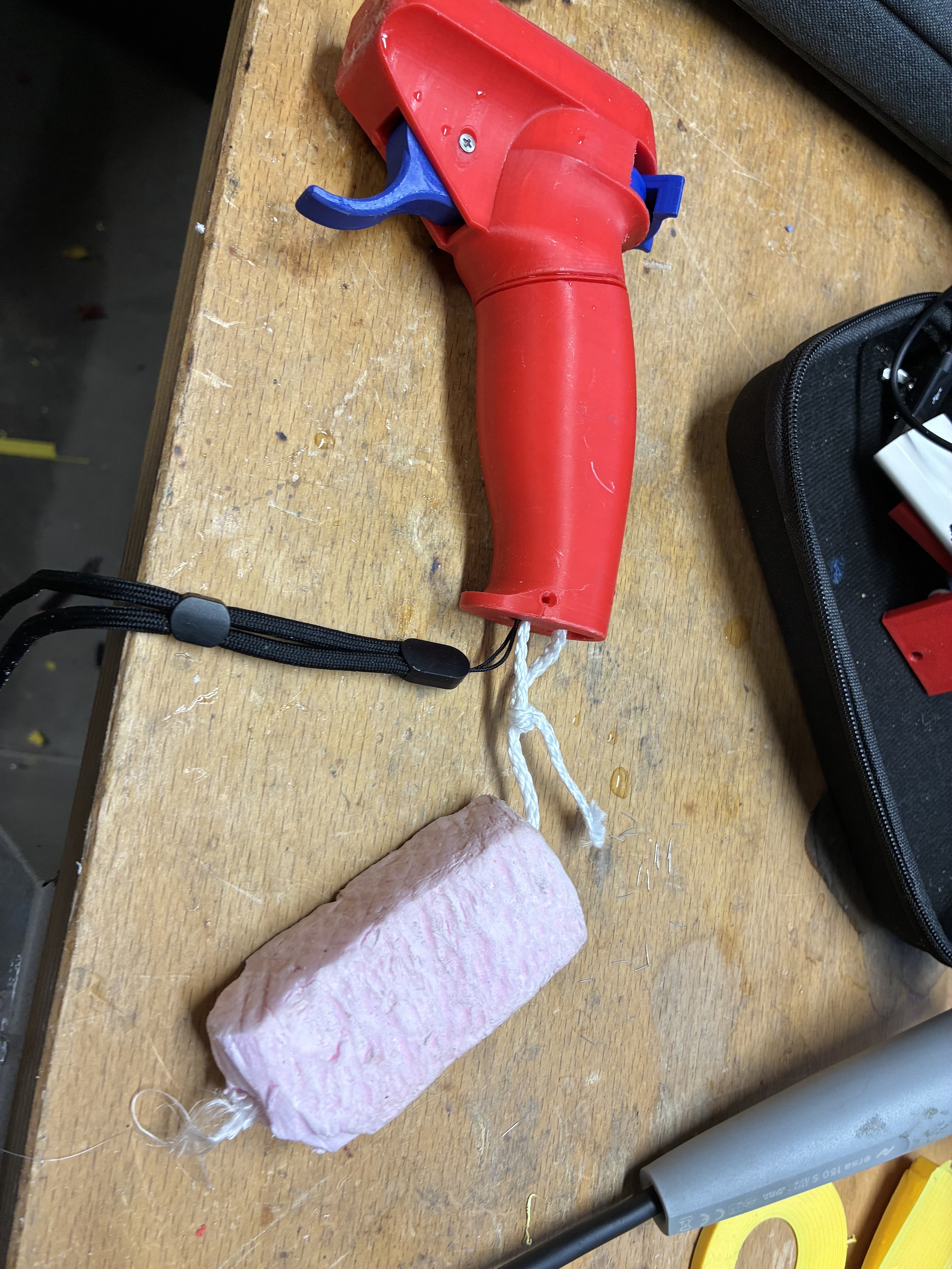

Has anyone a better idea to make it float?
I use these for my DIYS remotes:
Strap for GoPro/ Insta360/ DJI and Other Action Cameras, Length: 20cm
https://a.aliexpress.com/_EJi2E6W

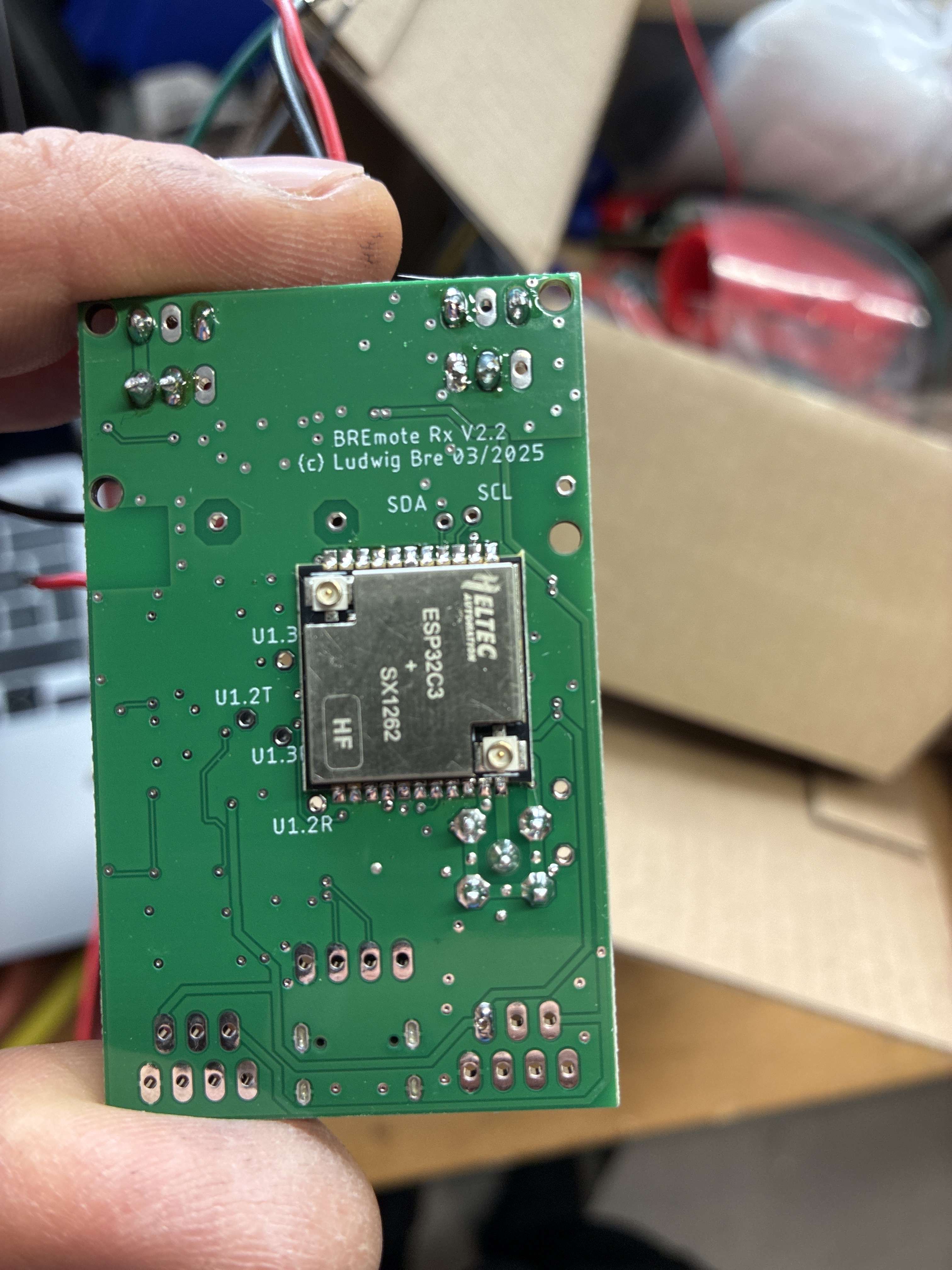

I want to use the pigtail antenna plug on the rx because of space limitations. Is it possible to switch? Is it enough to unsolder/cut the middle connection to the sma plug?
Thanks!
You can try to use it without any modifications, if you have problems with range cut the small trace to the SMA

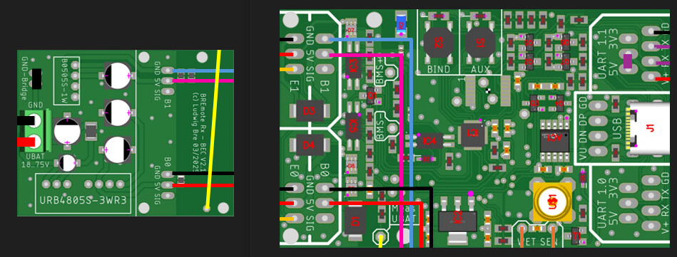

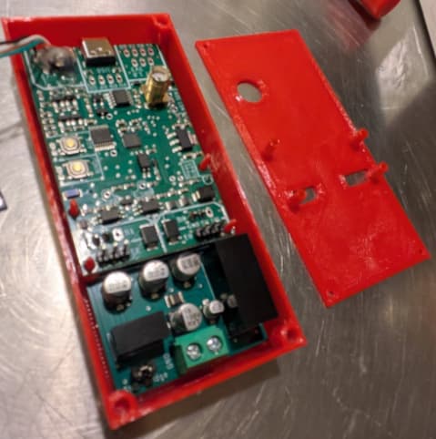

Is there a CAD or technical drawing of the Rx and BEC board available for refencing to draw up a box? Only the schematic is on the GitHub. Thanks. I have these images which will get me 98% of the way but helpful if I can get the original.
Here are the dxf files
https://www.dropbox.com/scl/fo/4z61a9c936tpptau64efv/ALY3YFt0IqLvF4fr3mDR554?rlkey=p04p5sbvpejnmw7ybz0bds4p6&st=1rectqtb&dl=0

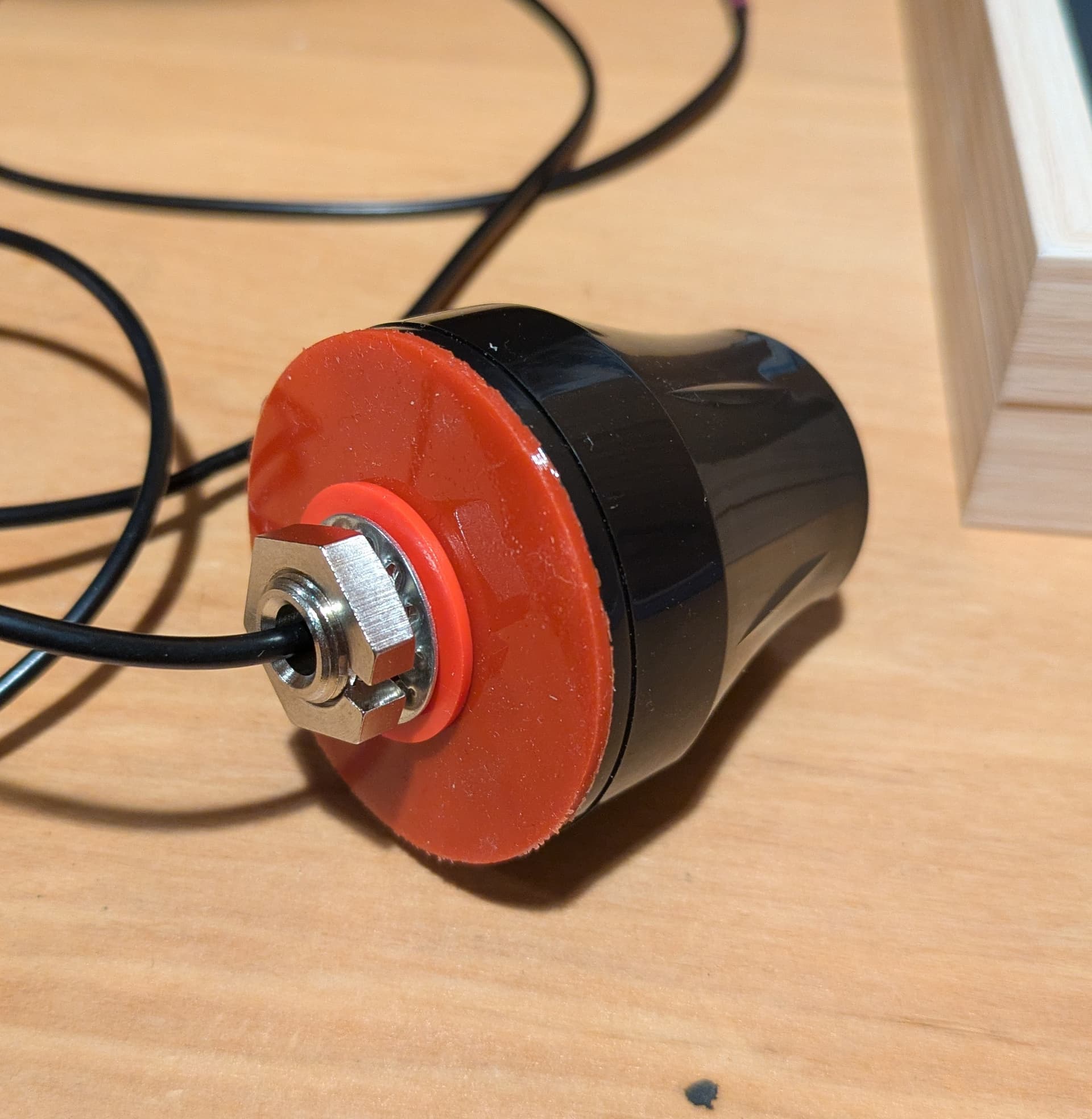

Hi @ludwig_bre, just received my V2 and looks great, thank you! I am planning to put all electronics in a metal for a tow boogie build (keeping the battery separate). Since the GPS antenna cant receive from inside a metal box, would you recommend changing the provided gps antenna with something like the below with frequency of 1575.42±3MHz
Thank you!
Yes, that looks like a suitable antenna for the GPS. Just keep in mind to also buy a adapter from U.FL to SMA.

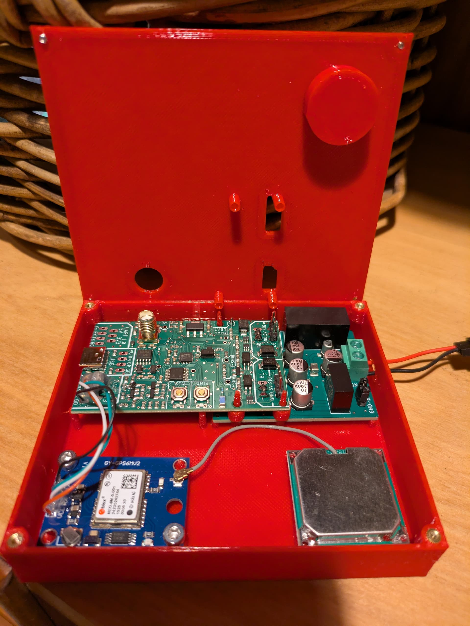

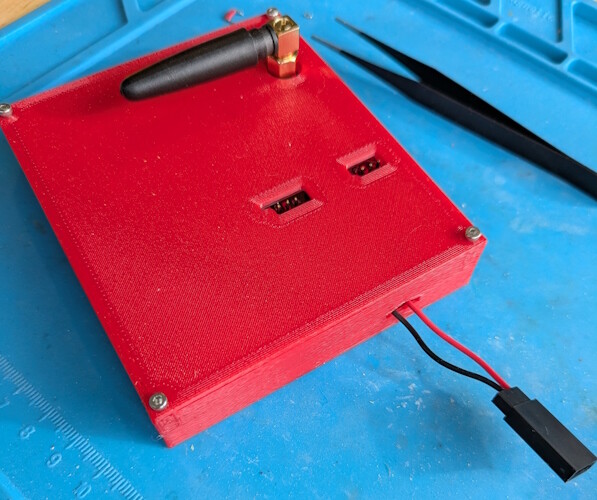

My box design is shared at Bremote V2 Rx Box by seagullnz - Thingiverse It assumes the Bremote BEC is being used and there is a version with GPS and one without. I also include mould for an additional silicone gasket on the external antenna, inspired by @hangloose

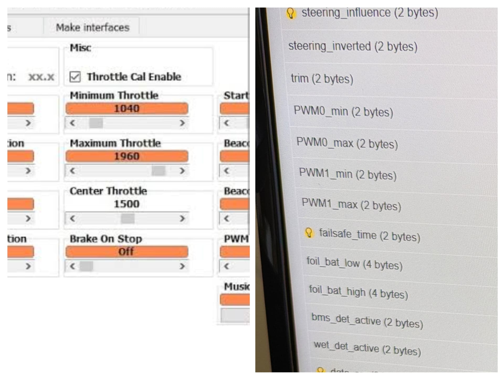

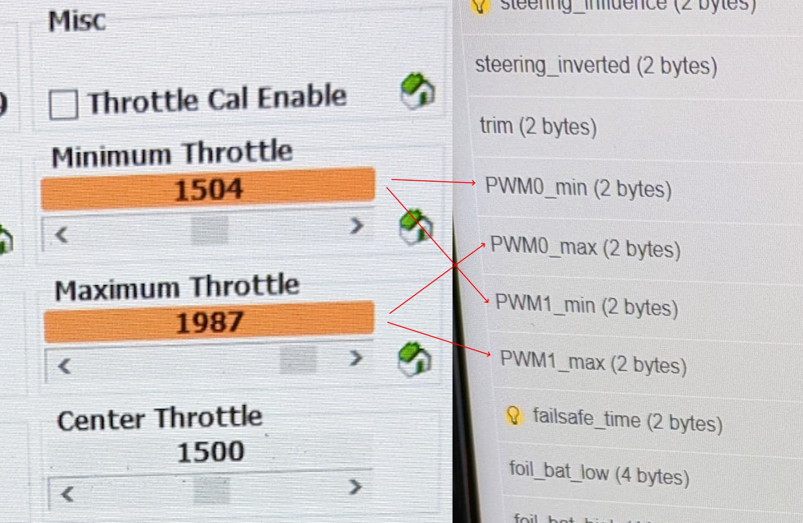

Just on final stages of setting up my tow boogie with V2. With my Flycolor ESC, should my max and min PWM values in Rx config be exactly the same as max min throttle settings in BLheli32?
