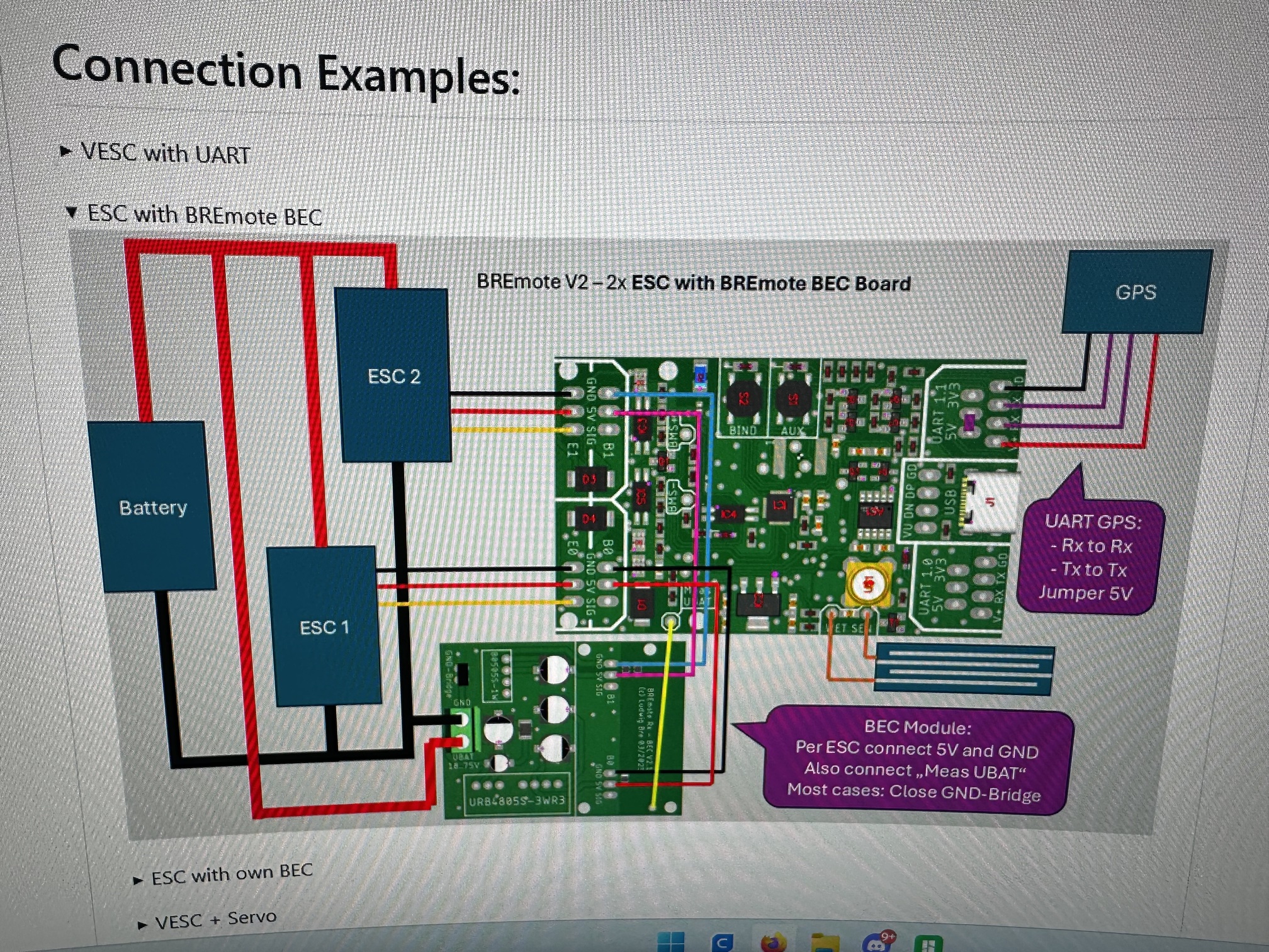

Hi Ludwig
I’ve been soldering wiring for dual esc with your supplied Bec for my tow boogie. On the diagram in git hub it shows from both esc’s there is ground, positive and signal wire connected to Receiver plus positive and negative running through BEC. I assumed that you would only run positive through Bec alone to RX.
Isn’t the positive running from maytech ESC still High voltage?
No, the positive on the signal wire from ESC is either 5V or not connected. Most cases not connected, so it does not make any problems if you leave the red wire. You can cut/remove it from the connector if you want, but you don’t need to

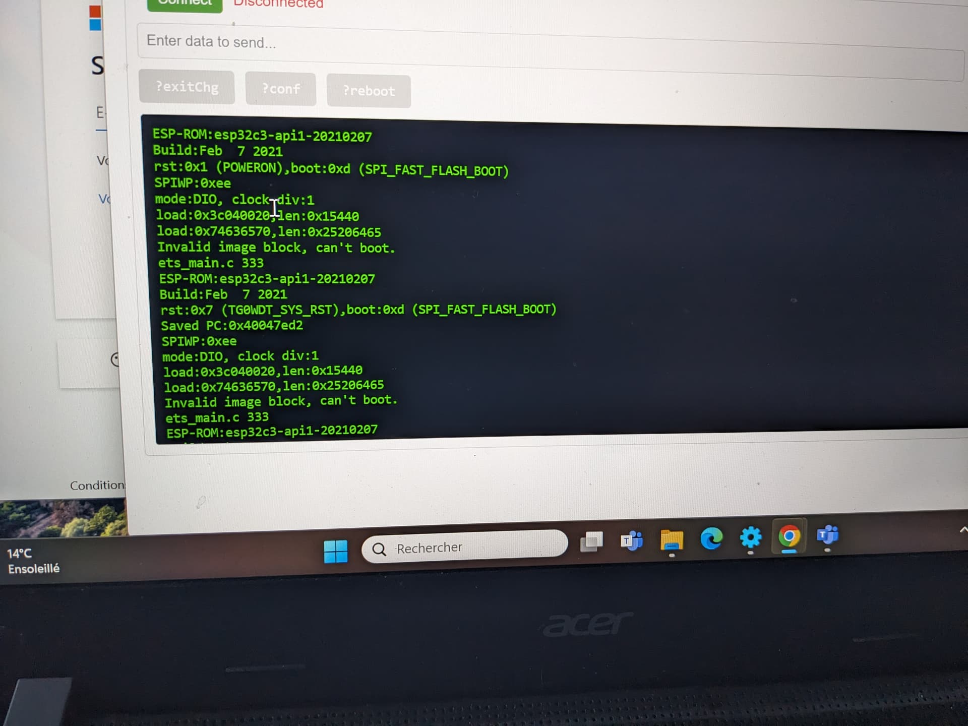

Hello @ludwig_bre
I struggle to continue the configuration of the TX because I have this message on the Serial Terminal . Any idea ?
Firmware broken
Upload firmware again
Thanks,
It is the last firmware V1.2, I will try with the previous one 1.1 and revert to you.
To be 100% sure. The Tx offset is always 0x0 instead of 0x10000 for RX ?
The offset is 0x0 for firmware with .merged and 0x10000 for firmware without .merged

Hmm. Something seems to not work with your firmware uploading
Please record a short video of the whole firmware upload process you do, including starting the tool, until you open the terminal, and send me as PM ![]()
It was because I used the “non merged” file. Since I used the merged it works great.

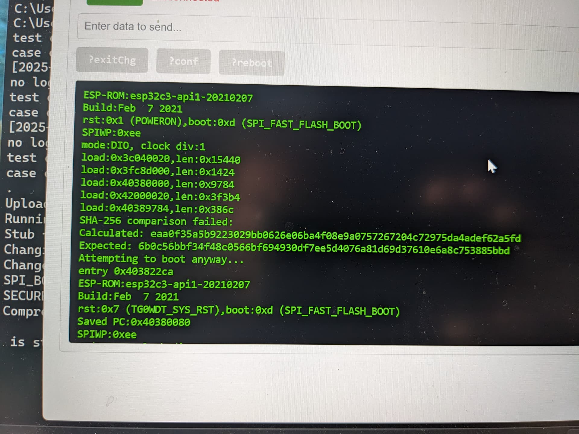

Hello Ludwig, in process with assembling v2 remote and ran into some problems with receiver (very nice kit btw, even 18650 included) . Remote seems to function as it should but receiver when powered up with bind pressed does not start blinking or get paired, getting two solid red led’s. Press and hold bind, connect usb C and get solid led’s. Same behavior when not pressed.
I think there was a solder bridge between two pins on ESP32, pin 3-4 from HF logo. Fixing that did not help.
Serial monitor reads some number and into deep sleep when connected and nothing after.
Blockquote
into deep sleep
�ݹ�: 817
into deep sleep
�own : 767
into deep sleep
��빁: 965
into deep sleep
��ݹ�: 2266
into deep sleep>
Any ideas what can be the issue here ? Kit came from Slovenia today ![]()
No firmware loaded, please upload firmware
Use . merged file and upload to 0x0
Thanks
was not aware it was not programmed. Firmware uploaded successfully and paired.
