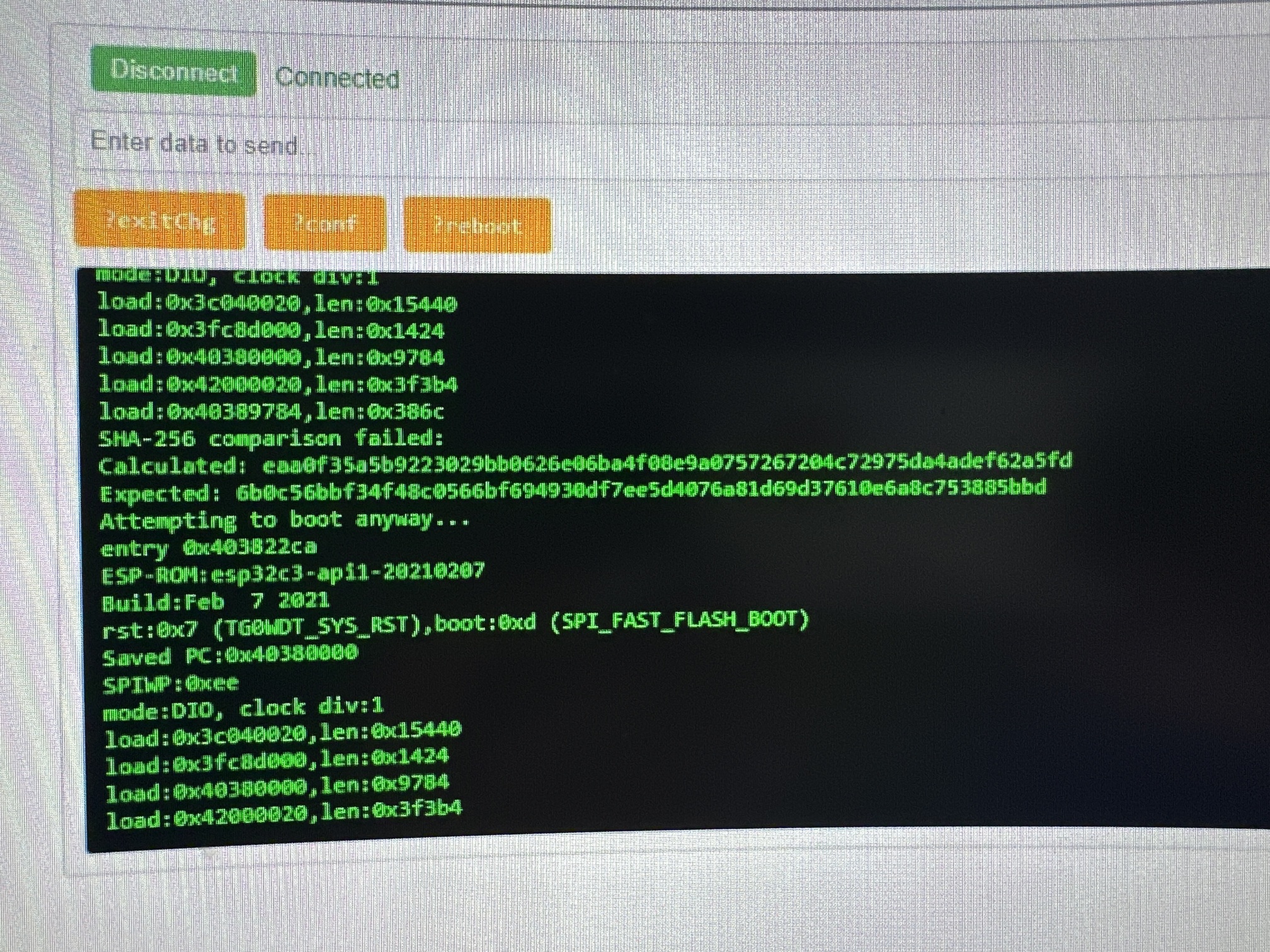

I’ve received my new RX I’ve tried to connect to serial terminal and all it shows is y??into deep sleep what does this mean? How come it won’t connect to RX and also tried to connect to TX and same thing?
Please update firmware by uploading the Rx merged firmware to address 0x0
I’ve done the integration should I do via 0x10000 or what you said
I’m not having any luck with these remotes at all I had it on and it was saying PA on remote I done flash upload 0x0 and now remote has gone blank and won’t turn on even whilst plugged into charge lead. I’ve plug in remote and connect to serial port and now it keeps rolling through a screen
I don’t know what to do now
Please make sure to upload Tx firmware to Tx and Rx firmware to Rx
And use the .merged files and upload them to 0x0
The last picture looks like you bumped or disconnected the cable mid-upload

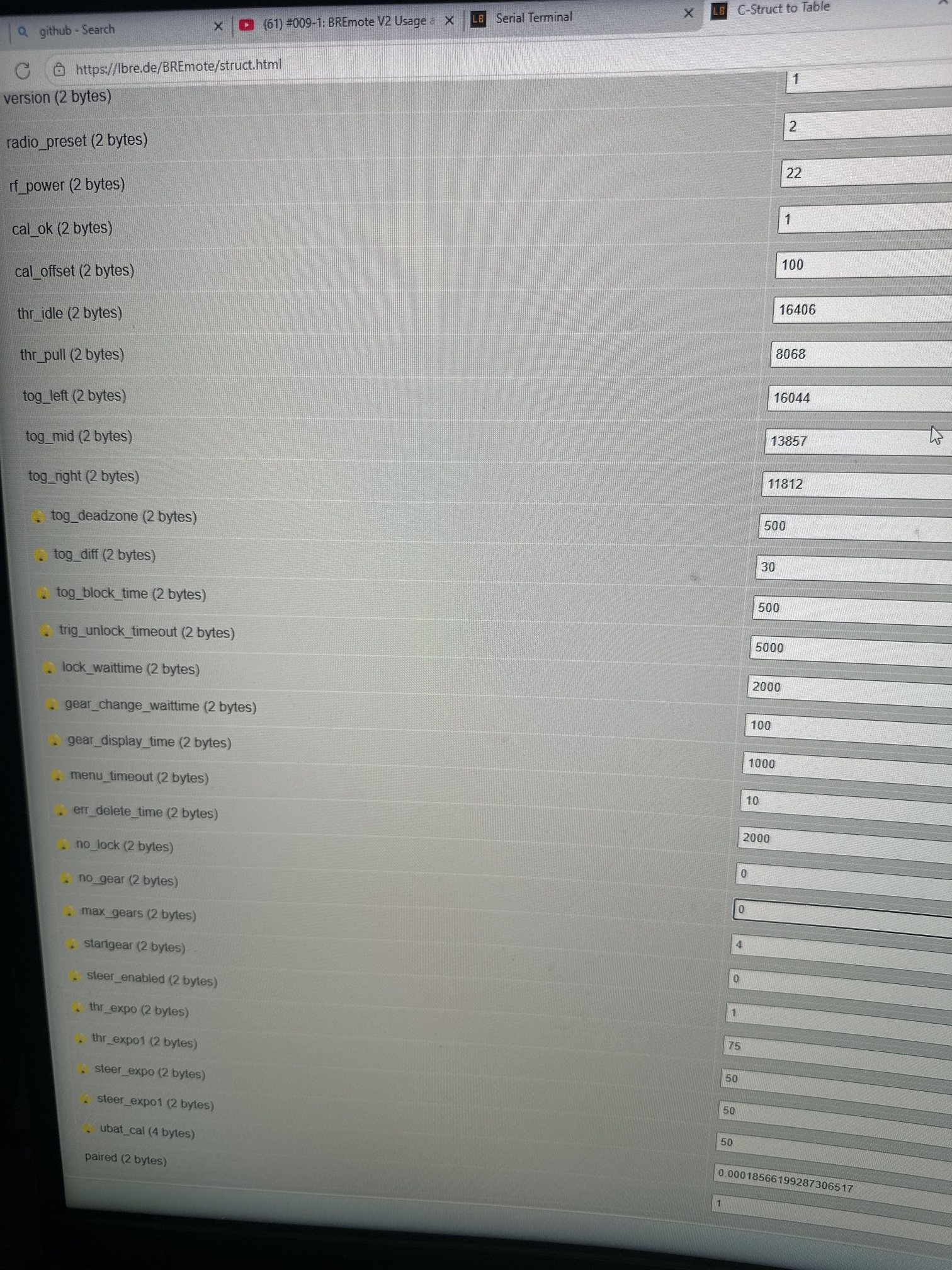

Yes ok I’ve managed to recalibrate again it didn’t work first time. I’ve managed to get original controller to connect and motors working but it won’t allow to steer seems to stay in gear change mode. Steering is enabled on TX table
String is : AQACABYAAQBkABZAhB+sPiE2JC70AR4A9AGIE9AHZADoAwoAOAcAAAAABAAAAAEASwAyADIAMgBDrkI5AQAVWCAVWxA=

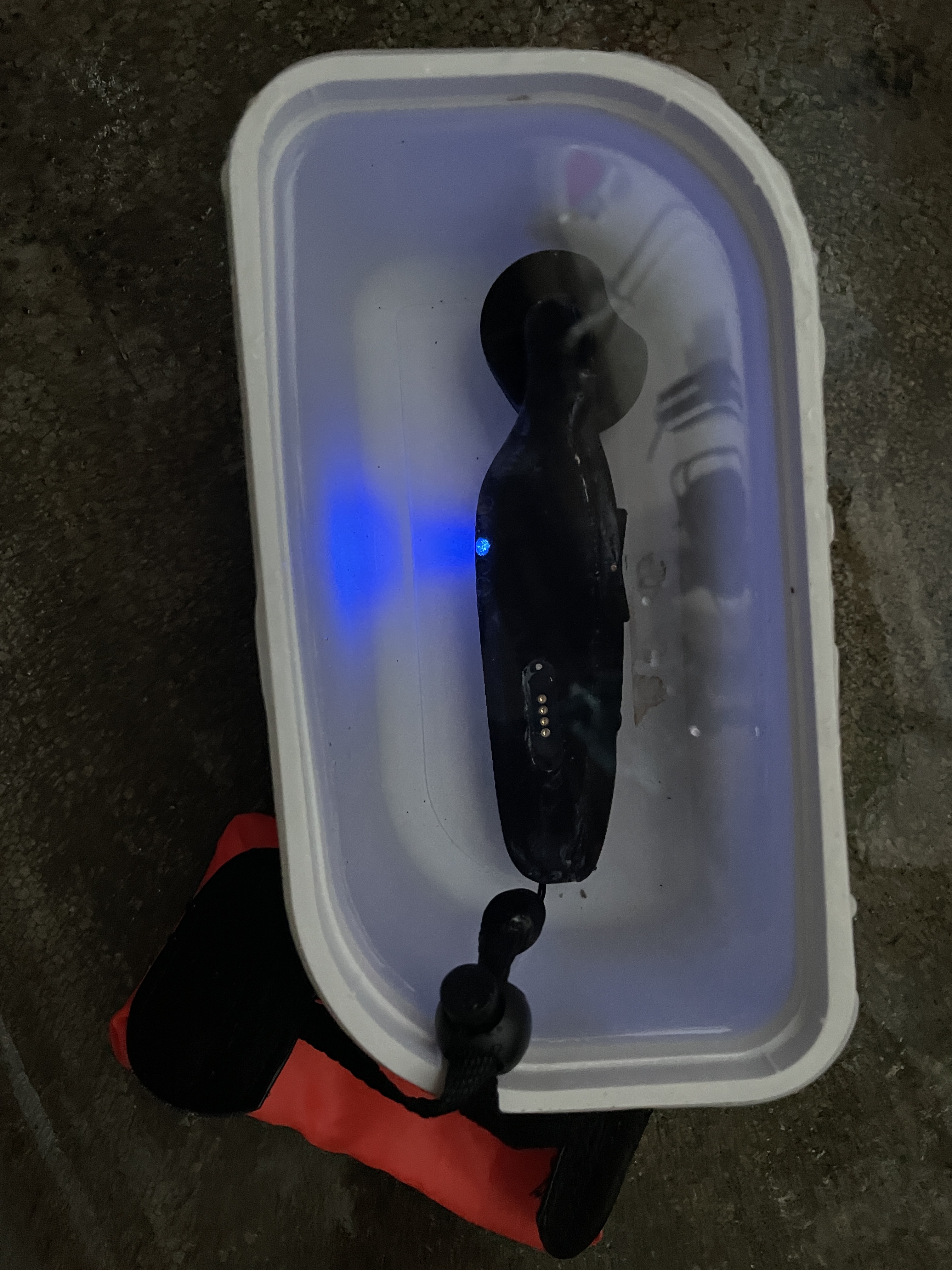

After a lot of swearing failures I’ve finally got it to work now. Tomorrow test to see if it even floats
Different handset version, but it floats like a stone with all the polyurethane filler inside. You need to add a floating wrist strap.
