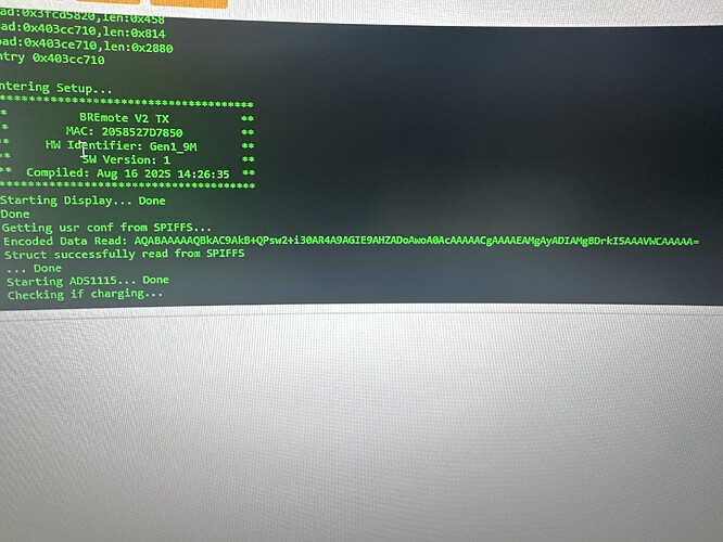

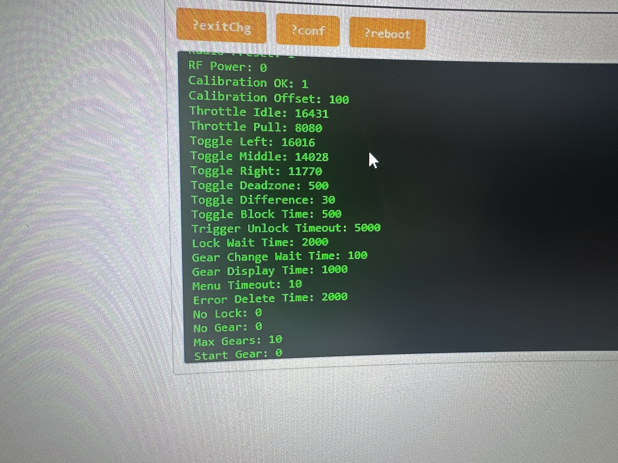

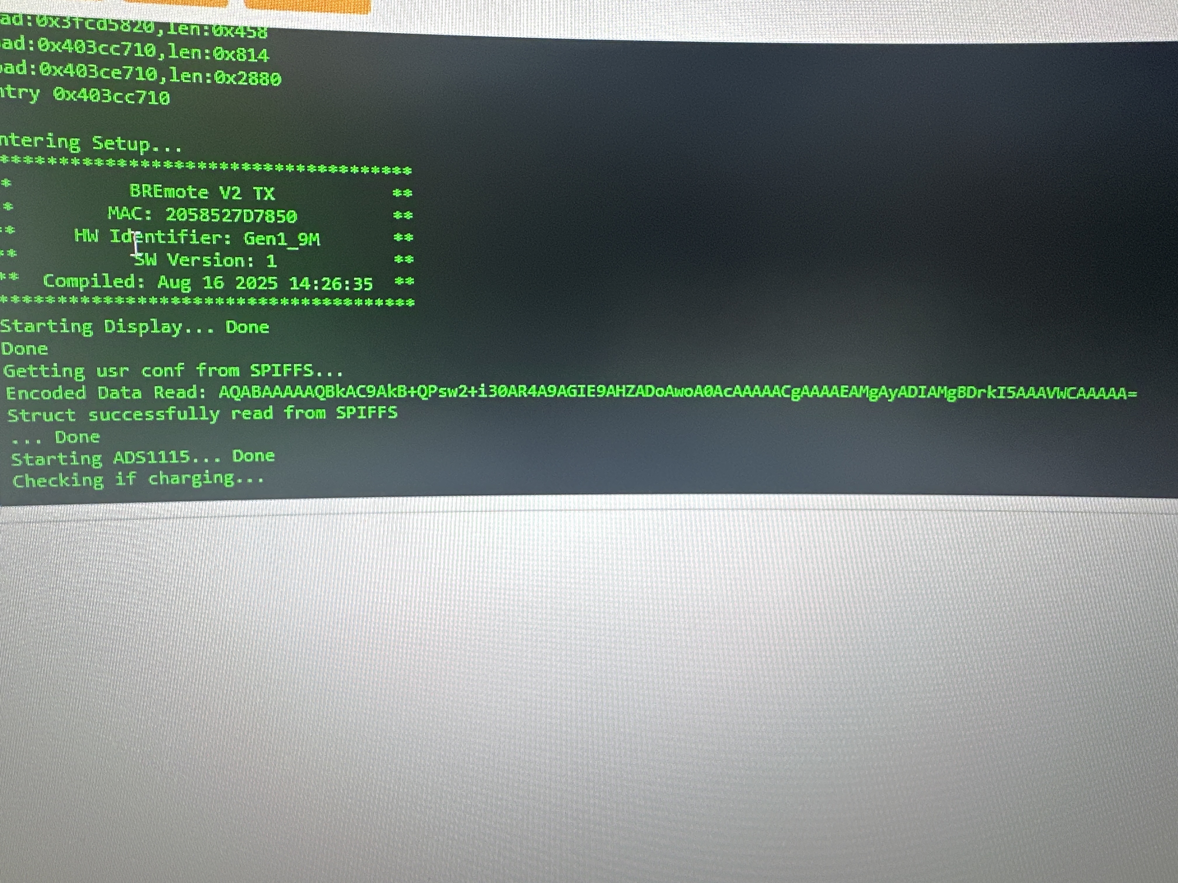

Please send me the config string, so the thing that you input into the configuration page
Both for Rx and Rx

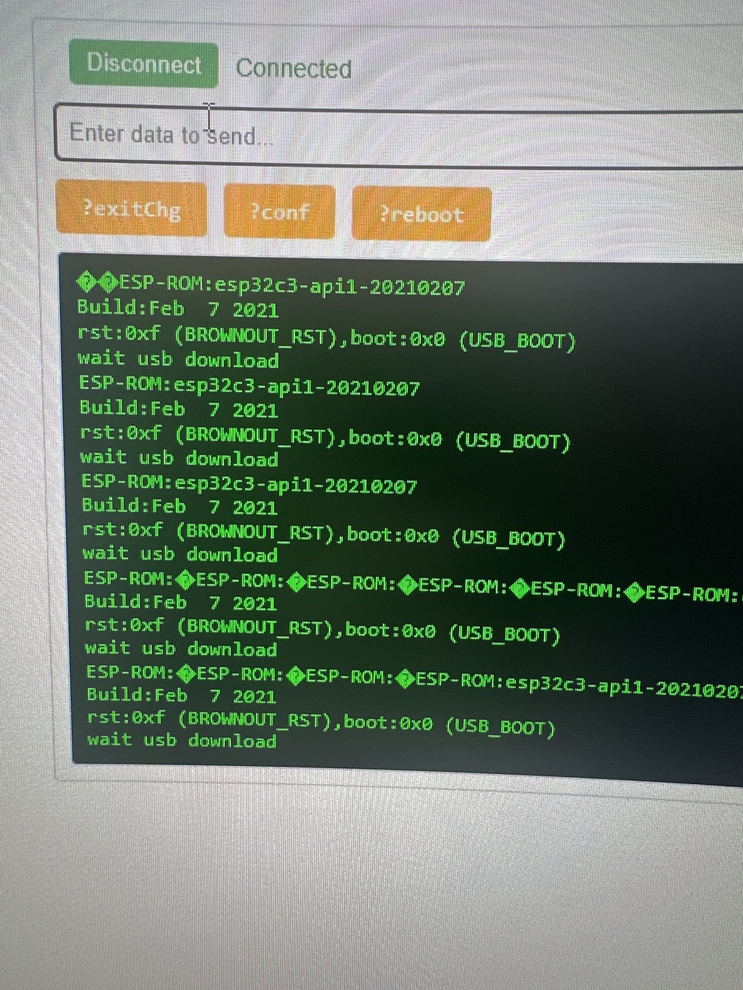

Ok I will but this is what I get when plugging in the rx.
I’ve tried a number of cords and this is only one that worked I’m away for work for a week next swing back I’ll try and find a cable used for data hopefully it will work.
Bottom pic is TX config string

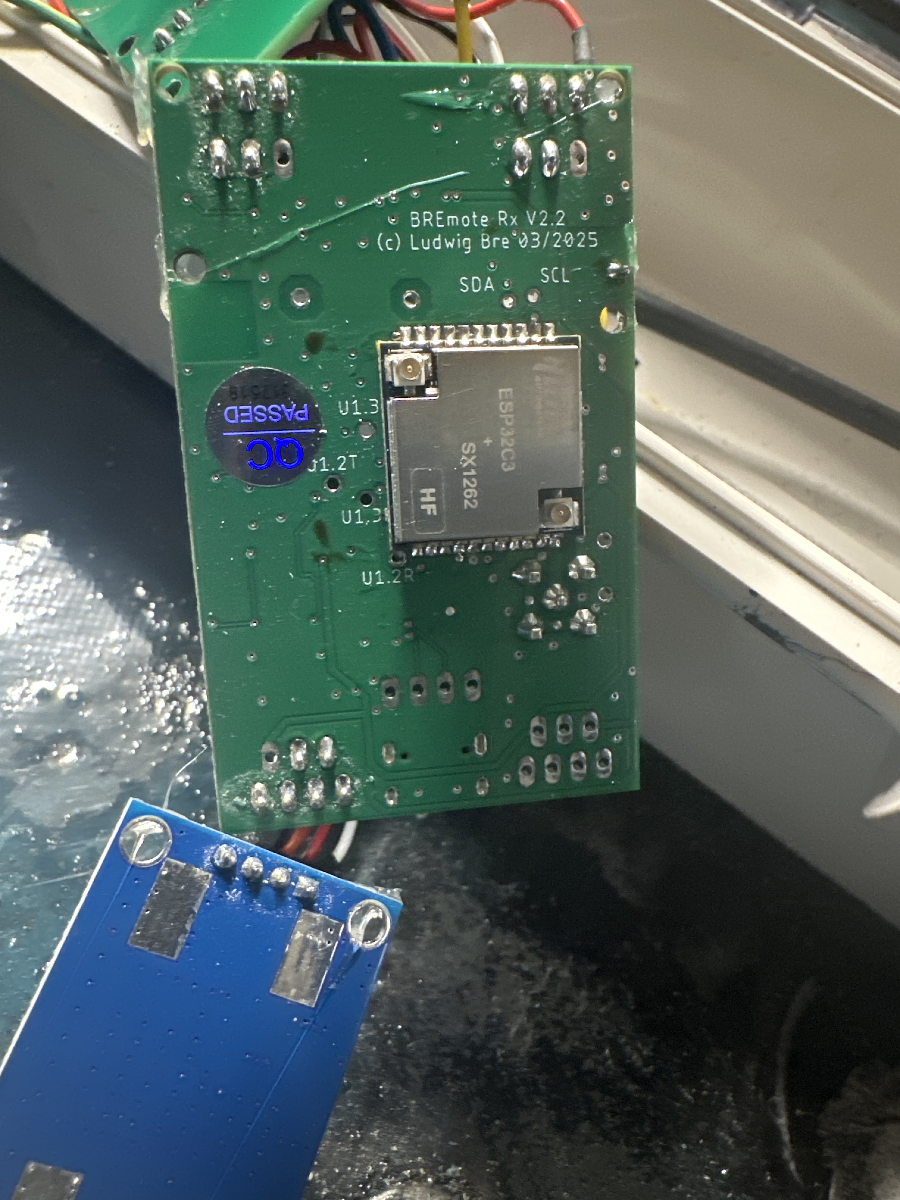

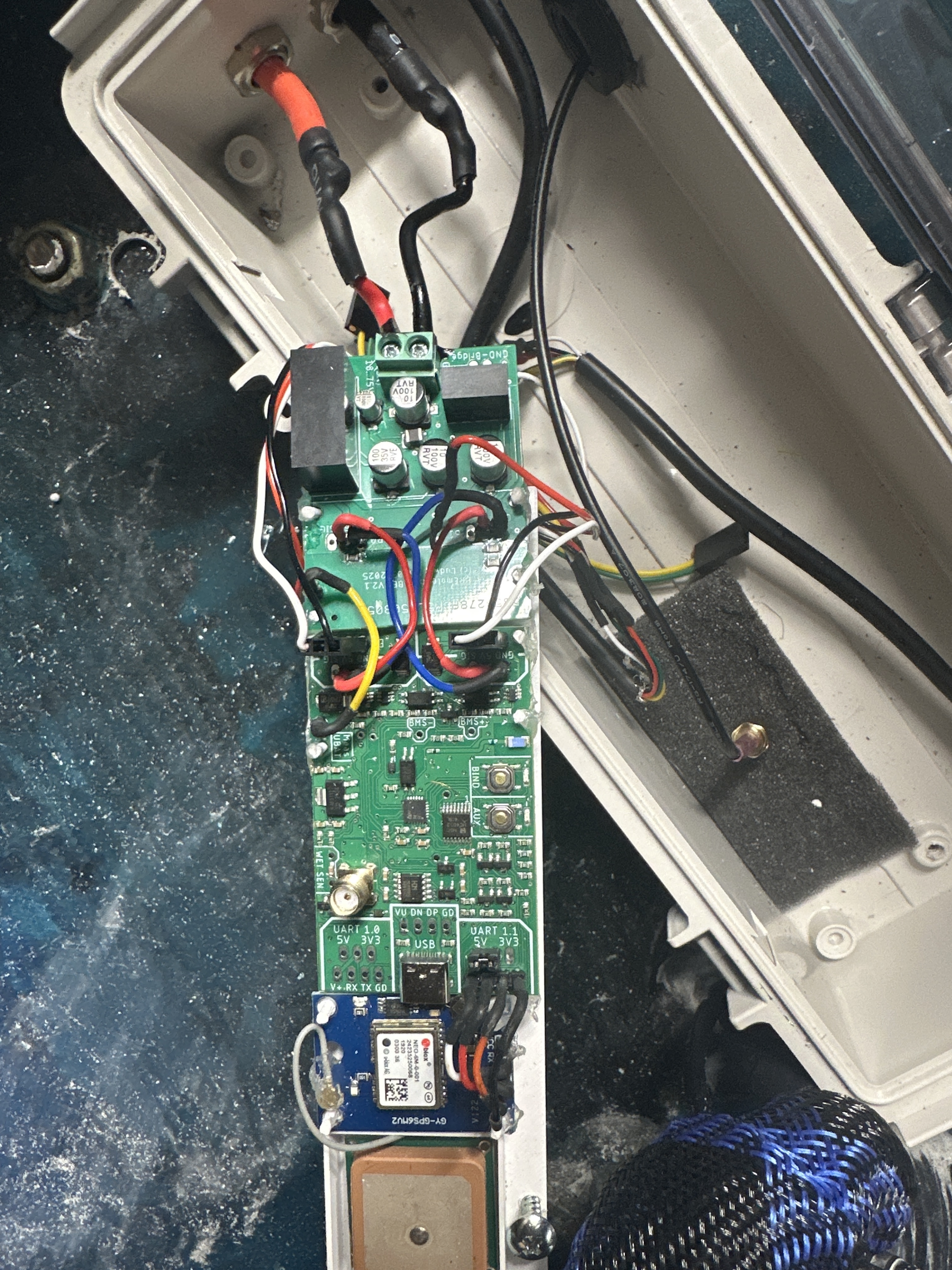

Rx has a power problem
Please disconnect everything and try again

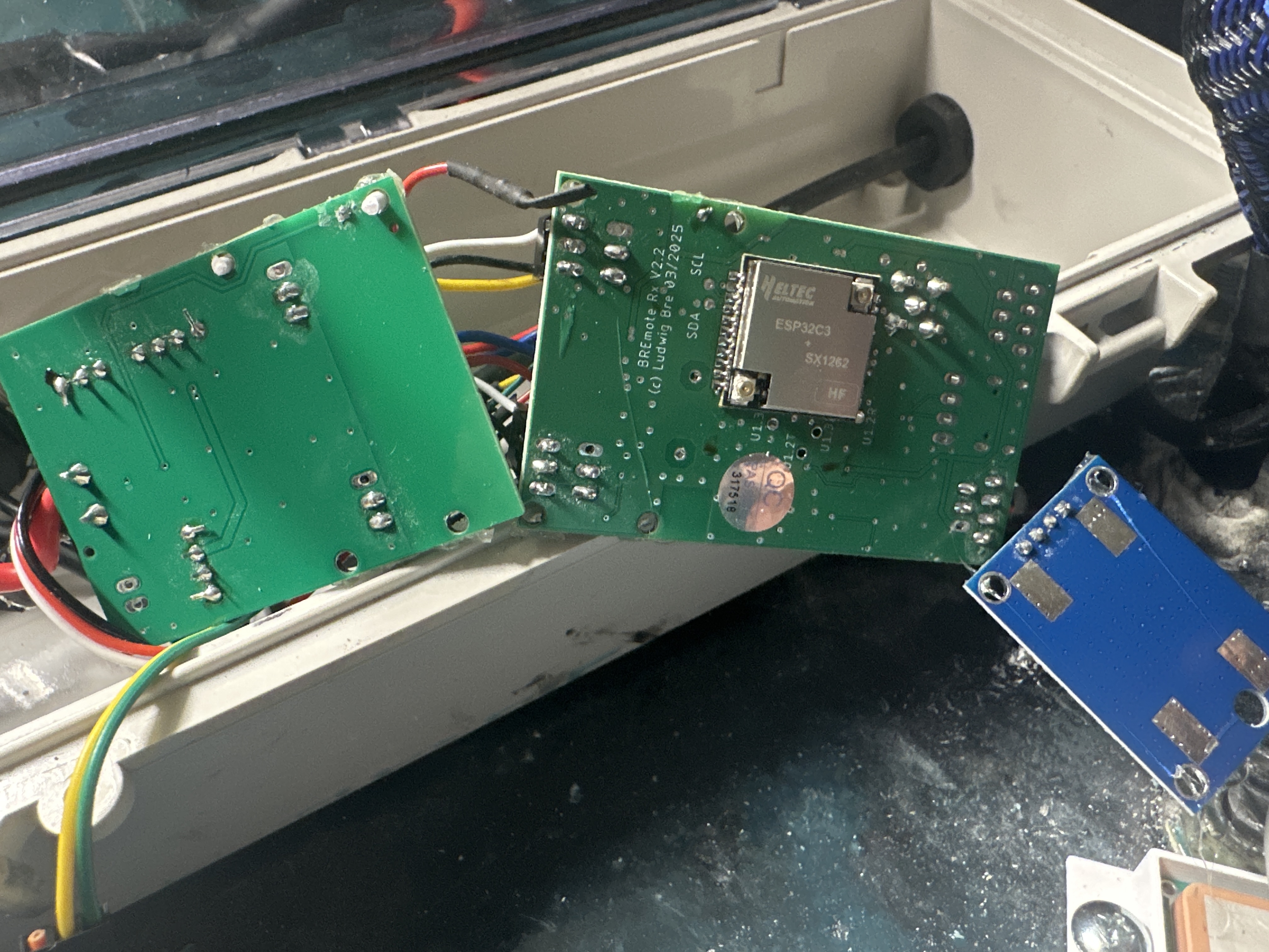

What have you connected? Please send an image of RX both sides
Also please send me the codes as text, I won’t type them from the image

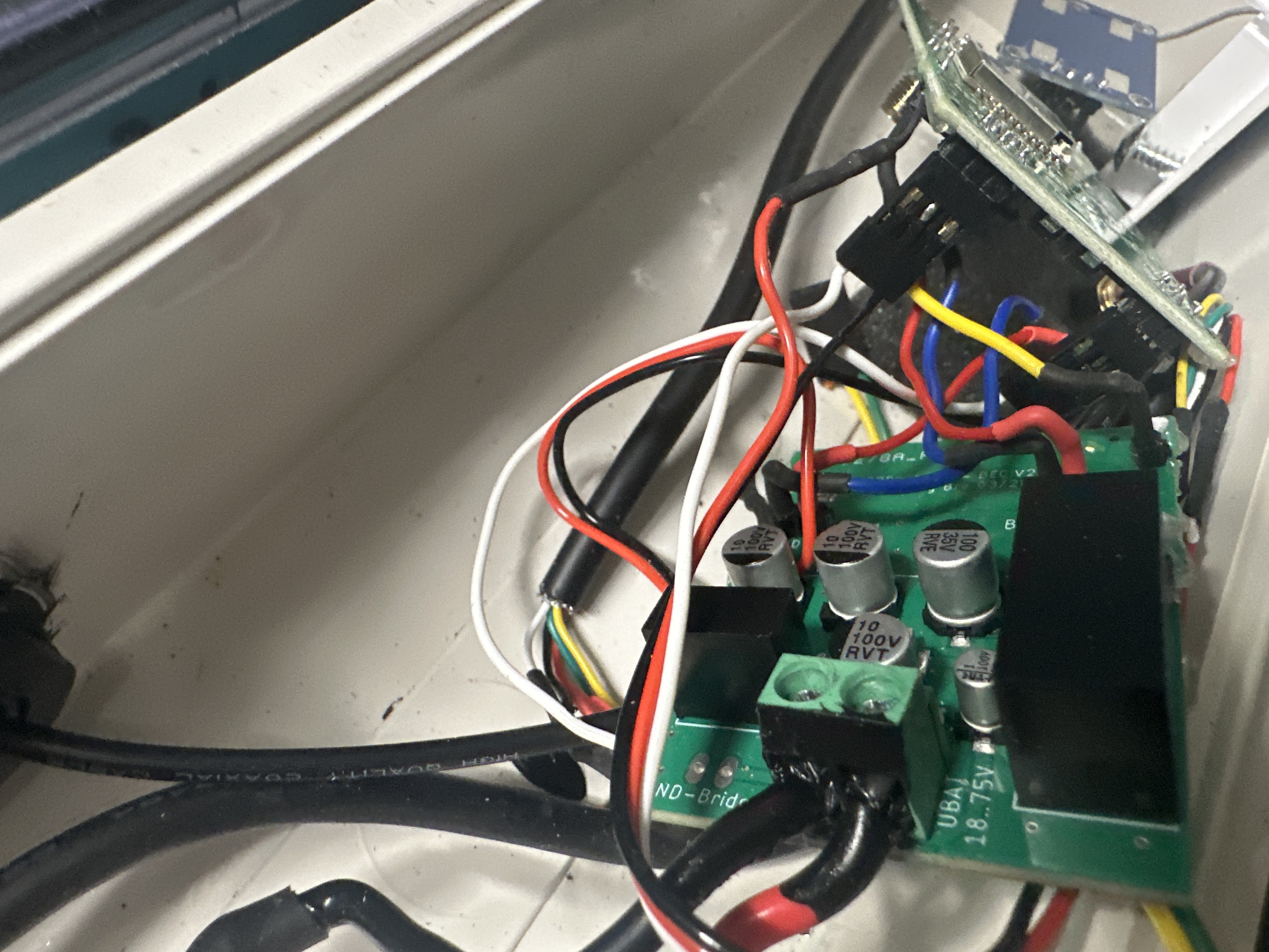

Is the GPS module needed if I’m not using a vesc just esc’s? If so can I connect a seperate battery power source to RX and get rid of Bec what Voltage is needed 6v??
No
No you can not, please keep using the BEC module that you have

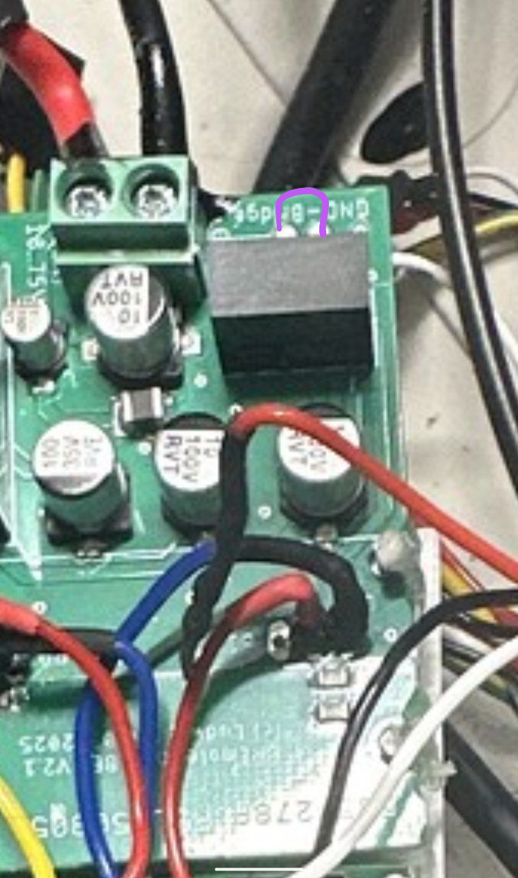

But close the GND bridge on it (connect the two pads).
AQABAAAAAQBkAC9AkB+QPsw2+i30AR4A9AGIE9AHZADoAwoA0AcAAAAACgAAAAEMgAyADIAMgBDrkI5AAAVWCAAAAA=
This is for TX can’t seem to get anything from RX. I will try again next week with RX or may have to purchase another to start again
As stated above the Rx has a power problem
  1. connect the GND bridge like shown on the image
  2. disconnect everything and check if it works only with USB attached
